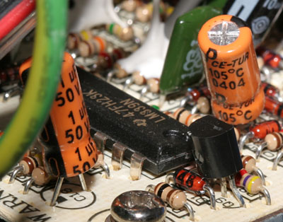

          • japlytic
            • Oct 2005
            • 2086
            #65
            Re: bad cap manufacturers - please post yours here
            What some people may interpret as PCE-TUR is actually a "JP" logo, and the series is "CE-TUR". "CE" probably stands for "Capacitor Electrolytic" and "TUR" is the series (I found data for the TUR series on http://www.0759.net/products/ecap/ecap_e/14-15.htm which may be correct, even though the pictues on the site do not show the "JP" logo). Probably "JP" stands for Jen Pan.

              #66
              good info. here are pics to compare.

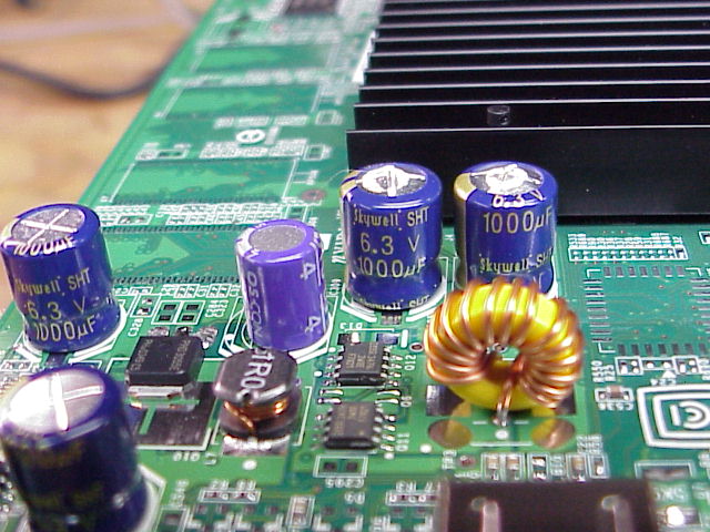

                            • RegR
                              • May 2006
                              • 9
                              #74
                              Wendell? 1000uf 6.3v + pulled from flakey PowerVR/STM Kyro 32mb video card.

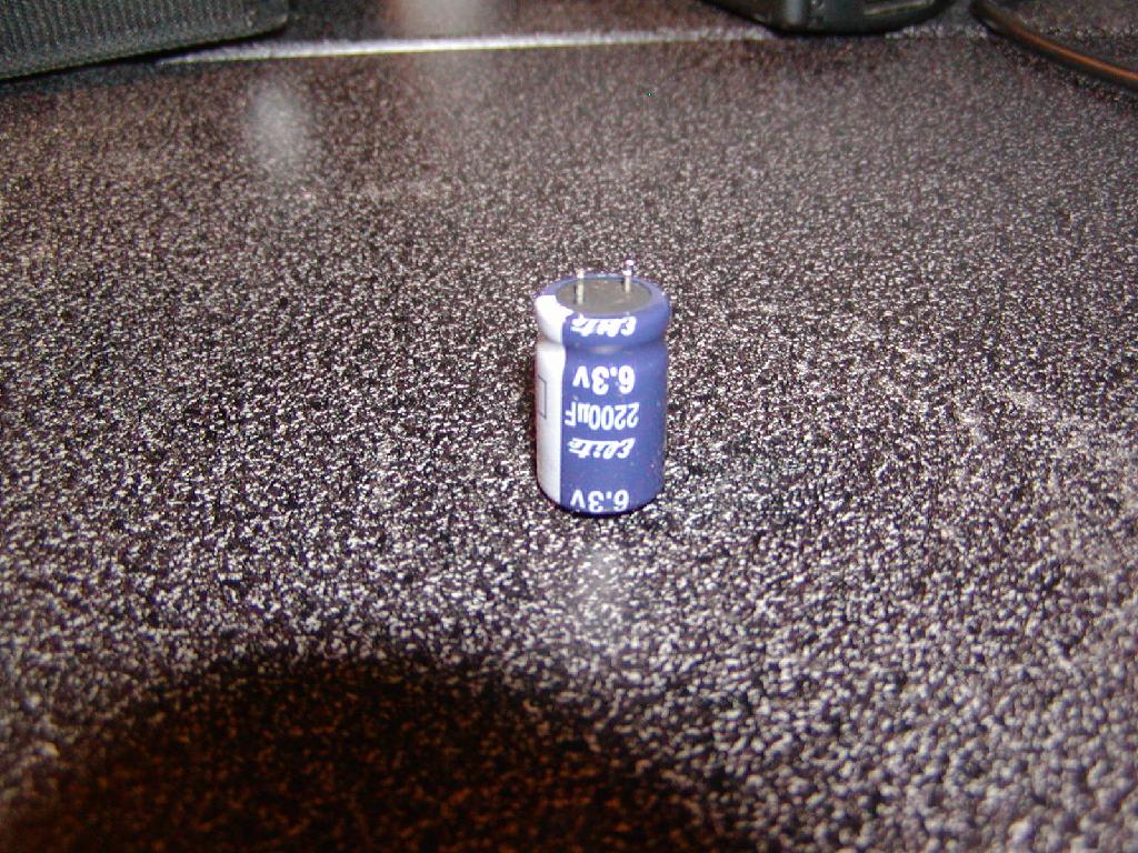

                                  • bobcaygeon
                                    • Feb 2005
                                    • 18
                                    #77
                                    not sure if this is a one off occurrence, but heres an "Elite" brand capacitor I pulled out of a NEC FE2111SB monitor. Not sure if you can tell, but the cap is bulged to the point that the cap is tipped in the photo. The picture on the monitor was best described as slightly jittery, and replacing the cap with a Nichicon of equivalent capacitance/voltage (either that or ripping the entire monitor apart and putting it together again) has solved the problem without reoccurrence after 2.5 months.
