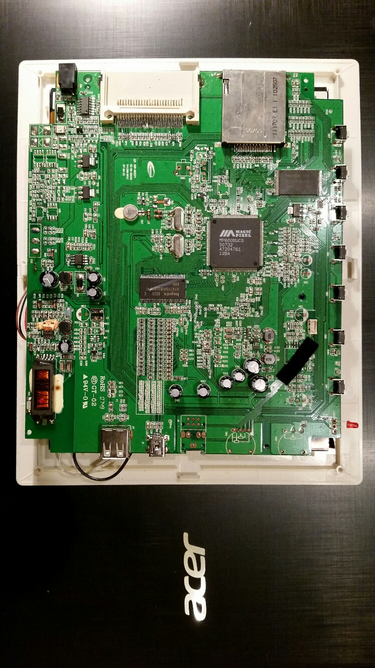

    HP 8" Digital Picture Frame model df810v1. Screen initially lights up with images but after a few minutes, the screen goes completely black. Would this likely be a capacitor problem? I've posted a picture of the board. If this is likely a capacitor problem, can those bad capacitors be identified for me on this picture? Thanks. None of the capacitors appear to be bulging.

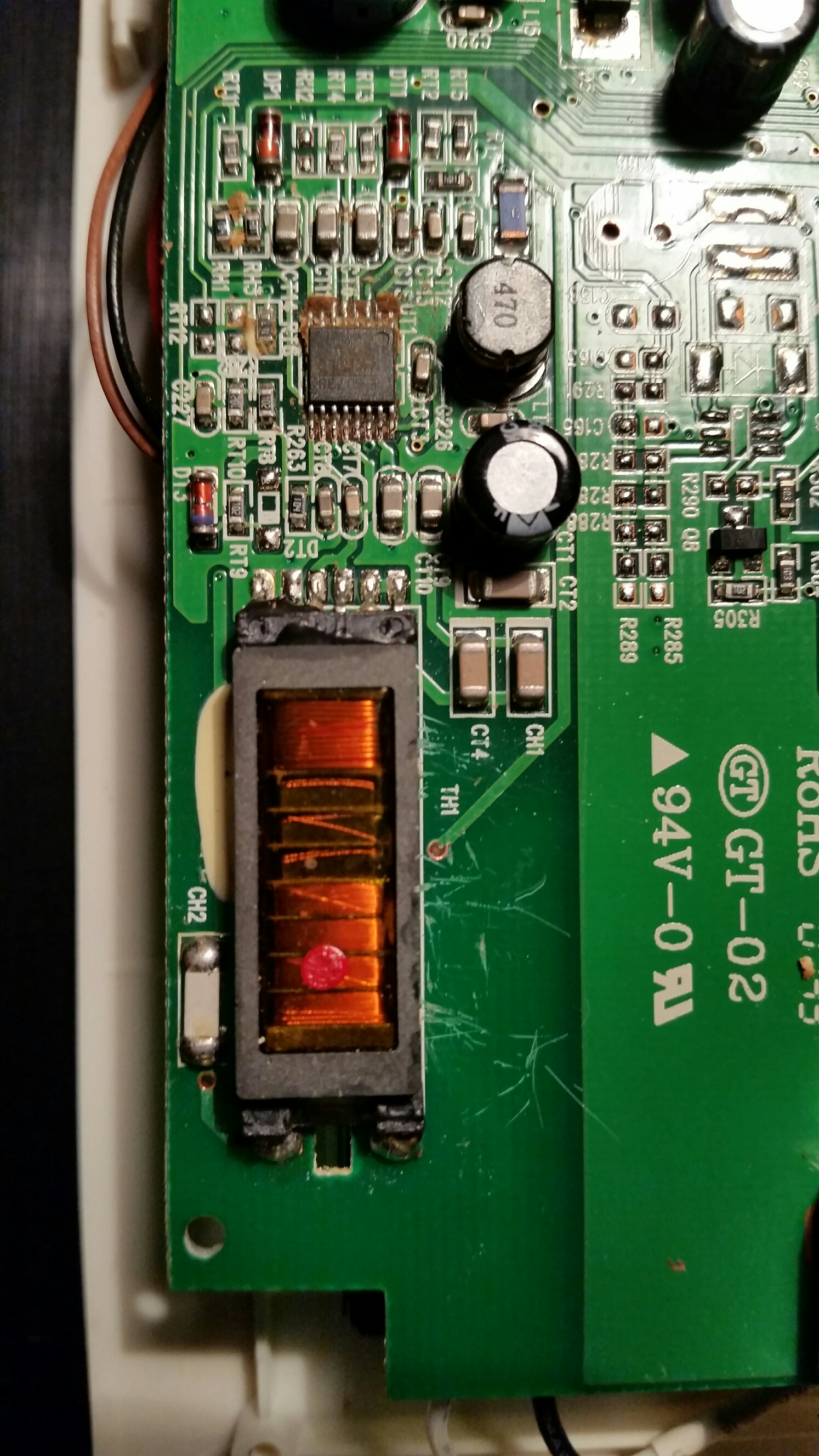

    What is the part number of IC chip that has a heat sink tab to the board and also has a lot of pins on it and looks like some thing spilled on it or burned up it hard to tell which one it is
    It is on left hand side of the board toward the bottom of the board
    Can you take a closer photo of that chip thanks

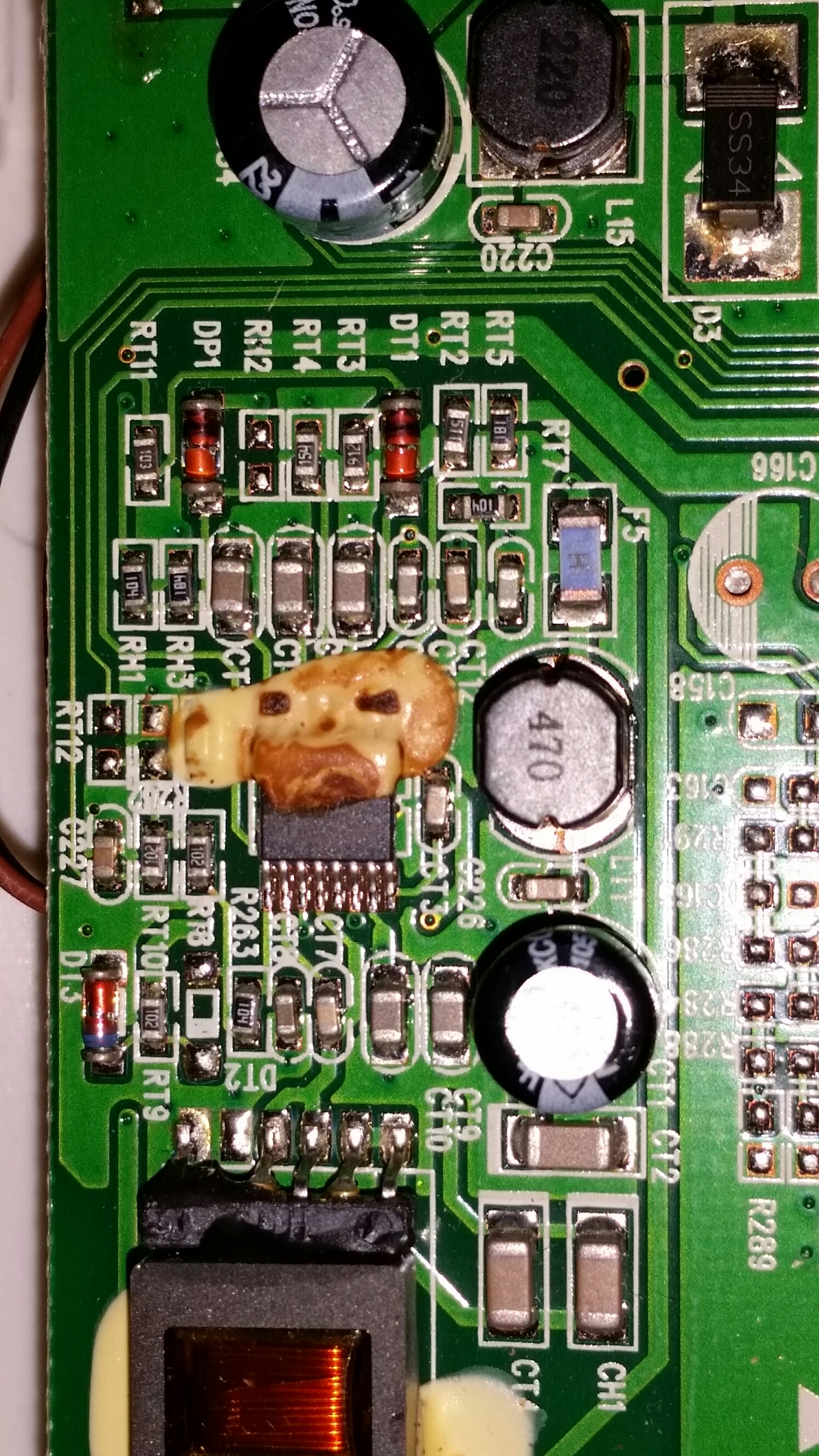

      Thanks. Here's another picture.

        conductive glue - bastards know not to use that stuff!!

            you need to carfully remove it.

                no, just remove the brown glue.
                it turns conductive with age and shorts stuff out - causes all kinds of problems.
                specially bad in psu's!!!

                  Thanks. I'll try that. Is there a 'best' way to remove it, aside from being careful?
                    • 31288
                    Re: HP Digital Picture Frame goes black
                    not really
                    it starts like gum, and as it gets older it becomes brittle like honeycomb
                    so it's very variable.

                      I would careful removing that glue
                      That a lot better photo

                        Looks like there is also that conductive glue on the high voltage transformer, lower left corner of the photo in the first post. Burn mark on right side of it, likely causing the display to shut down.
                        I have had to deal with that cr!p in HP evil (EVO) mini toaster (SFF desktop) power supply that shorted out from that glue. The supply had the glue poured all over the board. It took me 2 hours to scrape it off the board. Unfortunately, I know of no other way to remove except to carefully scrape.

                            No luck. Removed most of the glue (using acetone to first soften). See picture. Now, the screen will not light at all.

                              Look at the pads on the transformer the soldiering joint on the left hand side dose not look very good and another one a few pins from that one dose not look
                              Good either I would resoldier all the pins on the transformer
                              If you have an ( ex-o-knife or very thin blade screw driver)I would try to remove more of the glue but be very care not to dig deep in to the board

                                  Not sure which pins you're talking about. But anyway, what is the purpose of this 'conductive glue'? Is it already conductive and used in place of solder, or is it just glue and it becomes conductive with age? Thanks.
                                    • 31288
                                    becomes conductive with age.
                                    probably used intentionally as a "suicide" device to limit the life of the equipment!!

                                      Ain't that a Btch! But now I'm wondering why removing some of the glue made the problem worse. I was really careful to not damage the board or any connections.
                                        • 31288
                                        look at your foto, it looks like you may have cracked a resistor and possibly dislodged the soldering on a cap or 2.
