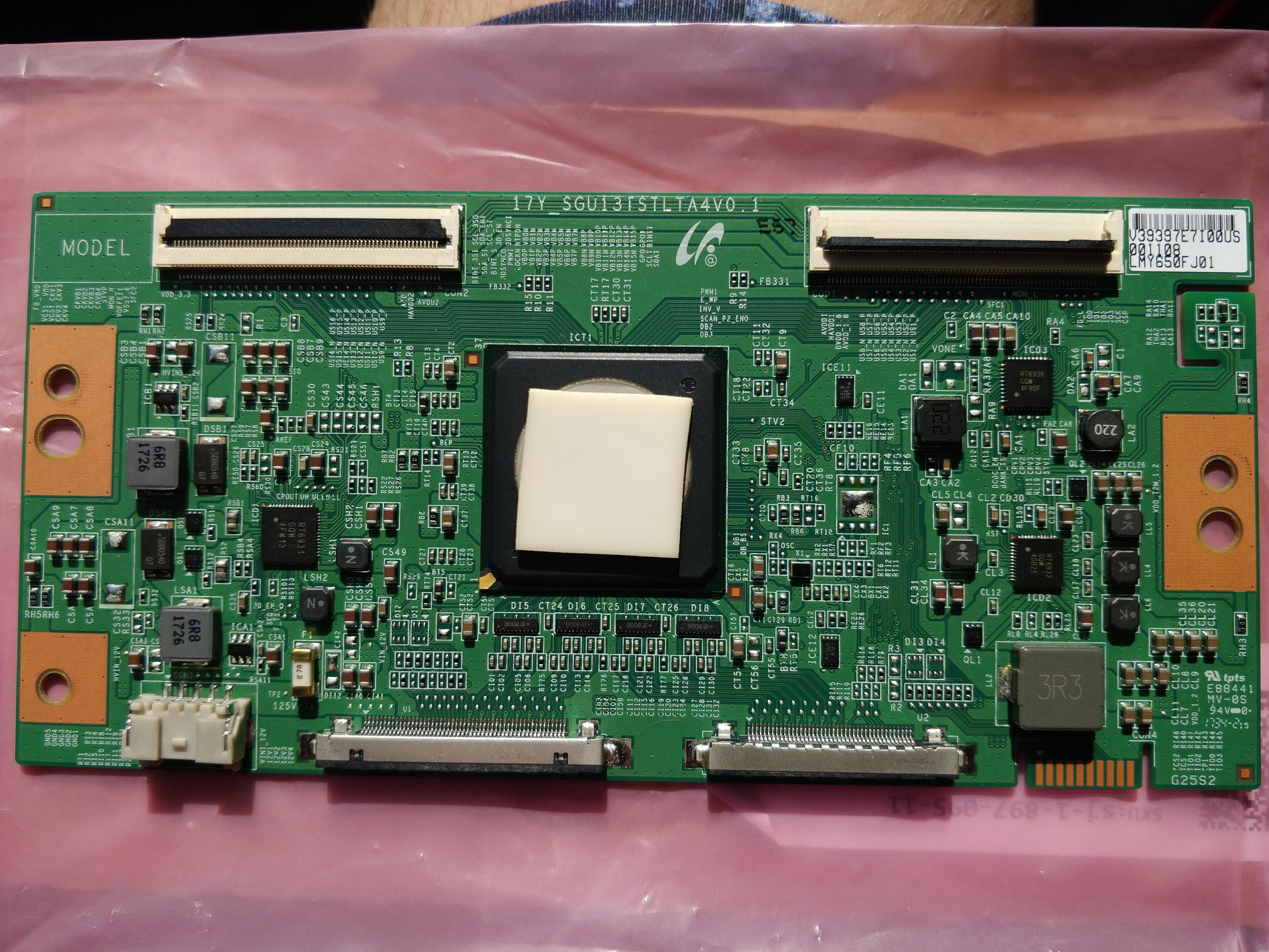

    Hopefully someone can help me out. This tv was working perfectly until a few weeks ago. At some point, the TV just faded to black, but sound continued playing. It almost looked like smoke on the screen as it faded from the bottom left corner toward the top right. Took only a second or less, but wasn't instant. After restarting, it turned back on and worked fine for another day or two. Then it happened again more or less the same way, but in a slightly different direction, again with sound continuing. I thought it was working fine after another restart, but looked a bit dimmer than before. Then I noticed that colors and brightness would be good right after turning on, but would slowly get duller and darker.
    After another day or so, instead of fading to black, it suddenly started distorting the picture and showing a double image a couple millimeters apart, sound stayed normal. Once again, fineish after restart. I started reading up on what it could be and was recommended to do some resets and move the plug into a different outlet. I removed the TV from the surge protector it had been in and plugged it directly into the wall, away from other power cables and everything seemed to stop. brightness improved and no more sudden weirdness. It worked for another week or so.
    Then one day when turning on, the startup logo showed up, but spazzed out and went black. Backlights still work, but no image. Can't start anything to check sound. If I try to go to the homescreen or start netflix from the remote, the backlit black screen does seem like it changes slightly, but still no picture.
    I got led in the direction of a bad t-con board, but also possibly a bad main. I got a replacement for both. Replaced the T-con first and had zero change. Replaced the main in addition to the new t-con and had zero change. Looked further into it and landed on the tape trick. Removed the panel control ribbons from t-con side and checked one at a time to see if I'd get half the screen to play, but still zero change. Figured that even though I hadn't updated the firmware yet, I'd still get some kind of image or menus on the screen, but no, only backlit black.
    Decided to get the update going, so put it on a flash drive and tried starting it up, despite not being able to see its progress. Started with green/amber flashing, but the update automatically started, so the led changed to slowly flashing white. About 10 minutes in, there was a power outage. When the power came back on, I tried the update again and it proceeded from green/amber to slow white, to restarting a bunch of times and continued slow white, and finally landing on solid white. I left it to sit for another 30 minutes or so, after that, but no change and still no picture. I figured the update was complete, so I pressed enter on the remote and a little chime sounded from what seemed like the main board area. I removed the drive and I have a solid white led, with a backlit black screen like I started with.
    I apologize for the length, but I figured you'd want to know as much of the situation and symptoms as possible. I sincerely hope that you can help with some information. Thank you so much in advance, for reading this mess!
    Will follow up with photos tomorrow morning.

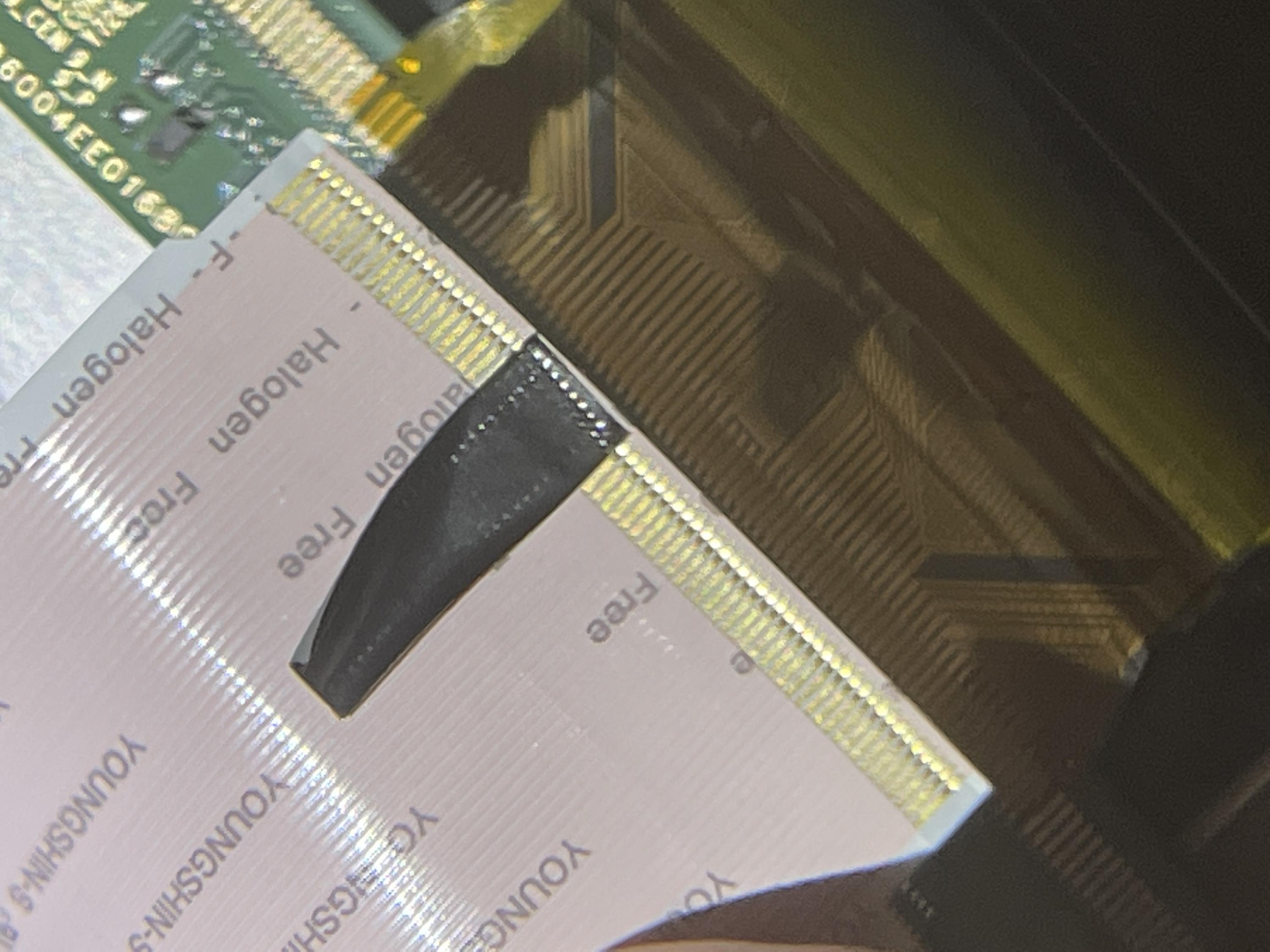

                                  So while I'm waiting for Nick's reply, does anyone have any suggestions as to how I can test what part of the panel is faulty?
                                  He originally mentioned that he thinks there's a good chance of the tape trick working if I can get a good new working main board. And that maybe I didn't do it correctly on my first attempt. I think that's very likely haha and I do have my old working main board installed now, so I can start working on figuring out the panel issue.
                                  When i turn it on with either single ribbon in the t-con, I don't get the half and half display that others get; just my same backlight black screen. So it seems to me that either both sides have traces that need to be blocked or there's something else going on instead of or in addition to this.
                                  I spent several hours yesterday moving a piece of tape around and got no change. I could still be doing it wrong and I only did one ribbon so far. Any advice on this technique or other tests to narrow things down would be greatly appreciated.
                                  • kerberos137
                                    • Nov 2022
                                    • 8
                                    Re: Sony xbr-65x930e faded to black; now has backlight but no picture

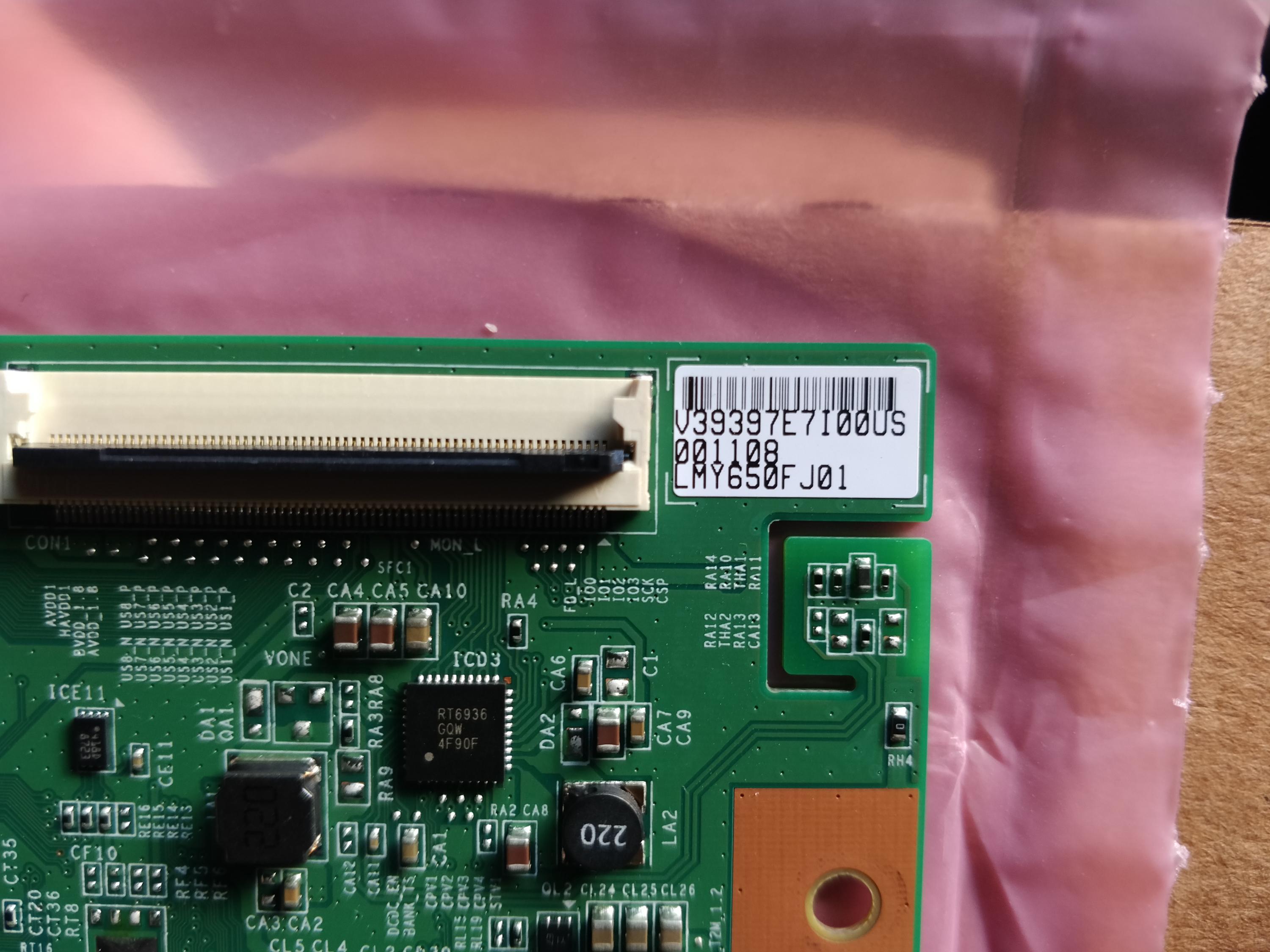

                                    Here's a pic of my t-con board. It's difficult to tell which traces the clock inputs are. I see ckv1-ckv4 and ckvb1-ckvb4 under the square that says MODEL, but can't tell how they all line up with the ribbon cable.
                                    I took that piece of tape on the right ribbon and went from right to left, a few lines at a time and got no change. Then cut it in half because I figured I was covering more than 8 lines and started going back again. I was gonna do the other ribbon today.
                                    I hope someone tells me I'm just doing something way off and not that it's completely screwed.
