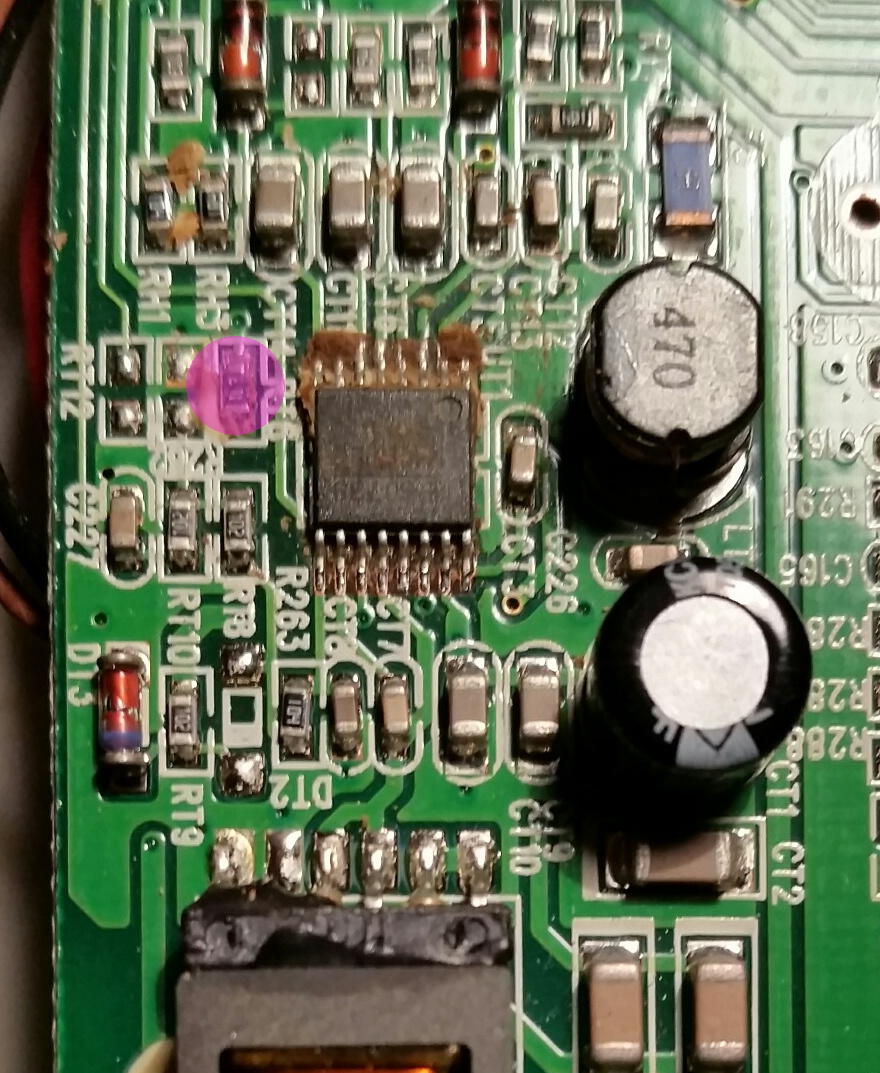

    Re: HP Digital Picture Frame goes black
    Thanks, but I'm sorry that that doesn't help me. Which photo? What resistor? Which caps and how can you tell that any are dislodged from this side of the board? I can't see, even with a magnifying glass, what you're referring to?
      • 31288
      in purple
        Thanks very much. But hallelujah, I plugged it in a while ago and the screen lit up and has stayed lit.

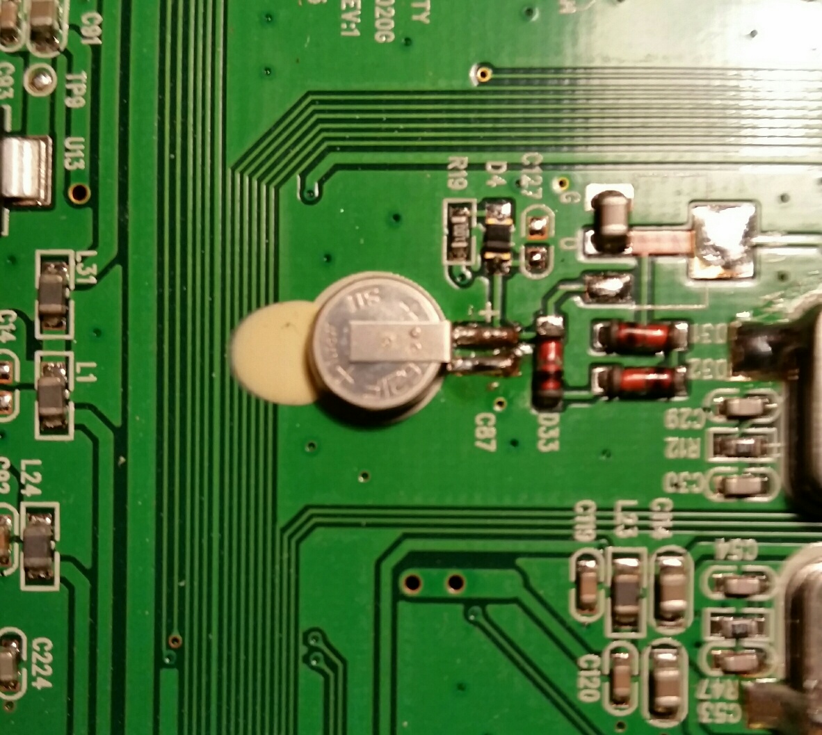

          Screen is still lit. Looking good. Any theories as to why it started to work? I haven't done anything to cause that except not touch it for a couple of days.
          I have another question, though. Attached picture shows what looks like more glue on what looks like a button battery, but I don't think it is. Is that a battery or is it something else?
            That does look like a battery of some type for memory of the photo or photos
            Dose ii keep the photos or do you have keep loading them
              • 31288
              it's a lithium-thionyl chloride rechargeable battery, used to hold the settings etc when the power is off.
              used to see them a lot in cellfones.
                Has an internal 128MB memory but unit says no photos. I'll get back to you on this. Thanks.
                  The unit is supposed to have a demonstration slide show that comes in internal memory. The slide show I think is gone because the unit now shows the message 'no photos'. But I set the time and date, pulled the plug, plugged it back in, and the time and date remained. I inserted a memory card and it displays photos properly. I can also copy photos from the memory card to internal memory and play them there.
                    I put everything back together and it looks like everything is working fine. Removing the glue did the trick. Thanks to all of you for your help. This forum is great.
