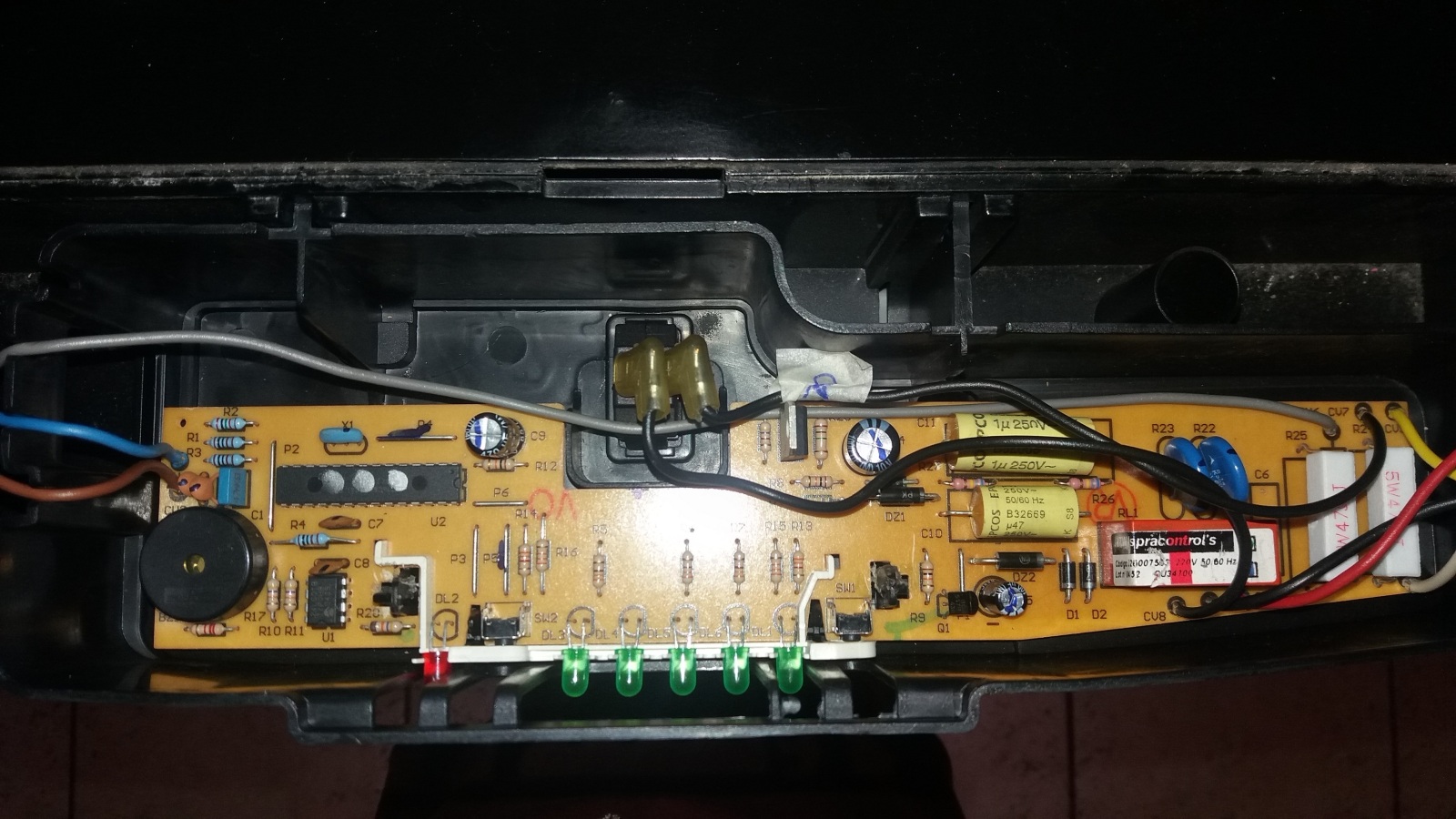

    Hey there everyone,
    So my controller board on my fridge which has 5 temperature settings which are displayed by leds on the front of the fridge has decided to only work on setting 1, 2 or 3, switching it to 4 or 5 causes the lights to flash and the fan kicks in and goes off repeatedly, i have phoned somebody who had the same problem and has told me to replace the 2 yellow capacitors, from what i see these are EPCOS Capacitors, 1u 250v & u47 250v, Model number : B32669.
    It seems like the board isnt worth alot of money but down here where im staying they want to charge 250$ for it..
    Datasheet : http://pdf1.alldatasheet.com/datashe...OS/B32669.html
    This company is local to my country and i was wondering if any if these capacitors listed would be applicable :
    http://za.rs-online.com/web/c/passi....264,4294464783
    http://za.rs-online.com/web/c/passi....766,4294464783
    it needs about 5 seconds to load the filters i added.
    Any help will be greatly appreciated.

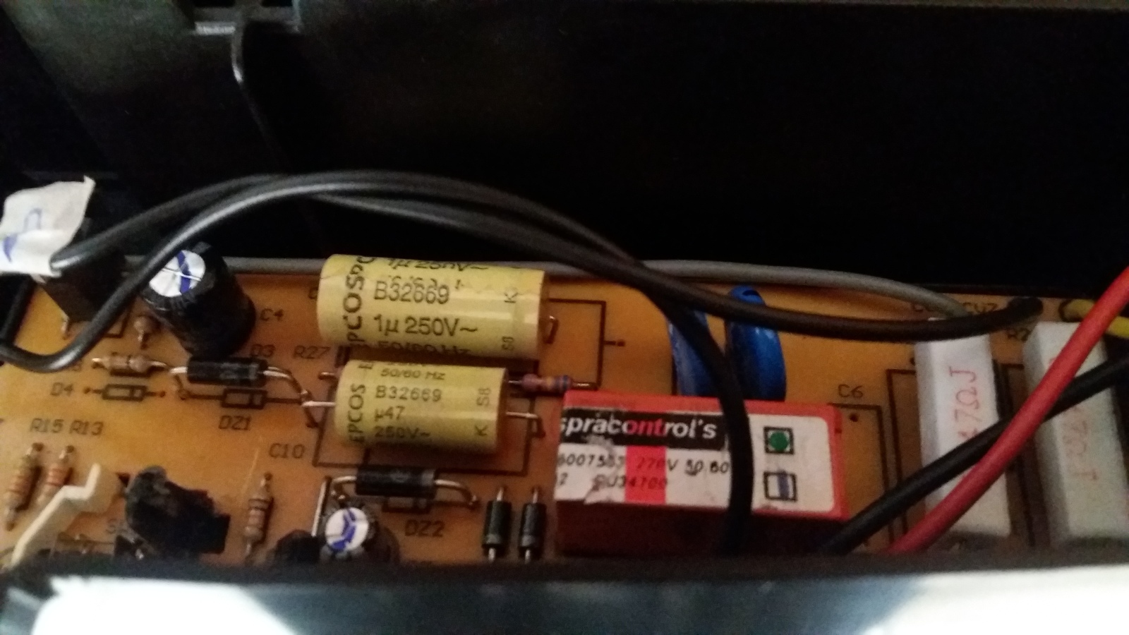

    I get blank forms - stuff at the top and sides, but no particulars about any parts. Did you notice the "~" after the "250V" on those capacitors? That means that the rating is 250VAC.
    The B32669 series was, I think, originally a Siemens part. They partnered with Matsushita (Panasonic) to create Epcos. Siemens and Matsushita sold their holdings in Epcos in 2006, and TDF acquired Epcos. The B32669 series was discontinued in 2014.
    Vishay has several axial lead AC rated MKP series. You might see if any of those are available there in South Africa.

      I would use any X1 or X2 rated film capacitor, polyester or polypropylene.
      Axial film caps are harder to find and expensive like 10X. If you measure the lead spacing, maybe put in a boxed part. But watch the height.
      Example http://za.rs-online.com/web/p/polyes...itors/8741481/ or http://za.rs-online.com/web/p/polypr...itors/1247430/ or http://za.rs-online.com/web/p/polypr...itors/8829496/
      The electrolytic caps (c4 etc) I would change out too.

        Hey there Pete, not sure what you mean by blank forms, do u mean i should of put a bigger picture of the whole board ?
        I did notice the ~ , had no idea it meant vAC, learnt something new !
        This board has been running 14 years so it makes sense that it has the old epcos caps, i did see a TDF data sheet on some similar caps i think. ill see if i can find it.
        Ill definitely take a look at some of the Vishay caps then, i think i do know a supplier, could i ask is there anything else i should be looking for when matching these capacitors ? Besides Voltage, capacitance, polypropylene dielectric etc ? Thank You

            Capacitors with suppression rating X1 or X2 can withstand overvoltages from lightning etc. so they are the toughest part. You don't have to have them for this board, and the one you linked to is fine without that approval.
            Big 27.5mm lead spacing, if it fits the PCB.
            I find film caps fail short-circuit, so I am not sure these parts are the problem with the board. Let us know how it turns out.
                  That makes sense redwire, so they just way more durable caps then ? so the ones i linked would work but they are not recommended because they cant withstand such overvoltages ? So pretty much wasting my time going with non x1 or x2. Spacing shouldnt be a problem with any box cap, the enclosure that the pcb is in has alot of headroom, id say almost 2 inches.
                  Would i be wrong to say that a capacitor like this could sort of half work ? Or in other words lost some of its capacitance ?
                  Here is another picture of the pcb maybe you could tell me what else you think has gone wrong ? Thank You man !

                        The board looks like a sturdy design, 14 years is nothing. Here is a CERN research paper on film cap failure and lifetime.
                        If you can measure the two film caps, that will tell you if they are bad. There are MOV's for surge protection R22, R23 so you don't have to use X-caps.
                        It sounds like power cuts out when many LED's are on?
                        I am guessing but DZ1, C11, C4 are for power to the voltage regulator near R8, maybe +5VDC for the MCU. DZ2, C10, C5 are maybe for the relay power RL1.
                        Taking some voltage measurements across DZ1 and DZ2 will tell you if board has enough DC power. Or you can change parts and hope it fixes things.

                          Those two caps look to be used Vdrops capaciitive power supply for drooping line Voltage for low level dc power supplies.
                          The lytics caps on the board should be changed for sure.

                            THanx for the reply once again Redwire, i take it you get boards that last quite alot longer than 14 years ! Thats intense !
                            I havent measured the film caps as of yet, i did order replacements though & i did get x-rated capacitors, you said i dont have to use them but using them wont be a problem right ? I got 5x1uf 250v & 5x0.47uf 250v Panasonic Caps as such :
                            http://za.rs-online.com/web/p/products/6225075/
                            Board does cut out when all leds are on, even on setting 4 as there are 5 settings, currently on setting 3, when i go to setting 4 or 5 all leds start to flash and fan inside fridge goes on and off along with the flash.
                            Im not too good at reading voltages across boards, if you can give me some tips maybe i could give it a try man ? Im hoping its one of these capacitors though.

                                Hey guys just an update, i installed the two capacitors the ones that i linked in the post when i quoted Red and the fridge is back! all settings are working! i havent replaced the electrolytic capacitors just yet, not really keen to tinker more if i dont have to, what do you guys think should i replace them now ?
                                To anybody else viewing this thread this fridge is a Whirlpool WRF40, i should of put this in the topic but hey maybe this post helps you pick it up : )

                                  Personally I would replace the electrolytic capacitors because after 14 years they would be past their best and could still fail blowing something else in the process - electrolytics are generally more delicate than film capacitors - if your fridge is the type with PID Temperature control (a lot of Liebherr Fridges / Freezers are [Liebherr make ALL Miele fridges and freezers] but I am not sure about Whirlpool/Philips) you would suddenly find out just how accurate temperature control can be!

                                    Your right man, i have all the necessary replacements, i should pull that board soon and give them a replacement. Fridge still working perfectly since i replaced the two film caps, so your implying i would get better temperature control with the newer lytics ? Thanx : )
