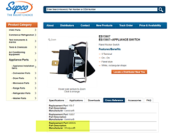

    I am trying to track down a replacement rocker switch for a Whirlpool RDE3340W electric range.
    The rocker switch was made by McGill under their part number 0801-1059 and supplied to Whirlpool by FSP under their part number 686605. Whirlpool's original part number was 865745.
    The switch is an On-Off-On type (SPDT) designed for use with either 115 VAC or 230 VAC. It is not lighted.
    Are there any current switches that could be substituted for this switch?

    Found only this on ebay - try to bargain with the seller:
    https://www.ebay.com/itm/22385514638...Bk9SR7zYv8yGZQ
    Jackpot!!
    https://www.ebay.com/itm/20464913212...Bk9SR77UzMyGZQ

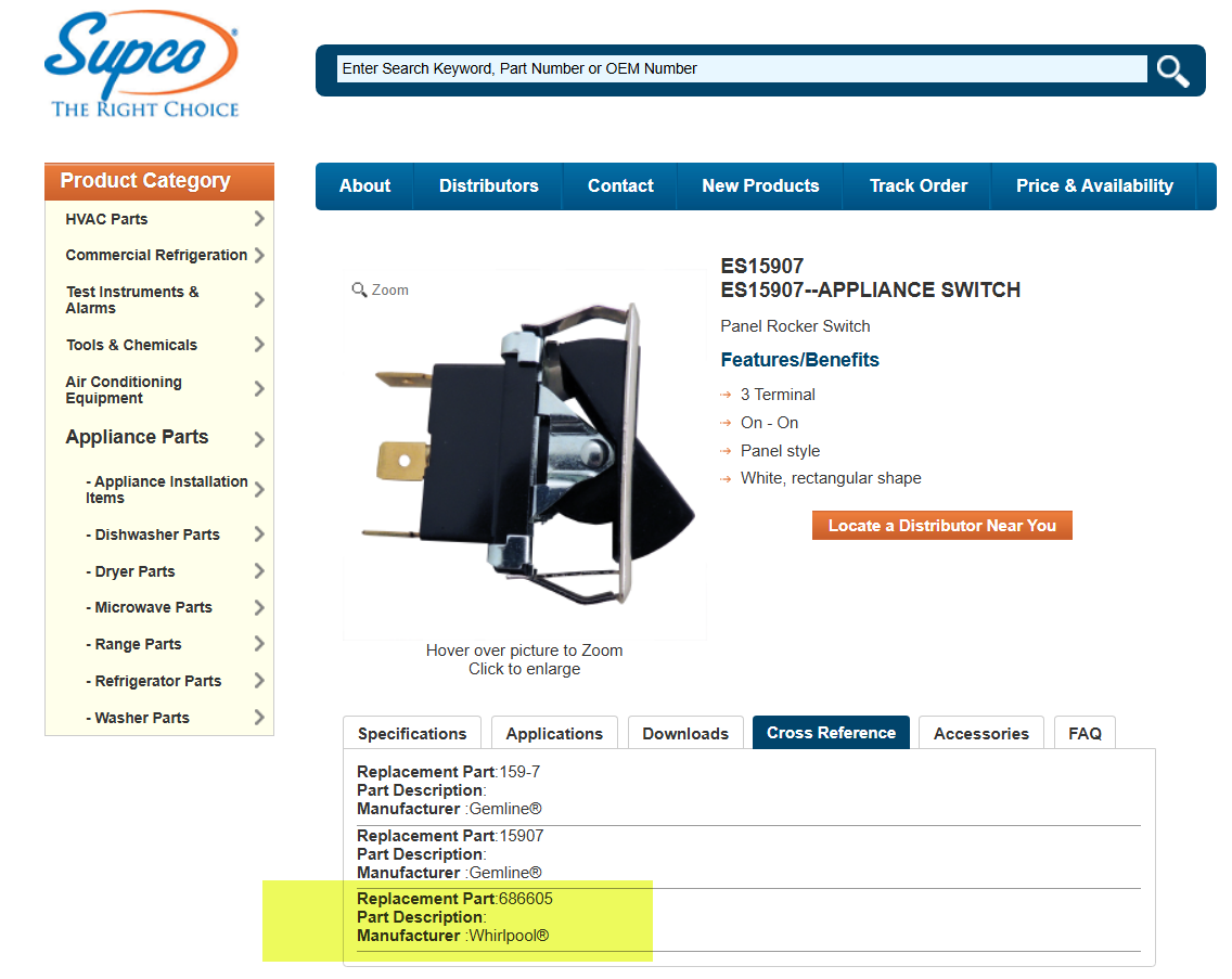

    Replaces Old Numbers 686605 15907 15908 42074042142
    You will have to confirm if this is a proper fit but available from Supco:
    https://www.supco.com/web/supco_live...s/ES15907.html
    Available on Amazon (but cheaper if you can buy through other avenues):
    https://www.amazon.com/ES15907-Supco.../dp/B003N6V7EQ
    Ok, last post:
    https://www.ebay.com/itm/18651503007...Bk9SR7DkkM2GZQ

          Both of you provided excellent answers.
          I did indeed negotiate with the first ebay seller and purchased that switch. I also purchased one from the second seller.
          Information is very useful to people, like myself, who try to keep appliances working. Knowing which new parts will work in old machines is valuable.
          So, thank you to both of you! Both are great answers!
