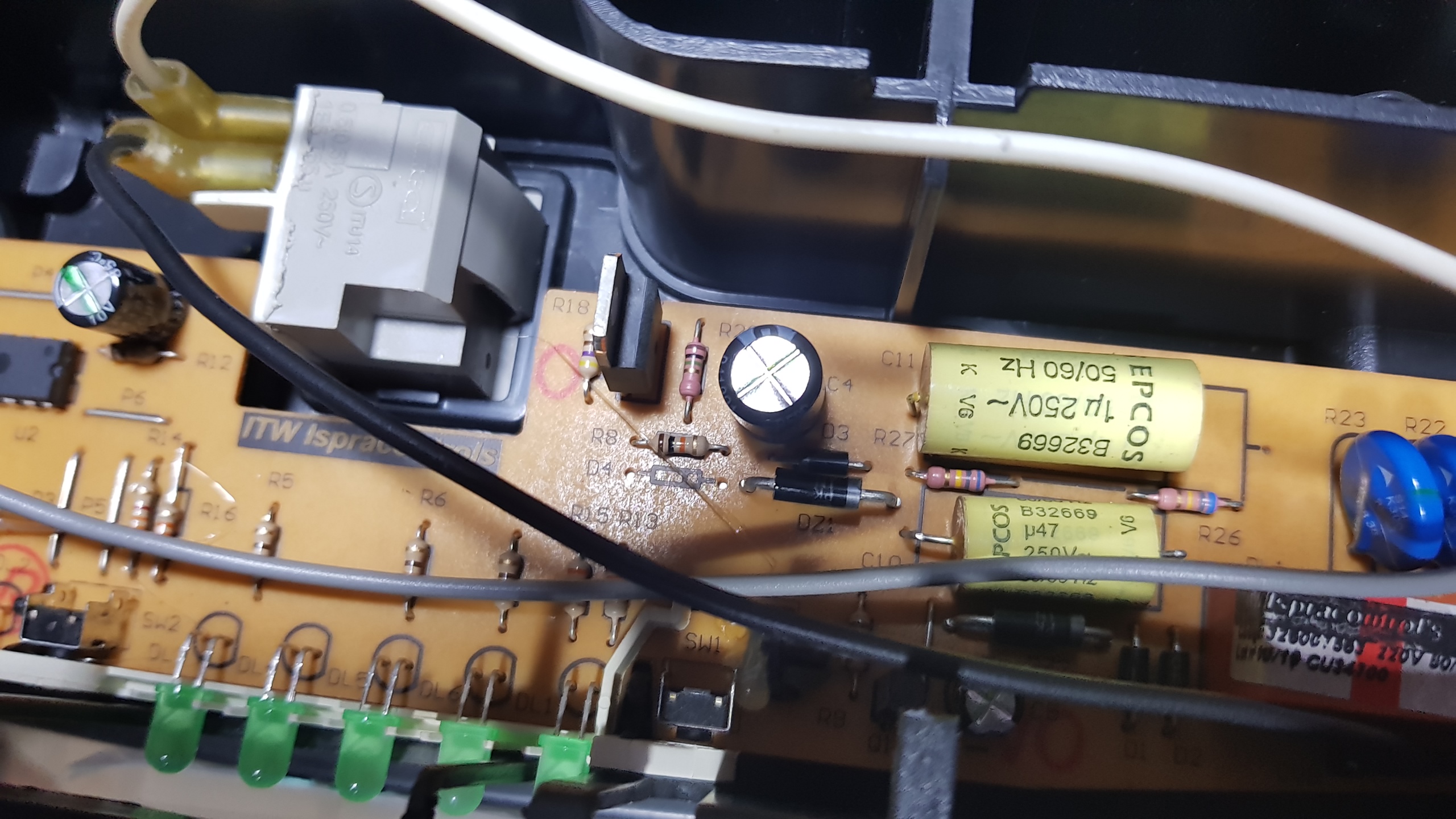

Whirlpool WRF40 fridge Metallized Polypropylene Film Capacitor Replacements?

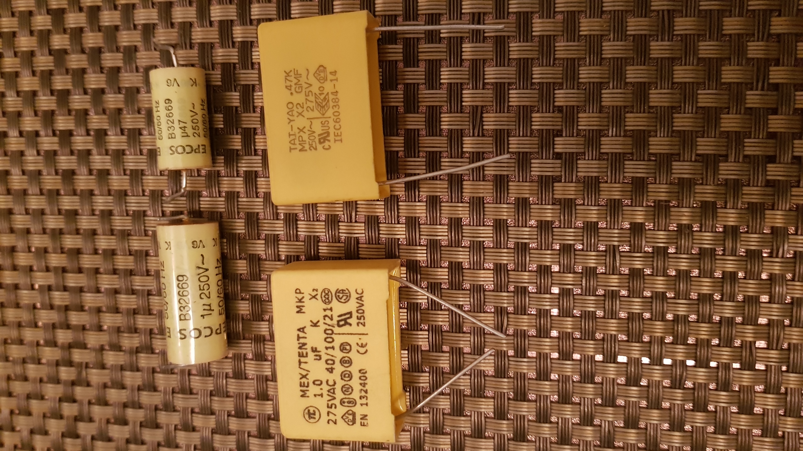

        I think the ones he used are these:
        http://za.rs-online.com/web/p/polyes...itors/6225069/
        http://za.rs-online.com/web/p/polyes...itors/6225075/
        This should also be a nice replacement, being X2 classed:
        http://za.rs-online.com/web/p/polyes...itors/8740829/
        http://za.rs-online.com/web/p/polyes...itors/8740826/

          Thank you so much for your help.
          Will get the better ones and try it out.

            • redwire
              • Dec 2010
              • 3912
              Re: Whirlpool WRF40 fridge Metallized Polypropylene Film Capacitor Replacements?
              C9: 470uF 10V? electrolytic (P=?mm)
              C5: 100uF ??V electrolytic (P=?mm)
              C4: 1,000uF 10V electrolytic (P=?mm)
              C10 - 0.47uF 250VAC metal film (P=22.5mm)
              C11 - 1uF 250VAC metal film (P=22.5mm or 27.5mm)
              If you can check/update the some of these numbers to help others.
              I put these in from the pictures

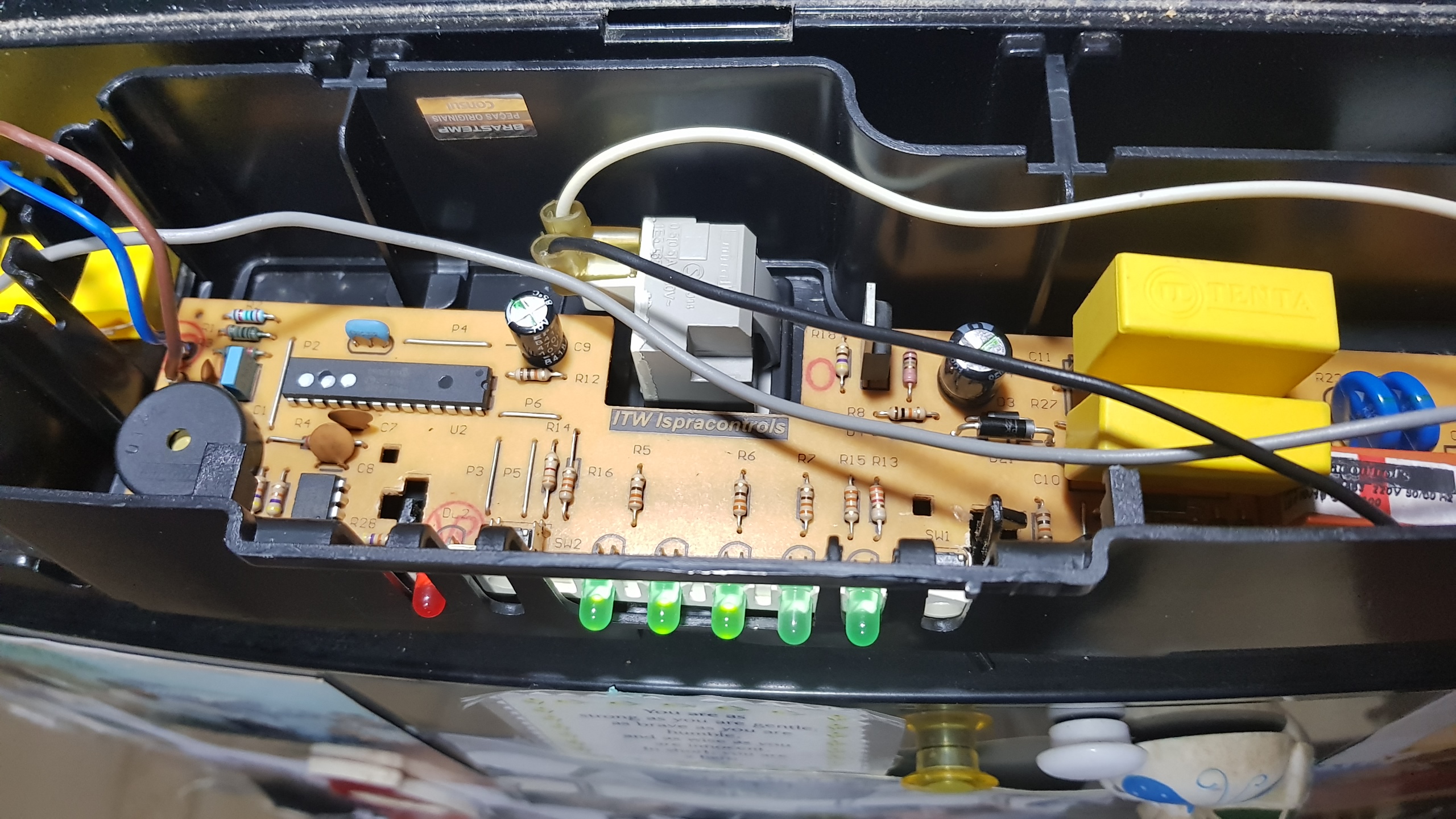

                I am planning to take the board out tomorrow to work on replacing the Capacitors.
                @ Redwire, I will update the numbers for you when I remove the capacitors, probably later tomorrow.

                      Hi RickyZA,
                      No I haven't had a chance been putting it off for a while, just moved house and trying to sort out chaos.
                      The top cover is a bit tricky and I wanted to spend more time in it so I don't break any plastic clips. Any pointers?

                        Eventually I repaired my fridge. I changed all the caps. All is working perfectly.
                        Update - C5: 100uF 35V electrolytic

                            See post #14, he replaced the two film caps. one is 1uF 250 VAC, another one is 0.47uf 250VAC.
                            Panasonic ECQUL series:
                            https://za.rs-online.com/web/p/products/6225075/
                            https://za.rs-online.com/web/p/polye...itors/6225069/
