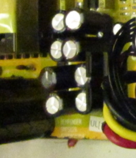

    Decon garbage
    Repairing Behringer EUROLIVE B1500D-PRO
    They used the crappiest caps ever...decon and ksd
    • 31156

              • Cartel
                • Feb 2006
                • 112
                Re: Decon garbage
                Originally posted by ReeceyBurger123
                Nasty Ive seen a fair few of these fail, also can you upload pic after recap ?
                I'm sorry I deleted the pics but its the 8 caps in this picture.
                I had nippon and elna on hand
                4-470uf 25v and 4-470uf 35v

                  Re: Decon garbage
                  Yup, Behringer loves to use Decon caps. But you got extra-screwed with those 85°C-rated caps.
                  I have an Europower EPQ1200 in the closet full of these Decon caps as well, except mine are the SHL series, which are supposedly their low ESR series rated for PSU use and rated for 105°C. I haven't recapped it, mainly because they are quite big and will probably cost quite a bit... and I don't use that amplifier very often (maybe take it out of the closet once a year), so I that's why it's not recapped yet.
                  Originally posted by stj
                  85' caps in a switching supply - insane.
                  CRT monitors and TVs often used 85°C caps and rarely had issues. Mostly small caps drying out on the neck board - but you know how hot that board can get as it's attached to the back of the tube (and very near the heater). That said, I have yet to see a Sony CRT TV or monitor with bad Nichicon VR caps. Or a Panasonic with its own Panasonic general-purpose caps.
                  Originally posted by Wester547
                  Using 85°C GP capacitors on the output of a SMPS is indeed a gross misapplication, but I'm pretty sure the fact that they are Decon made their failure all the more a likelihood.
                  Exactly.
                  You can bet that general purpose caps from the big Japanese manufacturers would have lasted much longer.
