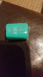

    Hi there can some one tell me from the following information what the capacitance rating should be on ths cap.
    it is marked as follows.
    fl 1.5khp
    333h s*j45.
    is it a 333pf rated at 1.5 kv,or am i completely wrong.also whats the best place for a replacement.

    Yes , it is 33000 pf , or 33 Nanof , or 0,033 Microf. at 1.5 Kilovolt capability .

      Do you have pictures of this cap and where it is used in the circuit? CERAMIC? POLY?

        yes ill post some pics of the cap for you as soon as i can.. i pulled it from a lg tv power supply board :the tv model number is 42pj550-zd.the capacitance seems to read ok (34nf),but cant test the esr as my peak atlas esr meter wont read caps that low.

            ESR meter is not really made for using on those kind of cap. I would say the cap is OK.

              heres a pic of that cap budm,one of the legs has broken off so will have to get a replacement now.

                you get loads of those type of caps in crt tv's & monitors.

                  just need to find a compatible replacement now.

                    could i replace it with this.https://www.amazon.co.uk/MKS4-33N-Ca.../dp/B01AIMD0L0
                      • 31012
                      Re: whats the capacitance of this cap please
                      you like being robbed?
                      go look here:
                      http://uk.rs-online.com/web/

                        http://uk.rs-online.com/web/p/polypr...itors/8829212/.would these be suitable,as a replacement.
