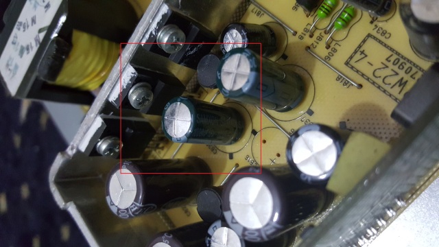

    Hi my sister gave me a TV. It's acoustic solutions lcd26762hdf
    yep I've never heard of that brand neither.
    Well it turns itself off after about 1 min.
    I took the back off and there is a capacitor on the power supply board which is bulging.
    I would like to replace this with a superior one.
    I look at the cap in question and it says :
    SAMXON 1000u F16v
    105ᵒ C6
    W9A
    GF(M)
    regards

      Replace it with Low esr of the same value, also replace any other Samxon Gf brand capacitor.

          GF series are LOW ESR type, 105c.
          https://cdn.badcaps-static.com/pdfs/...f7f2736d54.pdf
          I would replace them with PANSONIC LOW ESR, 105c FM or FR series.
            • 31214
            Re: LCD TV with a bulging cap in power supply
            esr is not printed on it, you need the GF series datasheet.
            however, dont concern yourself with it, just use panasonic FR series.
            be carefull to get the correct diameter and height or the tv may not go back together
            and dont use ebay - use RS or Farnell

              nice. thanks for help guys. Is it ok just to replace this Samxon with the panasonic and leave the other Samxon caps?
              • rhomanski
                nowhere man
                • 5157
                • U S of A
                If you need practice taking it apart, replace them one at a time every couple of months.
                Not that I'm a smart-aleck or anything. I usually replace all questionable parts while I'm there. If I have to come back, so be it, but I'm going to try to not let that happen. Personally I don't trust any but Panasonic, Nichicon, or Cornell Dubillier, maybe Rubycon.
                sigpicThe Sky Is Falling
                • dmill89
                  • Dec 2011
                  • 2534
                  ^This, if one cap failed the others have been exposed to the same stresses (heat, ripple, etc.) for the same amount of time, and likely aren't far behind (especially those that are the same brand and series, meaning they are engineered to the same specs.).

                        Hi I just want to check this out.
                        I've got the panasonic cap the gold strip is the + right?
                        • vinceroger69
                          • Mar 2012
                          • 6714
                          • uk
                          just checked one of my spares the gold strip is minus -
                          • eyespider
                            • Aug 2016
                            • 10
                            oh boll0cks I've got to desolder it then. Good job i didn't put it back in the TV lol

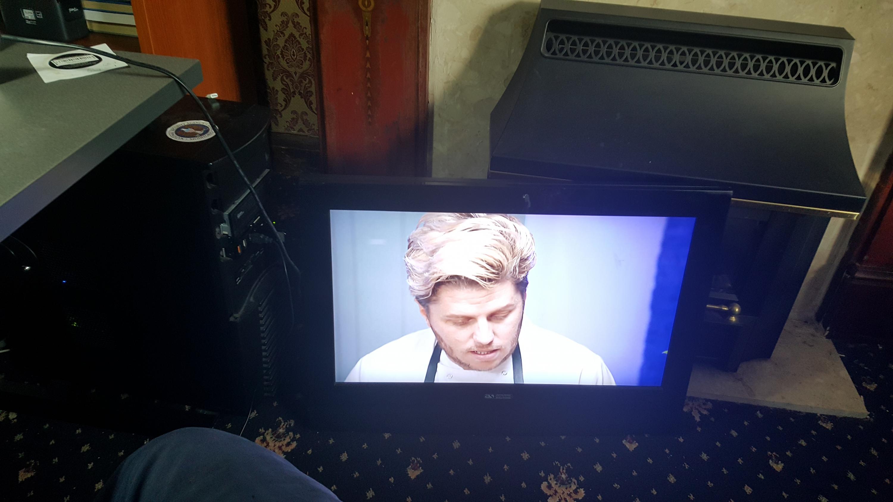

                            • eyespider
                              • Aug 2016
                              • 10
                              Get in!!!!
                              I've fixed it, it's working perfect. Many thanks to everyone who helped me out.

                                Thanks for posting the update and glad the capacitor fix worked not sure if you have replaced them all on the power supply but its always best too,although i usually leave the main large filter capacitor on the hot side of the psu, as thats usually fine.
                                • eyespider
                                  • Aug 2016
                                  • 10
                                  confession....I just replaced the bulging one as I am inexperienced soldering. As this has given me confidence I will now do the otheres.
