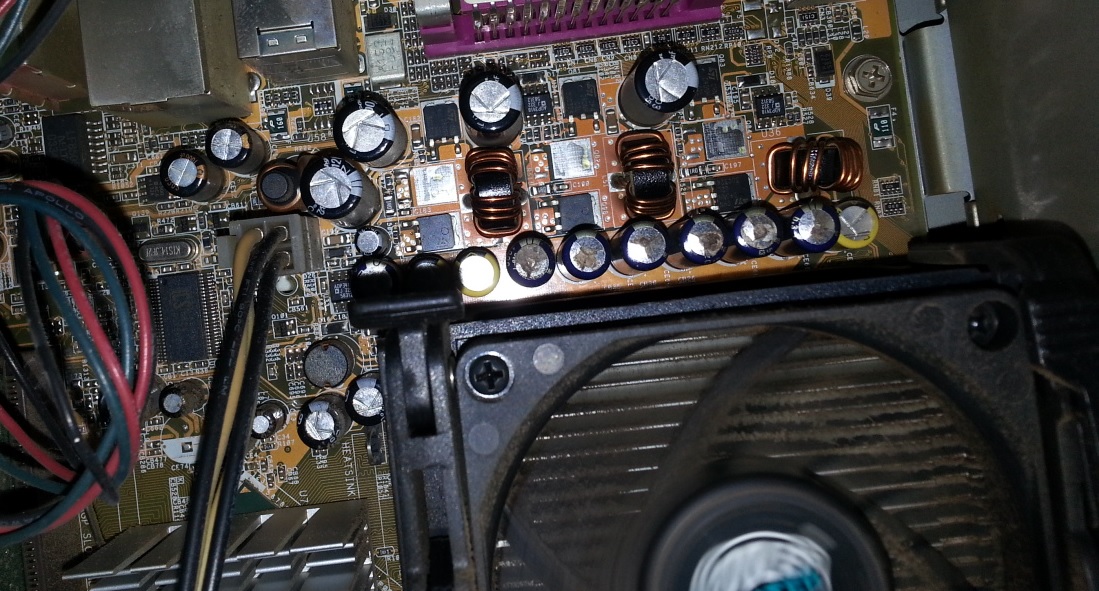

    How bad does a bad cap look?
    My tv stopped working this week, blank screen & no sound, but power OK. Took the back off and had a look at the main board. It looked OK at first, but when I had a closer look at the capacitors, saw that 5 of them had very slightly bulging tops. Think that may be the problem? I've sent for some replacements anyway, because if it's anything else it will be cheaper to buy a secondhand TV, rather than get this one repaired.
    • 31277
    Re: How bad does a bad cap look?
    caps go bad BEFORE they look bad.
    so if they look bad - they are very bad!
      Originally posted by stj
      caps go bad before they look bad.
      So if they look bad - they are very bad!
      This! +1
              How can we know the caps are bad if they don't look bad ?
              • junktv
                • Nov 2010
                • 3065
                These are still working.
                  • 31277
                  with an ESR meter
                    ESR meter.
                    i have had many caps that look like new that are bad
                        no they are not.those are open now.
                        the 2 polys are eating all the ripple and allowing the board to limp along.
                                Speaking of ripple sometimes the bestech psu powering it needs a little heat from a hair dryer to get going.
                                It needs some attention but so long as it doesn't catch on fire i'm not to concerned with it.
