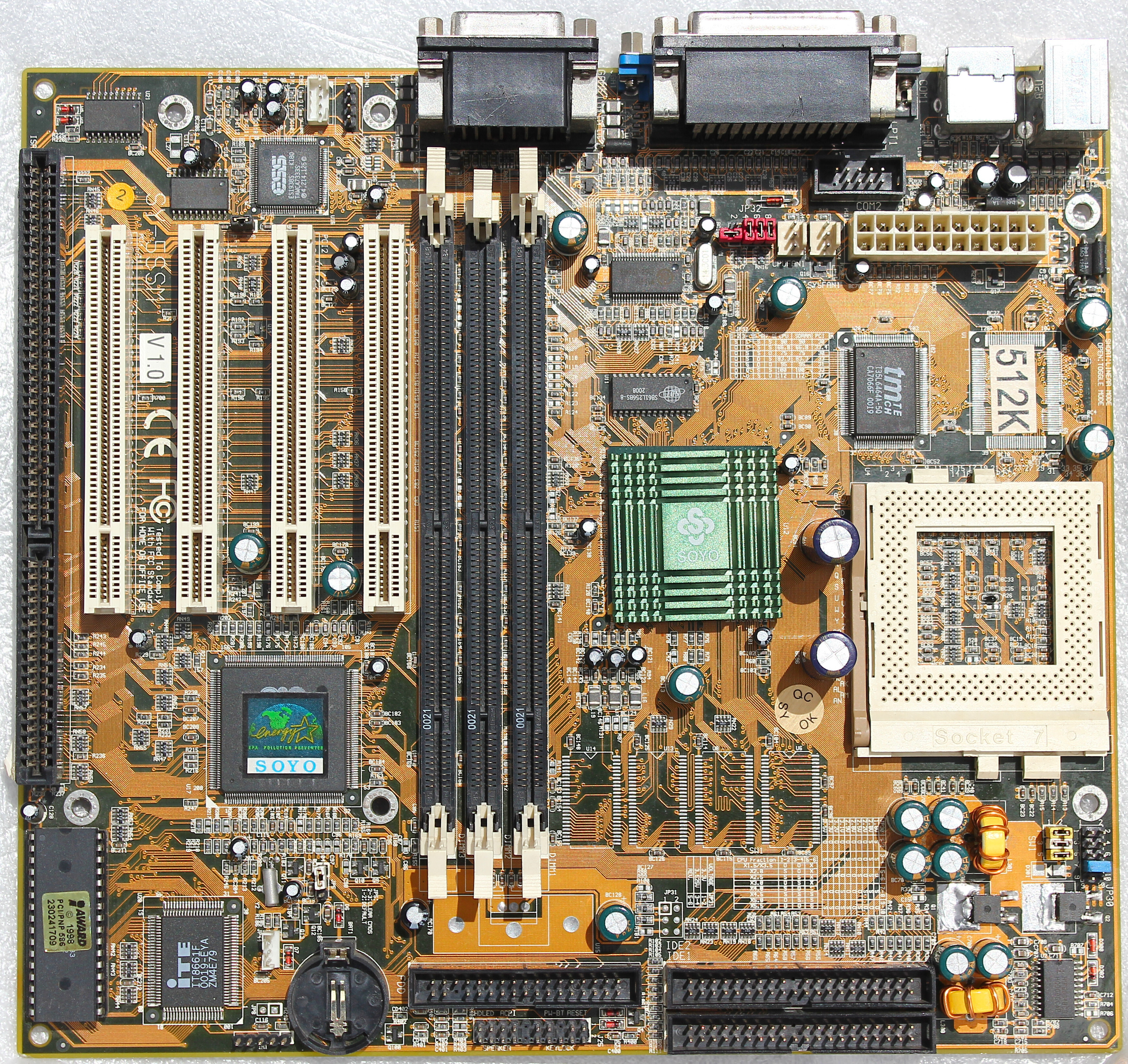

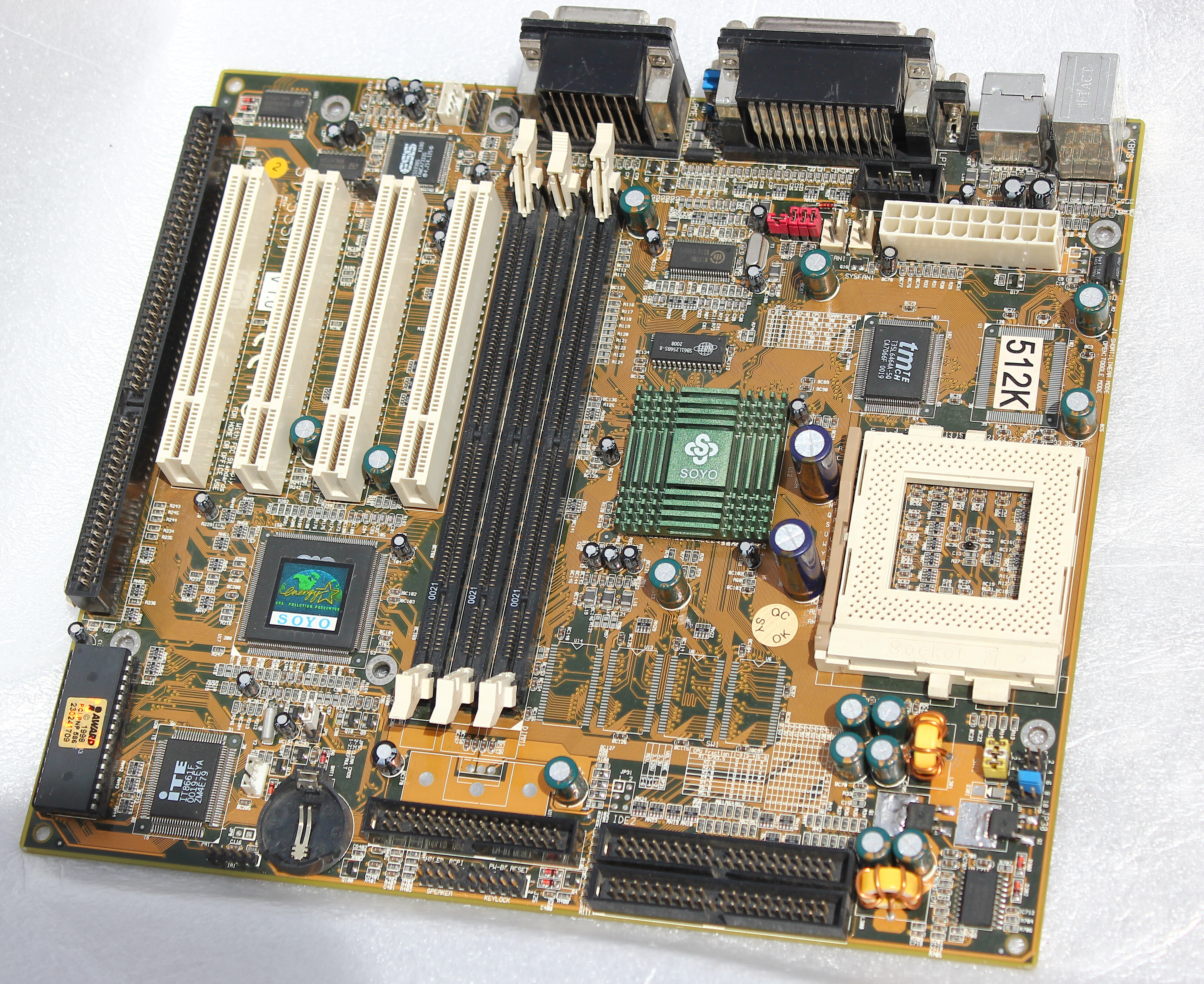

    I'm trying to fix this SY-5SSM motherboard (Socket 7).
ID:	3557374 Click image for larger version
    When the PSU is connected it powers on by itself but there's nothing on the POST card, no beeps.
    The BIOS EEPROM is ok (latest BIOS was flashed).
    All the jumpers are set ok.
    All the 1000µF 6.3v (14) and 1500µF 16v (2) caps are in spec.
    There are two 76129D MOSFETs (datasheet). I took them out and tested them and they are ok (no continuity from drain to source) in off state.
    But the voltage in the gate of the second 76129D fluctuates between 1.468-1.649, and it should be 2.2v (with a K6-2 installed, properly configured).
    The voltages are:
    76129D (closer to IDE interface)
    G 0.033v
    D 5.08v
    S 0.033v
    76129D (closer to the edge of the motherboard)
    G 1.468-1.649v
    D 0.033v
    S 0v
    What should I check next? What could be the problem?
    Any suggestions would be appreciated.​

      Hello Fred...
      I already fixed it.
      Coils were fine. I checked every electrolytic capacitor. I checked the VRM transistors, the buck converter IC (HIP6004). I couldn't detect any failure. I even replaced the transistors just in case. Then close to the edge of the board I noticed a missing SMD cap "C718". It can be seen in the pictures I attached. So I started figuring out how the circuit works as far as I could. I removed and measured some capacitors that were already in circuit and added one of a similar value (0.1µF).
      And violà, like magic, the motherboard posted! It was very rewarding. The voltages are now fine.
      I'm disappointed that I only get an answer after almost a month, but I appreciate you trying to help, that's why I'm posting this answer to let you know that it's already fixed.
