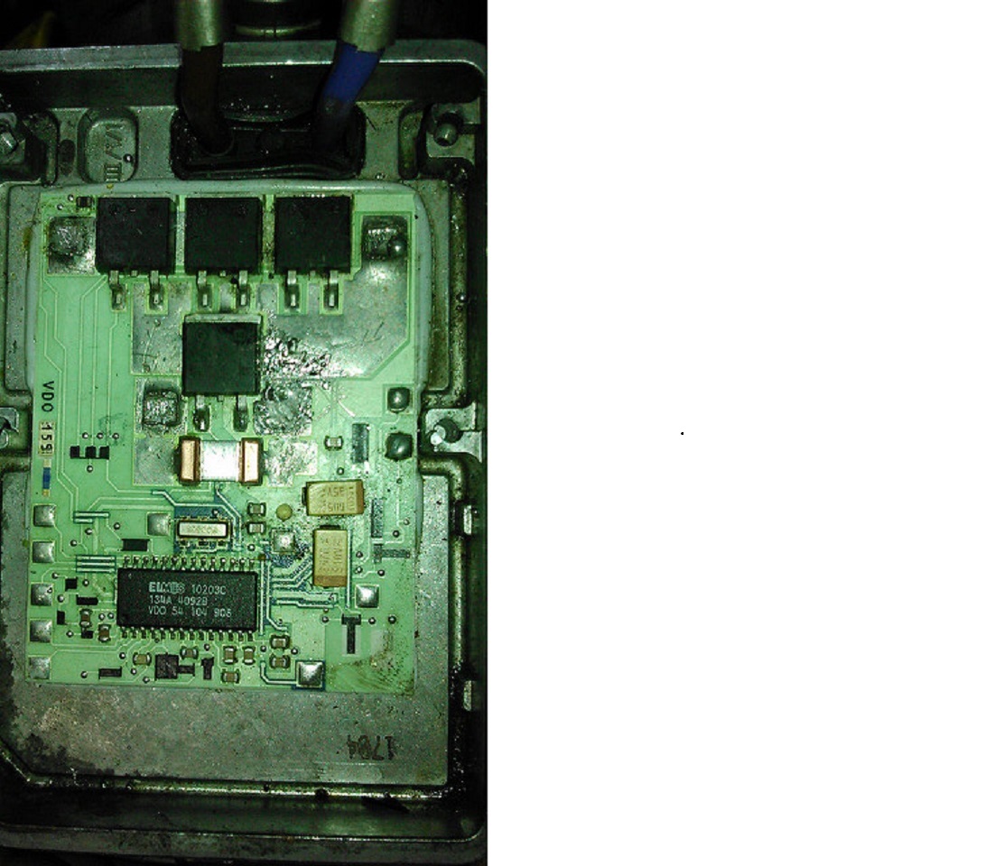

                  I am trying to repair an electronic (sensorless) power steering pump.
                  It was continuously running after ignition switched off and drained the car battery. Battery good-around 11.8v(now recharged, alternator good- outputting around 13.8v.
                  Replaced 2 of the 4 MOSFETs BUK7608-55A (one showed signs of 'blowing', the other shorted between gate,drain and source.
                  Now it just keeps stopping and starting, 3-4 sec intervals.
                  The sensorless i.c which drives the motor (Elmos 10203C 28-pin) is presumably the culprit for shutting down the motor but to be honest I am not really sure what to check now. other than a few smd caps and resistors there isn't anything to test.
                  The pump takes battery feed and grounds to chassis and alternator output which acts as an 'on/off switch', pump only runs when the car is running.
                  If anyone can help please let me know though I know this site isn't really for car repairs so understand if no replies of advice.

                    Photo of the pcb (taken from the web).
