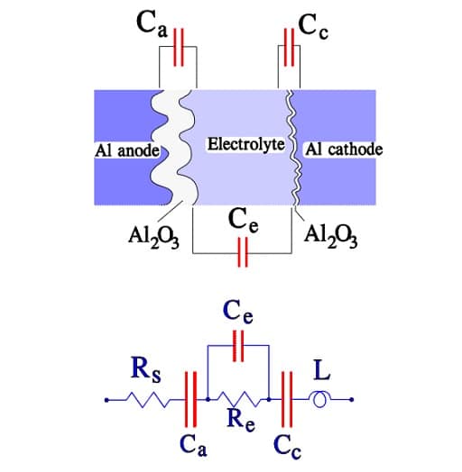

      Bipolar electrolytic construction I thought is the usual two-foil but with symmetrical etching? Ref. 3.1.8 https://epci.eu/capacitors-electrolytic-capacitors/
      They behave like two back to back series-connected electrolytics but have a problem if the capacitance or leakage current is not matched between the two sections.
      If there is imbalance, one capacitor can see reverse or over voltage which leads to its demise.
      So I'm skeptical you can reform one side without damaging the other.

          Usually, bipolar electrolytics are intended to be used intermittently, unlike film/oil caps. this is mainly due to them usually having higher ESR. Remember that they're simply back-to-back electrolytics, with either the anode or cathode internally merged, like Redwire's post shows.
          They use large canned bipolar electrolytics in induction motor starters because of the following:
          * they're cheaper than film/oil for the same capacity, at the cost of higher ESR (hence heat, then they pop if ran too long), but;
          * start capacitors are usually connected ONLY when the motor is spooling up (i.e. not at operating RPM), so if everything like the centrifugal switch is working properly, the motor will not use the starter cap when running properly. Refrigerator, freezer, air conditioner compressors are a common example use of this. Some of them may use a starter winding with a similar setup instead of a starter cap.

              You could reform it from an AC source then, just use a resistor to limit the current.
              This is the way I reform caps anyway: no need to limit the voltage (as long as you don't exceed the voltage rating of the resistor).
