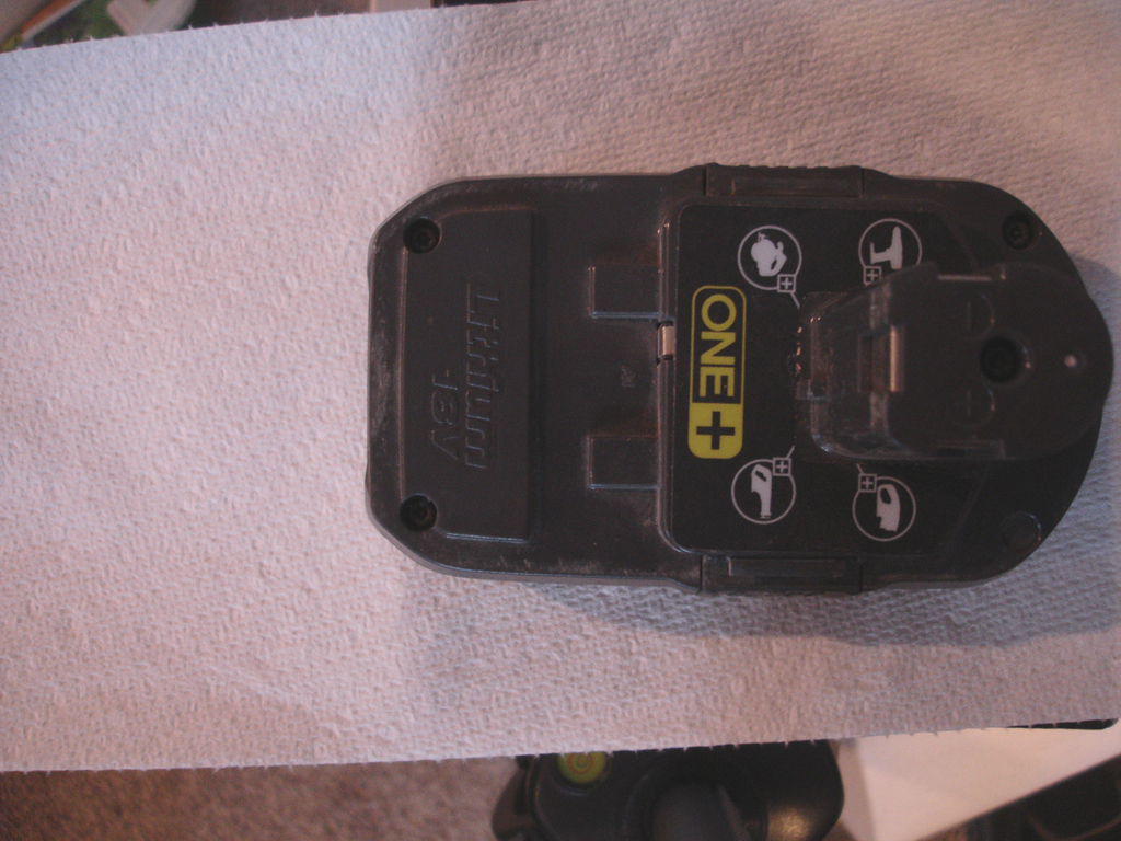

                    I have the following possible power sources available to me. Please comment.
                    Dell 19.5v Laptop Charger: CON: To connect to breadboard I will need to stuff the inner opening with copper wire and attach a ground wire to the outer surface. I don't want to remove the end piece (makes the thing unusable as a laptop charger). Also this is a 3-wire cable. End pice is 7.5mm, a non-standard size.
                    HP 32v/16v Printer power supply. PRO: Will work for 25 watt caps, Don't need to remove end piece, just insert wires directly into it. CON: output amps are 720Ma and 610 Ma. Is this a problem?
                    Respironics power supply. PRO: The end piece is a standard 5.5mm size. I could connect it to a standard socket.
                    Ryobi battery. PRO: Direct current, no ripple. !8 volt CON: Output Amps too high?
                    I might also consider using a Buck converter availabe for $30CAD which I could attach to the HP power supply above. I would then only need a dozen of the 1KOhm resistors/

                      Current will not be an issue, generally speaking, since you will have the series resistor(s) with the cap(s) to limit current (which is the whole point of reforming the caps, as that will make the voltage rise slowly across them.)
                      So both the Dell 19.5V and the HP 32/16V chargers will probably work fine. However, for 6.3V, 10V, and 16V caps, you will also need to make a voltage divider before the series resistor(s) so that the voltage is lower. Otherwise, if you use any of the above supplies on let's say 6.3V caps or 10V caps, there's a good chance you'll still damage them even with the series resistor(s) in place, because the supply voltage is too high.
                      Thus, either connect some kind of a circuit with which you can adjust the voltage from these power adapters *or* do similar to what I showed in post #2 with a voltage divider circuit using some resistors as a crude way to get the voltages needed.

                        While I'm not exactly an expert, I would say that of every single option you shared with us, the Dell 19.5v Laptop Charger is the one that is definitely going to work as a great power source.

                          Agree. I think that the Dell 19.5v Laptop Charger will definitely get the job done in the best way possible.
