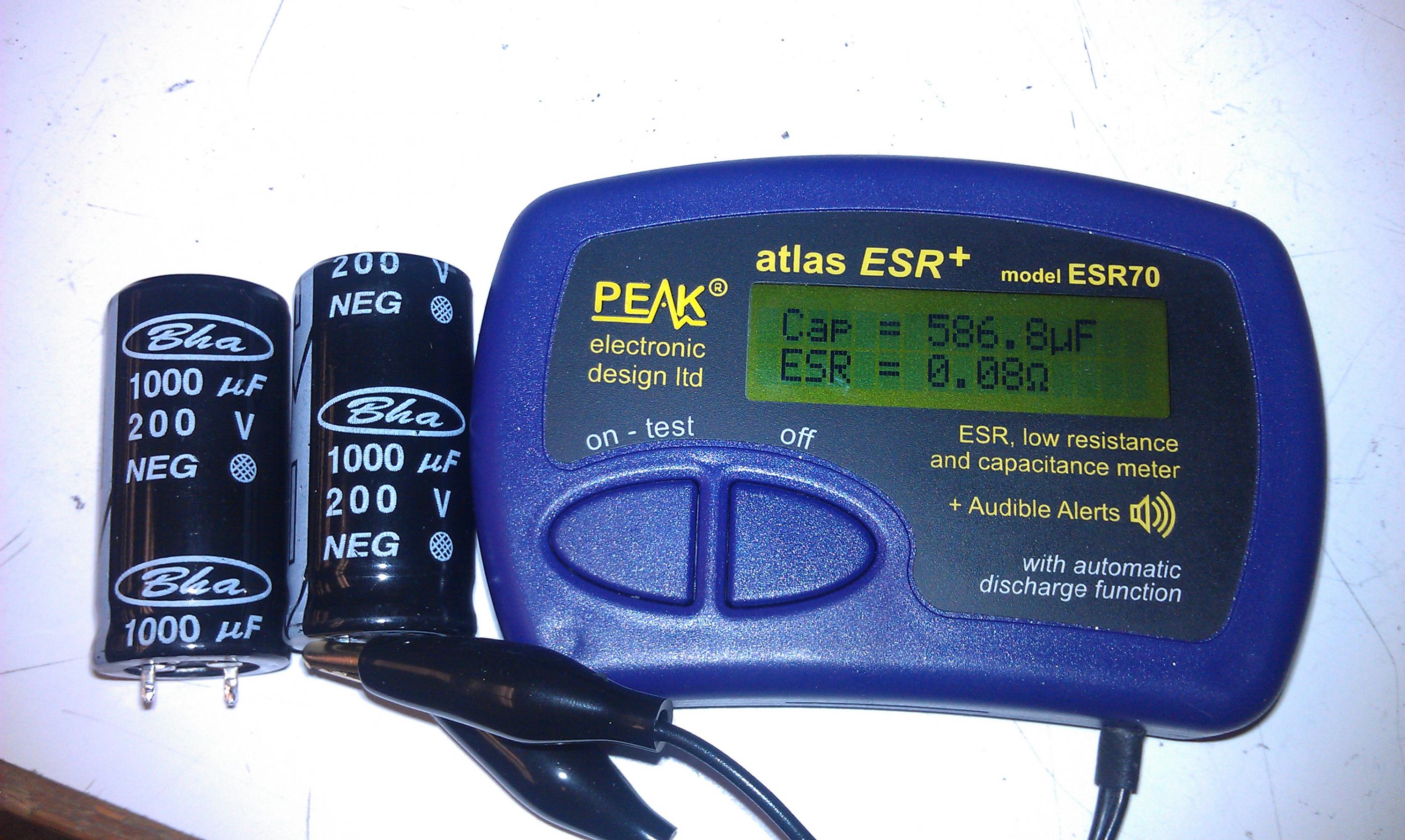

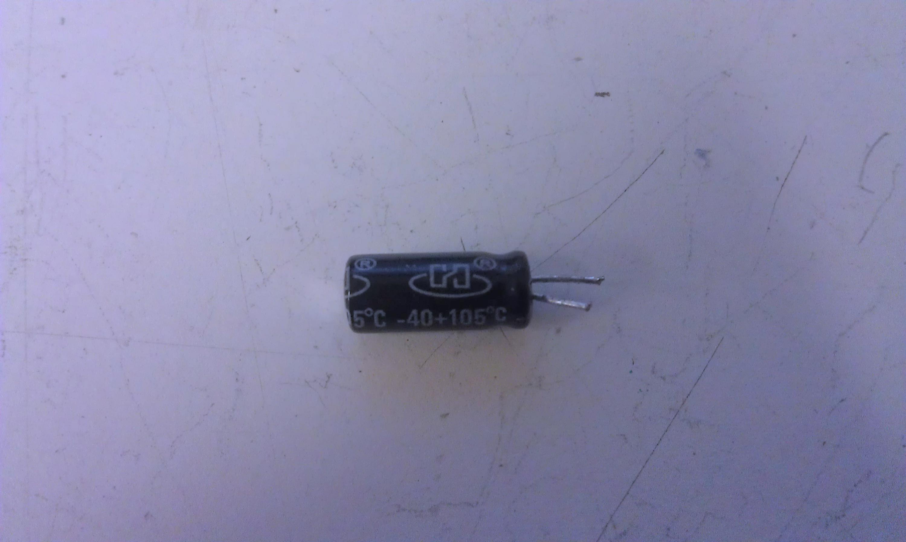

          I've never seen any of these brands before....and they ALL came out of a Topower PSU.
          1. Bha (Hmm, they don't seem to be 1000uF!)
          2. Huahong
          3. WKXC
          4. Changzhou Huayue
          5. OIFA
          6. SW
          7. TREC (It was sitting high off the board and was on the 5VSB filtering...)
          Anyone see any of these before?

            Last one in your pictures looks more like PEC ... the WKPC may be emulating the Samwha logo? Anyway, those that say CD110 are your basic Chinese crap.. that CD### is some kind of Chinese standard of capacitors.

              Sounds like it's good to go then! Did you bring those caps with you so you could measure their ESR?
              Could be
              Yeah, it does look similar with the tilted oval. or it could be poor manufacturing?
              I was curious about that, what is the CD supposed to mean? I've only seen that on BH capacitors (Or I just don't pay close enough attention)
                Bha in Chinese must be the English equivalent of Meh.
                So when they made them, they were like, Bha, who cares they're not 1000 uF.

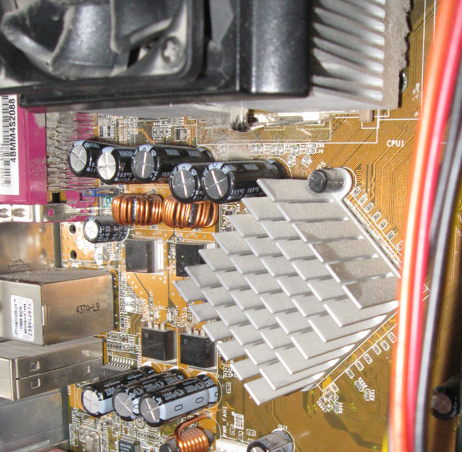

                      Had to bring to my place my sister's computer.. she's saving money for a laptop (while paying bank loans for apartment and other crap) so she still has an old Socket A system.
                      The secondary Maxtor 40 GB drive developed bad sectors, throwing loads of errors and making windows painfully slow... a 8 GB partition basically unreadable by windows... now moving at a painstaking 500KB-1MB/s data to my computer.
                      But then I had a look at the motherboard so I guess I'll have to fix it as well .. though I'm not sure if it's worth the cost of the capacitors.
                      click to zoom
                      Yeah, a bunch of KZG capacitors a bit swollen.
                      ps. Yeah, this board is a 5v design... 3300uF 6.3v everywhere.
                      May have to check the psu as well, i'm seeing fluctuating 4.98-5.02v on 5v, 12.5v on the 12v rail. May be just the low load on 12v (basically just cpu fan and two hard drives), may be a bigger problem. The PSU is a cheapo 400w "Premier" psu, these are typically equipped with CS capacitors.
                        It's worth it IMO. S462 motherboards are still usable for basic stuff. Moreover, those motherboards use leaded solder. The fact that the socket is through-hole and not SMD makes the motherboard even more bulletproof.
                        The Premiere PSU - probably standard Deer/L&C/Allied/Solytech garbage. Since its wattage rating is quite high, I'm willing to bet it's one of those extra-extra gutless craps from the L&C line. You know, the ones with very small heat sinks, big hot-running load resistors, missing PI coils, underrated schottky rectifiers, and undersized capacitors.

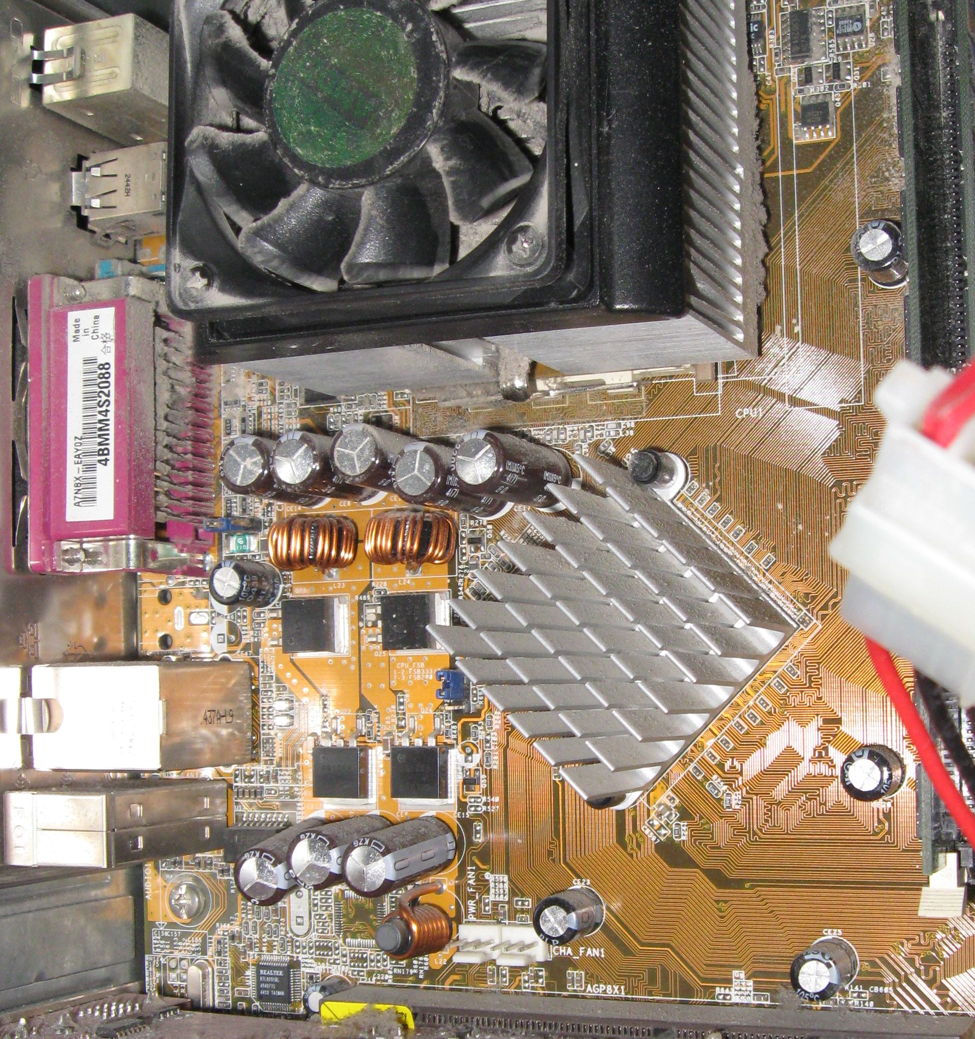

                          Followup on the motherboard above. Replaced the 8 KZG 3300/6.3v with Nichicon HM 3300/6.3v
                          The KZG caps were worse than i though, the bungs were stretched quite a lot as the pictures show ... the measurements were
                          1/5 3451/0.01
                          2/5 1536/0.06
                          3/5 0427/0.44
                          4/5 3542/0.02
                          5/5 3389/0.05
                          1/3 334/1.70
                          2/3 403/1.58
                          3/3 840/0.99
                          So far, the motherboard works fine, but I'm a bit concerned about the replacement capacitors, the pads were so tiny on this motherboard that I'm worried I may have performed a poor solder join on one or two capacitors of the eight. I couldn't risk adding a lot of solder because there's really extremely small space between the negative lead and the positive copper fill around the leads.
                          Either way, it can't be worse than before.

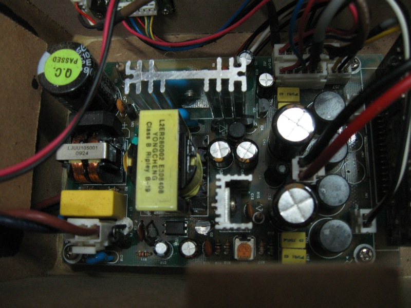

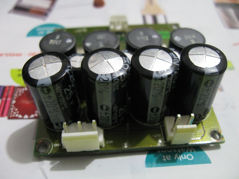

                            Another day, another speaker system. This time its a Krator NB-16220 mutimedia 2.1 speaker system. The subwoofer amplifier board has 4 badcaps, and possibly the first time I've seen the brand "VLSOM" (and the power supply side has capacitors with the brand "RSCon", again first time I've seen this brand and can't find any information on this particular brand). Those pictures speak for themselves. Already replaced them with Panasonic HD series capacitors. Pretty impressive bass from these speakers...

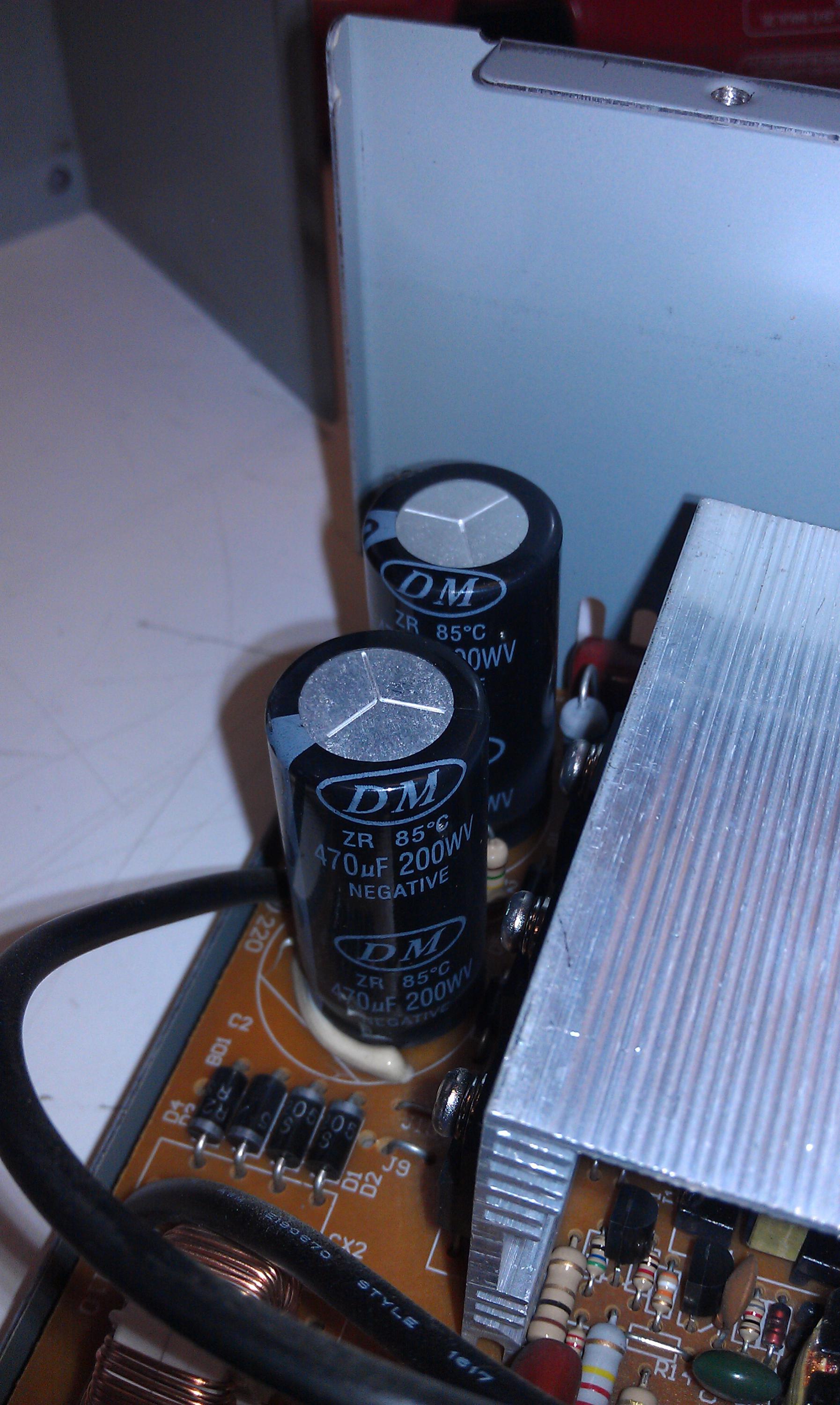

                                      DM primary caps from unknown OEM PSU made in May, 2003.
                                        Re: The Hall of Shame - Badcaps Photo Montage
                                        My old DVD recorder had one of those in it. I think it still had good capacitance (it was a 100uF 400V cap).
