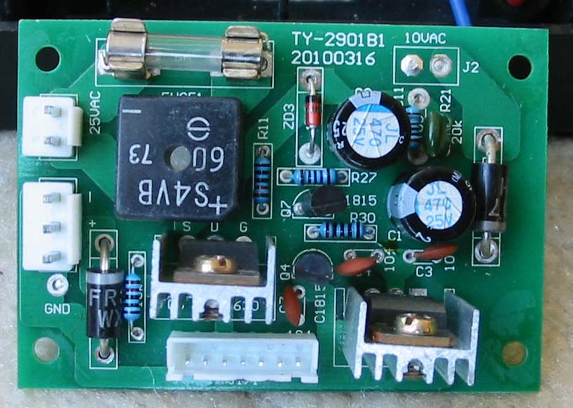

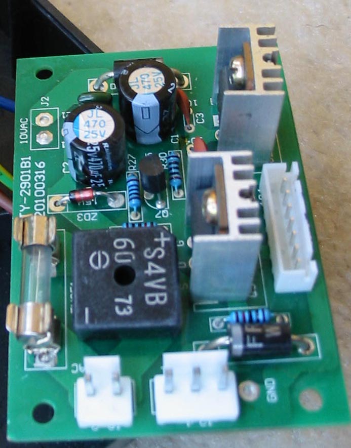

              #506
              Re: The Hall of Shame - Badcaps Photo Montage
              My Aoyue 2900 digital soldering station has fake 25V 470 uF Rubycon ZL caps. It's really funny, because the caps under the sleeve are sleevless caps with markings on the top. I don't know how to explain it better. I guess I will take some pics when I get back home for winter break.
              Surprisingly, they haven't bulged yet, and that station is almost 2 years old now and has seen quite a bit of use (and a little bit of abuse - not by me - like being left ON overnight many times).

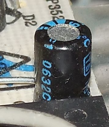

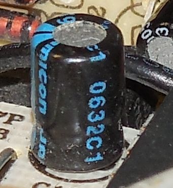

                      #510

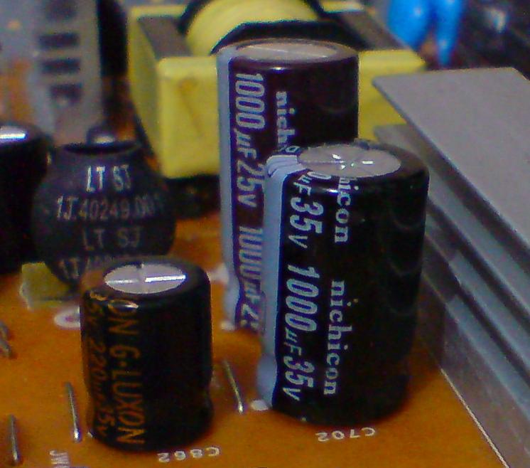

                      Originally posted by kc8adu
                      Originally posted by Pentium4
                      With the Teapo vent stamp
                      Had one of these actually, which I used it only for testing (whenever I ran out of capacitors with appropriate values and ratings). Found it in the local market, just bought it for fun...
                      See the attached pictures (taken quite some time ago). Next to the fake Nichicon (1000uF 35V) is a real Nichicon (1000uF 25V, much taller one) Those used G-Luxon capacitors (pulled out of Creative sound dock for re-capping) were still good, also used temporarily for testing only (will not use them for actual repairs). These capacitors were tested on a BenQ FP222W power supply board (which was brought back to life after testing)...

                        #511
                        Hmm, I wonder if they're actual Teapo caps with a nichicon sleeve or if they just forged the stamp. Either way, shouldn't be used on hot power boards. Unless testing

                          #512
                          Originally posted by ben7
                          Don't tease us, we need pics! :P
                          And finally I got around to it...
                          Here are two obviously fake Rubycon ZL caps found in a Circuit Specialists CSI 2900 soldering station (a rebardge Aoyue 2900):
                          https://www.badcaps.net/forum/attach...1&d=1388365550
                          Sorry for not providing any pics of the bungs. I was in a rush and decided to leave the caps in the station since they are only doing general purpose duty, filtering 60 Hz ripple. I doubt they will cause a problem, anyways.

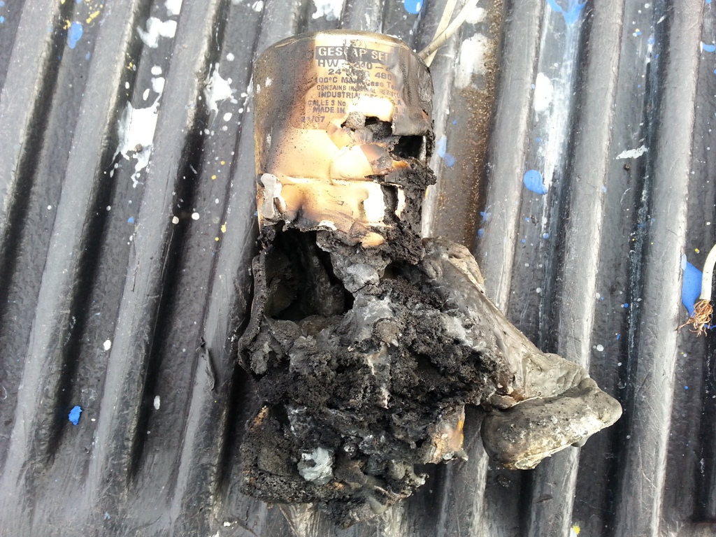

                            Working on 45-foot high 1000Watt metal halide pole lights today. Glass lens completely fogged and smoke-covered. It could be seen from the ground. We opened up the fixture and this is what remained of a 24uF, 480Volt plastic-can electrolytic cap...... Not much smoke left to release!
                            Stupidity should be a crime, especially for drivers. I have NO patience for them.
                              You sure it is an electrolytic? I think those are usually film capacitors used in that kind of environment. I doubt an electrolytic would melt like that!
                                Ben7 - This particular one was a plastic-canned dry film capacitor, part of a Sola-branded ballast kit installed in '09. This was the most-spectacular failure I have seen except for one that had a nearby lightning strike. That one had a complete melt-down. Copper splatter and no windings left
                                FWIW, The Sylvania version of this kit is identical to this kit except for the label on the ballast core. Capacitor is the same one, same inline factory-installed crimp/heatshrink setup.
                                The Philips/Advance kits use an oil-filled cap, usually by Aerovox. I looked up the specs for the Aerovox and they have a 60,000 hour rating.
                                The fixtures in this particular shopping mall are 480 or 208 volt. The original ballast kits are single-tap 480-only with GE caps from '97-98 and 90% have been replaced. We were replacing complete kits but have found a reliable source of the Aerovox caps at $20 each instead of $120 for a kit just because the caps has gone out of spec. The caps are rated for +/- 3% before they are considered bad. No ESR readings for these caps needed. Under spec is how they fail, low light output and short lamp life. We check them every time a lamp is replaced due to they height and access issues.
                                  Amazing!
                                  I bet this is what GSC/Sacon/Evercon and CapXon all aspire to achieve .

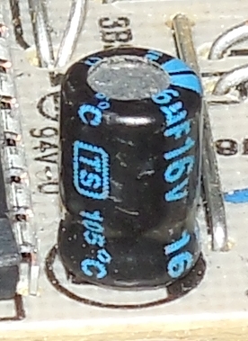

                                    #517

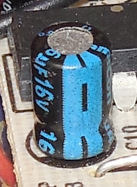

                                    Fake blue printed Jamicon TS 16v,16uF,105°
                                    - from original power supply FSP ATX350-PNF (FORTRON)
                                    - confirmed by JAMICON
                                    • japlytic
                                      • Oct 2005
                                      • 2086
                                      #518
                                      I've never heard about Jamicon TS Series - it doesn't even appear on the chart at www.icd-sales.com (Jamicon distributor).
                                      • zuhr14
                                        • Dec 2013
                                        • 23
                                        • Antarktis
                                        #519
                                        Yes, TS series of Jamicon caps really never existed. This is not any discontinued series. Only fake manufacturer, who use their brand

                                          #520
                                          16uF?!!!!
                                          WTF
                                          I've seen a few 15uF, but never a 16uF...!
