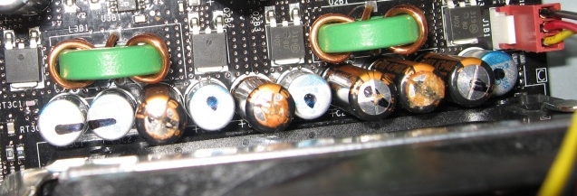

    Hi:
    I have an Intel D865PERL motherboard which is not booting any longer. It is out of warranty. So, intel is not accepting it for RMA.
    When I power on the computer, fans, motherboard light, power LED all turn on. However, TV output does not come. There is no beep, no post.
    I first thought bios could be damaged. I tried to do bios recovery but computer can't access to the floppy drive. Interesting thing is that boot damages the floppy. So, I am not sure if the problem is just capacitors. I tried to do USB and CD recovery but they did not work either.
    After I turn on the PC, led on the DVD drive comes on, but then I can't eject the tray. I can't use the power or reboot switches.
    I took the video card and memories out and there was still no beep. So, it looks like motherboard can't reach to that stage.
    I took out the battery out and put back. That did not help either.
    I lifted the motherboard to see if there is any short circut, that did not work either.
    I have another board. I moved the components to that motherboard and everything worked. I moved the things from that motherboard to this one and they did not. So, my conclusion is the motherboard is bad.
    I looked at the motherboard. It is very clean. I see no damage, no burn. Except the capacitors at the back of the CPU. There are 5 capacitors, there is a brown residue at the top and the top of them are popped up. And, that part of the motherboard smells more acidic. I attached the picture of the caps. These are bad capacitors right? They have X
    at the top of them. There are two more capacitors look similar on the other side with K on them and they look fine.
    I searched the internet and I found that this problem is common in D865PERL motherboards.
    Now, I am thinking to replace the caps. However, I am hesitating that even if I replace
    the capacitors, motherboard may not work. I do not have any soldering tool. So, I would be wasting money.
    What is your feeling? Do you think only capacitors are bad? What bothers me is that if I put a floppy into drive, floppy is damaged. Also, my DVD drive locks up. With bad capacitors do you get these symptoms?
    Thanks.

    those are bad.
    iirc intel was replacing badcaps boards for a while no questions asked .
    maybe talk to someone else at intel?
    if not i would replace those and any others like it on the board.

        really all you need to recap are new caps and a basic soldering iron (plus a little know-how). Where do you live? I could recap it for you if you don't want to mess with doing it yourself. I might even have some spare caps of the right type here, what are the voltage and uF ratings?
        As far as the floppy disks getting damaged, that could just be a fault of the drive itself. They certainly aren't bulletproof things that's for sure.

          I did not take the caps out. But, I think they are Nichicon HN(M) 6.3V 820uF A0315 105C.
          They are 8mm wide, 20mm long.

              Usually there is no voltage between 6.3v and 12v in a typical PC. So it does not mater if you take an 6.3 or 10v cap.
              As long as the high dos not interfere with any components, it is not critical.
              The more important thing is the diameter, which should be maintained, as the lead-wire spacing depends on it.

                  Height doesn't matter, as long as it fits.
                  Height would matter if say you were replacing capacitors around a pci slot and the caps were too tall and hit your video card or something like that.
                  Here is a good caps list... https://www.badcaps.net/forum//showthread.php?t=2280
                  Personally I would replace them with Panasonic FM caps from digikey.com . Though you could also contact Topcat, the proprietor of this website, and he can supply you with whatever you need.
                  You will want to replace all the caps of the type that are failing, even if they aren't bulging. Also, you would be smart to open up your power supply and check for bad caps while you are at it.

                                Intel support not familiar with the issue?
                                ~~ Try again...
                                http://www.intel.com/cd/channel/rese...tes/193414.htm

                                  These were affected by the Nichicon HN and HM problems.
                                  Those are the only caps you should need to replace.

                                    HM is rated about like MBZ
                                    HN is rated about like MCZ.
                                    FM ESR/Ripple ratings are a step down from HM and MBZ, (although Intel probably over-killed the ratings because HN and HM were less expensive at the time).
