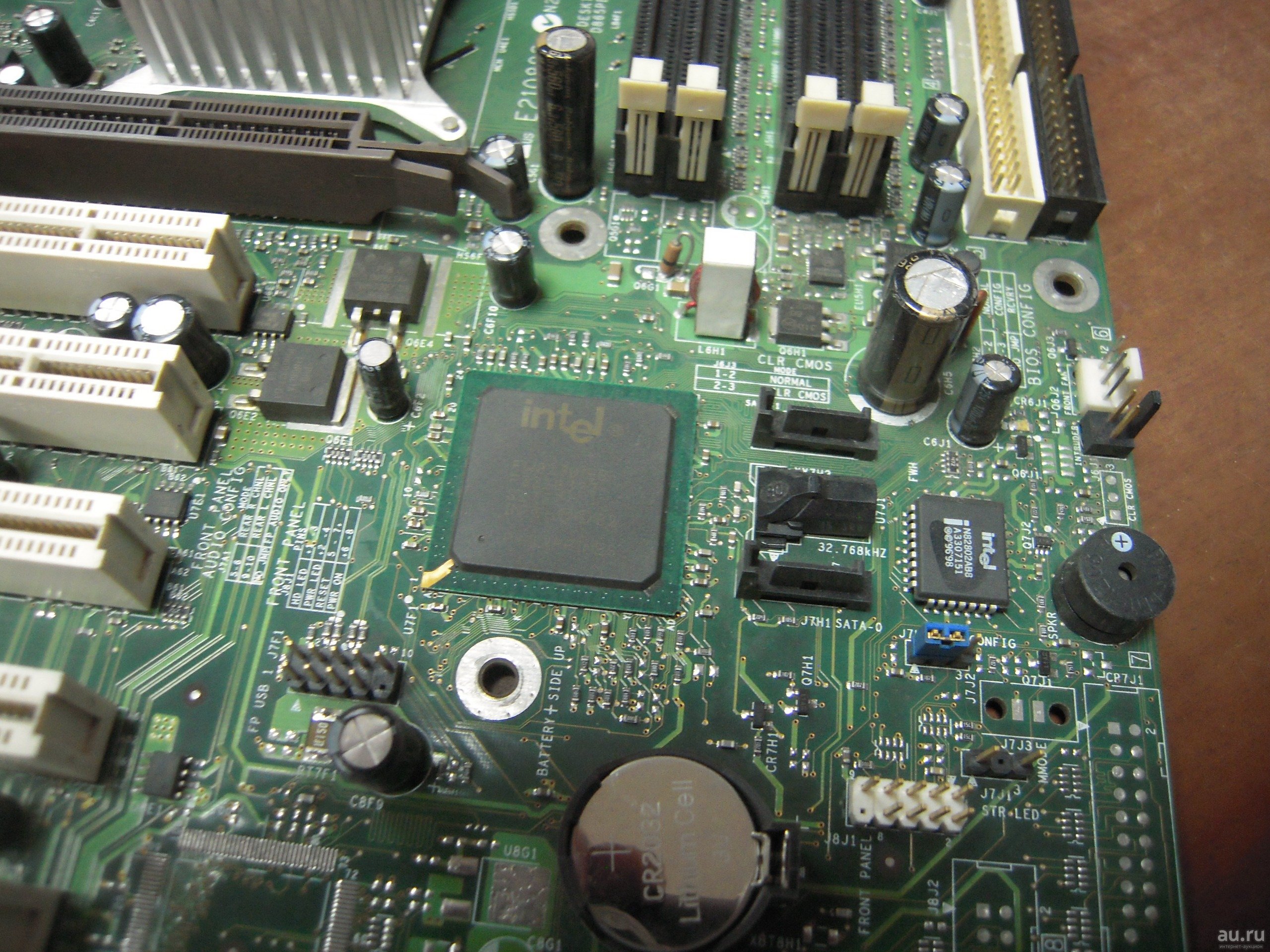

Can I substitute these capacitors on a D865PERL motherboard?
  • ribcage
    • Sep 2020
    • 43
    • Earth

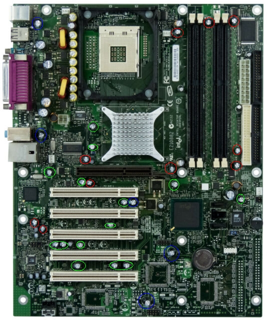

    Hello, I'm repairing an old Intel motherboard D865PERL and I wonder if I can substitute capacitors in this way:
    Nichicon VR(M) 470uF 10V 6.3x11mm B0341 85*C (red in picture)
    and
    Nichicon VR(M) 100uF 25V 6.3x11mm B0341 85*C (green in picture)
    with Suncon "low impedance" 330uF 6.3V 6.3x11mm 105*C
    Nichicon VR(M) 470uF 16V 8x11.5mm B0311 85*C (blue in picture)
    with Suncon "low impedance" 560uF 6.3V 8x11.5mm 105*C
    These are the most similar I can find of a reputable brand. I don't have much understanding but I have the impression that these small motherboard capacitors are never exposed to voltages higher than 5V? None of them are leaking or bulged but I did replace one Nichicon HM(M) that was bulged which solved numerous issues with the motherboard but I'm still having stability issues. That's why I'm considering replacing all the Nichicon capacitors on this board because they all have a similar production date (2003) and I've read about the faulty Nichicon capacitors back in the day.

    Re: Can I substitute these capacitors on a D865PERL motherboard?
    Nichicon VR is a general purpose capacitor (all 85°C caps are).
    It is therefore better to stay closer to the originals spec and just go up to 105°C temp rating.
    Panasonic NHG or Chemi-Con KMG would be better choices.
    Also the caps may be used on 12v circuits so do not downrate them without checking with a DMM first.
        I've used PW, HE, FC and FR as replacements for the GP caps on intel-oem boards.
        Most scattered around the board are tolerable if GP; the ones around/for the PLL, NB & DIMM slots should be low(er) impedance. Follow the traces. That board uses a switching converter for the RAM and(?) part of the chipset. This is located below and to the right of the DIMM slots.
        I've successfully substituted Panasonic FR for most caps on boards of this era, with exceptions for any switching converters. Looks like there are HMs for the VRM-in. You can replace with HZs, if you can get them. The yellow "functional polymers" on VRM out can be replaced with Nichicon LF/LE. VRM-out will have heavy power & GND planes, you need a good iron, preferably a solder station.

                I didn't explain it well, the PSU which overheated is dead so I changed it. Right now I'm using a crappy Lite-on 250W because the computer has only a single SSD for storage, no graphics card (headless), so it's not using much power. But I tried using a Corsair HX1050 (1050W) which is very good. Both PSUs have same results, random freezing. There was only one HM on this board, which I replaced with a Panasonic FM like I mentioned.
                Also like I said, I kind of can reproduce it with high network or disk activity. If I let it idle it seems to last much longer.
                Which ones are the VRM input? The four big ones (1200uF 16V KZE in my case)? Or the 10 smaller ones near the CPU (yellow Fujitsu polymers + 1 Rubycon MCZ)?

                      Originally posted by ribcage
                      The capacitors currently are small Nichicon VR and small Rubycon, two big Rubycon near RAM area, one big Rubycon near CPU alongside 9 yellow Fujitsu polymer, four big Chemicon KZE near the rear I/O panel.
                      The Chemicon KZE's near the I/O area are your CPU VRM input / VRM high-side caps. 16V, 1200 uF, if I had to guess. You can leave them, as KZE is known GOOD series. Might want to replace them only if you see the PCB area around them really darkened from heat.
                      The single Rubycon (MBZ series???) along with the 9 yellow Fujitsu FP caps are your CPU VRM output / VRM low-side (i.e. connected to CPU V_core.) Probably everything is OK there, unless kaboom can confirm that those Fujitsu FP caps fail.
                      The two big Rubycon caps near the RAM slots... MBZ series? If yes, you can probably leave them too.
                      It's the other small Nichicon VZ caps that kaboom and I mentioned above that you should replace first, as they are the most likely culprits.
                      That may be a clue.
                      Network and HDD activity go through the Southbridge. So I think that concurs with the above advice to change most caps around the RAM, NB, and SB areas, in addition to the caps around the hot-running TO-263 regulators.
                      Also, try this last test: use only one stick of RAM and see if issue persists. Make sure to try it with different RAM slots as well. Let us know what you get for the results on this test.

                          I should find/pull a hires image of this board and mark some of these caps for you, OP.

                            Currently halfway at replacing all the smaller 85*C caps to Panasonic FC and FR. It's not easy for me... If this won't help then I will replace VRM input to FR of very similar specs, except 1500uF, got them already.
                            Those two Rubycons near RAM are MCZ 560uF, 6.3V, 8x25mm. I can't even find them in the datasheet.
                            I'm quite sick of testing so I'll just recap for now. I tried three different sets of RAM, the simplest one being 2x256MB, single sided. Usually I run 4x1GB, all combinations yield same results.
                            The power supply that failed is KM KOREA GP-300ATX from 2003. It ran without a fan for almost a year so I think it's pretty well built. Did some dumb things trying to make the computer quieter, won't happen again. When it failed, I found the PC running but it was frozen. Wouldn't be surprised if those four KZE caps for VRM input were damaged.
                            The Lite-on PSU, when connected to an ungrounded wall socket, tingles when touched. Not painful but certainly uncomfy. Although I've often had tingles from PCs when I had ungrounded sockets. I measured ~100V from the PSU to ground, mains are 230V. I guess it's normal but still strange.
