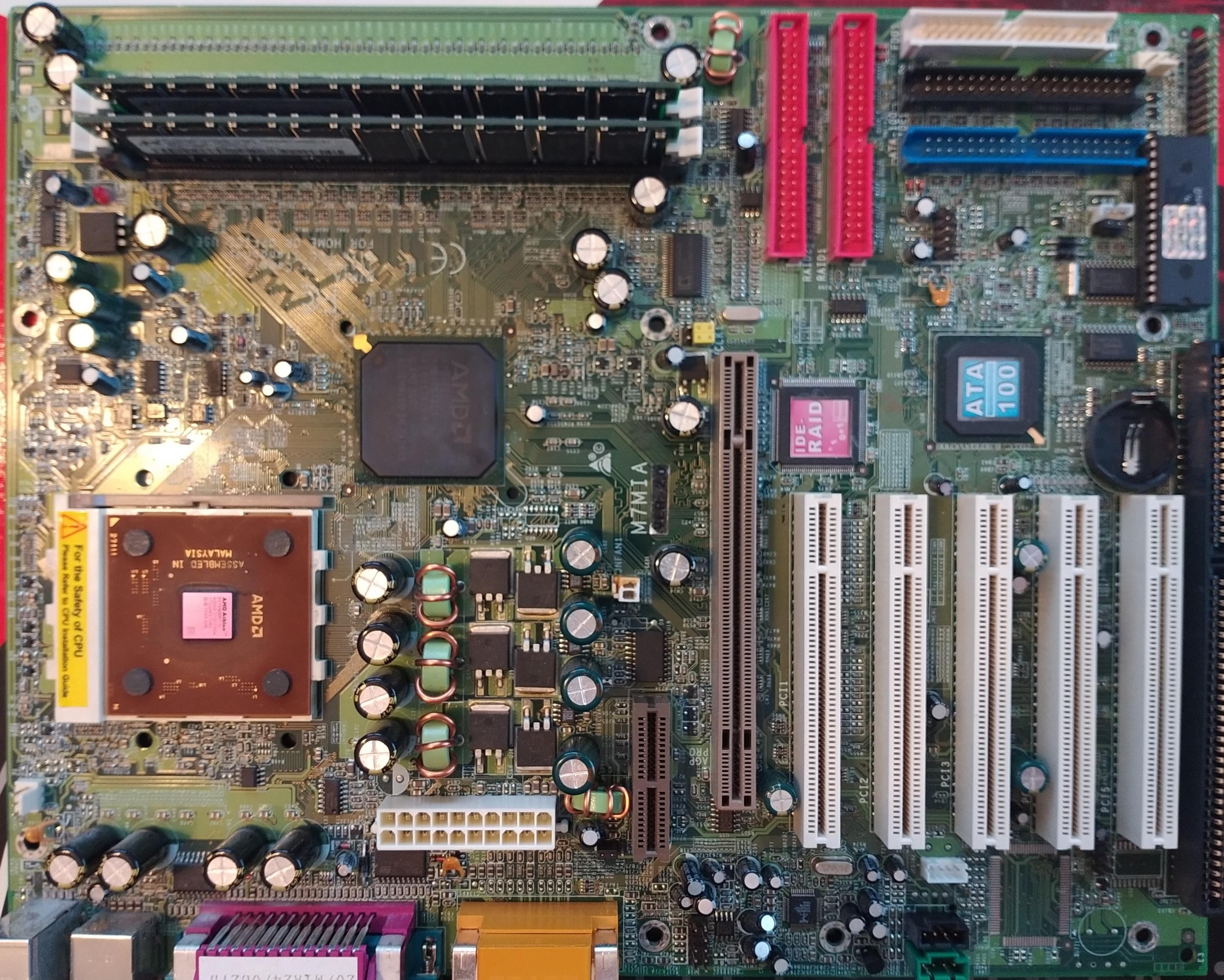

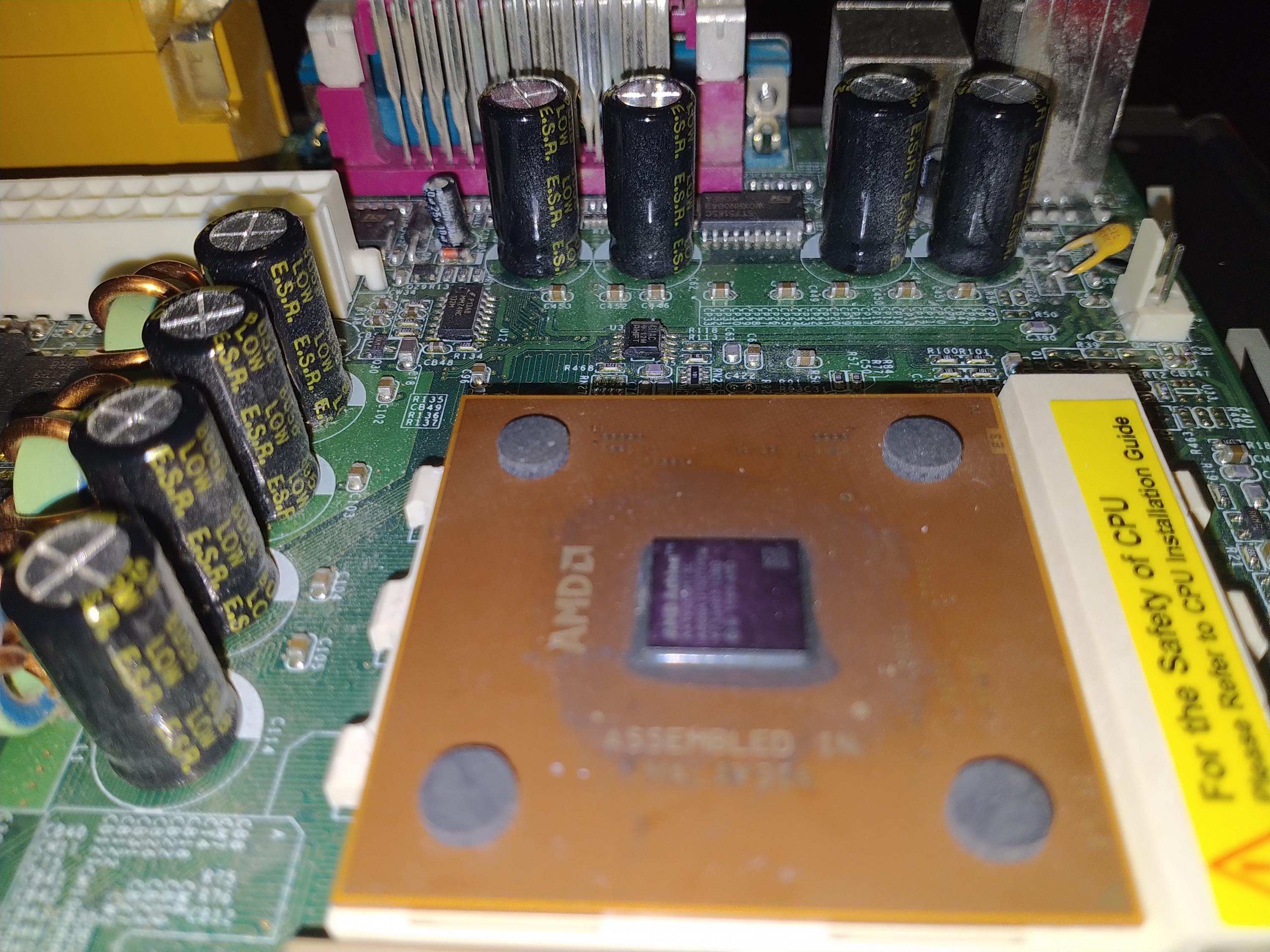

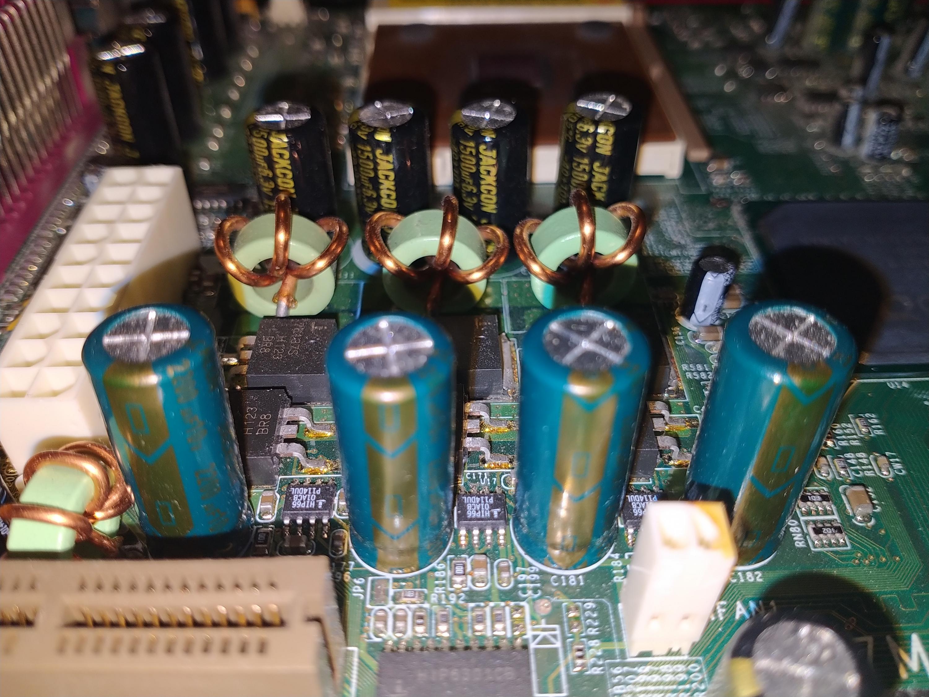

          here's an image of the board and closeups of the largest capacitors as best i could manage with the available light. the northbridge heatsink isn't missing--i scavenged it for the replacement system. i don't ever plan on putting the psu back into continued service, but i still have it and can take some photos of the internals tomorrow for the curious.
            • 31255
            Re: did bad capacitors kill my motherboard or prolonged exposure to faulty psu?
            "jackon" seriously?
            those need to go for a start!

                Appreciate it. Cool board too!
                Unfortunately, none of the cap brands look like anything I'd leave on there. Jackcon are fairly flakey. I can't tell the manufacturer of the green caps, but just by their sleeve color and vent, I can tell you they are not a known good Japanese brand.
                In any case... before you start (or think about) changing the capacitors, let's do some simple checks first.
                Start by resetting the CMOS first. Typically removing the CMOS battery will do it, but check your MB's manual - some boards may store CMOS settings on a flash, and the only way to reset such CMOS is through changing a jumper on the MB.
                After doing this, return CMOS reset jumper back to normal position and install a good CR2032 battery. Then fire up the board with minimum required hardware (i.e. CPU, CPU heatsink & paste, PS-ON switch, speaker/buzzer, and 1 RAM stick - in either slot or whichever one the manual requires for 1-stick operation.) Do this with a known good PSU and not the PSU that you were using up to this point.
                If the board still doesn't POST, try some different/various RAM sticks. Also a different video card too... or just remove and re-install the video card you had, just in case the contacts in the AGP slot have gotten oxidized. While at it, also release and reinstall the CPU a few times. Although rare, I've seen CPU pins catch slight corrosion on the surface that can make the PC not boot.
                If the board still doesn't POST after doing this, try removing all of the RAM from the MB and fire up the system again. Does the board beep an error code? If no, then that means it's not even getting to the point loading the BIOS/CMOS... at which point, I would suggest you try a recap. And if the board does beep without RAM but won't boot with any in the slot, then again it would be a good idea to do a recap.
                And of course, if the board POSTs after any of the above testing procedures, I would still advise a recap - at least for the caps around the CPU slot and the memory slots... well, just about everything in the upper half of the board above the AGP slot.

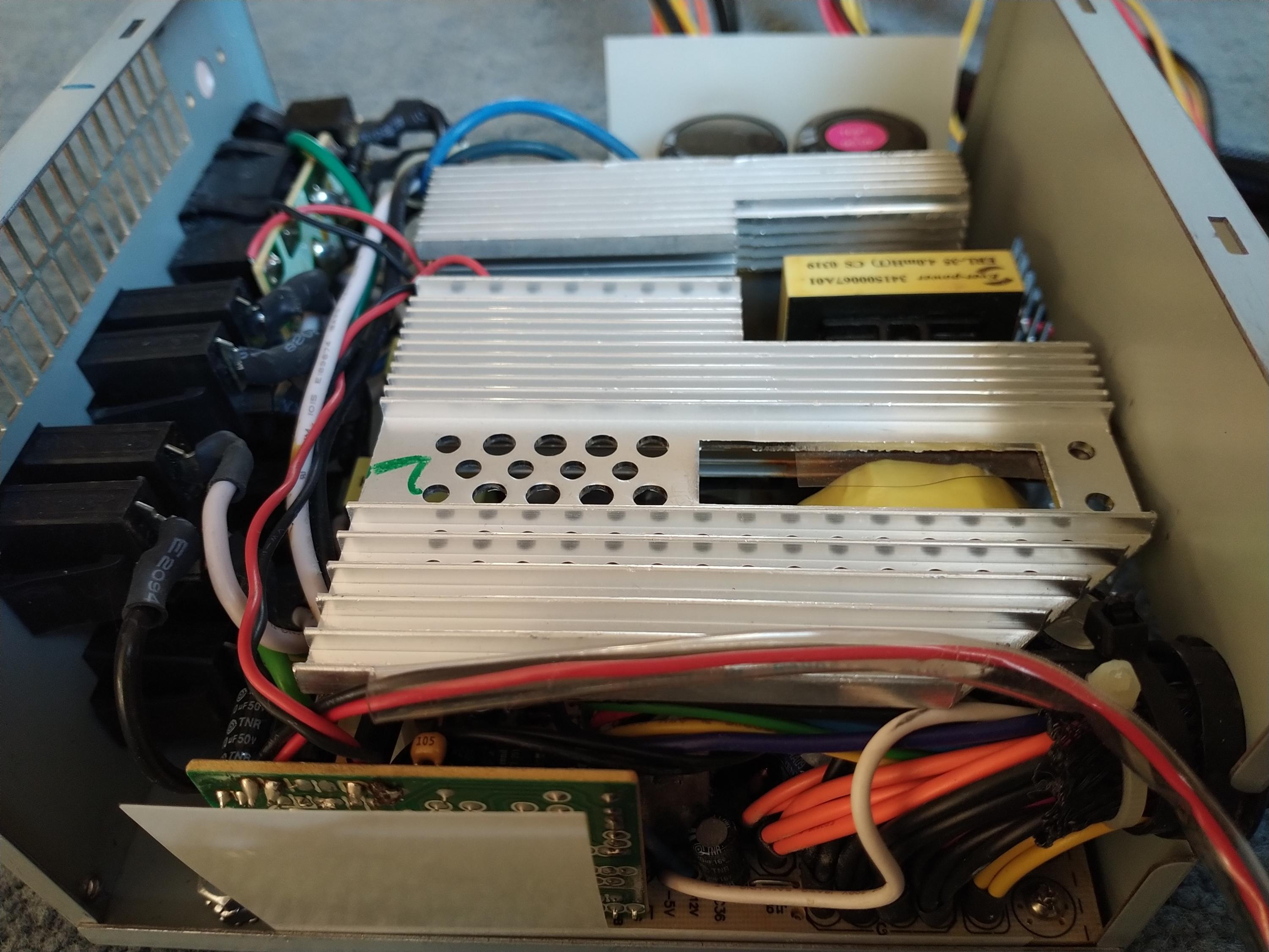

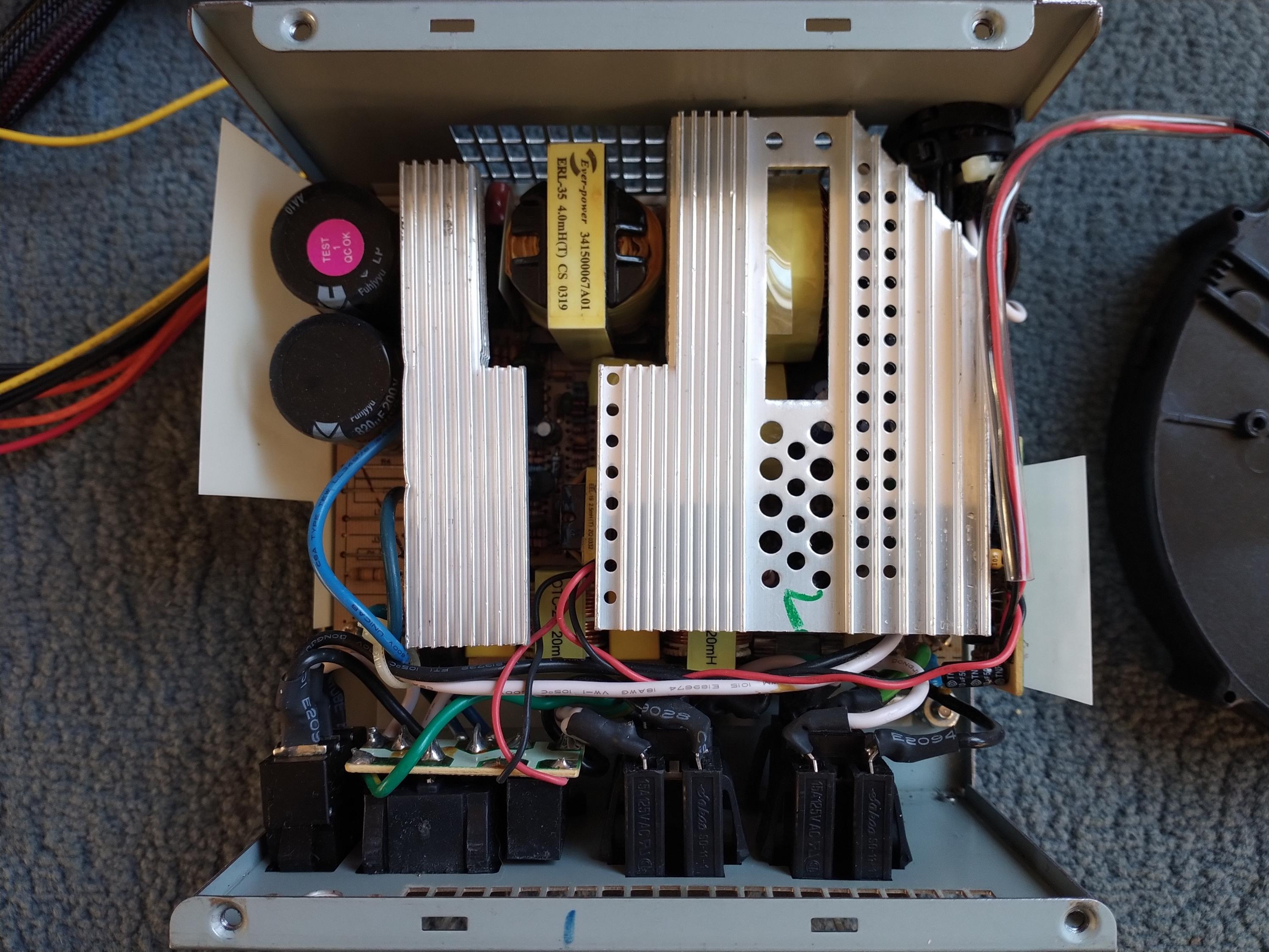

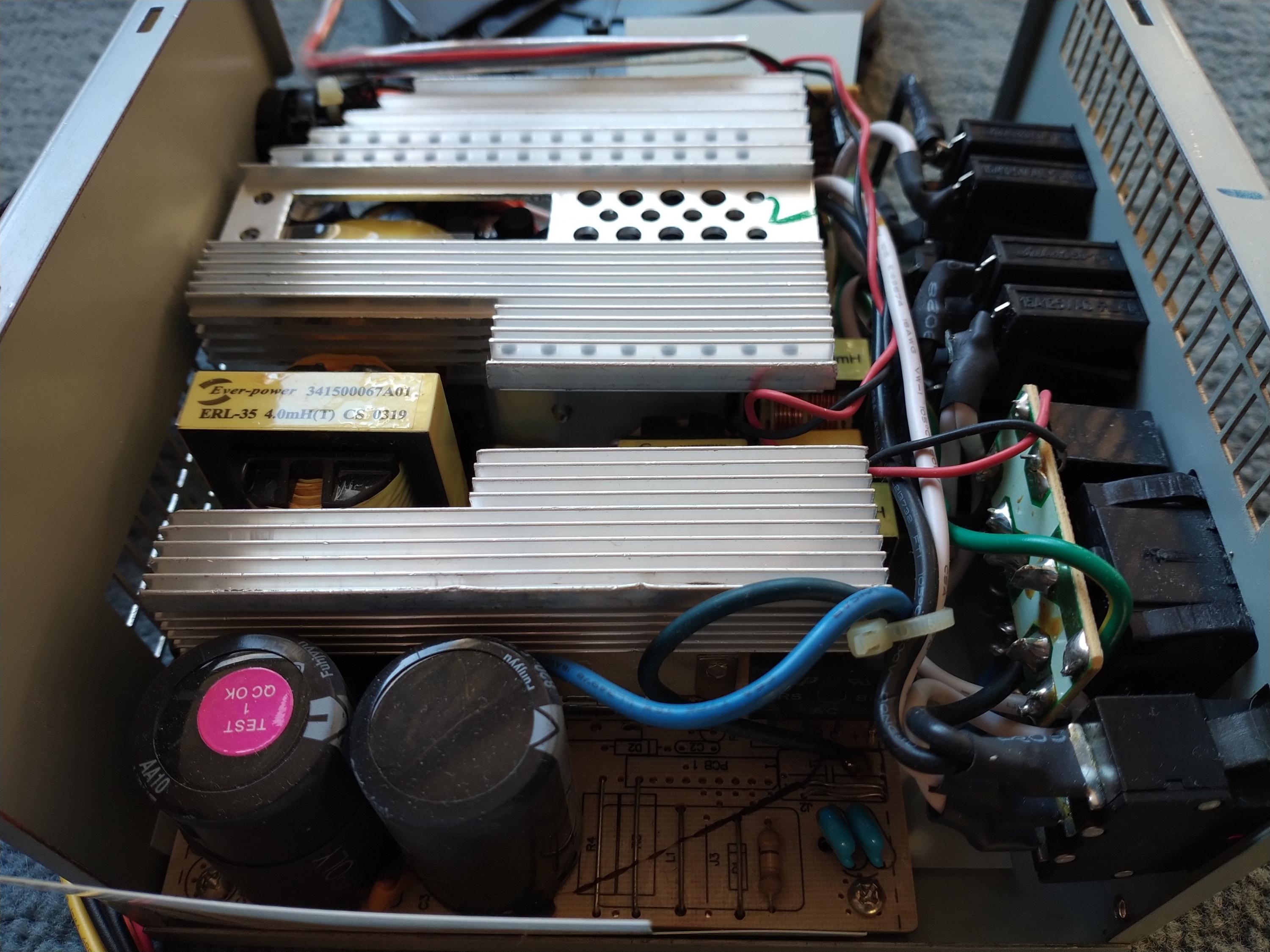

                          removed the cover and the psu internals are incredibly busy...would take considerably more disassembly to get a good look at everything. i took some photos, but i'm really not motivated to go further.
                          the cpu fan is a possibility to check. the iwill motherboard i transferred it over to reads 0 rpm on the cpu fan header, but i ran across some contemporary reports on iwill motherboards not detecting lower rpm fans so i didn't give it any more thought since mine runs low.
                            No problems.
                            Even this is more or less enough for us to get a clue.
                            This is a Topower PSU (as evident by the "Ever-power" text on the main transformer), which was a decent brand overall... though they no longer exist anymore.
                            I can see the primary capacitors are made by Fuhjyyu - a brand that is notorious for going bad. The secondary side also appears to have some Fuhjyyu caps in there. Thus, I wouldn't be surprised if the entire secondary side is done with Fuhjyyu caps. Because of that, the PSU is very likely due for a recap at this age, as Fuhjyyu caps rarely last this long (save for the 2 big caps on the primary - those are usually the only exception.)
                            I know the PSU is pretty crammed and may seem hard to take apart, but you really only need to remove the 4 screws on the corners of the PCB and untie the output wires from the case. After this, the PCB should lift up and out nicely. I can't see if the input wires are soldered to the PCB or connected with a connector... but that's usually the only thing that stops the PCB getting completely pulled out. Once pulled out, bend the output wires away and see how the output caps look. Maybe take a picture again, if you can. The PSU looks well-built, so it would be a shame to trash it.
