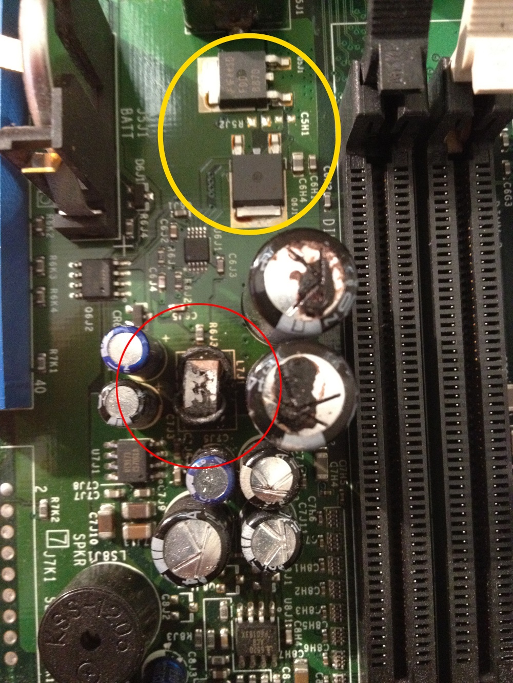

    So I think I'm going to send this board into the guys at badcaps.net, but just thought I'd post some info and get some thoughts on it.
    It's an old Dell XPS 600 that stopped working last year (I've replaced the computer since). However, I'd like to try to get this machine up and running again, as it wasn't a bad machine when actually working.
    When it stopped working, it would turn on with the fans blaring, but that's it. No POST, no nothing. Upon further investigation, I spotted a couple bad caps on the board, along with some other attachment next to these two. On the underside of that small other attachment, I see some slight burn marks on the board.
    Anyway, here's a couple pics...just thought I'd try to get some input/thoughts on this. Unfortunately, the damn Dell cases are so specialized that you can't just put in a new board, and of course, Dell doesn't have any more of these boards available (and because of this, these 5 year old boards still go for $400+ on eBay, which is crazy).
    http://ratlhead.com/mobo1.jpg (bad capacitors)
    http://ratlhead.com/mobo2.jpg (board info)
    http://ratlhead.com/mobo3.jpg (small attachment next to capacitors)
    Thanks guys!
    -Mike

    Well, well, well, it looks like you have busted rubycons, which is very unusual, since they are usually a vrey reliable brand. I think that coil must have cooked them.
    I had a similar issue on a gigabyte board at https://www.badcaps.net/forum/showth...ied+GA-8IPE775.
    It turned out that one of the MOSFETS had shorted, which is probably what caused the coil to burn up. I'd be checking the two parts I circled in yellow. If one is shorted, then that might explain why the coil burned up. Of course, you will also have to replace the coil and all 8 of the caps in that picture.

      That's a good place to start.
      Also trace the circuit the coil is in back to the ATX PSU connector looking for bad components or PCB traces that burned out due to excessive current.
      - The MOSFET is the more likely the -cause- of the problem, what I'm suggesting you check is more for collateral damages.

        Thanks for the replies guys. So I'm not much of a techy when it comes to mobo components/parts, but it sounds to me like you guys are suggesting this board may take more effort to repair than it's worth?
        I've seen a couple other threads on here now with the same board and same issue. From what I read, the 'inductor' next to the two blown capacitors will also need to be replaced. Is this something the guys at badcaps can do as well? MOSFETS too? I certainly am not skilled enough with a solder iron to do this repair work myself.
        I'm scared to think other components could have fried. Safe to assume the processor could be a victim? I know my hard drives survived...hope the RAM/video card as well, but won't know until I repair/replace this mobo.

          I've replaced the MOSFET's, caps, and the coil on a lot of these.....it revives maybe 25% of them. Not worth messing with, I won't even take them in for repair anymore. They were just a crap board.

              The parts affected are more likely for RAM or possibly PCI-E.
              Power comes from the large power connector.
              CPU power comes from the other power connector on the other side of the chipset from there and uses the MOSFETs located close to the CPU.
              - CPU isn't likely to be affected at all.
              This board is unusual because Dell went with an nVidia chipset.
              Many nVidia chipsets are defective and break. [It's complicated, covered elsewhere.]
              I avoid them in general so I dunno which are okay and which are junk. [I have to look it up every time.]

                I scavenged the coils off other junk boards, the FET's came from digikey (forgot the P/N, havent ordered any in a couple years), and the caps I have. I measured the inductance off a good coil with a Sencore LC102 (measures coils quite nicely), and then scavenged one off a crap board of similar size and within 20% of the original. They're easy to find.
                The ones that went deeper than the fets, coil, and caps, I have no idea what's wrong with them beyond that. I never dug deeper. Beyond that, they went in the trash or back to their owners.
                It's worth repairing, but the odds of actually making it work again are very slim....but certainly give it a shot if you want, you have nothing to lose and some interesting experience to gain (even if you fail).

                                    OCL: 0.18
                                    TOL: 20%
                                    DCR: 0.00145
                                    I rating: 18.00
                                    Hope this can help get you jump-started. I have smoked four of these boards myself. Good Luck!

                                      These are the pita of all boards to repair when they fail. They can be repaired but require so much time and effort finding the problems (most of the time its not the same problem per board) its not worth it.

                                        yes results are variable.
                                        i will get 6 that all live even though that area looks like hell.
                                        then i get a few that look decent but the nvidia is shot.
                                        the losers are the ones with nvidia plague.its hit and miss.some i fixed 4 years ago and still going 24/7 and some work awhile and the nvidia gives up.
