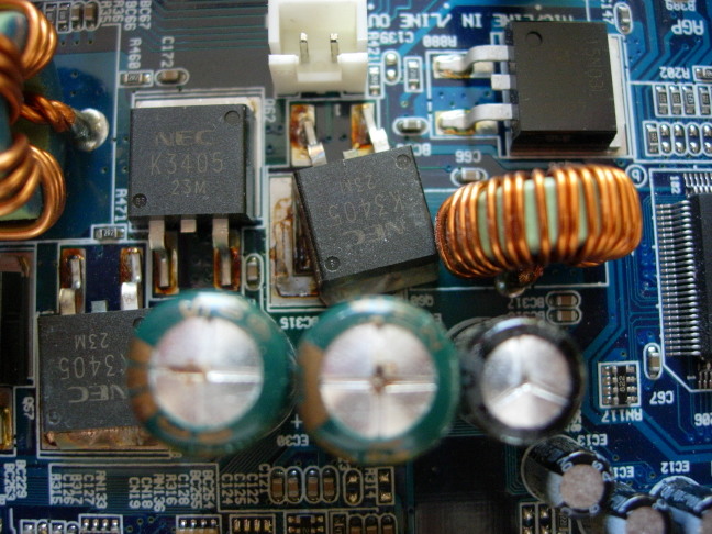

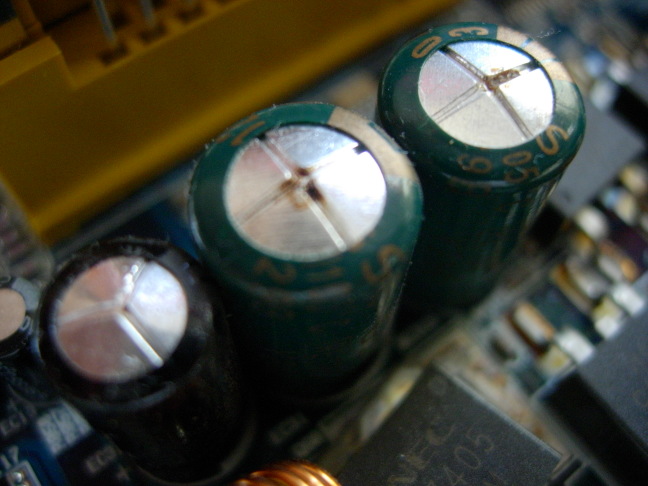

    I have a gigabyte GA-7VAXP motherboard which has bulging and leaking caps.
    It has been running OK. When I examined the motherboard, I found the bad caps, and also saw that several of the MOSFETs in the VR circuit had overheated and melted the solder onto the motherboard on their flat side - none are scorched or melted. I presume (but don't know for sure) that this was caused by the bad caps.
    I'm worried about a fire-hazard here. If I recap the motherboard, would the MOSFETs be OK and not further overheat?
    Should I replace the MOSFETs as well ? - I'm not sure how I would desolder the flat side of them from the motherboard if I had to replace them.
    If I should, and can replace them, can anyone recommend a source for the new MOSFETs ?

      Re: Would just recapping solve my problem - desoldered MOSFETs
      Here are the pictures:
      Bad MOSFET
      Blown Caps

        Ouch, you were VERY close to a disaster. The caps need to be replaced, of course. The MOSFET is probably not shorted if the board works so it only needs desoldering and soldering back to its place.

          i would replace the sliders and recap it.
          that board was really close to letting the smoke out.

              I would suspect the continued reliability of the MOSFET in centre picture. The temp melted solder, then rose higher due to a poor connection to the copper plane heat sink. The full part number is 2SK3405. It seems hard to obtain this device but STmicroelectronics offer a replacement (superior spec) to be found at Digikey part number 497-3515-1-ND at $1.95 single unit.
              here: http://www.digikey.com/scripts/dksea...t=STB75NH02LT4
                at what temperature the soder can melt? >100C?
                  It's above 200 degC. I'm surprised what can these MOSFETs survive.

                          i dont think recapping will fix your problem,
                          i dont think the failed caps caused the fets to overheat.
                          i think the over heated fets caused the caps to fail, if its hot enough to desolder itself, its way too hot for caps.
                          so it appears something else is the problem, and recapping and resoldering the fets is just setting yourself to fail again soon.

                            It is well known that bad caps will increase the duty cycle of an smps and could lead to severe dammage to the mosfets due to overheating. This could be easily seen e.g with ecs k7s5a and several of the older epox boards. So i don`t think that there is anything else the cause than bad caps. Any other short circuit condition would probably had exploded the mosfet and not let him slowly melting its solder.
                            It is clealry that the heat could dmaged the caps futher to an obvious degree, but i am shure that they had already bad esr values.

                                    The body of these MOSFETs is soldered to the board, not just the two pins, correct? I have one (same failed mosfet and caps) I want to try to repair.
                                      Yes, that is correct
                                      Quite allot of heat is necessary to desolder/solder them in place so it's good if you have something to practice on first...

                                        I would say before that MOSFET on the picture was like that when it was new.
                                        Transistor usually can not handle over 90C and solder melt around 260C BUT in this case temperature had to go over 330C. There is no way to resolder that FET with temperature under 300C because board is draining temperature.
                                        (unless you have 150W soldering station with fast tepmerature recovery)
