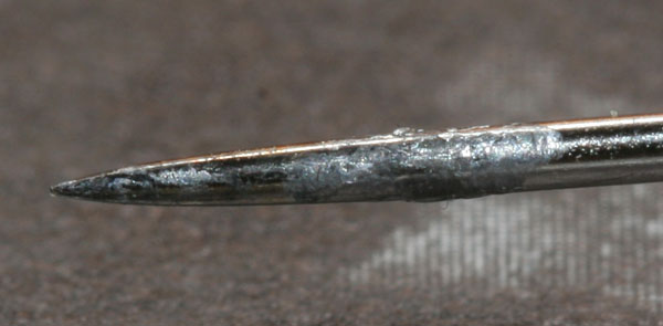

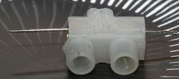

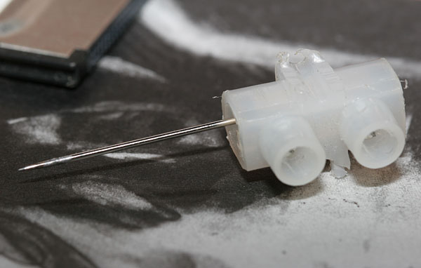

          Re: Hello There, Im new with a question
          Originally posted by willawake
          need dental pick or sewing needle.
          I've found that most sewing needles are nickel plated and will stick in the hole. By chance and some luck I discovered that sewing machine needles are usually made of stainless steel. I just cut off the top with the eye, and screwed it in a piece of electrical block. Works like a charm
          Sudum G

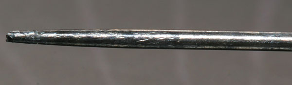

            interesting. i will check those out. does your needle remain completely clean? here is mine, i have used them a lot. milward brand, no idea what the plating is.
            this one i use the most, it is about the same size as a cap lead
              That looks good willawake. I use the stainless picks and I have a Stanley Tool screw driver kit, it has an awl in it that I also use, works pretty good. No pic to share though.

              • Sudum Gumudu
                • Sep 2005
                • 97
                Yes, my needle comes through completely clean. It's a sewing machine needle of the Falk brand. All the sewing needles I've tried has been sticking either directly, or after a few holes poked through.
                I've done some research, and even found a webpage done by a woman who has nickel allergy, and she complained of the impossible task of finding nickel free sewing needles.
                Sudum G
