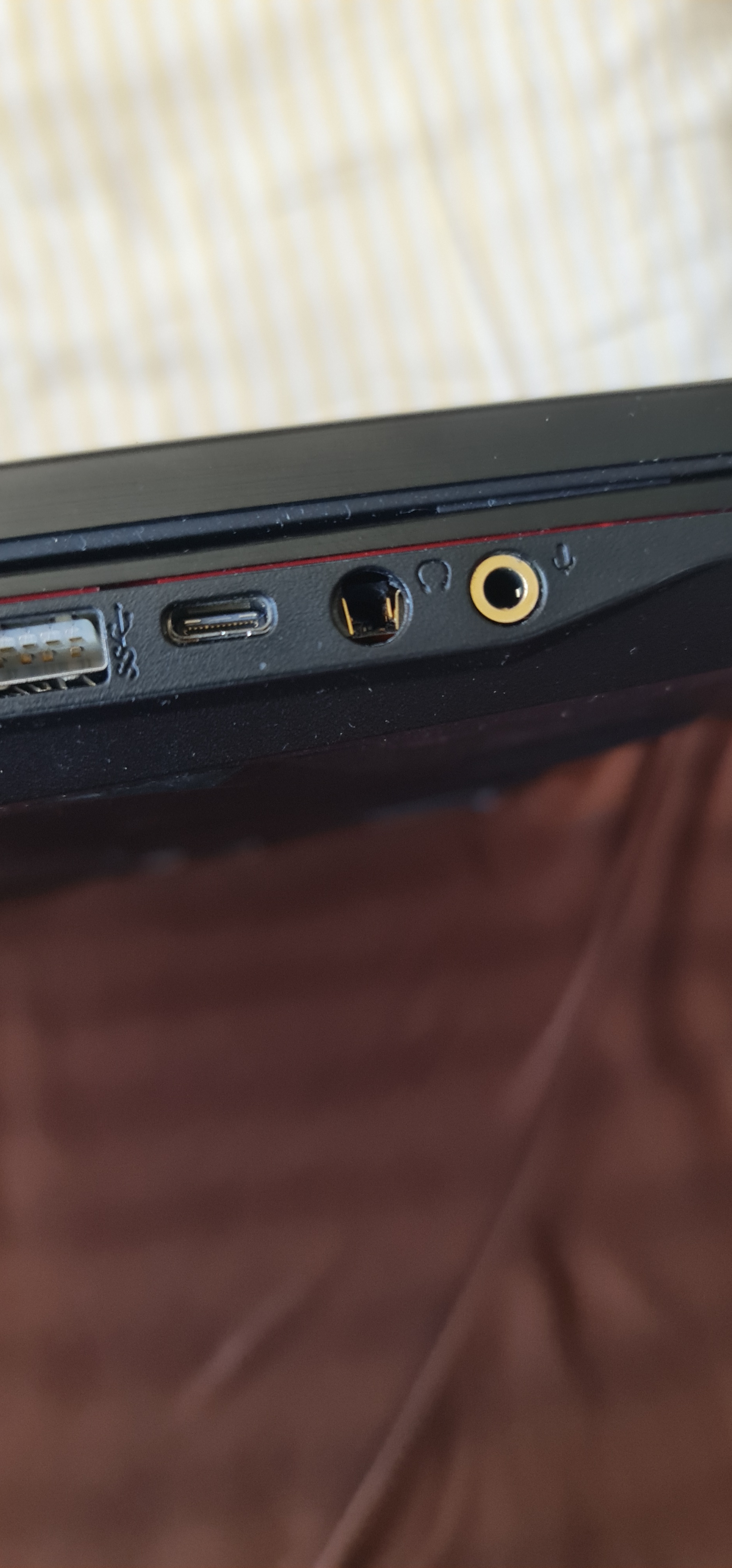

    Hi guys,
    I purchased used MSI GE 73 Raider laptop used from a guy.When laptop came home I noticed that there is no "golden circle connector" on the headphoner jack (pic below).
    I contacted the seller, he told me like it was there and it probably fell off.
    I am not dumb, is he lying to me or it is possible that in the shipping it really fell off?
    Oer laptop is missing whole connector.
    The headphone jack works normally,I have tested it with headphones.

    Okay, so I am probably missing 3.5 mm stereo hedphone jack inside I guess.
    Can it be replaced?
    Is it universal for all laptops or I need to search for this specific MSI one and solder with technician guy?

      There are several models of headphone jacks, you need to open the laptop to check if it's similar
      Yes, it needs to be soldered, you may ask your local laptop technician/repair shops, they may have a dead motherboard with the same connector as yours

        Has to be scrapped from same motherboard or mannufacturer (MSI)?

          From another MSI laptop motherboard i think, can be different model but uses the same audio jack, as long as the connector looks the same it should fit
          The one you linked above may be the same, check the motherboard first
