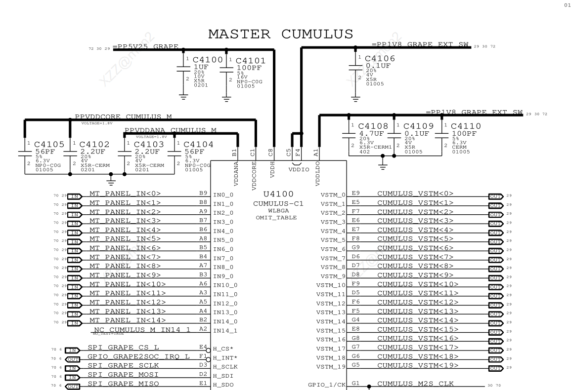

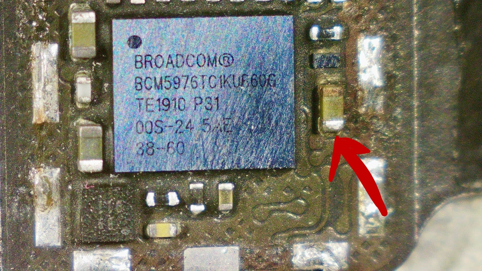

    Got this waterdamaged where oxidation happened under shield on touchbar cable. It showed image but no touch. After I cleaned and resoldered everything except ic (it is sealed anyway) i am getting touches however i find it a bit hit n miss where it works but sometimes missing dragging. Tapping seems fine. I think it might be something to do with this big cap which might be LDO or something. I placed 10v 2.2uF cap there. Anyone could measure it from good/dead touch bar lying around ?

    The same Broadcom controller (BCM5976 aka Cumulus) is present on assorted Apple products including the iPAD AIR 2.
    From the AIR 2 schematics, perhaps you can figure out the value of this mystery capacitor.
