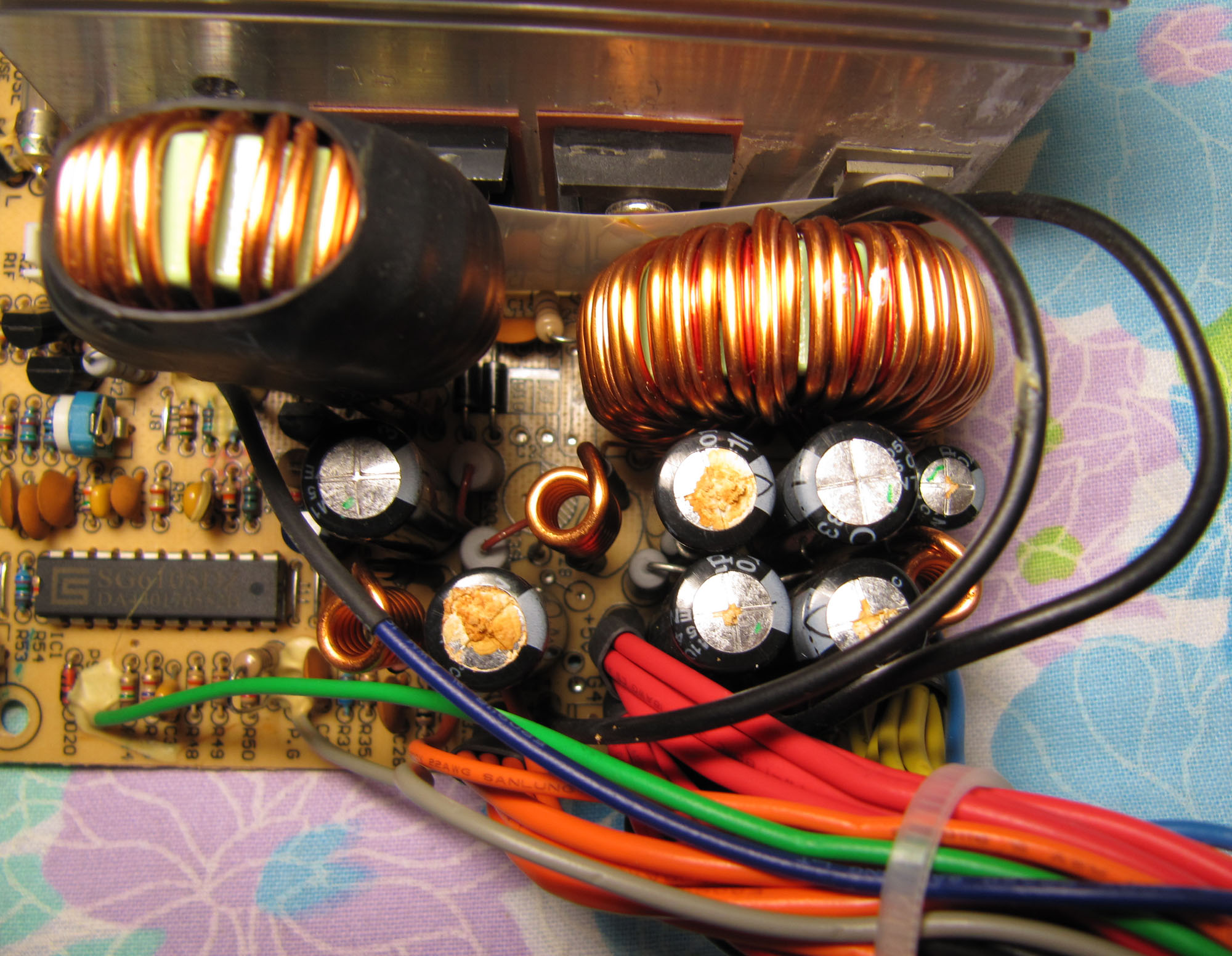

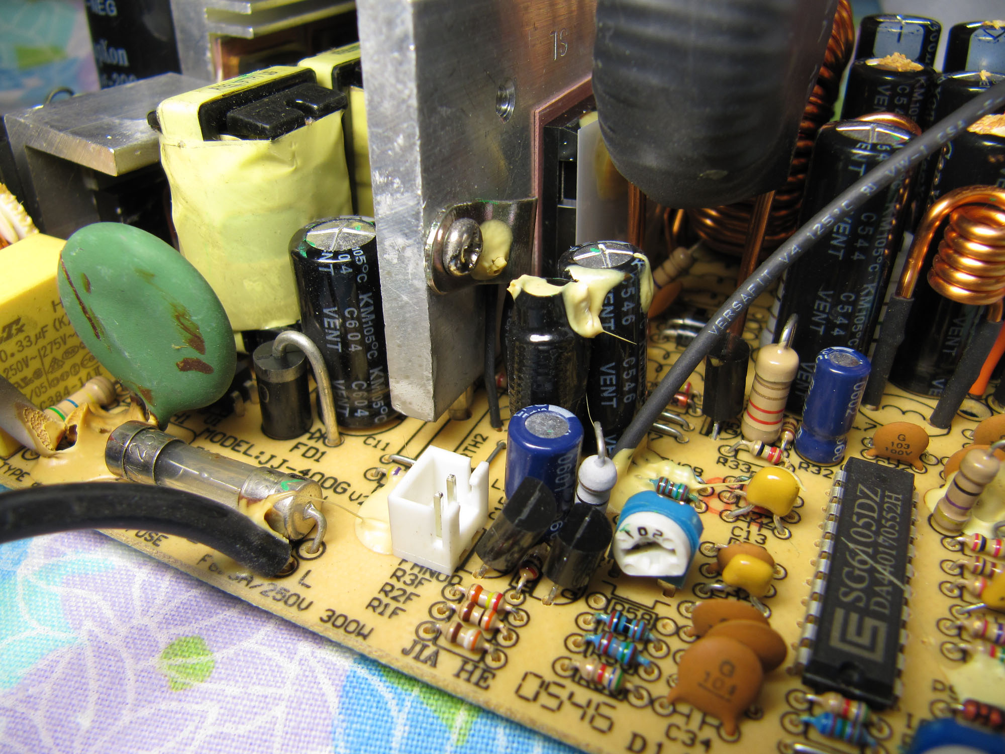

                      CapXon - very inconsistent quality. They do, however, consistently fail with visible signs in hot places, such as in LCD monitor power supplies.
                      - Good job, CapXon, at least your vents are working properly .
                      From my experience, their KM series seem to be just a bit more reliable, but those aren't low ESR.

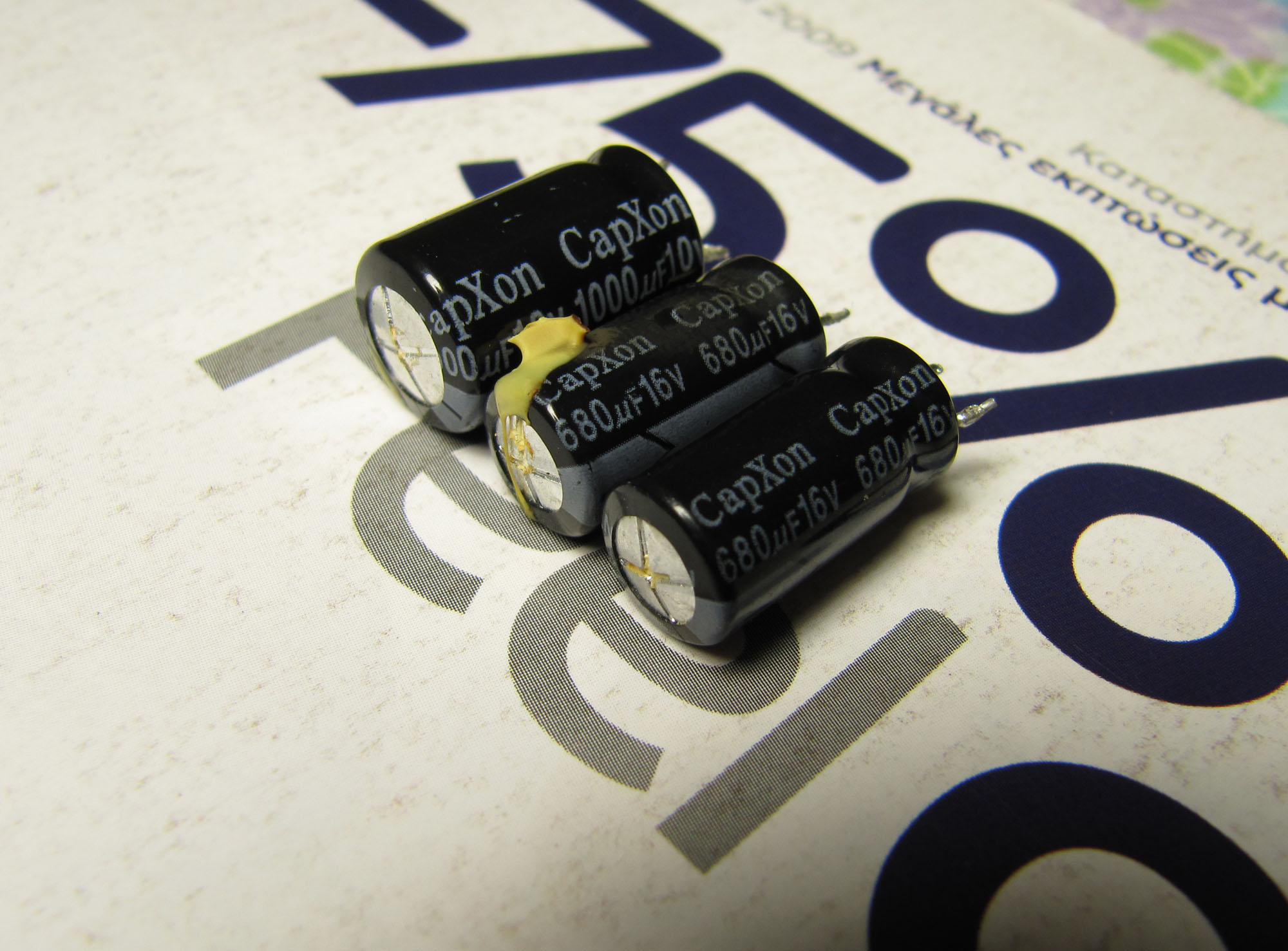

                                    Bulging Capxons, mostly KM
                                    Their only excuse is that they should not have been used at smps, as they are not low esr.
