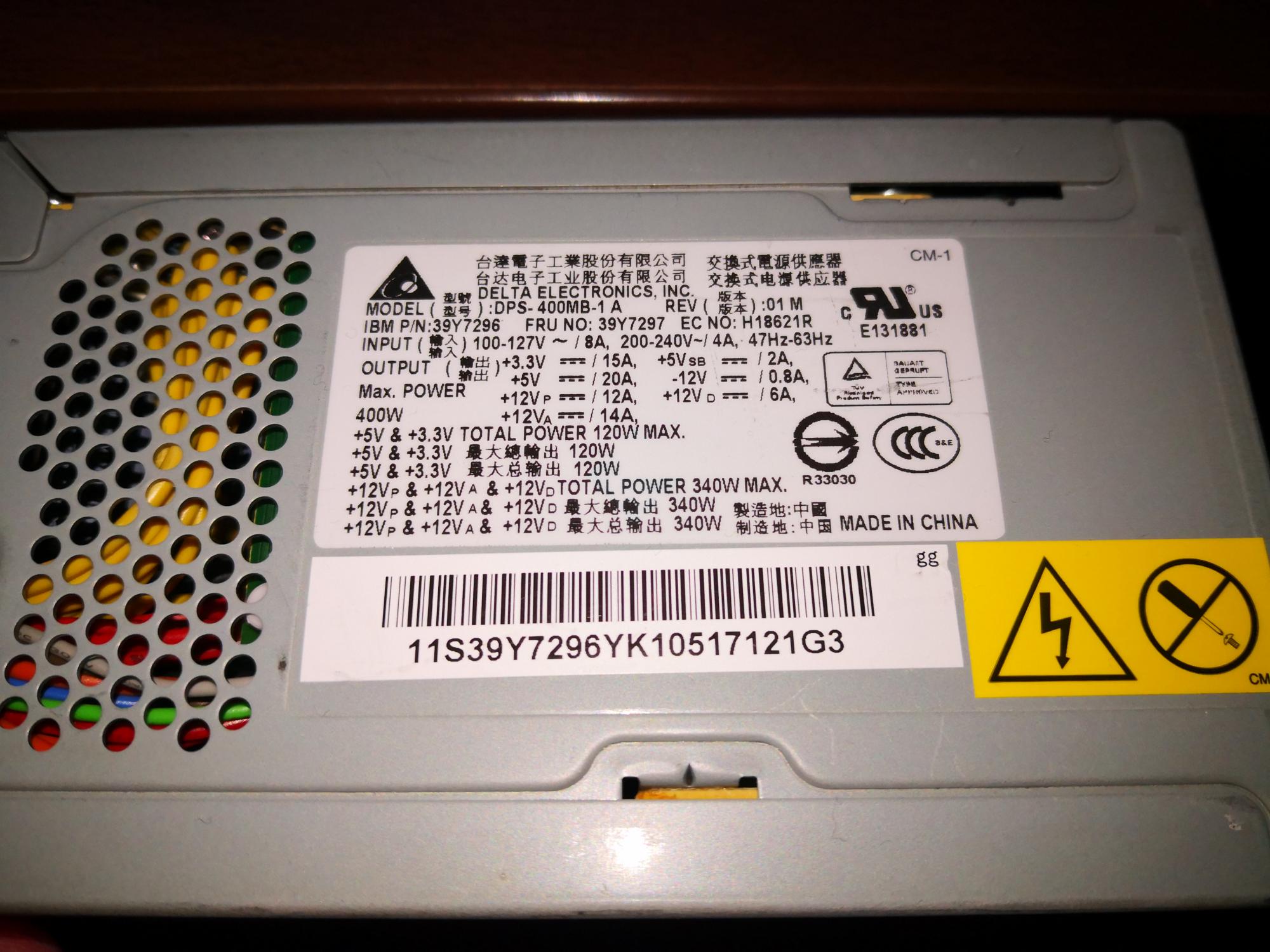

    I recently got this PSU to replace the 250W Delta unit in my "Retro-PC workhorse" - the rig that I'm using for testing most of my retro stuff.

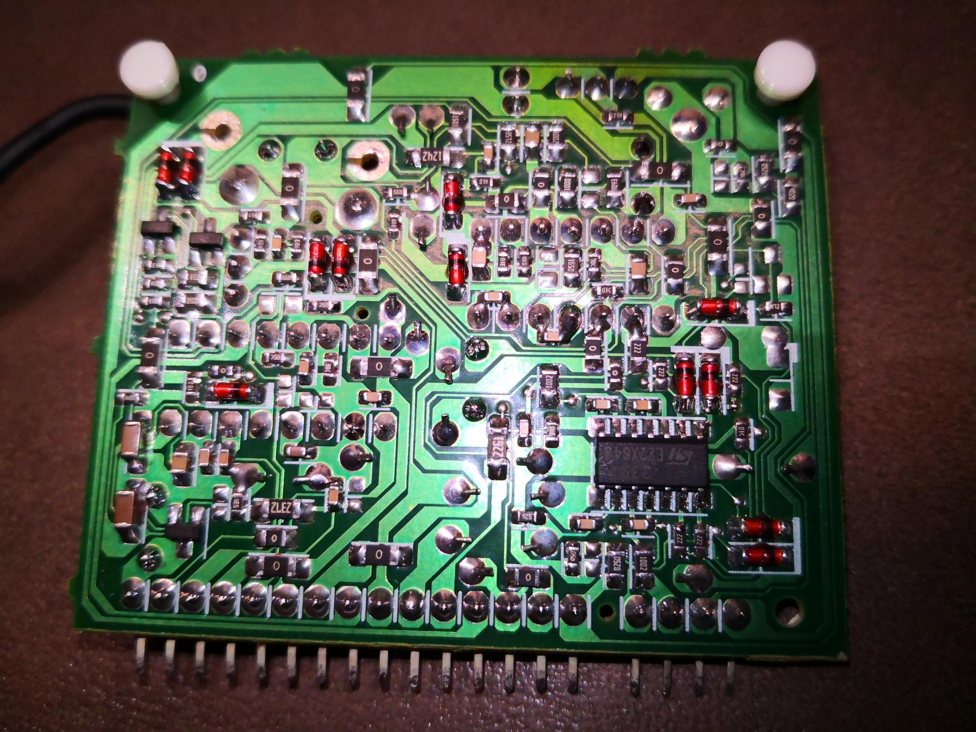

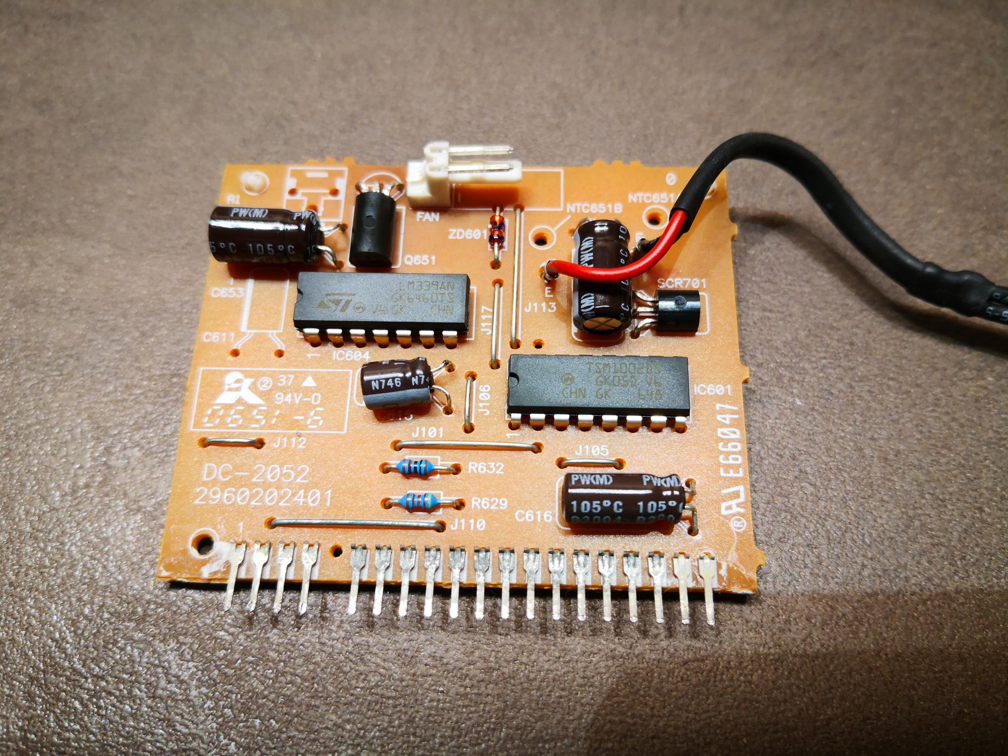

    Took it apart again, desoldered the small daughterboard/control board to check for problems. At first I thought it was soaked in electrolyte from supposedly bad capacitors, but this proved to be only an excess of flux from manufacturing, which was easy to clean with iso alcohol.
    One of the small elkos on the board (nichicon PW 10uF/25V) seemed to have a high-ish ESR (a bit over 4 ohm) so I replaced it with a 10uF/35V from the same series (around 1 ohm I think). However, after putting it all together it didn't change anything. Voltages still in spec, pwr_ok missing.
    The three chips on the small board are two LM339 (one DIP, one SOIC) and a TSM1002DS which I suspect could be a custom Delta chip. All capacitors are from reputable brands (NCC primary, mostly Rubycon on the main board, Nichicon on the daughterboard). Lacking a schematic (and experience) I'm at a loss, so any advice/idea/hint will be greatly appreciated.

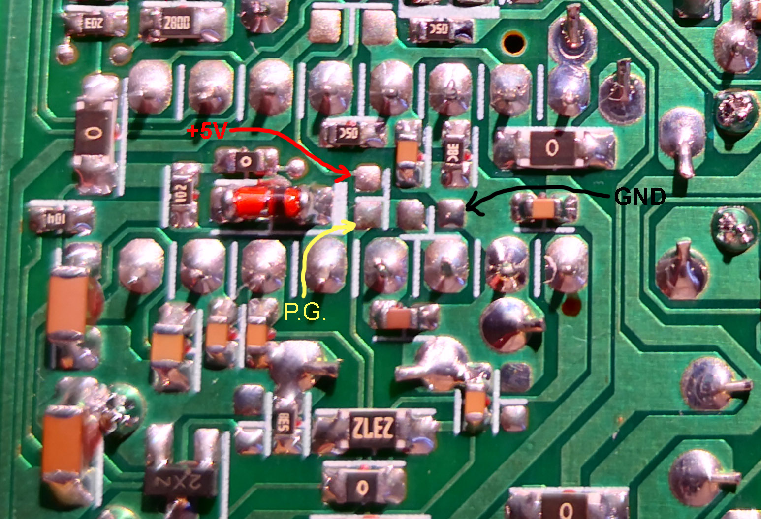

    You may be able to find the pin-out and a schematic for that custom Delta ASIC. It was “DNA1002” when I was at Delta in the late 90s. Look to see if the PG output needs a pull-up resistor, and if there is one on the PCB. If there is, check to see if it is open or has a bad solder joint.

          There should be a "pullup" resistor from +5 to PGO, as the latter is typically an "open collector" output.
          If this is open, PG will never go high, no matter what's going on with the opamps/comparators.
          For testing, connect anything from 1k-4.7k from +5 to PGO.
          Easy to do at the ATX connector- connect the resistor from red to gray.
          If PGO behaves normally, you're on the right track...
          You have to trace PGO from the gray wire back to wherever it originates.

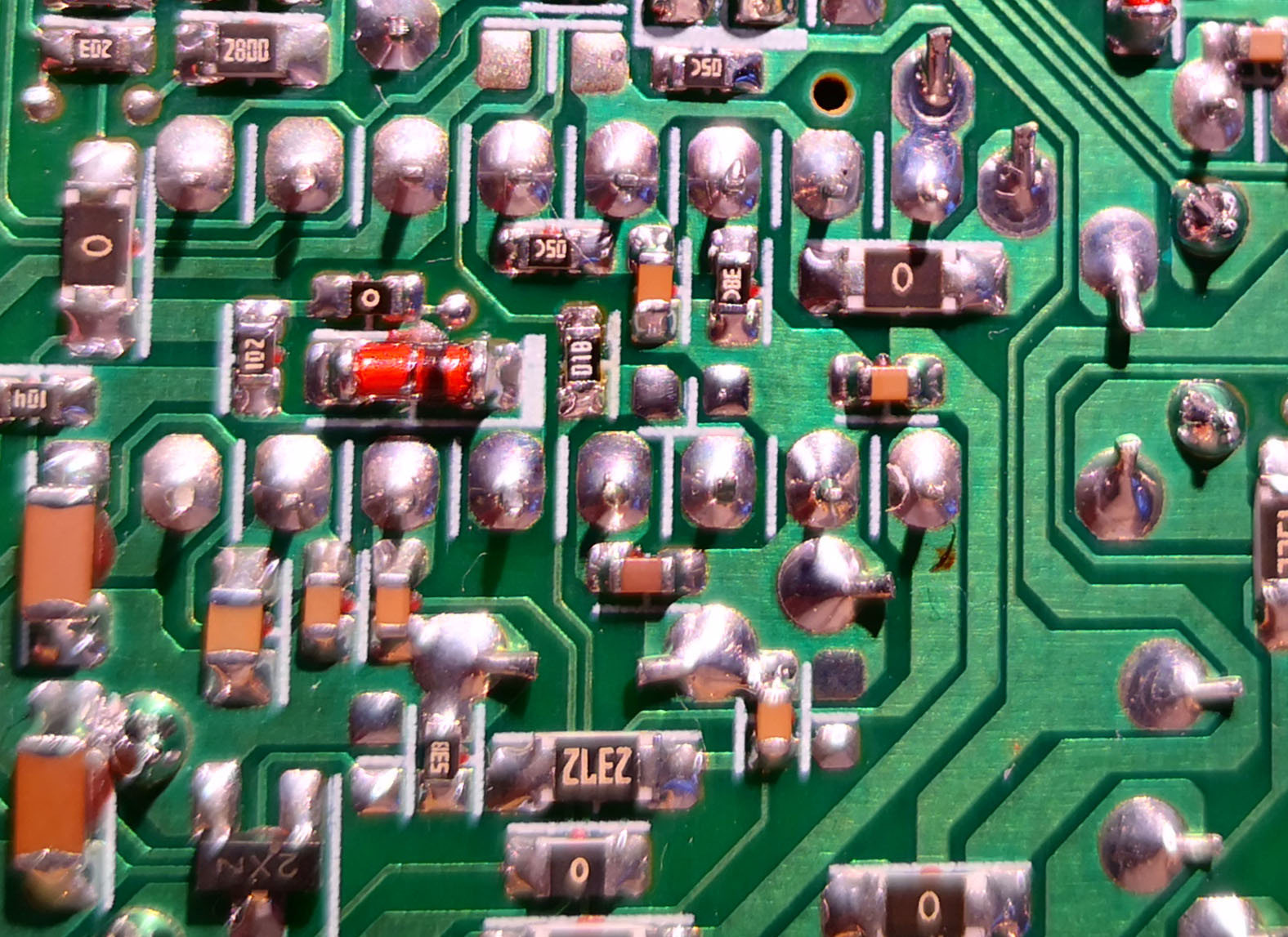

            First I tried the external resistor trick sugested by kaboom, and it seemed to indeed solve the problem. So I opened the PSU again and inspected the small board. Traced the gray wire and it only connected to a single point inside the PSU, that being pin 3 of the '1002' chip.
            There are two pair of pads in the area, one for pulling P.G. to +5V, the other for pulling it to GND. None was populated - the PSU came like this from the factory. The unit has an IBM part number, so maybe this is some trick requested by them to make it less usable with other systems?
            According to the schematics found online, I added a 1K to the "pull up" pads and after this the PSU behaves as expected. To make sure I didn't simply pull up a dead circuit i quickly wired some LEDs+resistors to the main rails and also the PG wire, and as expected there's a small delay (about 0.2s) for the PG compared to the rails.
            Thanks again for everything, I now consider this solved!
