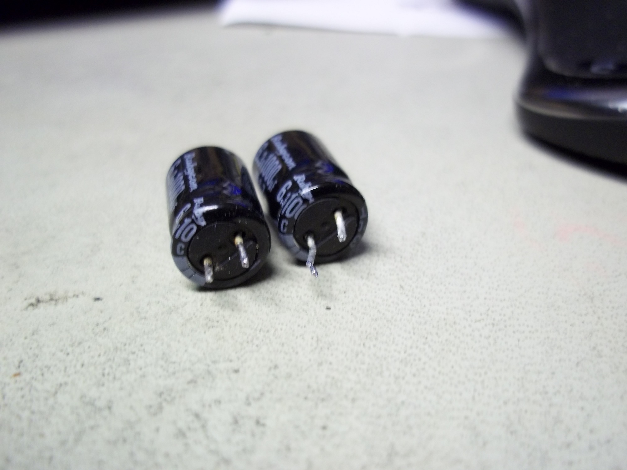

    I ordered a mobo off ebay from hong kong, got it today, It works, but blown caps.
    Pictures below.
    I'm not sure if these blew due to heat or are fakes?
    I have rubycons from another matching board and the font doesn't seem to match, the bad ones are more bold then the good ones.

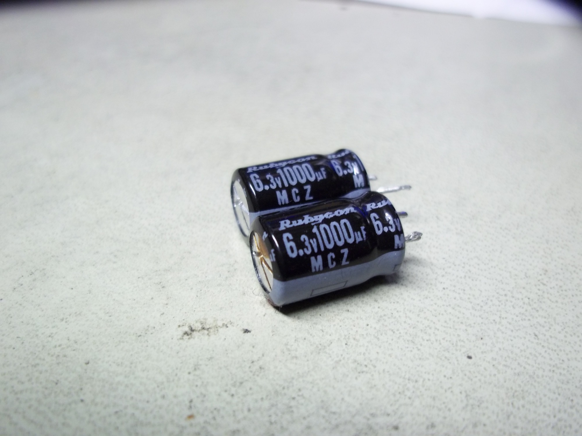

            If those are fakes, they're certainly very good fakes... The color is unusual, but I've seen black/white MCZ before on Dell boards, so it's not unheard of.
            You said they were on a board. Did the board show any signs of rework?
            I've seen blown MCZ before too. They're very reliable overall, but not indestructible.

              Came off a HP board, looked at the back before I began work on it, no signs of rework.
              You never seen black/white ruby's? I have them on alot of boards, I only noticed this one when I compared it to 2 other boards that had ruby's and noticed the font is more bold on these bad ones.
              I got suspicious considering the origin of the board.
              Anyways I replaced the passive north-bridge cooler with an active one apparently it puts out alot of heat and the spot where the bad ruby's are sit next to this furnace.
              Thanks mocking bird for the heads up, I will be more cautious next time.

                Mad_Professor; yyonline said that they are unusual but that he has seen them before
                I say they look genuine too, they where probably cooked.
                Remember they are only rated for 2000h @ 105°C
                For example if that chipset runs as hot as I've seen them do and heats the capacitor internal temp to 75°C
                Then it would only take 16000 hours for it to fail, that is ca 267 days...
                Bloating will take longer but at this stage in time it would be outside the tolerance of the manufacturers specifications...

                        They look real to me.

                            I think the black and white MCZ have Polyethylene terephthalate sleeves and are marked with "PET". I believe the gold lettering MCZ have PVC sleeves.
                            • TCKTMB
                              • Jun 2011
                              • 56
                              Re: Rubycon fakes??? or just blown?
                              Correct, PET(black/Grey) sleeves use the "option" section in part number of EFC as well. This used to be helpful when searching for MCZs if everyone was out of the PVC sometimes you would get lucky using the EFC part number. example PVC: 6.3MCZ820M8X11.5, PET: 6.3MCZ820MEFC8X11.5

                                      Those look fine, because the other Rubycon series are usually that color and the label text looks even clearer.
