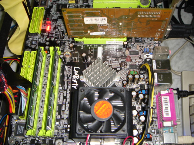

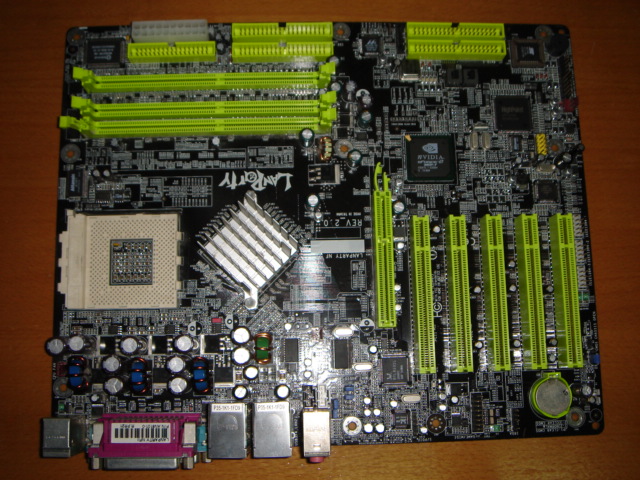

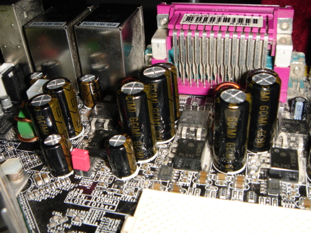

                      Re: cap size help
                      Originally posted by Mustang
                      Big Pope, what's your experience with the Abit NF7-S motherboard? Every cap on it is Rubycon. It overclocks very well but would your caps push it further? Curious
                      Yes, i have experience with NF7-S Ver2.0. All are Rubycon MBZ, i know. By this reason, it is no much space to push further. Actaully, i have experience over 100 pcs motherboards in th past.(Socket 7 to P4 and A64)
                      Do you know DFI LanParty NFII Ultra? NF7-S compare with LanParty NFII Ultra, both are good motherboard, but DFI can overclock FSB 250MHz above with same CPU. I feel DFI LanParty NFII Ultra is better than NF7-S.

                        Re: cap size help
                        Yes, that DFI still is the best NF2 mobo for overclockers. The Abit was considerably less expensive at the time and to my surprise has very good caps across the board. I'm not sure what the DFI has for caps and how well they stand the test of time but I guess the overclockers already have A64's and beating those up now

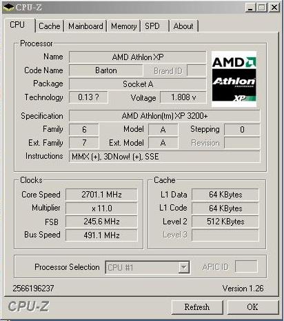

                          Re: cap size help
                          Yes, DFI LanParty SLI-DR Expert and Asus A8R-MVP is my target motherboards for A64's system. Now, Opteron 146 is hot choose for DIY user. Retail market price is HK$1480 in Hong Kong. What price of Opteron 146 in your side?
