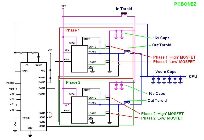

      Originally posted by styxbound
      Sorry, I'm old and senile. Can anyone simplify for me how to find the inputs and outputs on vrms? There seem to be any number of fets around the cpu on a lot of boards, and I can't figure out where the in and out is on the circuit.
      'In' will have +12v connected one one side of caps.
      [Continuity check to power plug.]
      'Out' will have Vcore on one side of caps.
      [Continuity check to toroid(s) NOT connected to +12v.]

          Originally posted by AK0R
          Procedure for testing Voltage Regulator Modules (VRMs):
          (This assumes that any bad capacitor problems have already been fixed.)
          1. Turn off power to the computer.
          2. Remove CPU, memory, and all peripherals from motherboard. Disconnect power supply.
          3. This step verifies that the board is not damaged, and the VRM is not shorted:
          a. Measure resistance from power supply pin (+3.3, +5, +12, -5, -12) to input of VRM. Resistance should be zero (too low to measure).
          b. Measure resistance from output of VRM to load supply pin. Resistance should be zero (too low to measure).
          c. Measure resistance from input of VRM to ground (should be greater than 1 megohm, usually much greater).
          d. Measure resistance from output of VRM to ground (should be greater than 1 megohm, usually much greater).
          4. Install CPU, memory, and all peripherals to motherboard. Connect power supply.
          5. Turn on power to the computer.
          6. This step actually tests the VRM (all voltages taken with respect to circuit ground):
          a. Measure voltage at the power supply side of the power connector (+3.3, +5, +12, -5, -12).
          b. Measure voltage at the motherboard side of the power connector (+3.3, +5, +12, -5, -12). Anything less than the value obtained in step 6.a indicates a high resistance in the power supply connector.
          c. Measure voltage at the input to the VRM (+3.3, +5, +12, -5, -12). Anything less than the value obtained in step 6.b indicates a high resistance in the PC board traces to the VRM, and is probably not repairable, even with a schematic.
          d. Measure voltage at the output of the VRM. The value obtained depends on the functions being powered by the VRM, so knowledge of the expected value is required. Anything different than expected indicates a failed VRM (note that output may be higher or lower than expected if bad).
          e. Measure voltage at the device being powered. This requires knowledge of the device (which pins are power pins). Pinouts are readily available on the Internet for 30-pin, 72/144 pin, and 168 pin memory, as well as ISA, PCI, AGP, USB, etc. Pinouts for CPUs are either on the Internet or may be obtained from the manufacturer. Anything less than the value obtained in step 6.d indicates a high resistance in the PC board traces from the VRM, and is probably not repairable, even with a schematic.

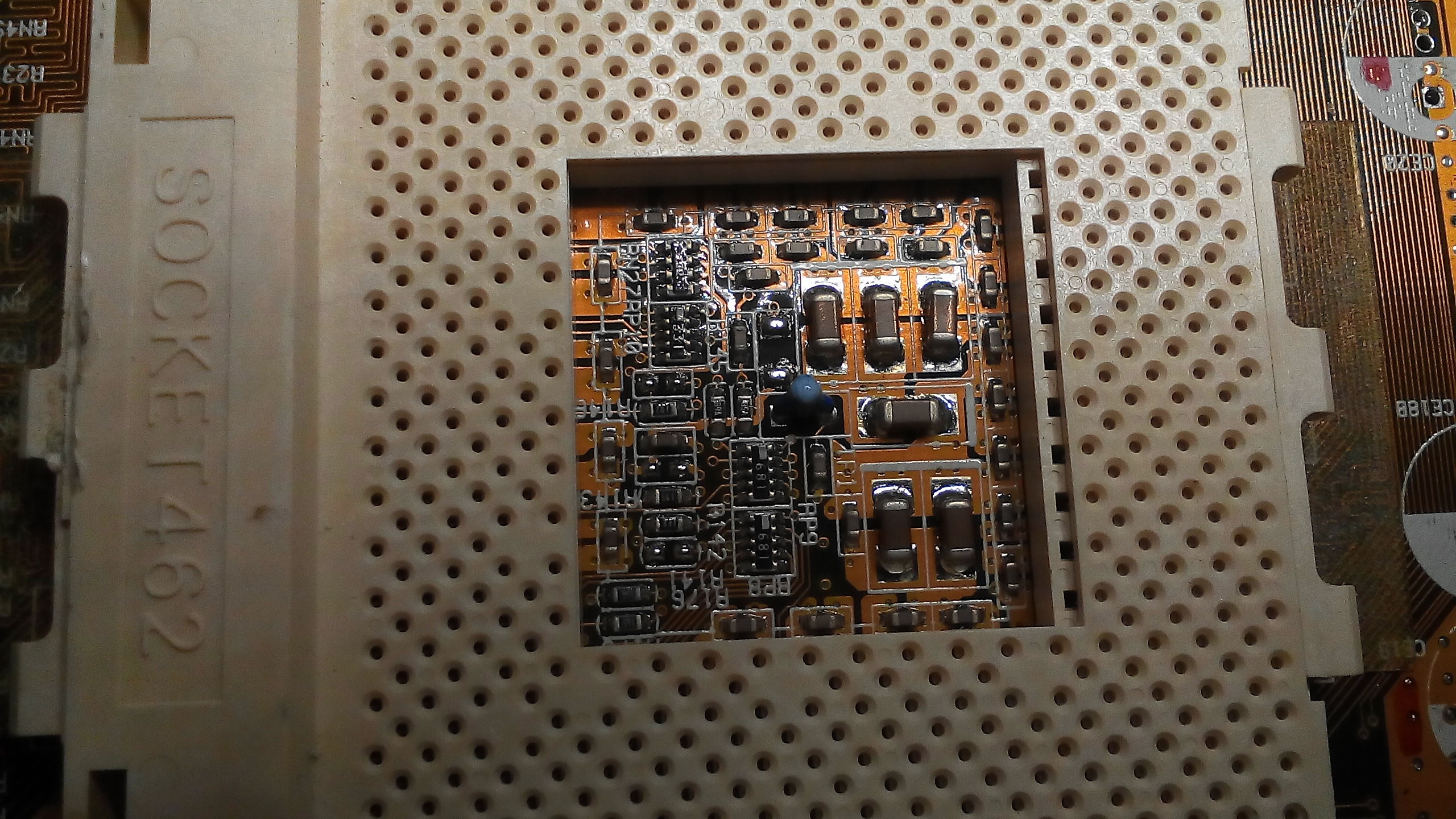

                  I measured it very low at 9 ohm....is it because of filter capacitor in parallel ?
                  buck controller = NCP5322
                  Please have a look at the schematic, typical 5322...at the input and output ...there are filter capacitors..
                  What happen if NCP5322 is bad ? the output voltage is not right ?

                          Could it be one of the output filter caps short ? but they look ok ( no bulge )...I tried replacing with new one last time...still the same...
                          Is it possible that one of the ceramic caps near the CPU is short ? ( on the bottom of the CPU, inside the socket )
                          without CPU in socket, 34.6 ohm...

                            I have removed all the output capacitors now....I got only 8 ohms between Vcore and GND...CPU in socket...I also have removed all the FETs and the resistance is 7.5 ohm....what could it be the faulty now ?????
                            I have removed the inductors as well so the CPU now isolated by itself....
                            CPU on socket....resistance = 8 ohm....so it will be some somewhere on the ceramic CPU caps ?
                            Is it possible that those caps are faulty ??????

                              When I tried to measure one of the chip capacitor with my LCR45....I got value >20000uF
                              which is not right, mostly those capacitor is about 100nF to 500nF....
                              Is there any possibilities that they are the faulty ones ??

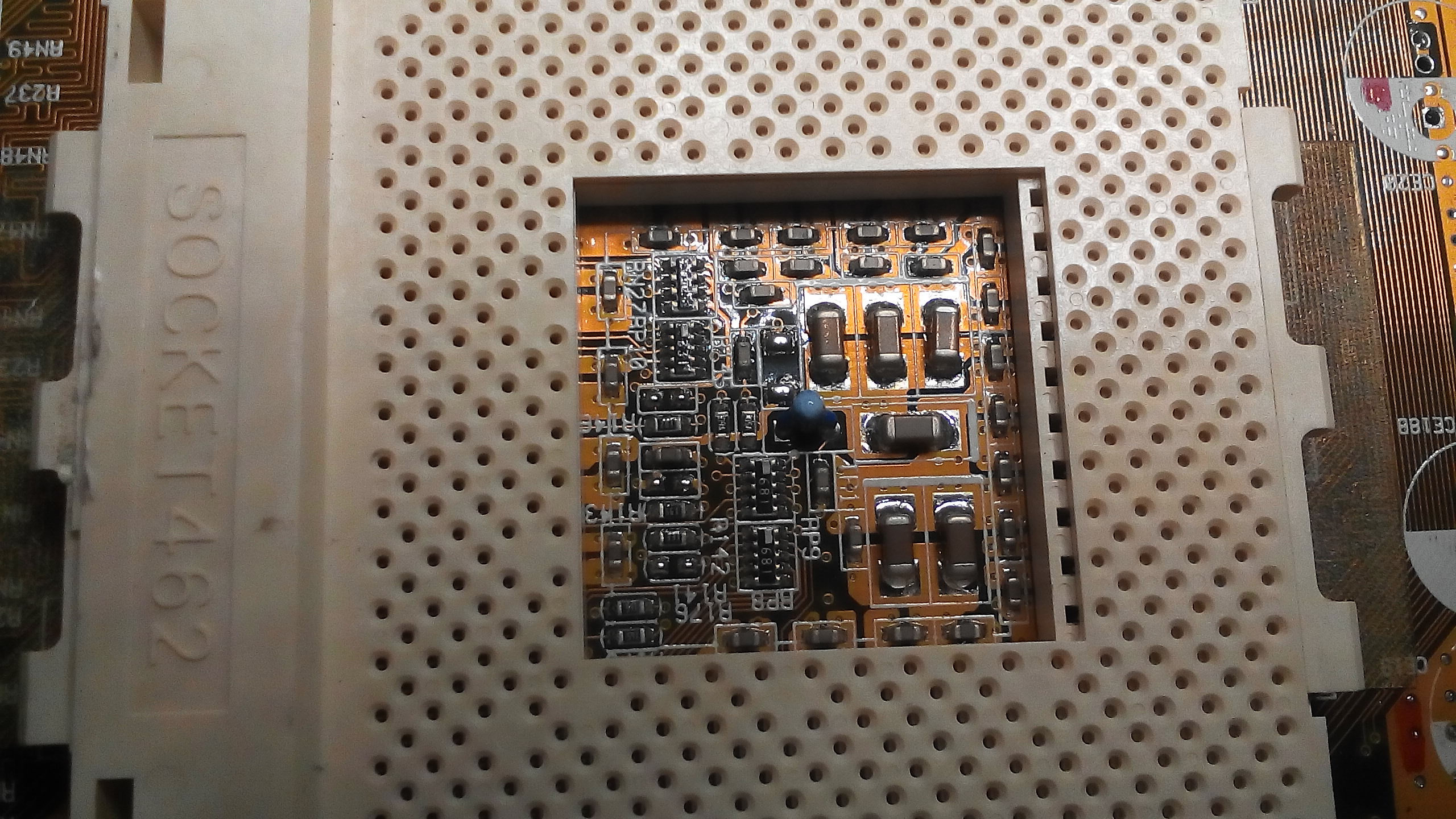

                                  Photos :
                                  • bianchi77
                                    • Jun 2016
                                    • 1121
                                    #57
                                    Re: Testing VRMs
                                    I've found two missmatch value with the code written on it..05A = 110 ohm...measured in circuit 66 ohm...
                                    09A = 121 ohm....measured in circuit 67 ohm....and they are not in parallel...
                                    Could it be the problem ?

                                      Something does not make sense here, you had 9 Ohms before the output caps and MOSEFTs are removed, and now you have 7.7 Ohms, and 8 ohms?
                                      Is Vcore connected to that power supply as shown in the diagram that you are getting the 9 Ohms reading?
                                      Very confusing.
