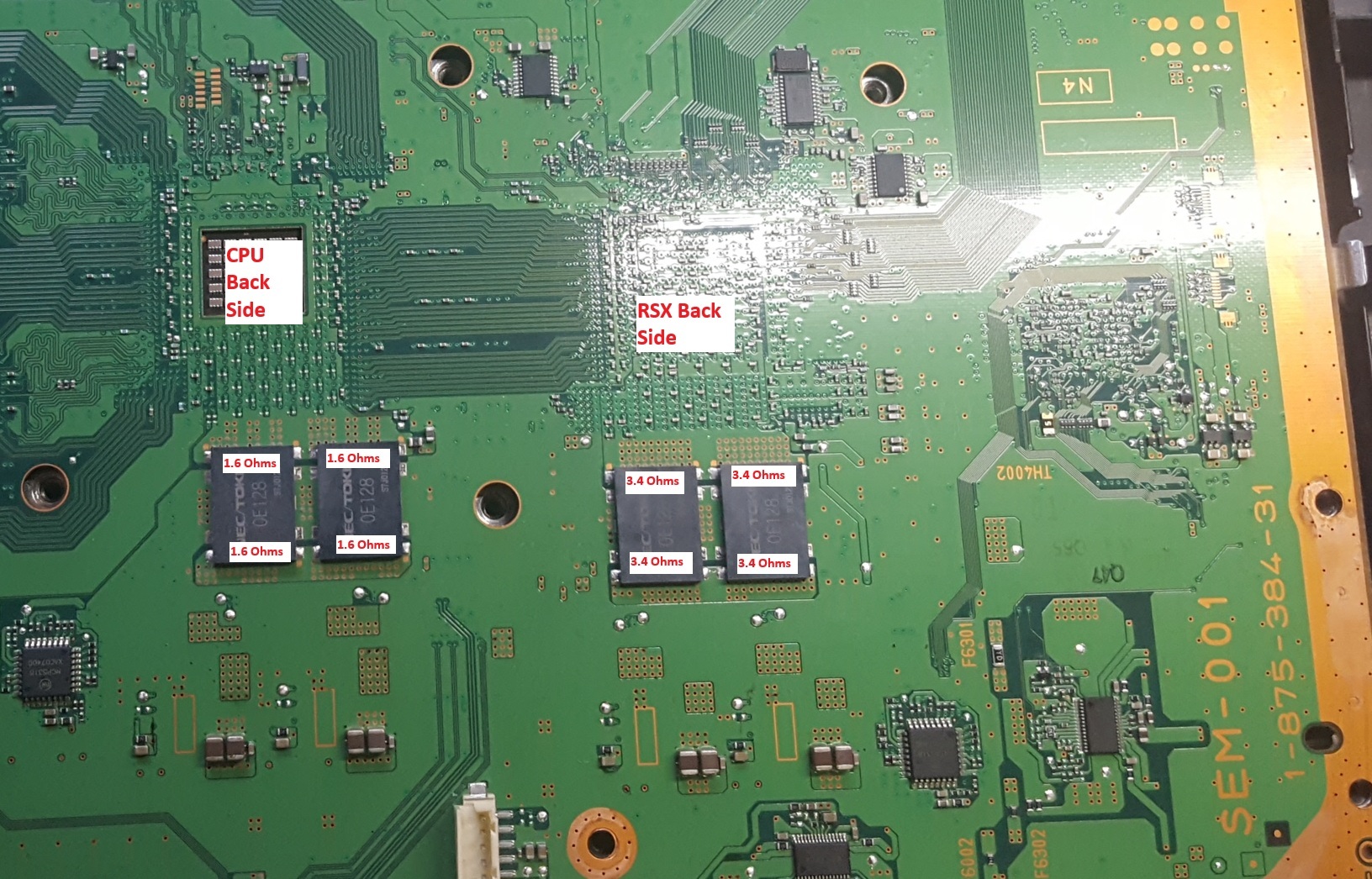

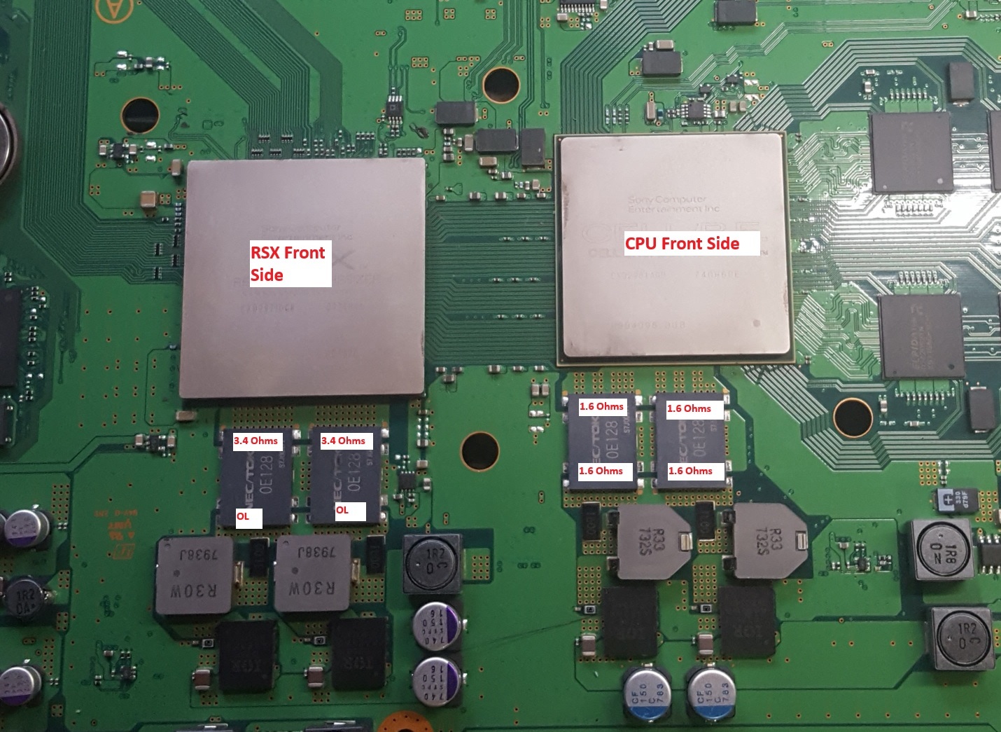

    I'm in process of diagnosing the yellow light of death symptom on my PS3 FAT console CECHG01, in process of getting the Arduino gadget to be able to access Syscon and be able to read fault codes. In the meantime, I'm trying to measure resistance of the NEC/Tokins while still attached to the board. I took the Ohm readings from each of the NEC/Tokins from front and back of the board (4 from the RSX and 4 from the CPU chips).
    What I gathered in the attached pictures are values from the CPU NEC/Tokins are consistently measuring 1.6 Ohms while on the RSX they measure 3.4 Ohms except for two places where its open circuit (OL) no measurements. I understand that these are like capacitors and are hard to measure on the board. I hope somebody more experienced can tell me if what I'm seeing is a set of bad NEC/Tokins on the front side of the board or a bad RSX chip?

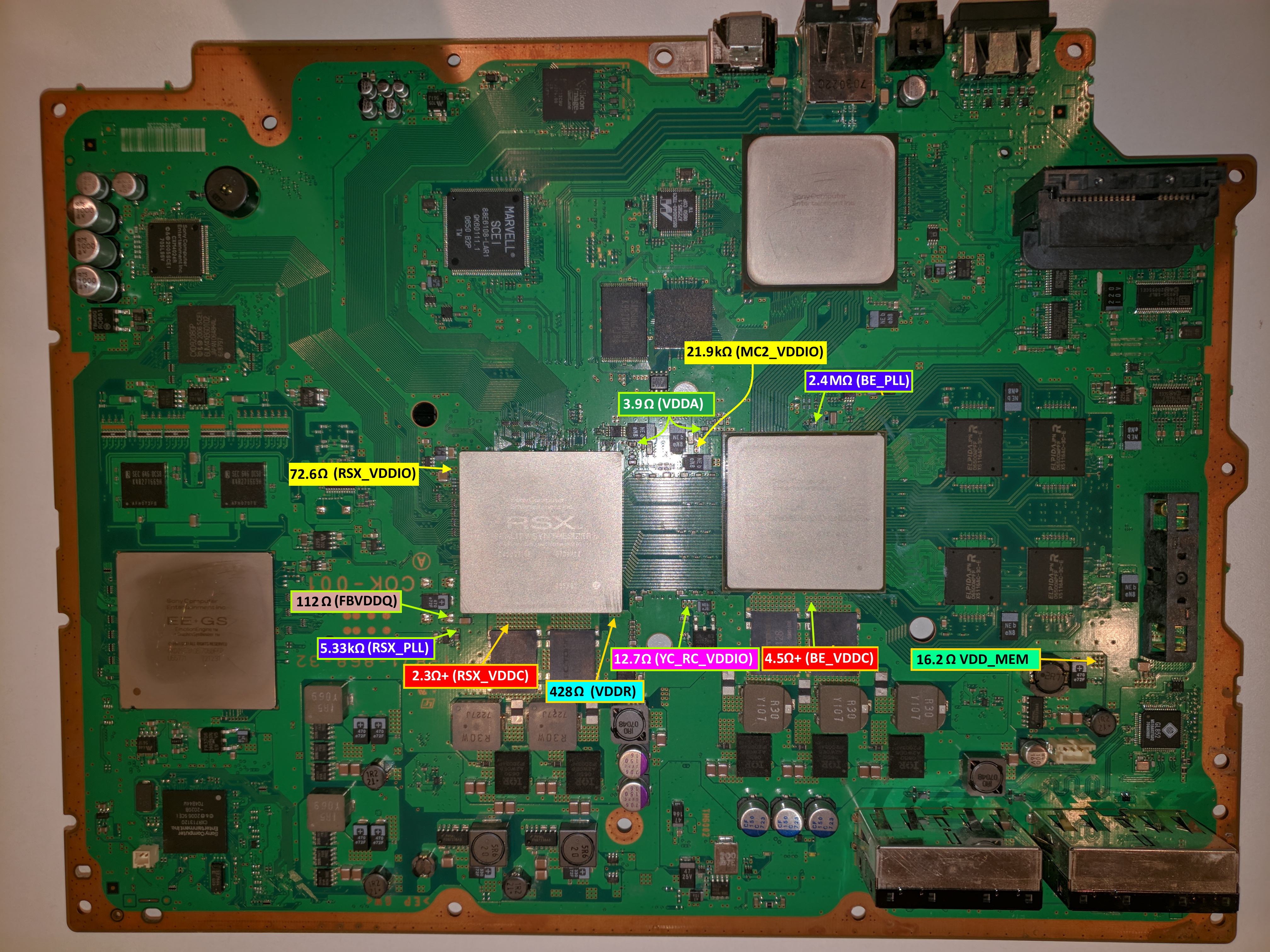

      Originally posted by stj
      Thank you for sharing, the values I was able to pull from looking at the shared diagram is as follows:
      RSX_VDDIO = 85.2 Ohms
      RSX_PLL = 5.78 kOhms
      RSX_VDDC = 4.1 Ohms
      Keeping my fingers crossed 😊
        Great Sage ι½Šε€©ε€§θ–
        • 32068
        values will be different for a "G" board because they use 65nm chips instead of 90nm

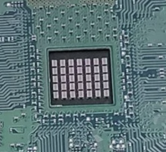

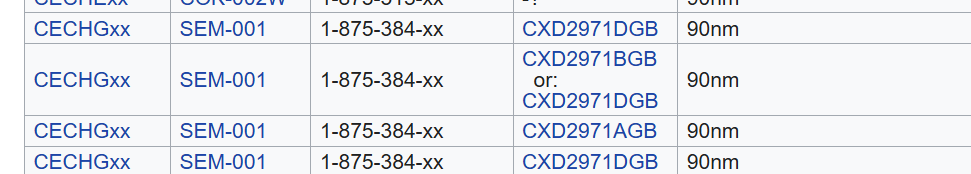

          I thought the board had a 90nm RSX chip per the psdevwiki site that showed all the SEM-001 boards had them, and tanks to you I realized from the back side that there are 5 rows & 6 columns of capacitors (30) behind the RSX chip which makes sense it to be a 65nm unlike the 90nm would have been 5 rows and 7 columns (35).
          I'm completely guessing if that's a tell unless one was to delid the heat plate to confirm the die size:
          Click image for larger version  Name:	image.png Views:	0 Size:	118.6 KB ID:	3739638Click image for larger version  Name:	image.png Views:	0 Size:	193.6 KB ID:	3739639

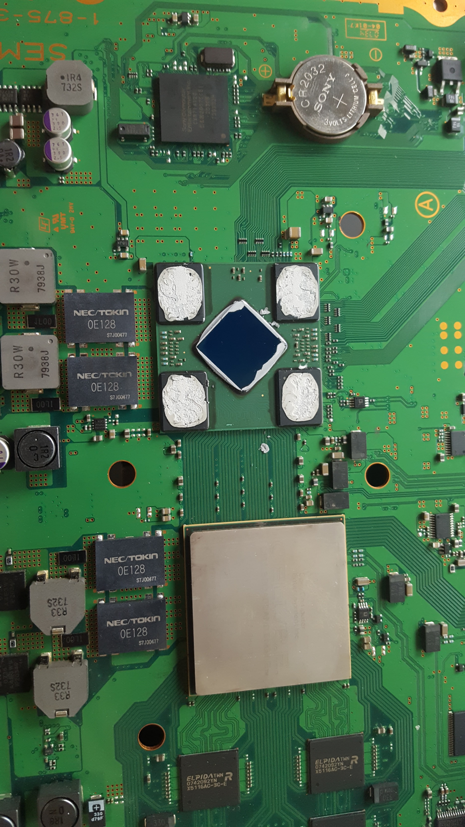

                    • jkucukov
                      • Feb 2025
                      • 73
                      I removed the IHS from the top of RSX, it measures a 90nm chip. So the resistance values being off on the chip potentially indicate a defective rsx
                        • 32068
                        possibly, normally i just use those charts to look for shorts.
                        i think you can get different readings based on the voltage your meter applies in resistance-mode too.

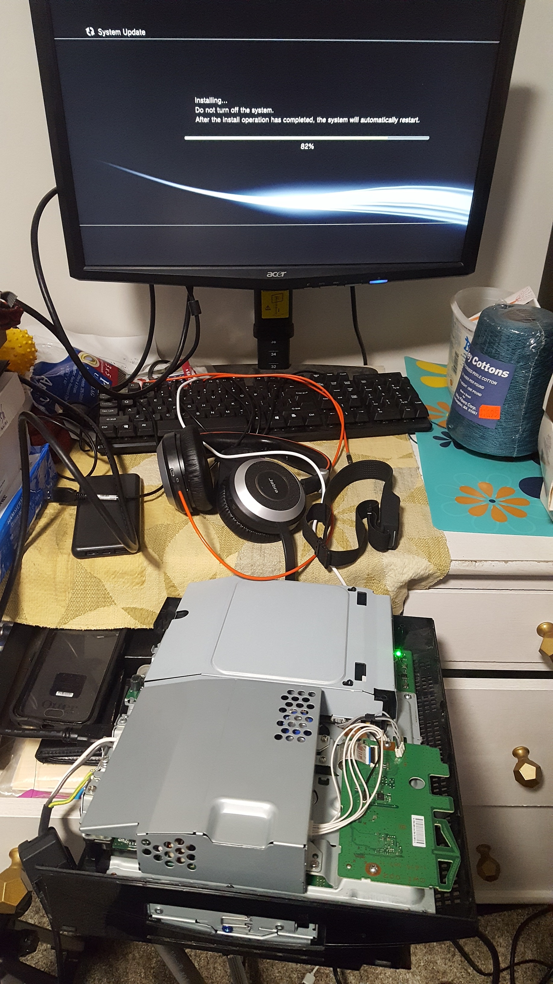

                          Extremely funny thing is after deliding of the IHS from RSX chip I measured the values again several times and everything was the same except for one value that changed. RSX_PLL went from 5.78 kOhms to 1.47 kOhms. I couldn't believe what I saw so I tried seeing if the console would power on, guess what.. we have picture, I cant believe it.
                            • 32068
                            nice
                            now install EvilNat 4.92
                            THEN upgrade it to 4.92.2
                            dont try to clean-install 4.92.2 or you risk a brick!

                              That's the 1st thing I did after I was sure the console was not going to YLOD again, I wanted to see what the CPU & RSX temps were out of the gate so I got the Webman too. The CPU I didn't want to delid just yet but the temps do go above 76C on the CPU from just browsing so I have to keep the fan speed up. The RSX temps are nice cool in the mid 50s, however I dont want to jinks anything knowing that all this is due to delid confirming cracked solder joints under the RSX chip.
                              Funny, reading online people are experiencing YLOD after performing Delid, in my case it managed to fix the issue god only knows for how long, not holding my breath lol!
