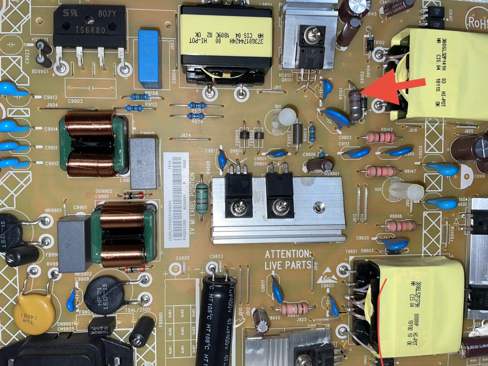

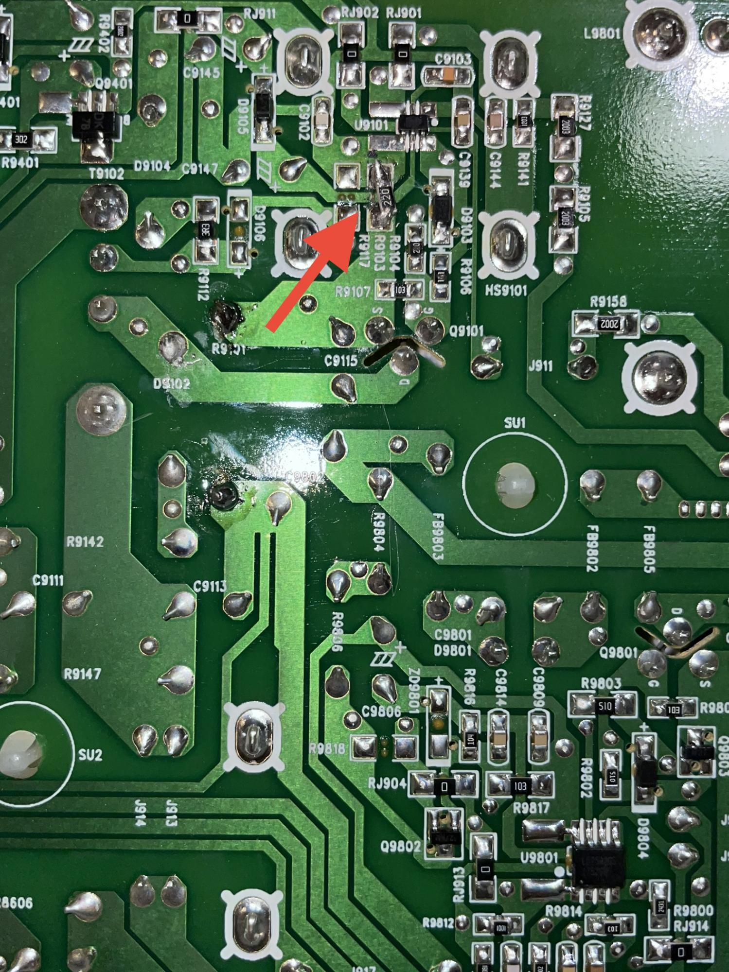

    I received this 43' TV. It has no standby voltage and the owner had it on when it banged and shut off.
    With a quick look I found one resistor burnt on top side
    R9101 0.24Ω
    and at the back smd resistor R9142 22Ω
    Both were reading with MM in MΩ
    The schematic is attached to this post.
    I investigated nearby components and found N-Mosfet Q9101 is K8A65D1 instead of STF24NM65N as per schematic. The resistance between drain and source is 4.4Ω. Should I consider it shorted and the culprit of the failure or is this normal?
    The photos uploaded are after resoldering new resistors

    Correction R9104 not R9142.
    Also R9106 and R9103 are also burnt reading over 10kΩ
    IC U9101 seems ok

      Had the mosfet been changed before? I think one was 8A and called for 24A.
      • R_J
        • Jun 2012
        • 9588
        Re: Philips 43PFS5803
        If Q9101 shorted and R9101 is open, U9101 is damaged as it would have seen about +300vdc on pin 4(CS)
        • Davi.p
          Hobbist Tech
          • Sep 2009
          • 4463
          • Italy - Milan
          Replace mosfet first.. if it is shorted between drain-gate check components between gate and ic, get also a new ic this case..

            I found a repair kit that includes IC U9101, mosfet, blue film capacitor and the resistors (even though R9104 is not included but already replaced) so I will change them all.
            Better safe than sorry, specially when my only other option is to buy separately and wait 2 months from China..
            It seems this can be a common problem in this board since there’s a specific repair kit for it.
            I will come back in 15 days when they arrive.
            • Sraros
              • Jan 2017
              • 223
              • Greece
              No for sure not, maybe it's another version of the original board to cut down the cost. The repair kit has the same Mosfet I removed and not the one in schematic
              • Sraros
                • Jan 2017
                • 223
                • Greece
                Update on this. The repair kit did it's job. TV works again.
                IC U9101 was indeed shorted (compared grounds to new one)
                Q9101: K8A65D1 shorted
                The SMD resistors passing through blown.
                All the 0 resistors ok. Fuse and caps ok
