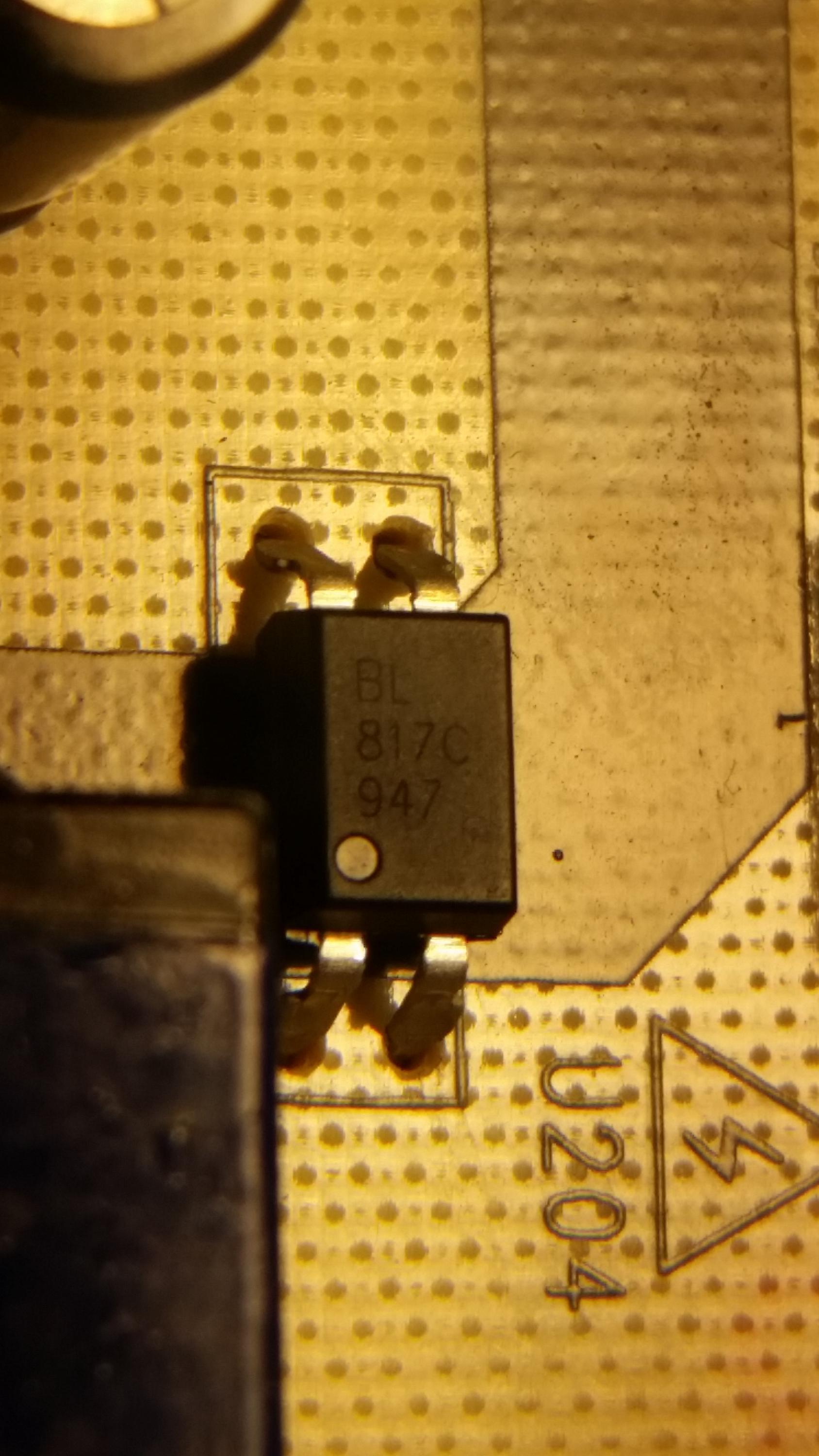

      also here is a pic of the optocoupler and its datasheet

        The optocoupler is in the correct way. see the pin 1 dot on the ic, it matches the pin1 of the board (cutoff corner)
        Pin 1&2 are the led and are on the secondary side of the power supply, pins 3&4 are on the primary (HOT) side and are the photo transistor.
        If you are carefull you can check the voltage ACROSS pins 3 & 4 and see if they change when the PSON changes
          but the datasheet shows that the dot is on pin 3 .... ???? also i dont see any cut off corner? edit: oh on the top silkscreen there is a cutoff corner that matches where the dot is on the IC...but according to the datasheet that dot is on pin 3!
            If you look ath the top of the board, there is a black rectangle around the optocoupler and one of the corners is not like the others
            Does it look like it has been replaced (fresh solder) It seems the Secos brand BL817 and the BL817S have different pinouts.
            Here is a different manufacture datasheet for the BL817
              That datasheet seems to be marked wrong, Check a datasheet of the sharp PC817. If you look ath the top of the board, there is a black rectangle around the optocoupler and one of the corners is not like the others
              Can you recheck the number on the optocoupler, Does it look like it has been replaced (fresh solder) It seems the BL817 and the BL817S have different pinouts.
              Thank you for taking time with me. I will look closer and see if I do have the wrong datasheet
                it doesnt look like it has been replaced. it definitely is a BL817C not an S.
                after looking at both datasheets i have no idea how i am supposed to logically decide which pinout is correct without testing the optocoupler itself to find out. is this just how it is sometimes?
                am i just supposed to know by the placement of the components around the EA1 that it has to be driving the LED side of the opto so therefore i choose the datasheet that lines up with that pinout? and that noticing the side of the opto that connects to U101 (main switching IC?) must be the feedback, so therefore has to be phototransistor side... i guess i see it now. i will hook up some clip leads to pin 3 and 4 and see whats there before and after PSON.

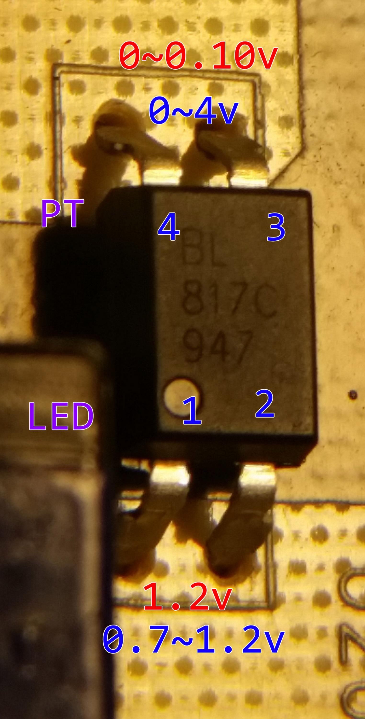

                  ok heres what i got. red voltage is by itself. blue voltage is with 5v supplied to PSON and to BK. ~ denotes fluctuation. it definitely does change when PSON is applied.

                            ok i have been doing research and perfecting my "tools" for testing opto isolators easily. i tested a couple other ones i had laying around to get a feel for it before trying it out on the ONN board.
                            the other ones i found were also 817. i have this breadboard with a power adapter plugin board for it that can make 5v or 3.3v.
                            i went with the 3.3v and then used 2 resistors totaling 110ohm to drop 2.1v
                            over the resistor, leaving 1.2v for the LED.
                            i got the resistor value to use by this process:
                            according to the datasheet, the LED wants 0.20A and 1.2v
                            i have 3.3v from the power board so i need to drop 2.1v over the resistor to leave only 1.2v at the LED.
                            so using ohms law R=V/I = 2.1v/0.20a = 105 ohms but i didnt have a 5 ohm handy and figured 110 would be fine. and it seems it is. i get 1.19v going to the LED on any 817 i test. the two that i tested seemed to work. the resistance on the other end of the optocoupler dropped from infinite to around 40 ohms.
                            i tested one opto out of circuit, and another in circuit.
                            i get similar results when i test the one in the ONN PSU. (in circuit)
                            when the 1.2v is applied, the resistance on the other end of the opto drops to 45 ohms.
                            i cant find in the datasheet where it tells what ohm value to expect here when the 1.2v is applied...but it seems pretty close to the other ones i tested so i have a hard time suspecting that the optocoupler on this board is the culprit.
                            could this test be incomplete? is the only true test replacing the component with a brand new one? or is it an indication that we might look elsewhere for the problem?

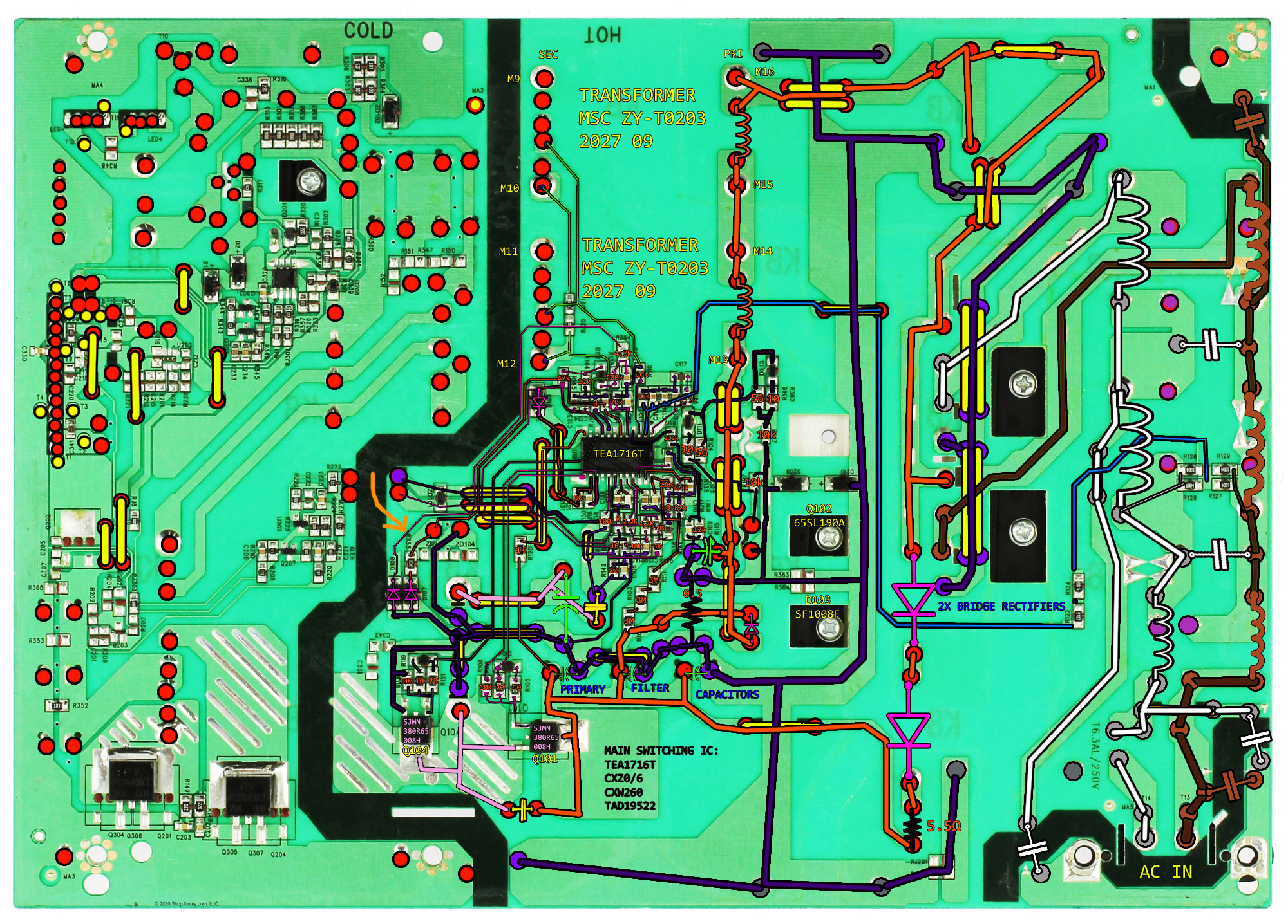

                                  Re: ONN 100012588 Has fluctuating Voltage on PSU 12v
                                  i still have to figure out a meaningful test of the component U302.
                                  but i have been mapping this board out by hand. put quite a few hours into it.
                                  along the way i was checking resistors and looking for shorts and all that. i didnt find anything obvious until i got to R355 which is marked 2R2 so should be 2.2 ohms but instead its 20.3k and on the other power supply board it reads 35k so i think it has failed on both boards...but failed slightly differently with regards to the end resistance value it attained. this circuit is very simple it only has 2 capacitors and a diode in it. the plus side of the diode goes to hot ground (negative leg of PFC). the negative side of the diode goes with 2 capacitors in parallel to the main IC i need to look up this chip. TEA1716T and see what that line does. its pin 6. i put a yellow arrow pointing to R355. its pretty nearby the optocoupler circuit but not connected to it in any way i can see.
