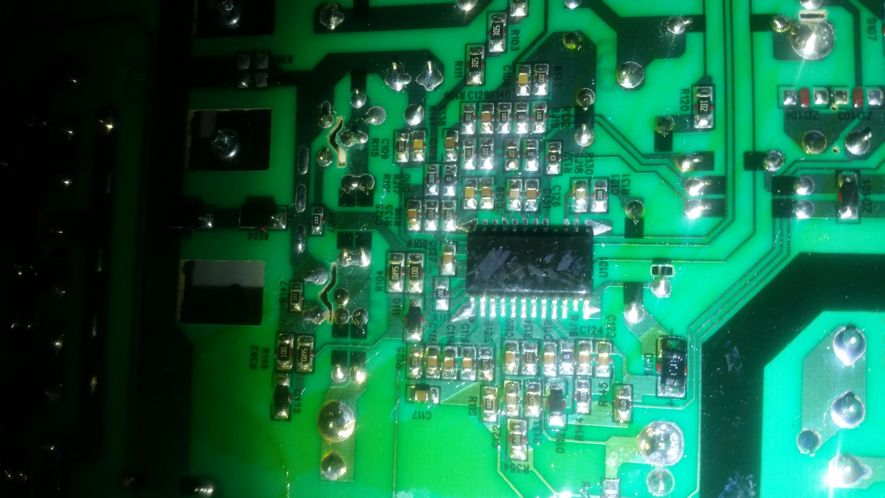

            Voltage on PSON is 0v when I don't connect mb or add my own 5v. It drops to 4.6v actually when I apply the 5v. When the mb is connected, it fluctuates between 1.8 and 2.8v
            There's some nasty glue all over the place, making it hard to read markings but i think this is right.
            markings on u101:
            TEA1716T
            CXZ0/6
            CXW260
            TAD19522
            Marking on u302:
            EA1

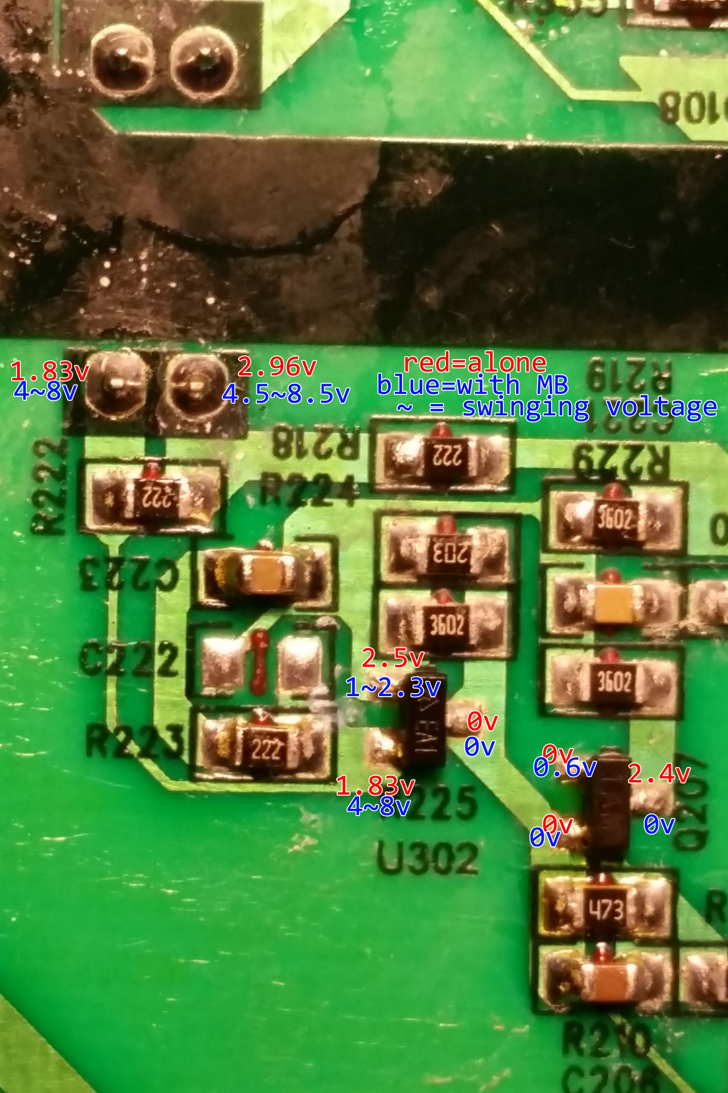

                    here are the voltages i measured around the optocoupler circuit. red voltages are with the PSU by itself, and blue voltages are with the MB attatched and red light blinking.
                    i notice a fluctuating voltage at the optocoupler when the main is plugged in, but a stable one and much lower when main not connected.
                    the base of Q207 is 2.4v without MB and 0v with MB ... that seems a bit strange. of course i dont really know what im looking at so maybe thats totally normal!
                    but it does seem strange to me that there would be so many 0v there. particularly on the anode of u302, which is 0 whether the MB is connected or not.

                            oh but one last thing i noticed before i go... that ANODE of u302 Marked EA1 (pin 3 according to the datasheet) is shorted to ground. that cant be right, can it?
                            ANODE should be positive, right? and its 0 in both cases, with or without MB...

                              That EA1 appears to be an emule of 431 so it simulates a zener (is a programmable zener) where correctly anode is at GND..
                              if ref pin rises over 2.5v then it flows current from cathode to anode and then cathode is very low volt.. have you tested the secondary caps? i can also suspect an intermittent short on them, it happens in cheap chinese miniaturized cap brands.. so i'ts better anyway to be replaced.. use only good rated brands like Rubycon, nichicon, panasonic..

                                  U302 is not a zener, it is a shunt regulator ic, The reference is connected to a resistor divider network, one end is ground, the other end of the divider connects to the +12v output, when the +12v output changes, the reference voltage also changes, this causes the voltage on cathode to also change. This change in voltage will control the 817 optocoupler, which controls U101 pwm duty cycle. This is how the +12 volts gets regulated.
                                  Like I said before, in standby the voltage across the main filter capacitors should only be 160vdc. You may have a defective optocoupler or U302.
                                  When nothing is connected to Cn201 what is the voltage on the +12v line and is it stable? (in picture red=alone) voltages seem stable.
                                  One more voltage to check would be the actual LED voltage between CN301 & CN302, this should be the un-boosted led voltage, likely around 60~80vdc

                                    yes those voltages in that area are stable when nothing is connected, but do fluctuate when MB is connected.
                                    the 12v line always fluctuates whether mb connected or not, but it fluctuates down to lower voltages with the mb connected.

                                      Now, watching better last photos, i see that p.s. board outputs 9,5v when in standby, when AV board sends back ps on command it tells psb to rise the standby voltage to 12v, this doesn't mean for me that activates also the PFC, i don't think primary can sense the state change st.by> full on.
