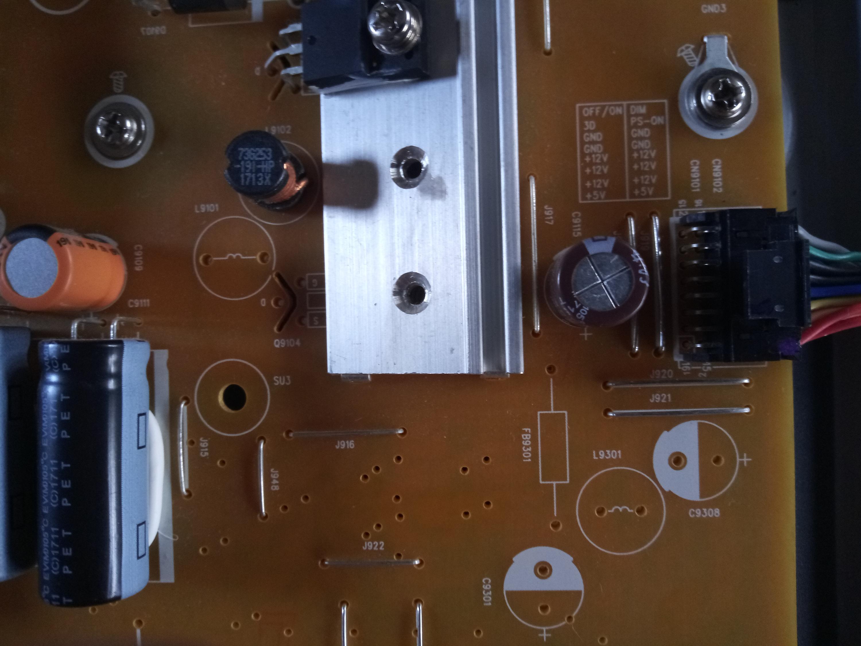

    hi to all,

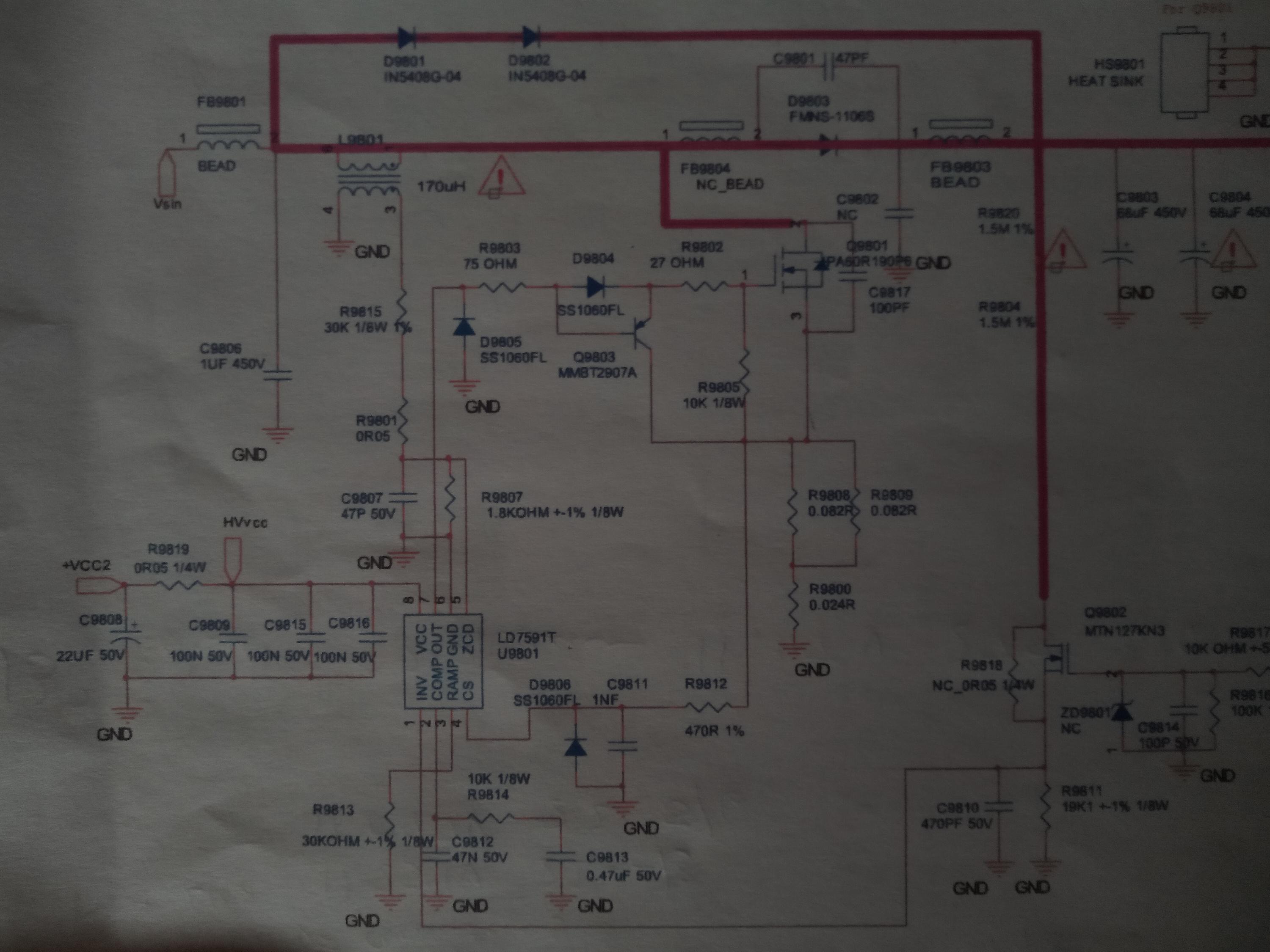

    following on from earlier post ref:no boosted pcf voltage
    i managed to get a LD7591T pcf boost ic
    i now have 385v boosted volts.
    the psu produces 12v ok ,
    (and bear in mind the 5v and 3,3v supplies are produced by the main board not as shown on the psu board markings.)
    now, the tv has no sby led lit ,no backlight voltages
    my thaughts were that ths processor could be faulty,but i wanted to completely eliminate the psu first
    i checked all the supplies on the main board 1,5v,3,3v,5v, they are all ok,
    the psu voltages:
    dim 0v ,
    on/off 0v ,
    ps-on 3v
    i fed 3.3v from main board to:
    dim,
    on/off
    and ps-on
    but still no backlight voltage
    any ideas as to why psu wont give out b/l supply volts?
    am i correctly trying to run psu ,or am i missing something?
  • jimbofz
    • Apr 2013
    • 539
    • uk
    Re: philips 65PUS6162/05 dead no sby led

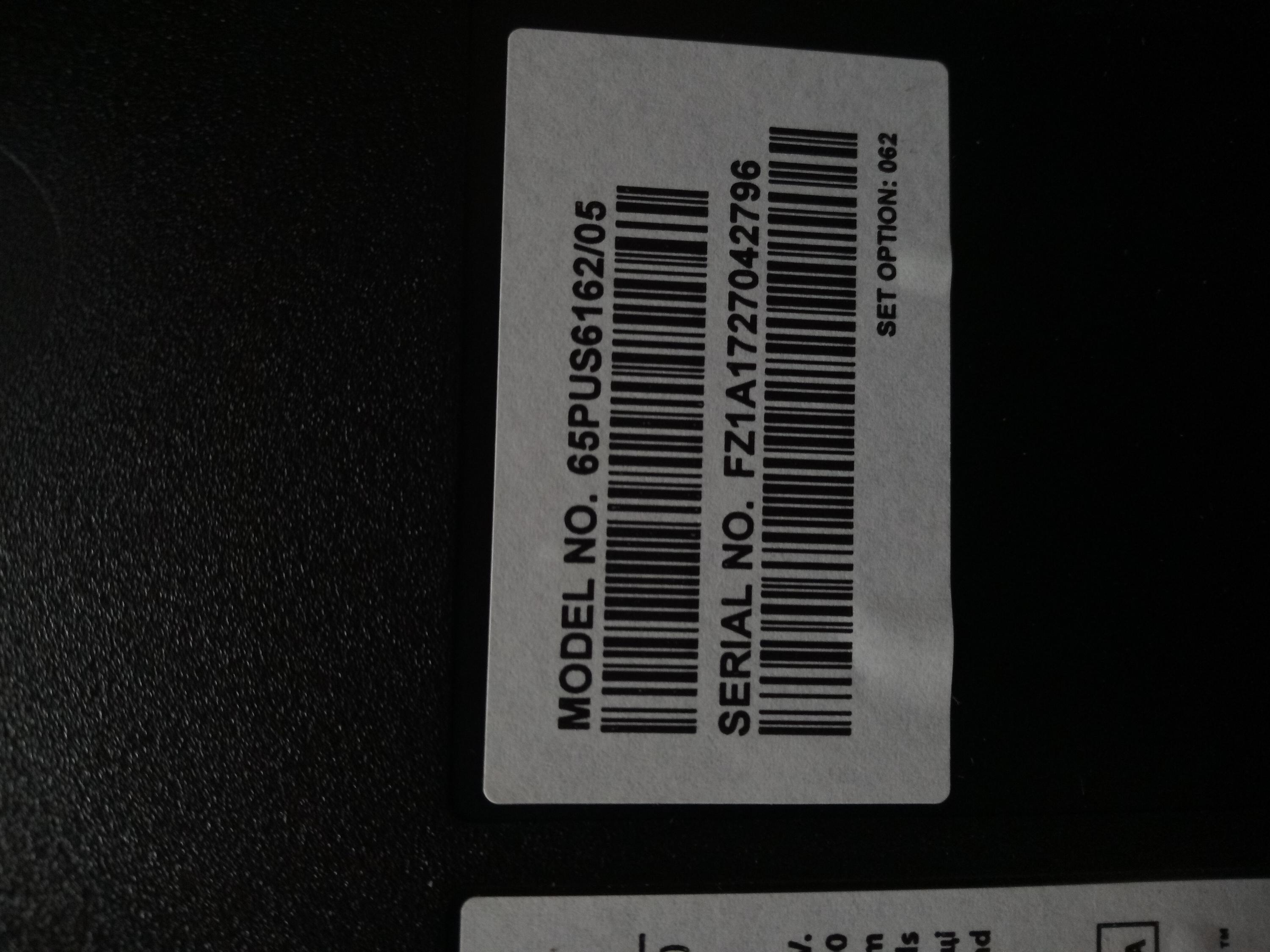

    sorry here are the pics
    the cct is from 65pus 6162/12 version not 65pus6162/05
    i dont know if theres any difference

      last number region designation:
      60 – Russia
      12 - Europe
      F7 - North America
      F8 - Central America

          standby seems a little low, maybe unhook cable from powerboard to mainboard, recheck standby voltage with it off, if it stays the same maybe check that cap right by the connector, D9100, D9102 and the transistor right there by it on the heatsink, can you post a picture of the whole back, as to see how everything is connected?
            the voltage on ps__on when mains connected (no sby lit) is 3v
            pressing the remote or toggle switch at rear of tv does not change this voltage
            because of the design of the psu ,the main board has to be fed 12v to enable any
            of the important supplies to be produced
            my attempt to force on the psu i used a link from the good 3,3v supply on the main board
            and fed it to: ps_on
            dim and
            on/off
            this produced no backlight voltage
            earlier before any posting on the forum i checked all caps with esr meter and for good measure replaced a few that were not 100% cap value
            i also confirmed the vcc1 and vcc2 voltages were good at approx 12v and that the backlight cct or LLC as philips like to call it revealed no s/c or suspect components
            perhaps ,(as philips like to be different )the ps_on has to go low to turn on psu not high as i first thaught?

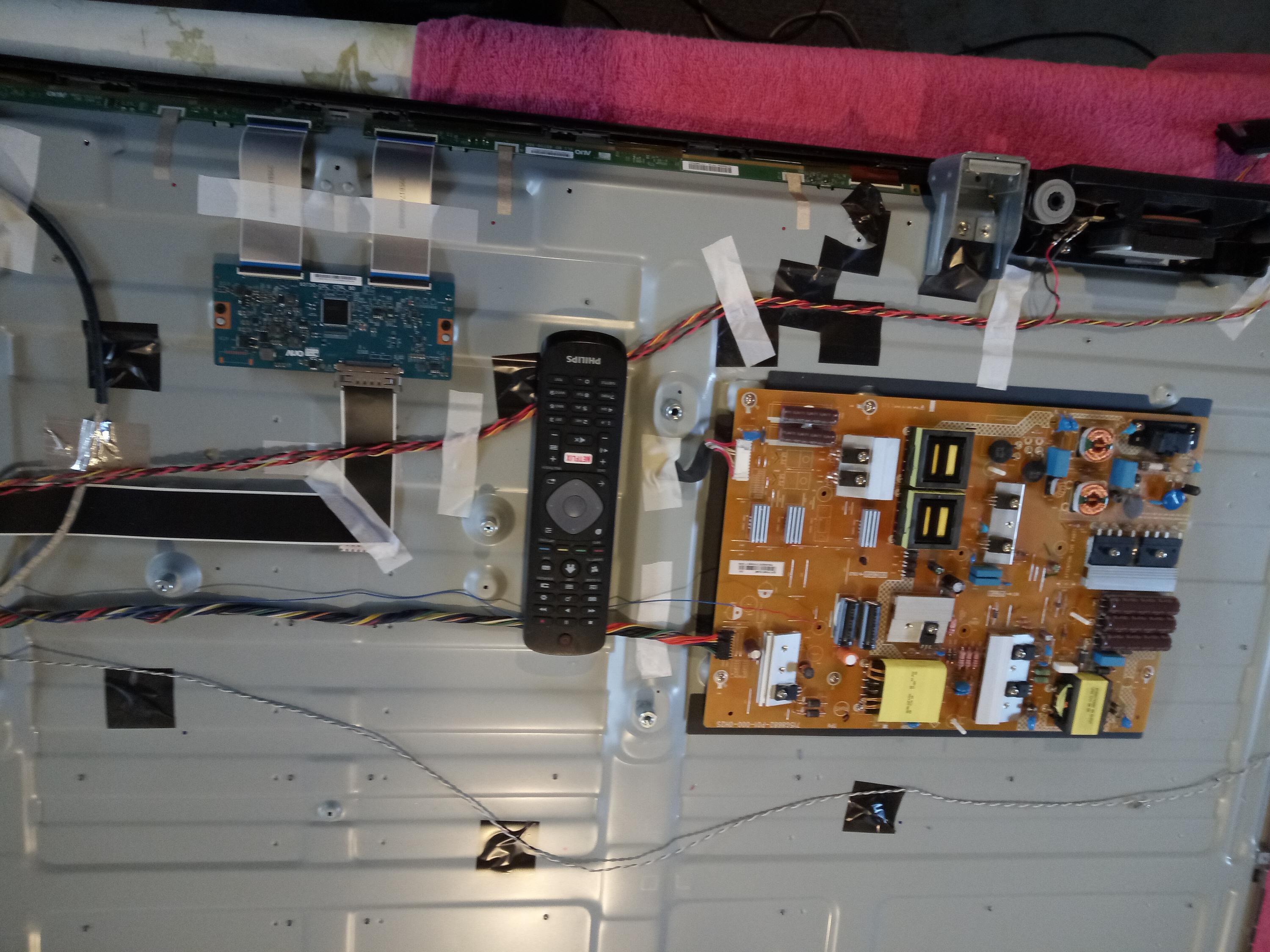

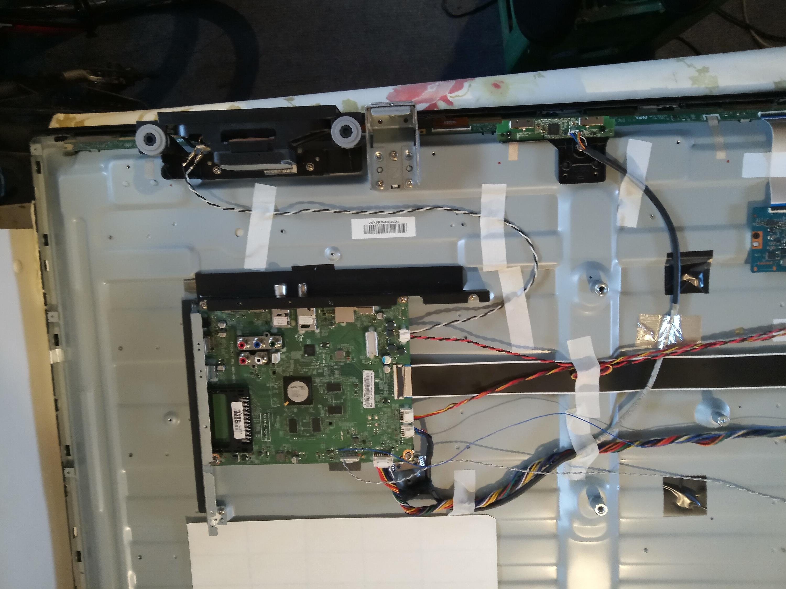

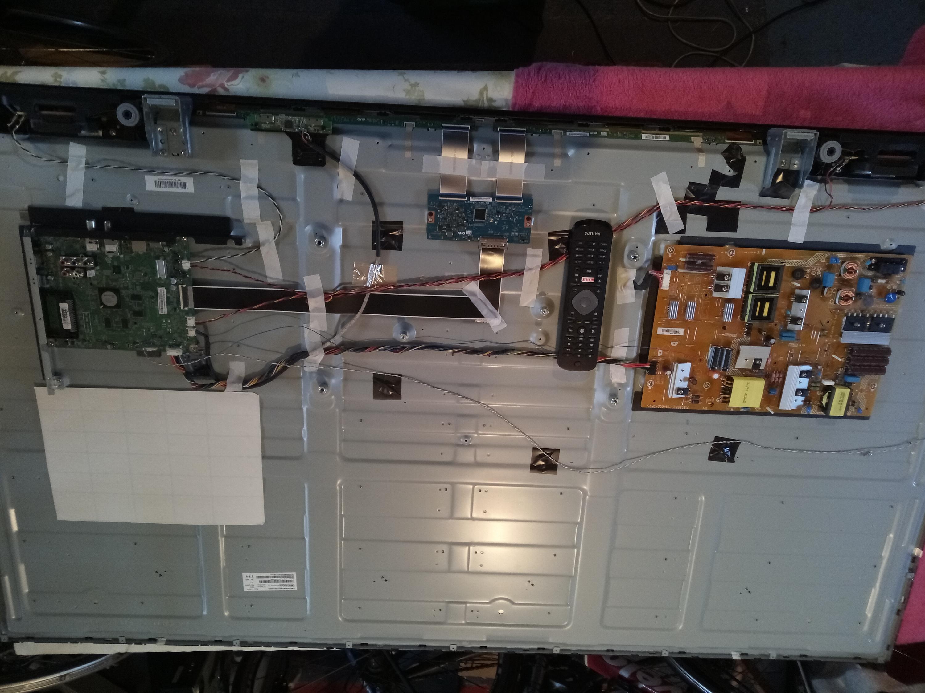

              how bout that picture of the whole back, we don't have the tv on our bench so we can't see it.
              • jimbofz
                • Apr 2013
                • 539
                • uk
                ok oops sorry my mistake

                    i have found the correct cct

                      Ps-on has to change state from standby. Whether from high to low or low to high.
                      • jimbofz
                        • Apr 2013
                        • 539
                        • uk
                        yes i understand ,i just need help /advice how to turn on psu and check if b/l volts are working
                        then i can replace main board
                        or repair it possibly replace micro mt5802 vgej
                        with confidence that psu is good
                        when i use the 3.3v supply to force on psu theres no sby volts as that is provided by the micro hope that makes sense thanks

                          yes makes sense, if ps-on never changes and if you get nothing from on-off pin which is backlight on off, more than likely a mainboard issue, did you try heating the mainboard processor with hairdryer, or cooling the processor, then see if it works for a while.

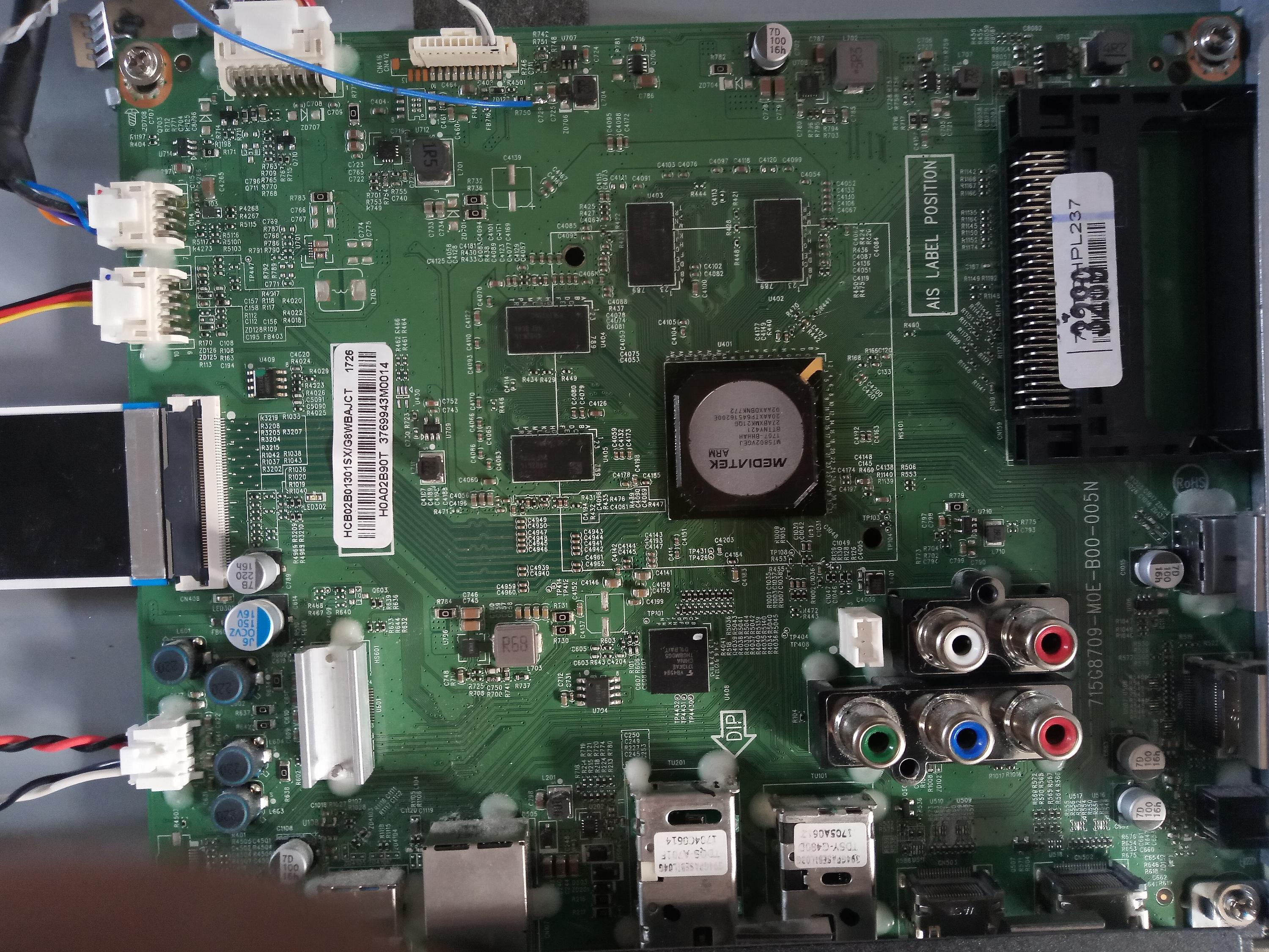

                            WOW you must be a mind reader .just tried that with s/station up to 200 deg for 5 mins then let it cool to room temp sadly no change
                            i know the main board is type :715g-8709-moe-b00-005n
                            theres a number for sale listed with correct model number but board number not exactly the same .are the philips boards identified by the white paper label or the printed numbers on the board perhaps they have to match the screen panel numberas well?

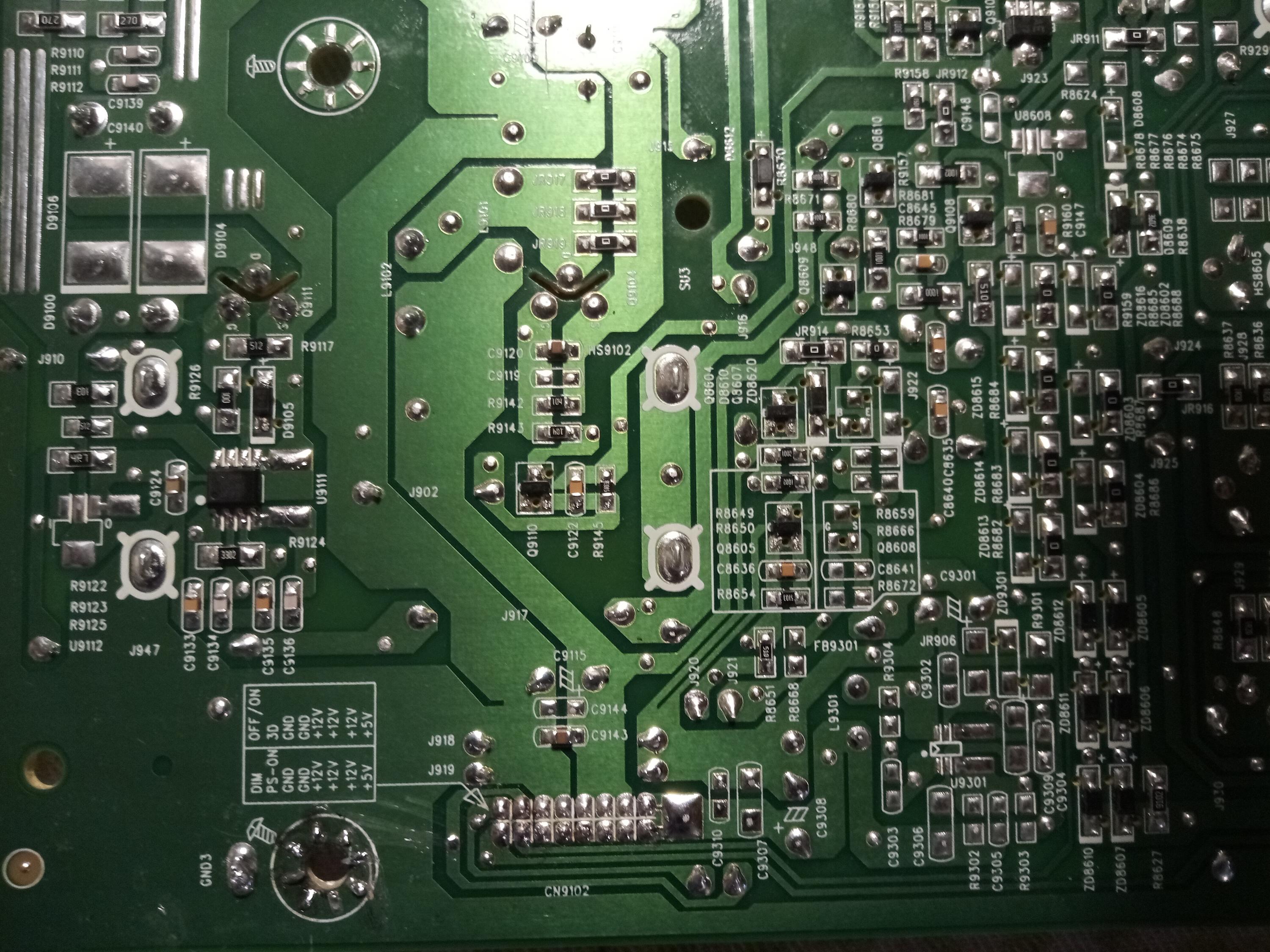

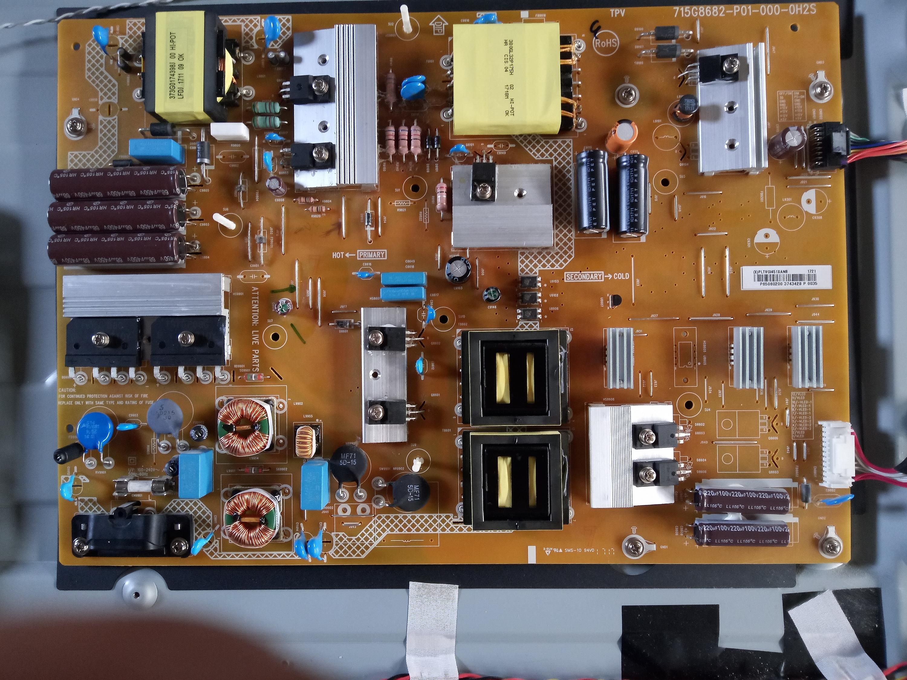

                                it shouldnt be too hard to powerup the powerboard stand alone, can you get a better focused picture of the map/legend of that connector or write out the description like pin 1 +5v or whatever it says?

                                  all yours messurments are at wrong pins lable.. you will never have PS-ON 3V if there are no STB V. you may have STB 3V not PS_ON but there are short / open on MB. so it didnt start.

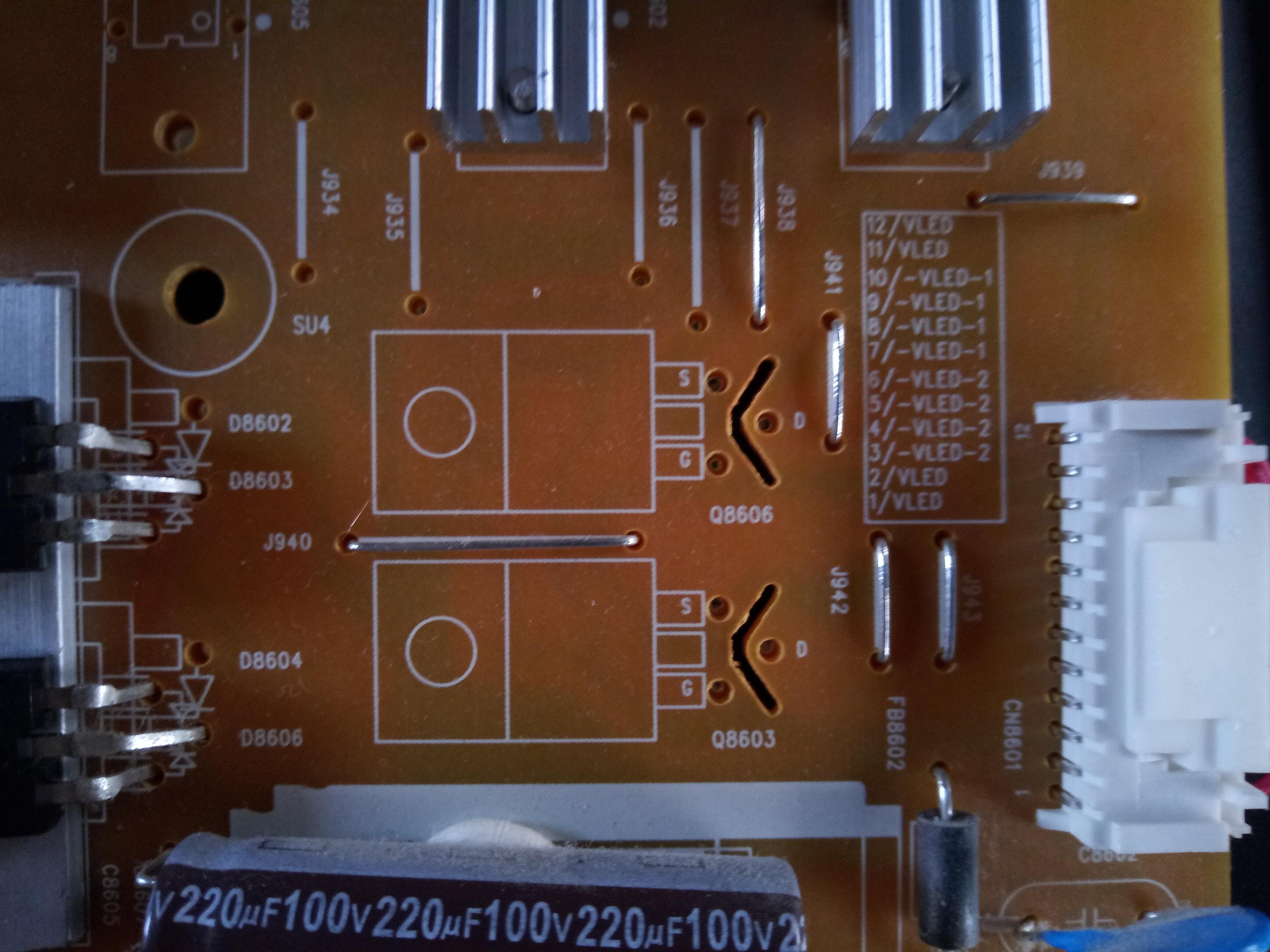

                                    with regards to the legend on the psu there are no components on the board for 5v
                                    unlike most other psu designs the 5v is not produced on the psu
                                    the only dc supplies from the psu are: 12v
                                    and b/l supply which i expect to be around 30v
                                    this is why i find it tricky to force on the psu
                                    the 12v is unswitched and is always present when mains applied ,the 3 pins that are used to control the psu state are :on-off, dim, and ps-on.
                                    when the tv works normally the main board produces the above voltages
                                    now the fault i have is the 12v fed to MAIN board does produce on the test points shown in manual ,5v sby ,5v, 3,3v 1.5v these are on coils: l701, l704. l702, l803

                                        are you saying now if you just plug the PSU in wall socket with out main board plugged in.. PFC boosted and you have 12V on the socket and the main cap +380V???
                                        so what will u9301 of power saving will do ?? did you checked all 3 Opto are fine no one of them are shorted?
