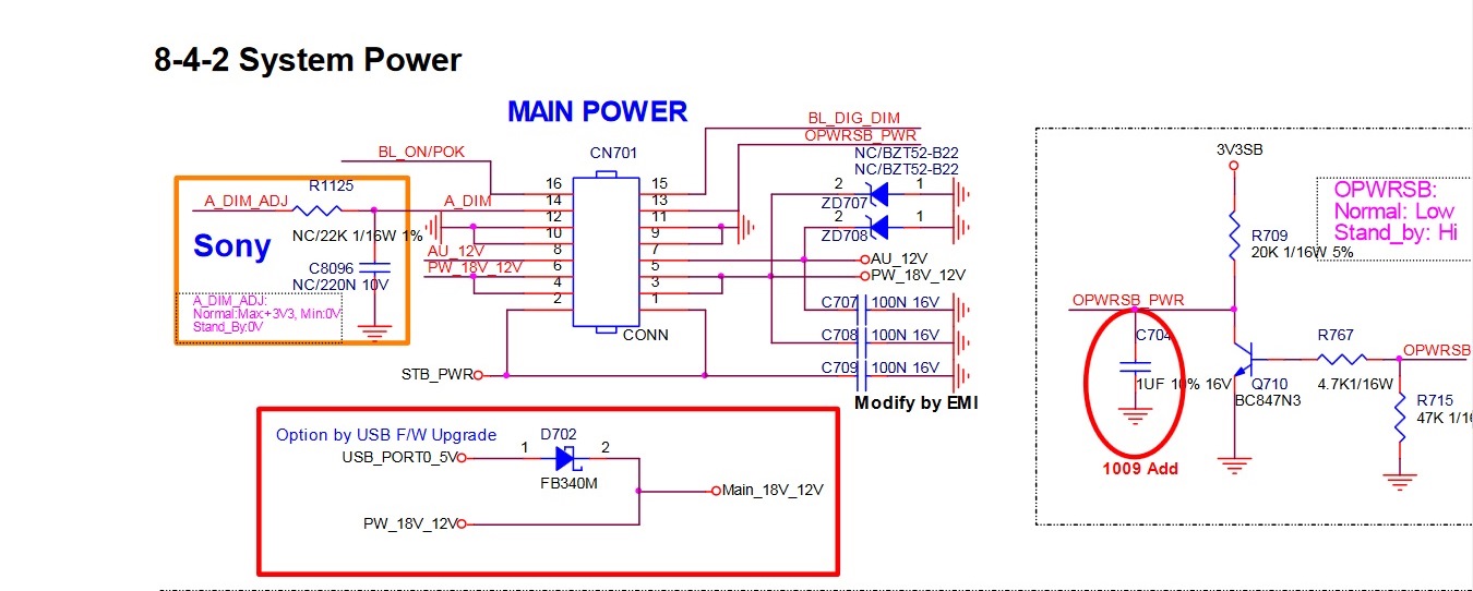

              BTW . let bring things in correct way.. this is yours Service manual.. on page 48. we can see the system power on the MB socket will be.
              STB will be only 12V on pin 7 & 8 =AU 12V ( this remain 12V )
              after the eeprom start script load will send the signal PS_ON from PIN 13.
              then on PSU PFC go high and should produce 12V high 18V-12 inter MB socket on Pins 3/4/5/6 = PW_18V_12V.
              PS_ON you said you have... so check the pins 3-6 on MB if they are high >12V. if not PSU problem. and this why no Panel VCC 12V on T-CON

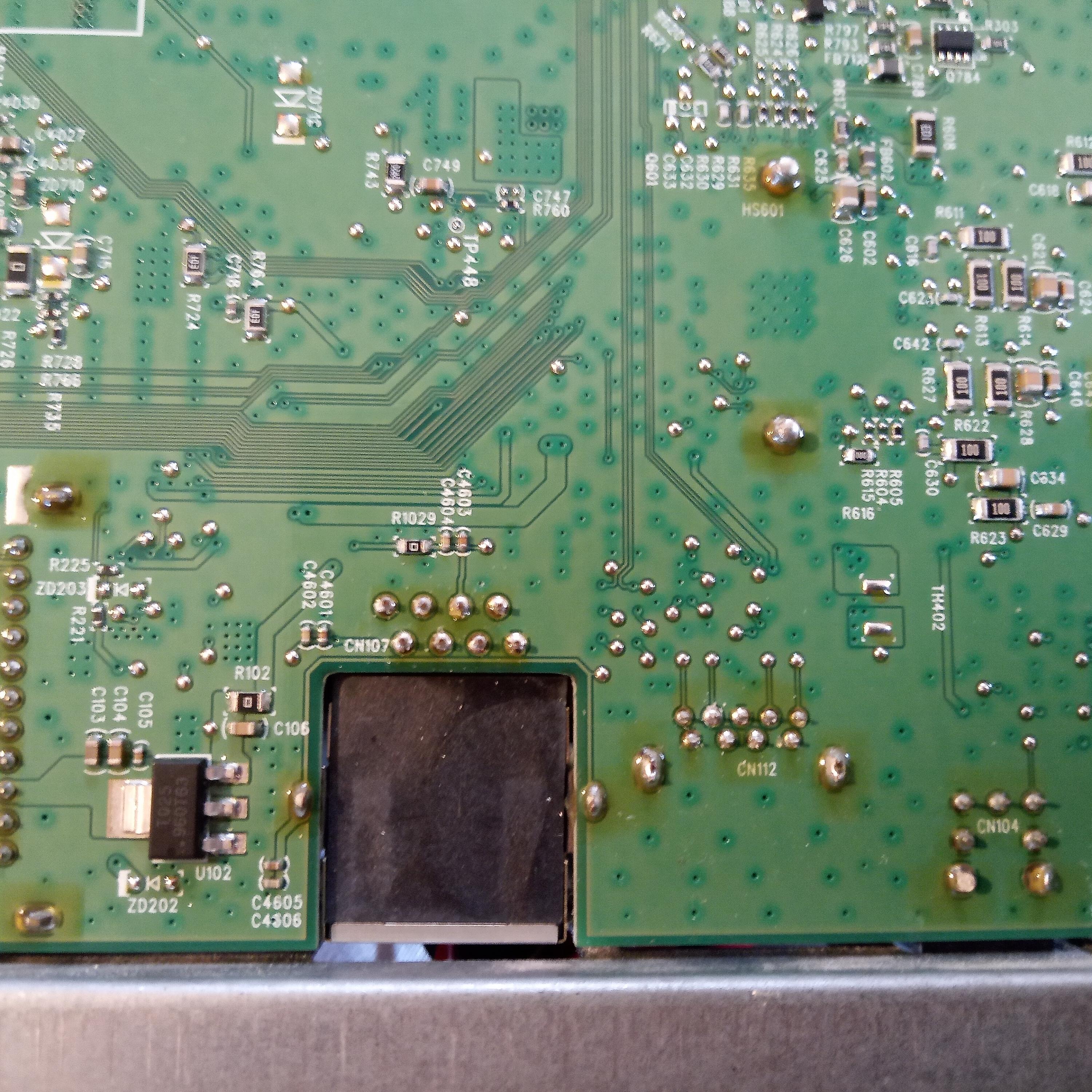

                on the underside of usb2 socket there are 9 contacts
                two rows CN112
                5 and 4
                to the right of the black internet connection CN107
                theres no voltage on any of these pins
                see jpg
                pins 3-6 i dont see any change in 12v it measures 12,4v
                where does the 18v come from?

                  read my post above.. your PSU didnt give 18V_12V high on pins 3 4 5 6..
                  take yours PSU out on the table and run it as stand alone... from 12V with R2K !w JUMBER IT TO ps_on:: ps_oN WILL TAKE THE CURRENTS IT NEED 3.3V and it should produce other pins 18_12V high.. .
                  Be carfull.. you should know exactly the pins of AU_12V and PW_18V_12V on PSU socket

                      read my post #46 first.. and open page 48 onS.M to take look on MB socket ( system Power ) , on this socket 3-4-5-6 should have PW18V_12V after TV turn on.
                      PW18v_12V dosnt mean exactly shoild be 18V . but its range of main power DC will be bossted as much the MB need forexample speaker run on high vloume..etc,
                      we dont care now on howmuch... but we need to know if the PSU produce this PW18V_12V or not..
                      if not then you need to work on the PSU as stand alone to touble shooting it. if there are PW18V_12V on the MB socket 3-6 mean your PSU OK.

                        PIN 7/8 AU 12V this is always remain 12V like STB
                        PIN 3/4/5/6 PW18V_12V this go high after the PSU PFC goes high ( after PSU recieve PS_ON .

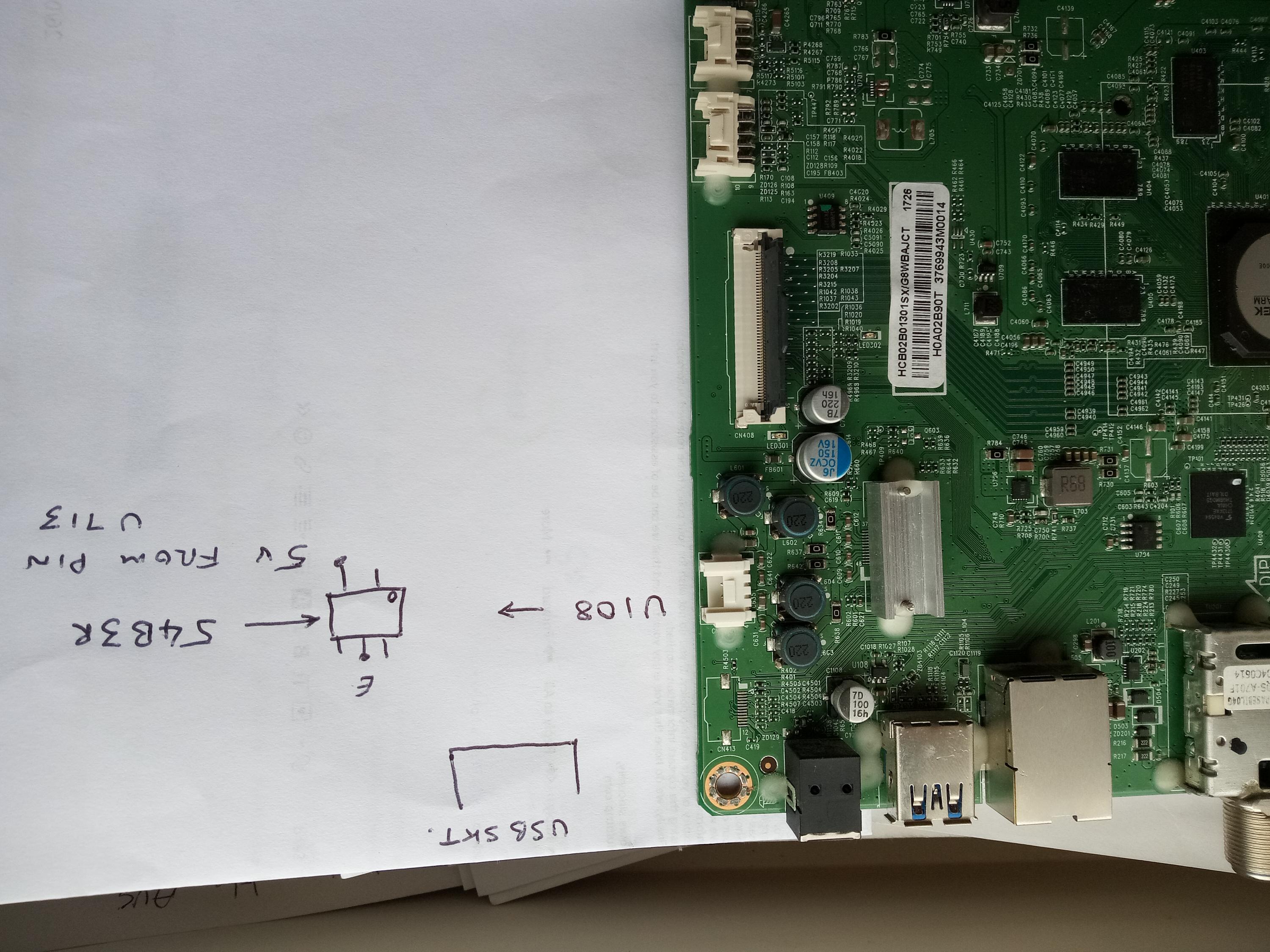

                                Re: philips 65PUS6162/05 dead no sby led
                                heres the jpg
                                i traced the 5v from u713 to u108 ic 54B3R
                                this lives in corner of board near to usb skt this ic i suspect is not turned on so no volts on usb skt
                                sorry image upside down even though it was uploaded correct way up

                                  Originally posted by jimbofz
                                  heres the jpg
                                  you need to plug in USB stick and do the messurments..
                                  U108 recieve 5V on Pin5 and V out 5V on Pin1 if Pin1 <0 and the IC get warm mean you have short at some USB sockets. if its not geting warm mean IC are Open

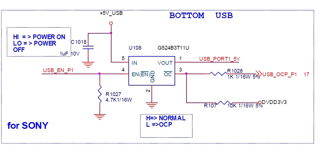

                                    heres the results;
                                    pin1= .18v pin2=earth pin3=3.3v pin4 = 0v( on enable pin) pin 5=5v
                                    without enable pin active no o/p to hdmi skt
                                    surely the processor needs to turn on this ic with enable pin4? so no enable means no o/p?
                                    i tried with usb stick and without
                                      heres the results;
                                      it means Analog power circuit on MB are fine... but the digital are fault
                                      2 ways u have now..
                                      capture start log from UART port on S.M you have the sign of TX & RX to see where are the script stooped and give error..
                                      or go direct reflew urs MTK chips before u are going to replace MB
