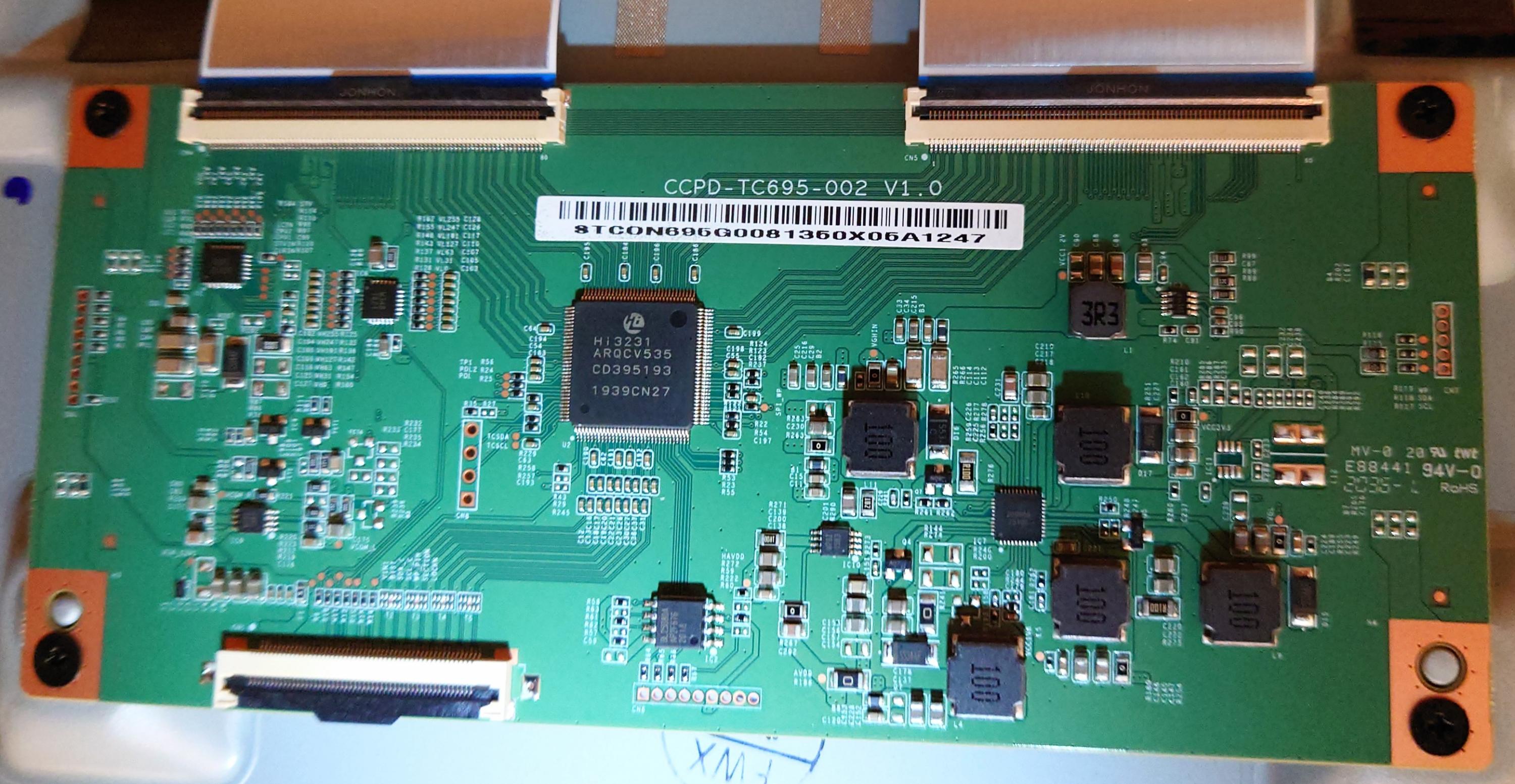

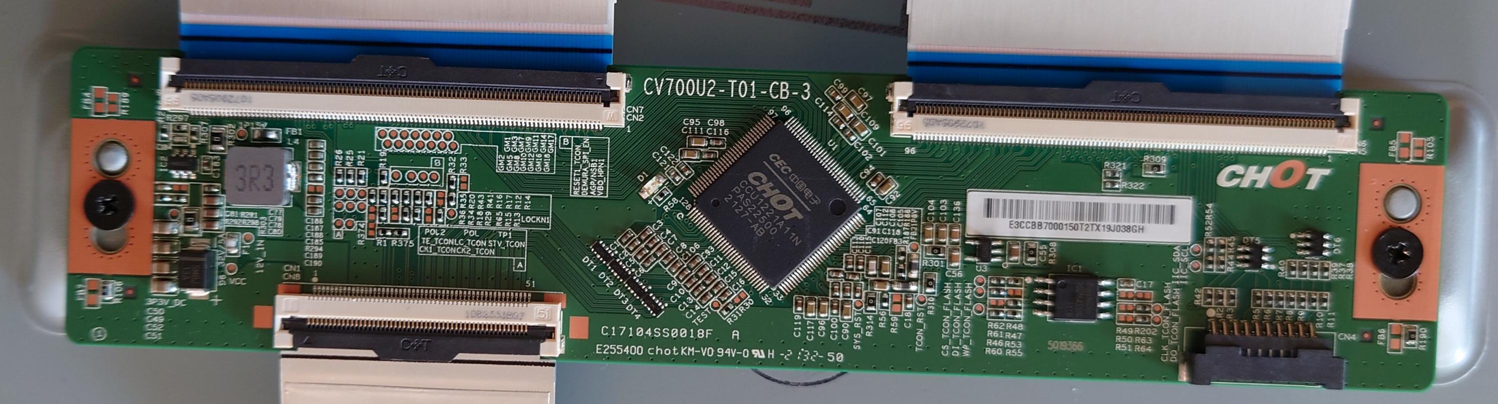

          Today the repair guy arrived with a replacement panel.
          He took one look at the symptoms on the screen and concluded that this fault is in the panel so it all had to go.
          In fact, he brought an all new chassis with the PSU- and SSB-boards missing including the internal cable harness, so those were swapped over from the old chassis into the new.
          He said that the TCON-board is actually part of the panel assembly, and that it was an LG panel.
          The replacement panel was a newer version with a very different TCON-board.
          The old TCON-board looked like this:
          The new TCON-board looked like this:
          This was the internal label on the old chassis:
          This is the internal label on the new chassis:
          Afterwards, the picture was stretched and doubled horizontally, so he entered the menu and went to set the new Panel ID 147 as was specified on the internal label.
          But the range of values only went up to 24, so that was a bust.
          The old value was 5.
          He had to call someone to look it up, they asked if the TCON read "panda" or "chot", and since it was the latter, they said the correct value can be either 5 or 9, so he set it to 9 and that worked.
          The old chassis would be sent back to the factory in Poland, he said.

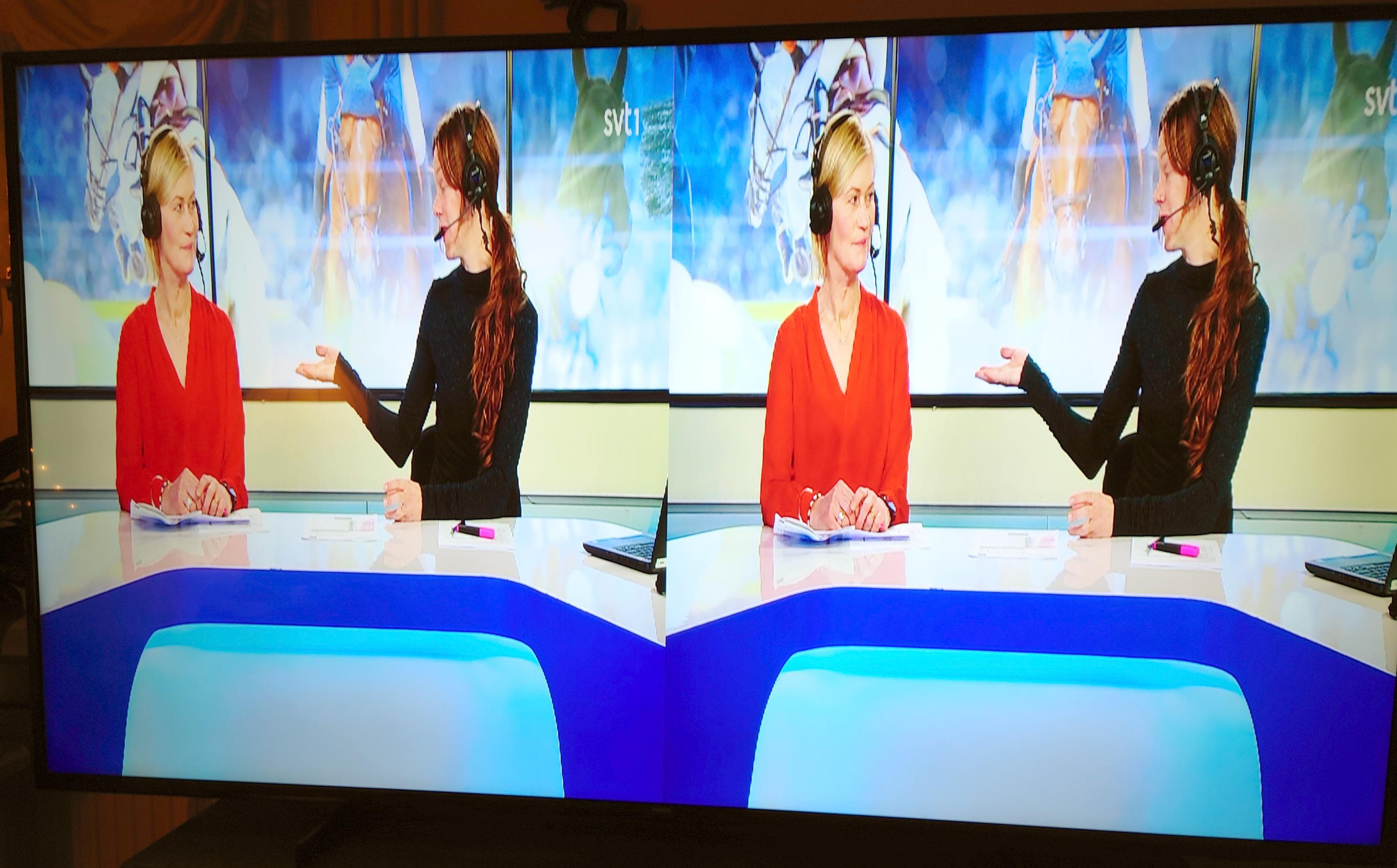

              I've got an update on this TV.
              Last night, while my mother was zapping channels, something happened with the picture and she's too old explain it, but suddenly she had this kind of picture:
              The picture was compressed to 50% on the horizontal axis and doubled.
              I was over there today to see what's going on.
              I tried all the basics; power cycle, different sources, different resolutions, nothing helped.
              The Error Buffer was empty too.
              The problem solving flowchart in the service manual ends on "take photo", same as last time when the panel had to be replaced.
              So there was nothing to go on, however, I remember when the repair guy started the TV for the first time after the panel replacement, that this was how the picture looked like.
              He had to set the Panel ID to the correct value through one of the service menus, after that the picture was good.
              I thought I'd better verify that setting, which was a bit confusing because there is also something called "Panel Code" which is one of the listed values in the Customer Service Mode menu, but it is not the same thing even though the value is similar.
              I found the correct parameter in Factory Mode (you have to be very fast with the key sequence on the remote control to enter this mode!), it's listed there as PANEL_ID.
              The value was 10 instead of the expected 9.
              In binary that's two bits of difference so I wonder what happened there, I'm assuming these fundamental settings are the ones stored in the SPI EEPROM.
              I changed the value to 9, scrolled down through what looked like almost 100 parameters to select EXIT_FACTORY at the far bottom of the list and then turned the TV off and on again with the remote control.
              Afterwards, the picture was back to normal!
