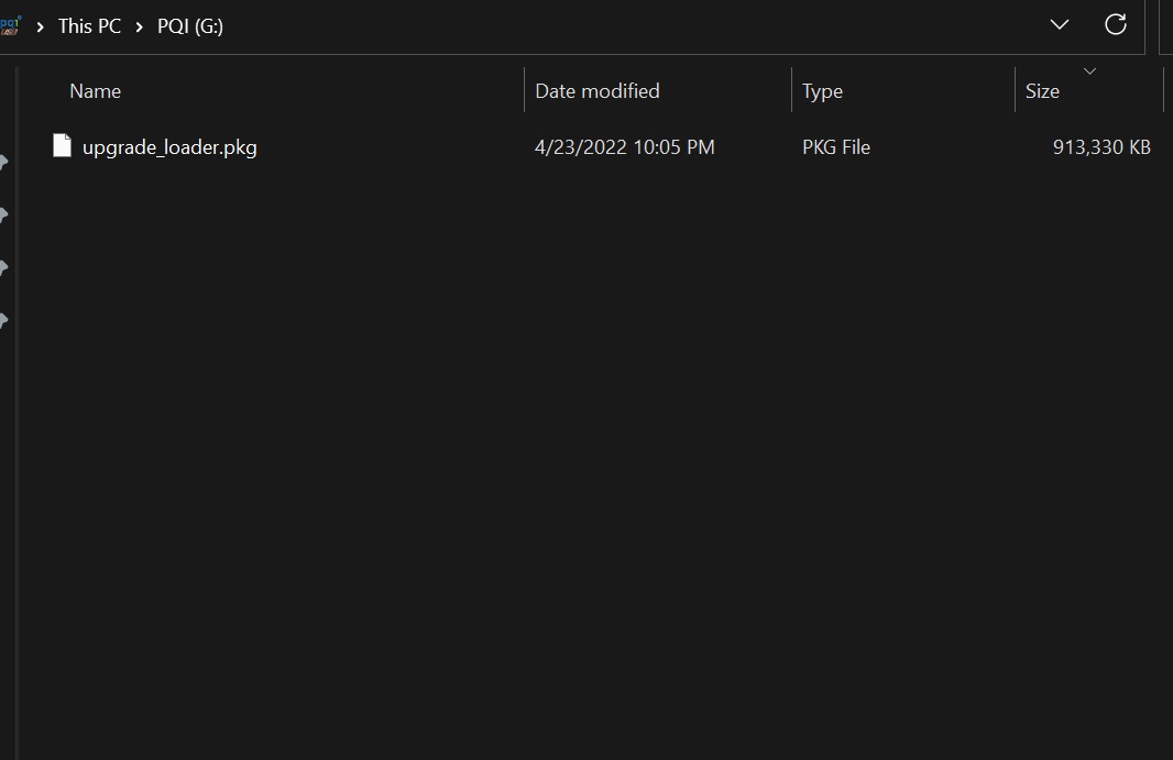

    rename the file from ( upgrade_loader_no_tvcertificate.pkg ) to upgrade_loader.pkg and start with point 7.
    be sure yours PC showing the file extension to avoid written double .pkg.pkg

          It did not work Diah. It is the same as it was before.

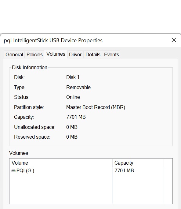

            the rename supject of the file must be 100 done. what kind of stick you have ??? stick should be MBR mode
            shoe me the properties of yours usb stick and the file inside it

              if the USB stick are MBR mode formasted FAT32 and the file on it in name upgrade_loader.pkg and it didnt work to have screen of upgrade prosees... mean yours TV went to shut down as it had HW issue 100% are led backlight, one or more are defect.

                It is in MBR mode. It is 8GB, I think it is USB 1.0, definitely not USB 3.0.
