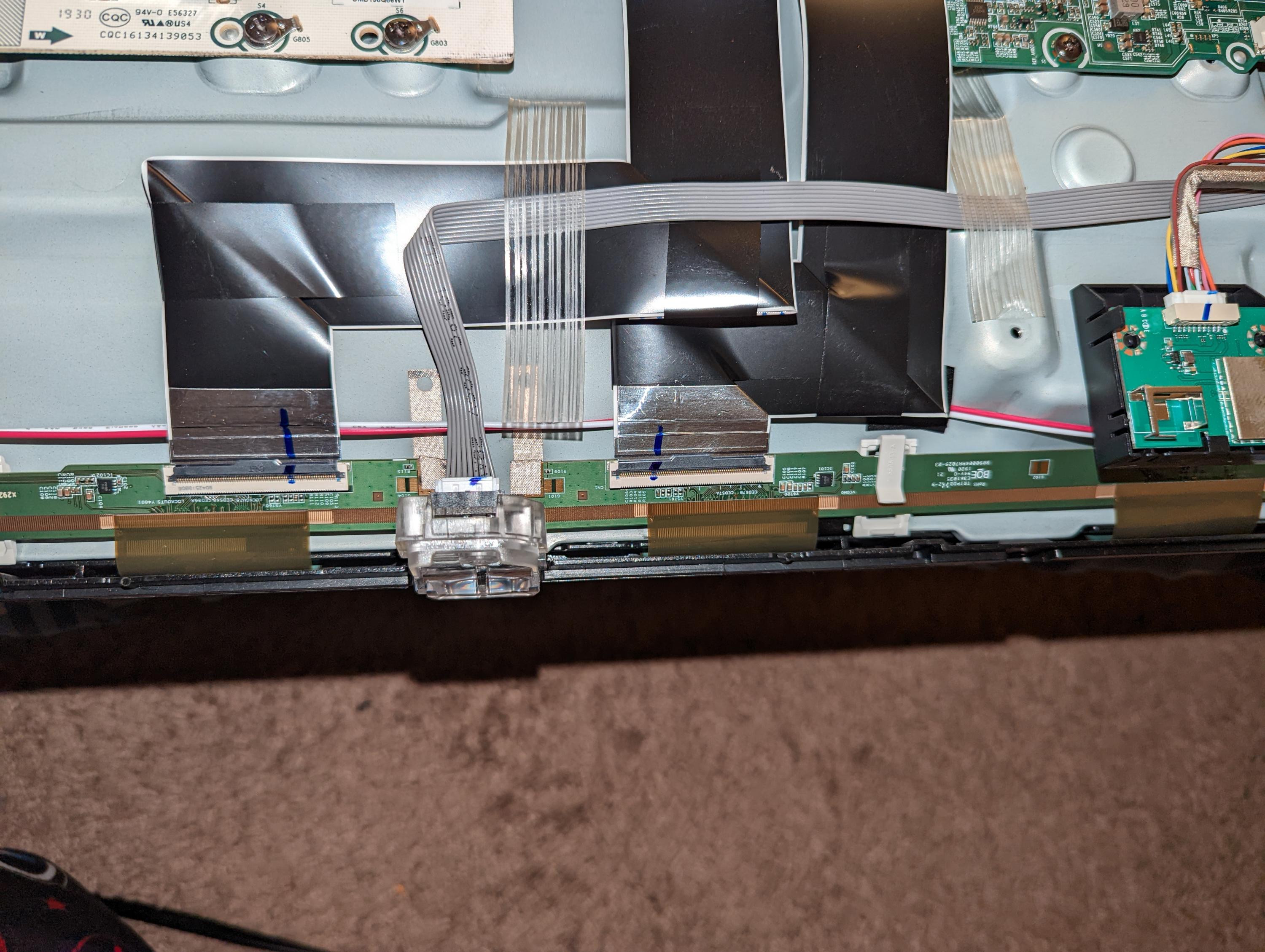

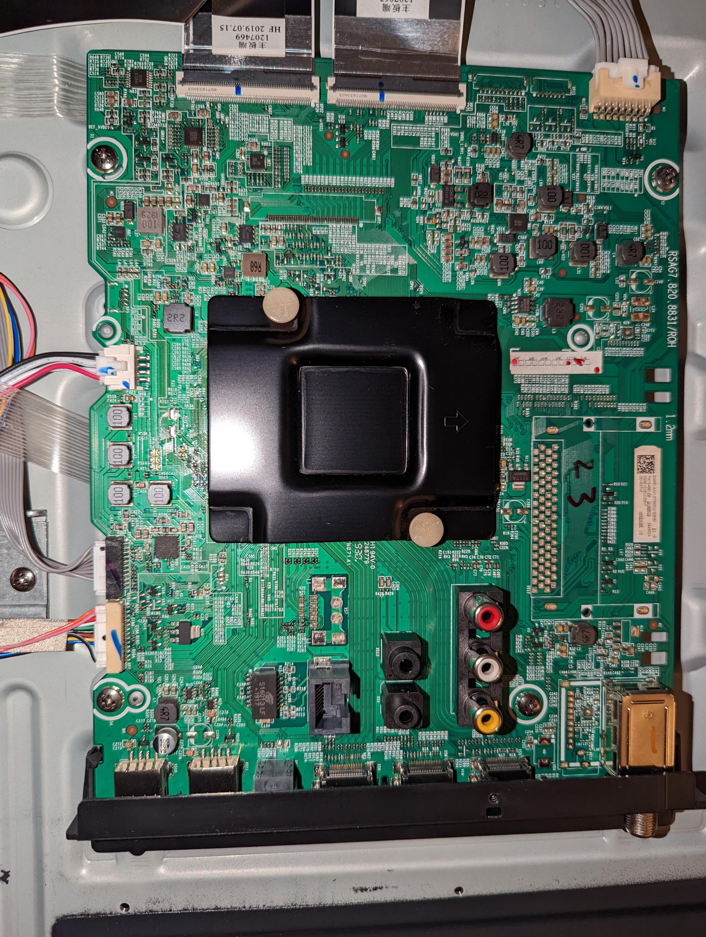

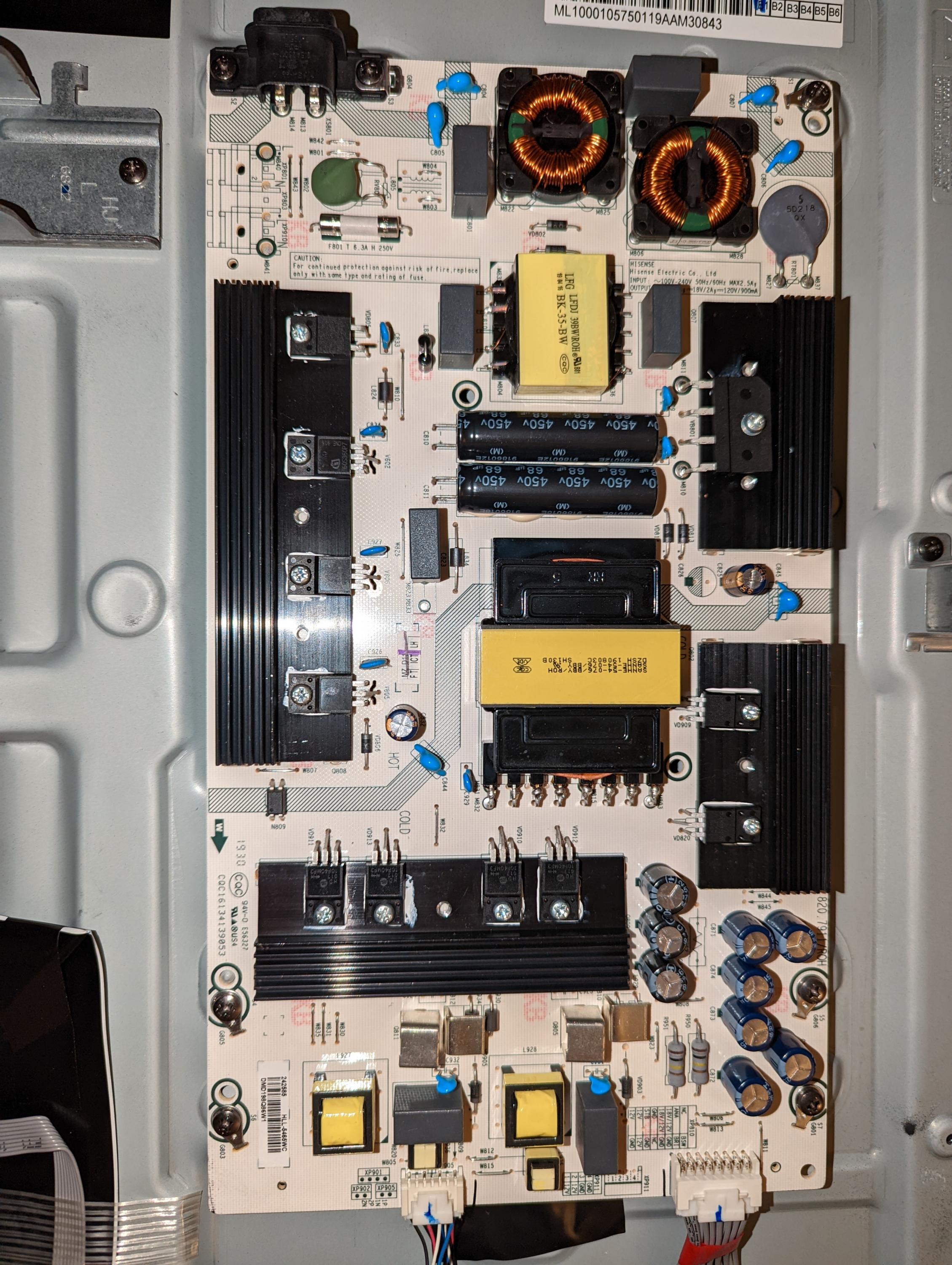

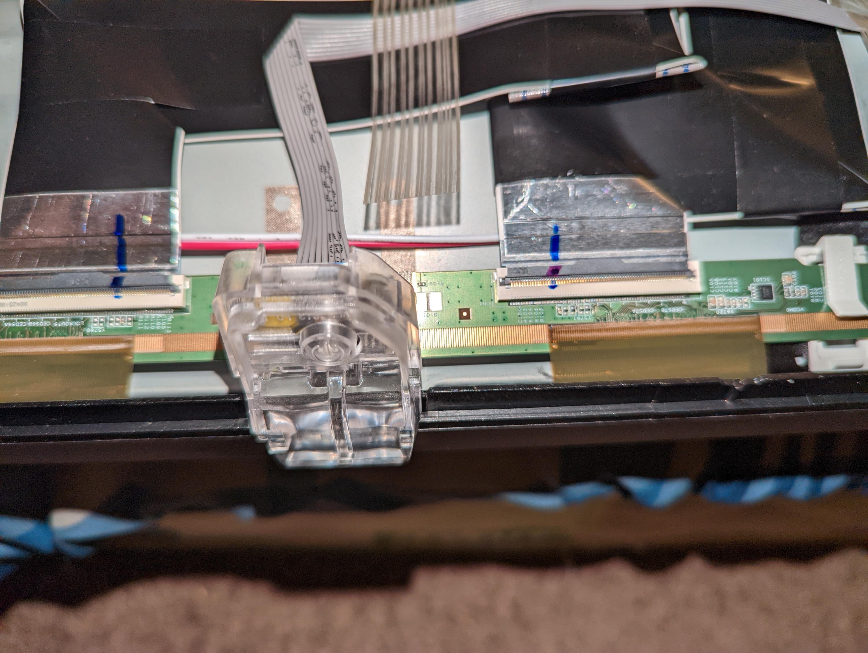

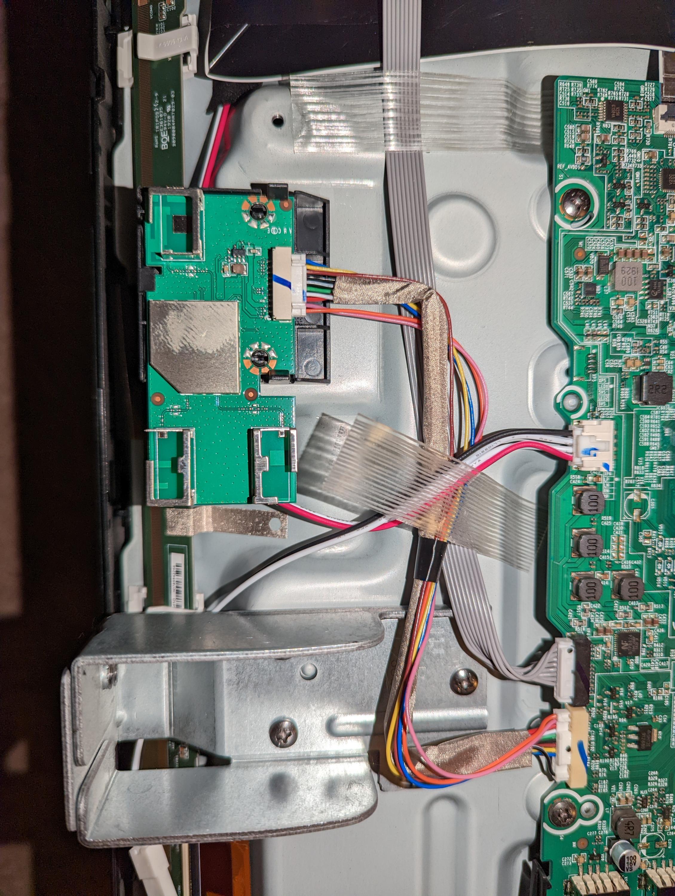

      Re: Hisense 65H6570F Logo shows then turns off
      These are the pictures of the boards.

                    at this point dont do SW with USB untill we be sure we dont have HW problem.
                    lets try to remove load from the MB, disconnect the wifi/BT module socket from it and turn on see any different, if no change
                    we need to see the print chart of the BL socket wiring.. on the top are not clear just they put P1 N1/ P2 N2. look from the downside of the powerboardss and show me here the circuit of the BL. also be sure the socket solder are fine and tell howmany wires you have on the socket.

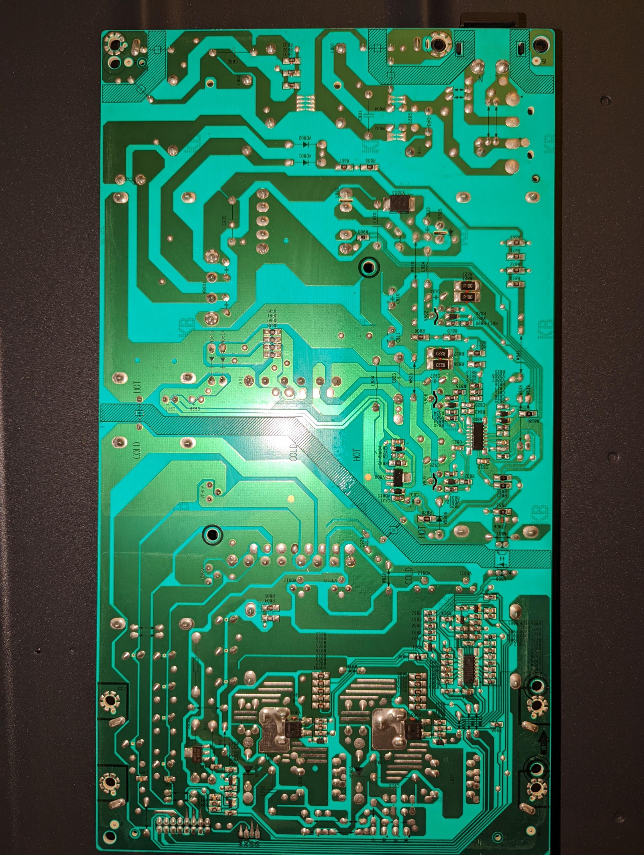

                      1. I removed both the BT/wifi module and the speakers, no difference.
                      2. I only removed the BT/wifi module, no difference
                      3. There is no voltage charts. Pictures of the top and bottom of the powerboard is attached. There are 4 wires in the BL socket.
