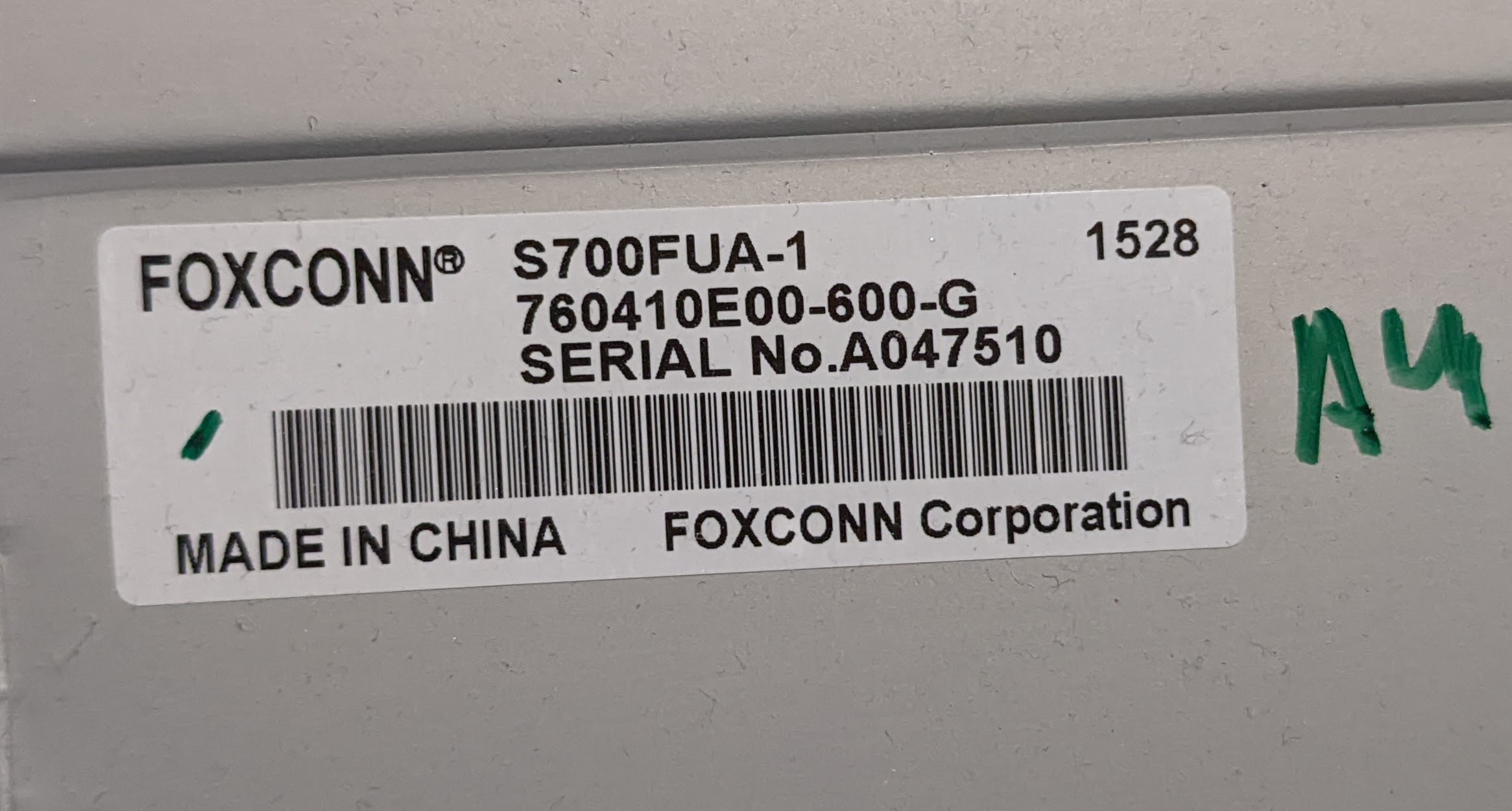

          what is the panel number of the tv? should be on a sticker on the chassis someplace.
                Is this the right one? See attachment

                  Re: Vizio M70-C3 ... Help with Diagnosis
                  ok, from what I see, I think both those boards will work, look here, notice it says these boards will work too and there's an arrow to even more beside it, looks like several will work: https://www.shopjimmy.com/vizio-y838...trsyar-serial/
                    OK thanks for checking on this. So sure sounds like the boards I received are compatible but unfortunately bad.

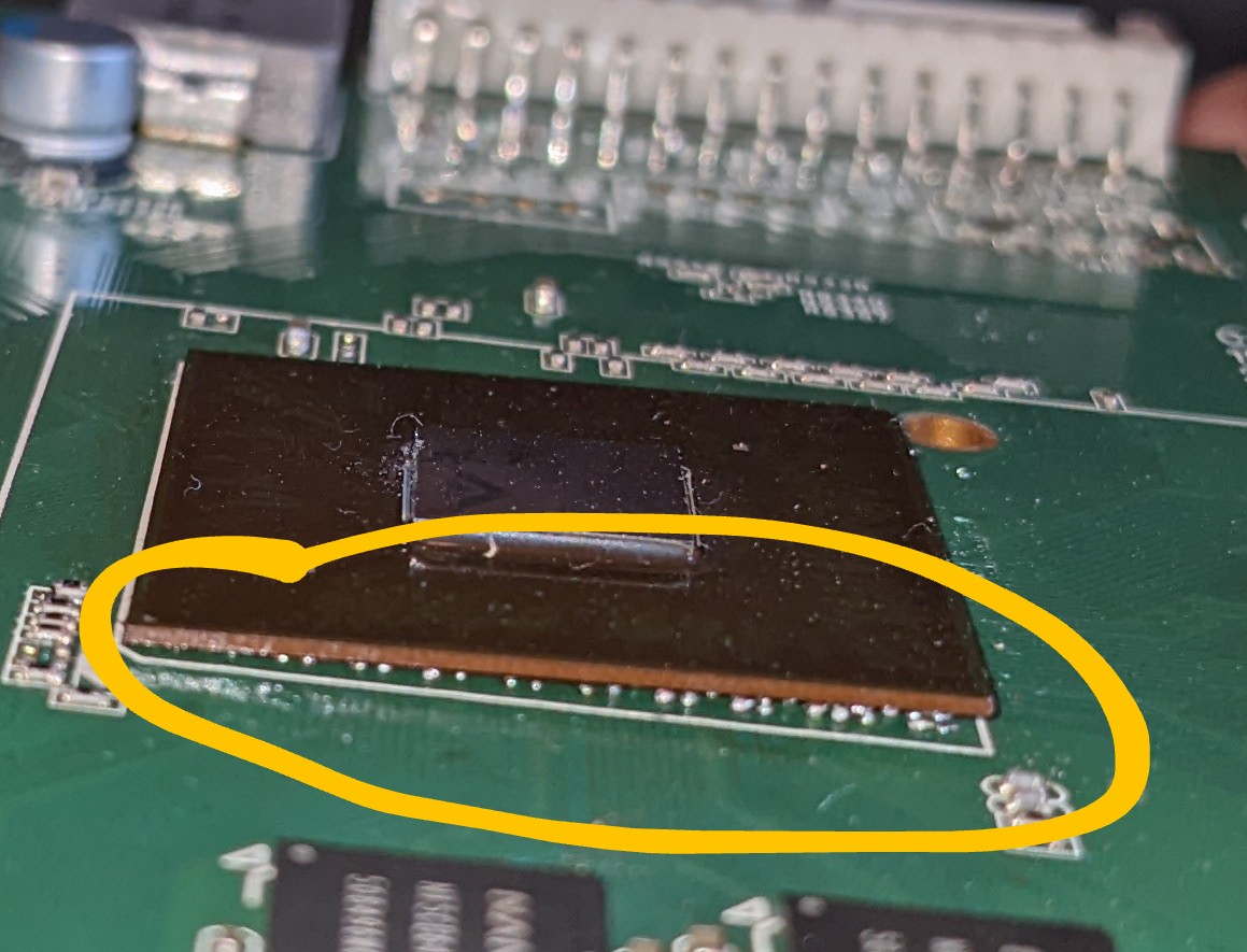

                    So now going back to the reflow method and the original picture of my board... how do I handle the plastic covering the chips? Without removing them it seems I wouldn't be able to get the flux around the actual chips and possibly not hot enough?

                            Sorry to hear about your reflow. I took a look at that thread and has a lot of great info. I didn't seen anything specific regarding what looks like a protective plastic cover over the two main chips. I'll post over there and see if they have any thoughts. Seems like for a successful reflow I would somehow need to remove that to get flux in there. But who knows maybe I am not understanding what I am looking at. Thanks again
                                There is no plastic cover, that's part of the chip. The white square on the PCB denotes the edge of the chip. You should be able to see a tiny gap between it and the PCB.
                                    Thanks diff this is where I was getting confused. I wasn't expecting the chip to have that semi-clear look to it around the black center.
                                    So an update... I reflowed the first chip, seemed to go well, reflowed the second chip and unfortunately slightly bumped the board right at the wrong time and the chip slid of the contacts a bit. I tried to do my best to realign but either way not good. Feel like its pretty much impossible at this point without more professional tools to get the chip back on in the correct spot without any issues. I think for now I am going to completely remove that chip and clean everything and then figure out the best method to DYI this chip back on and cross fingers. Obviously at this point this TV is a loss but I appreciate this forum and all of the great support and users. I hate throwing things away if they can easily be fixed plus the learning and fun that is also is involved with it.
                                    Attached the picture for fun, so you saying there is a problem here? Haha
                                      i believe flux and hot air should float it back into position
                                        It wouldn't be hard to get back into position but it's likely some of the balls are jumbled at this point.
