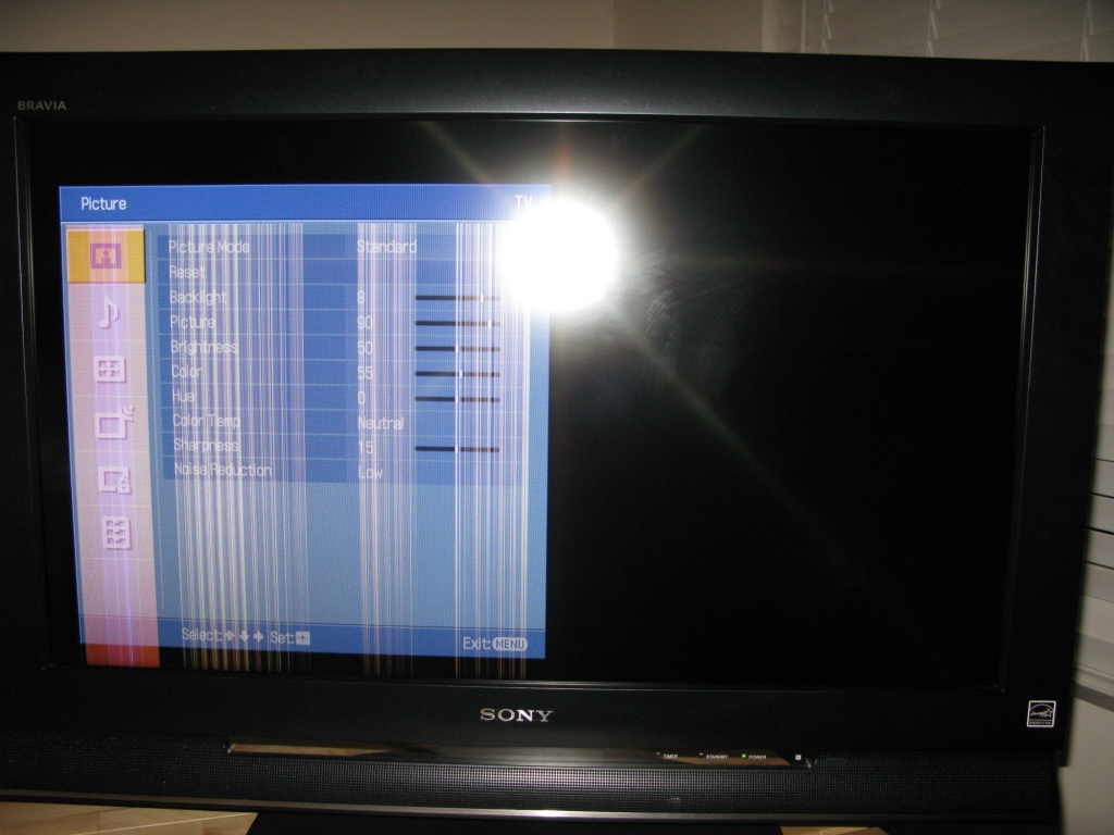

    Haven't opened and taken a look yet, but powered it up and saw some vertical lines. The strange thing about it is that the vertical lines don't appear right away. When first powered up, the screen is clear -- but when you open a menu or see any text display, the vertical lines "bleed" in over 5-10 seconds or so. Also, the top 1/6 of the screen doesn't seem to be affected (the lines only appear in the lower 5/6 of the screen).
    Conventional wisdom is that vertical or horizontal lines are indicative of a panel problem, but hoping that there's something that can be done to save it. Attached is a photo after about 15 seconds of being powered on. Is it worth opening and taking a look around?

      Thanks for the reply. As far as I could tell the warranty for this model is only 1 year, and it was purchased April 2008. Sad to see an LCD TV from a major manufacturer last only 2 years!
        Re: Sony Bravia KDL-32L4000 vertical lines
        What does a video input picture look like or other input program source look like? I don`t think the pdp is bad. I would check all of youer ribbon cables connections first any patterns are board related and not always pdp related.

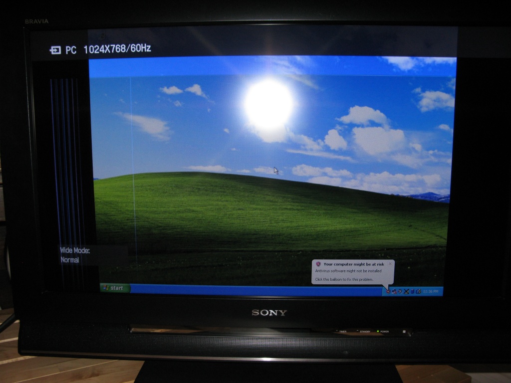

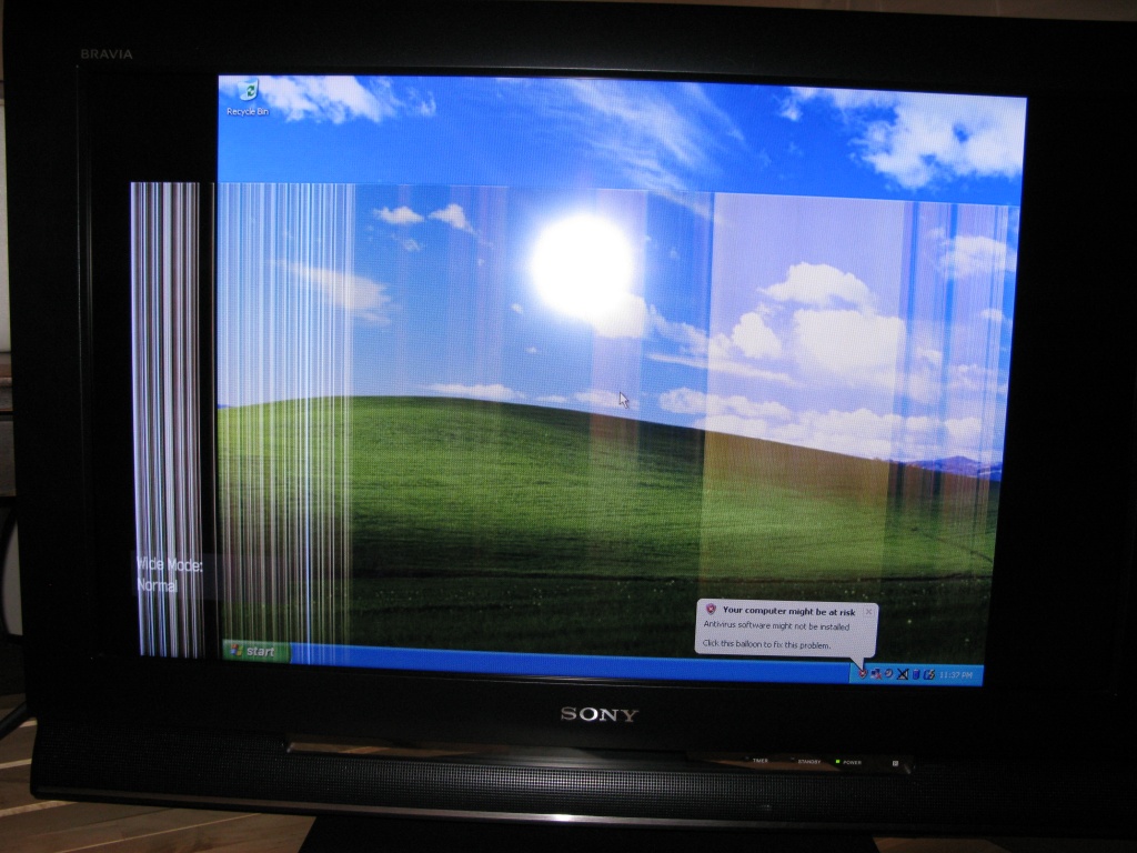

          Thanks -- I plan to investigate a little more by opening it up and taking a peek soon. In the meantime, I hooked up a laptop to it via the 15 pin D connector, and here's a couple more pictures of what happens after 5 seconds and 15 seconds of being powered on.

            I had one of those doing stuff like that to me... and "ghosting" the image.
            A new TCON board fixed it.

              Thanks for the input, I appreciate it. From what I've read, the TCON board (on this model and serial number range) is integrated into the panel and not replaceable separately. Still hoping to find something else serviceable inside!

                  Thanks spacesnow (hmm.. is that "Space Snow" or "Spaces Now"?). I finally had some time to open it up last night, and found that the TCON is definitely not integrated into the panel like the Sony service manual stated. So far, the cheapest I've been able to find is about $60 shipped... but I think it's worth giving it a shot!

                              I have a unit in with similar issues, wondering if a TCON is going to fix it. Wrog, can you try gently applying pressure to the plastic interconnect tabs coming from the small PCB above the lcd. (must remove metal bezel and support LCD panel if turned upright, otherwise it will fall out!)
                              These tabs sometimes become defective, apparently the glue fails? They get pretty hot in operation.
                              There is a thread and videos about the tab bonding issue here: http://www.avsforum.com/avs-vb/showthread.php?t=1173106
                              Unfortunately, this doesn't appear to be the issue with my set. I poked at everything trying to illicit a response to no avail. (including all chips, looking for cold joints) Problem persists with inverter unplugged, so the inverter is not causing noise issues as was suggested in a similar thread.

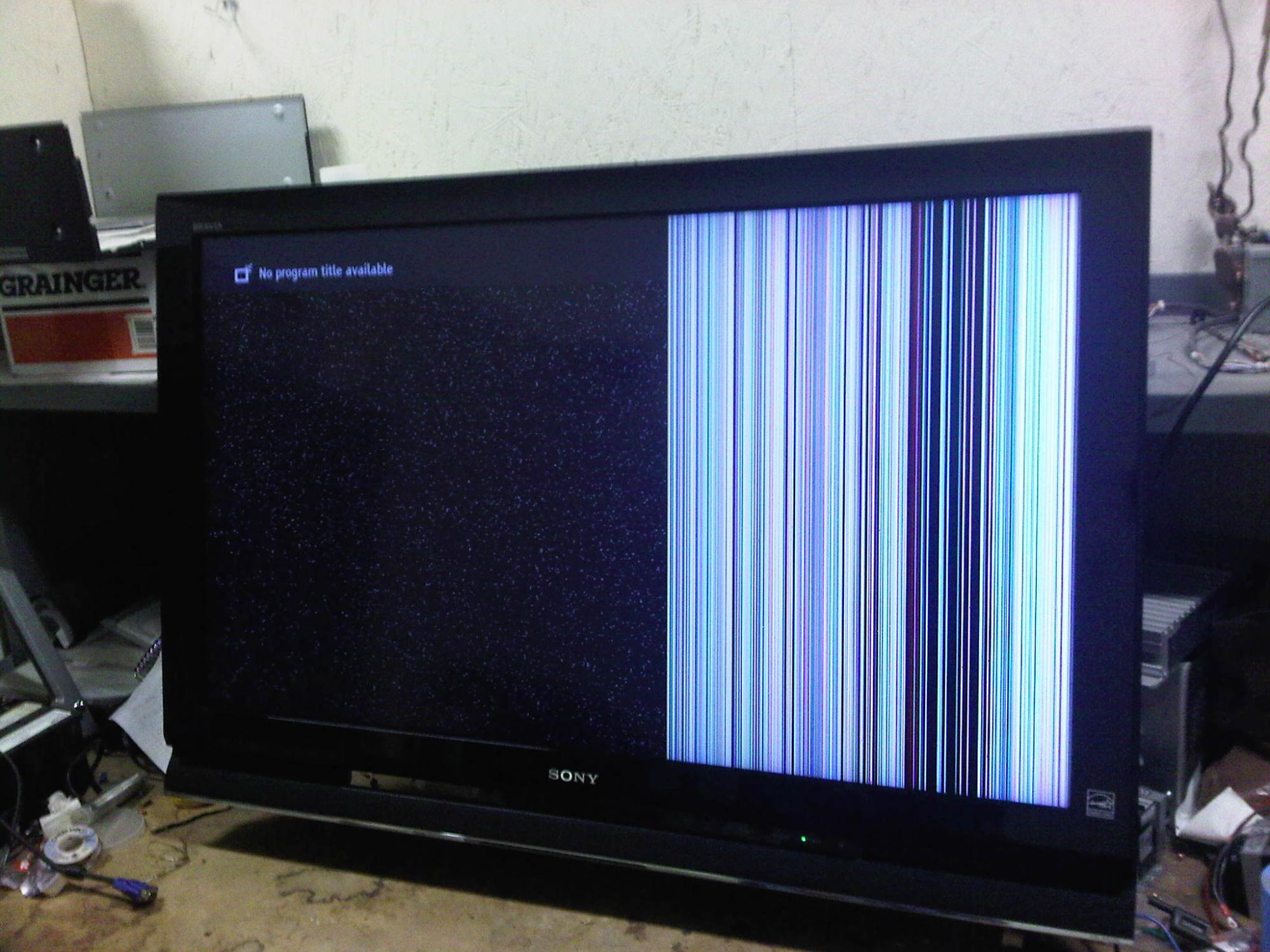

                                      i have a smilar problem on a KDL-40S4100. see attaced pic

                                        I have this TV, did a bunch of research, and I hope I save the next guy from what I did:
                                        Everyone says it is likely the T-CON board, so I replaced mine, the first one I was sent was either defective (as it appeared from the silk screening) or slightly different than my own. I acquired the exact match for my T-CON board, installed it with ease, yes with ease, it was so simple it isn't even funny, it is more difficult to swap a PC power supply, all of this to no avail.
                                        The above screenshots are carbons of my problem and PAY ATTENTION!!!
                                        YOUR LCD IS RUINED AND NEEDS REPLACED! DONT WASTE YOUR MONEY ON USELESS T-CON BOARDS, ACCEPT YOU HAVE A MEDIOCRE GARAGE TV AND STOP TRYING TO FIX IT!!
                                        I have already wasted $50 on a diagnostic from a TV repair facility, and $85 on two T-CON boards that did not help at all.
