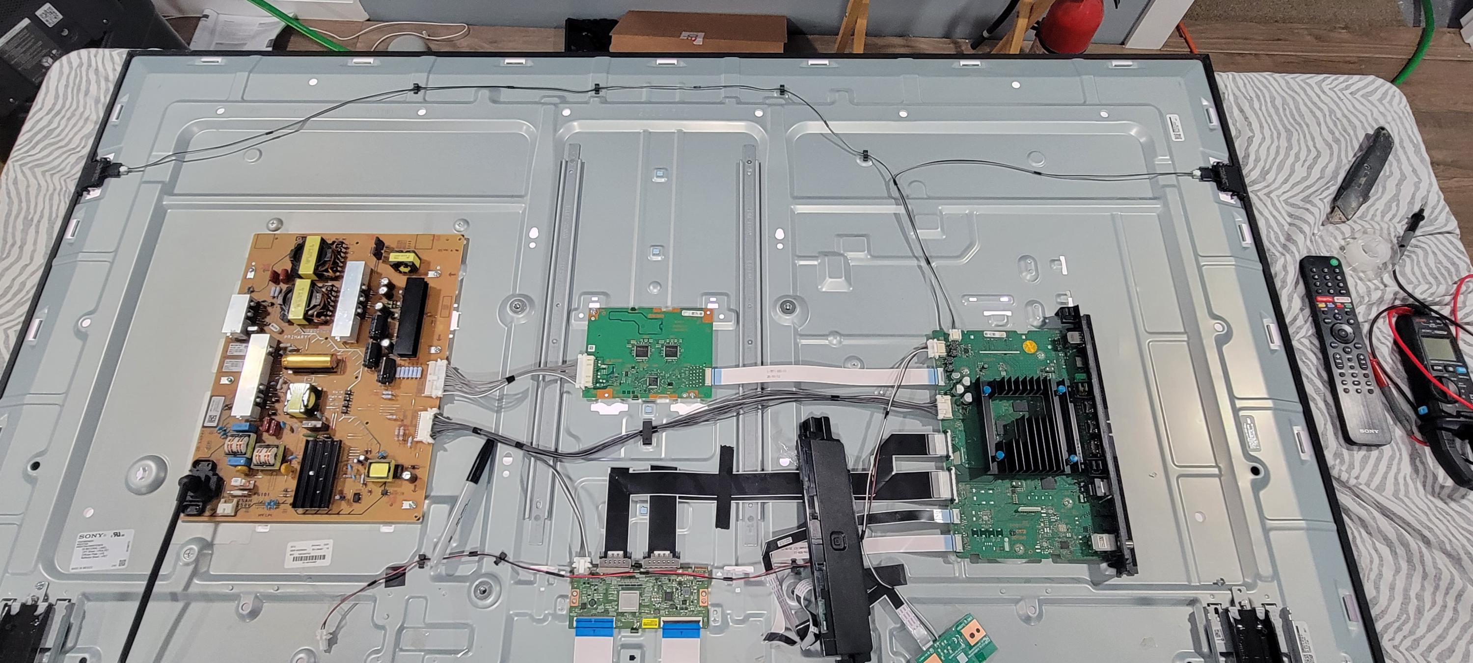

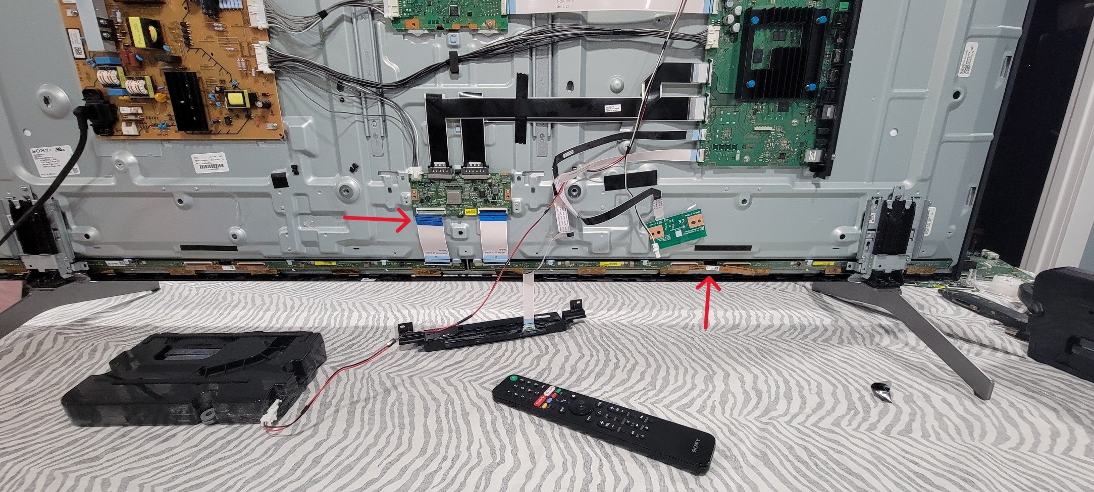

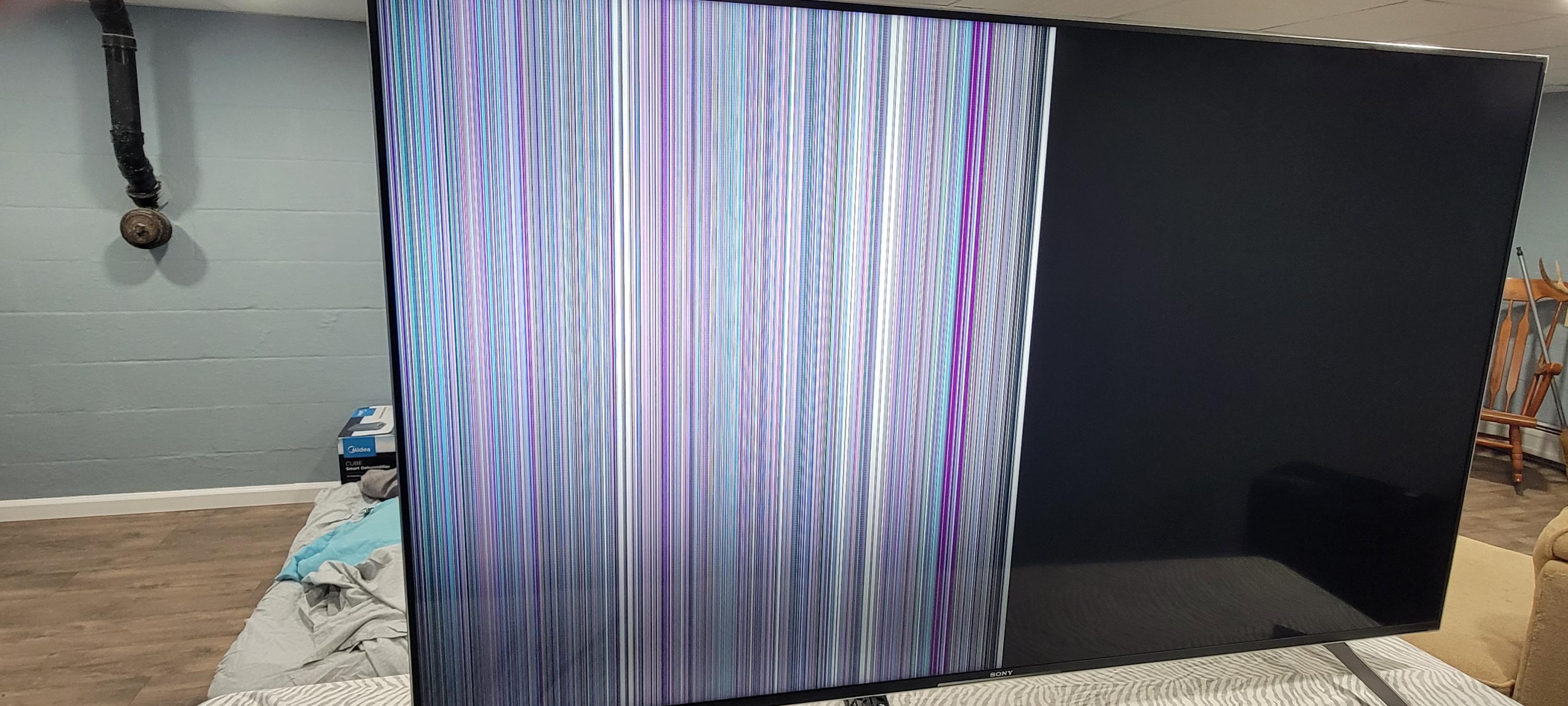

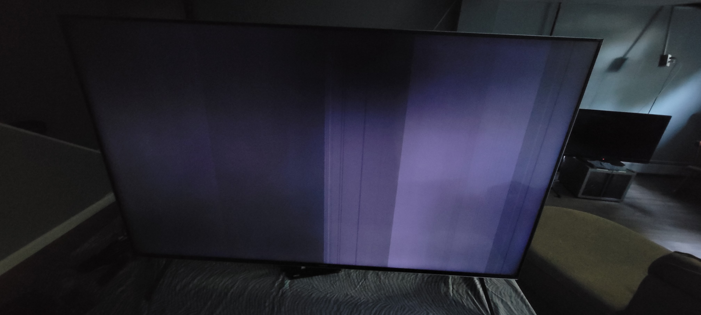

    I have acquired a Sony XBR-65X900H to try and fix. It probably was a complete no power situation. The main board was replaced and the TV started turning on. I now have start sounds and backlights, but no image. I've replaced the t-con with no improvement. Cables all appear to be ok and seated properly. The TV took a firmware update and hard reset but neither helped.
    Using the tape trick I can get both side to display combinations of colored vertical lines. There is no change in the stripes and the pattern always appears the same. If I add additional tape strips I can get the screen to go grayish with less pronounced lines.
    Any other ideas? Bad panel?

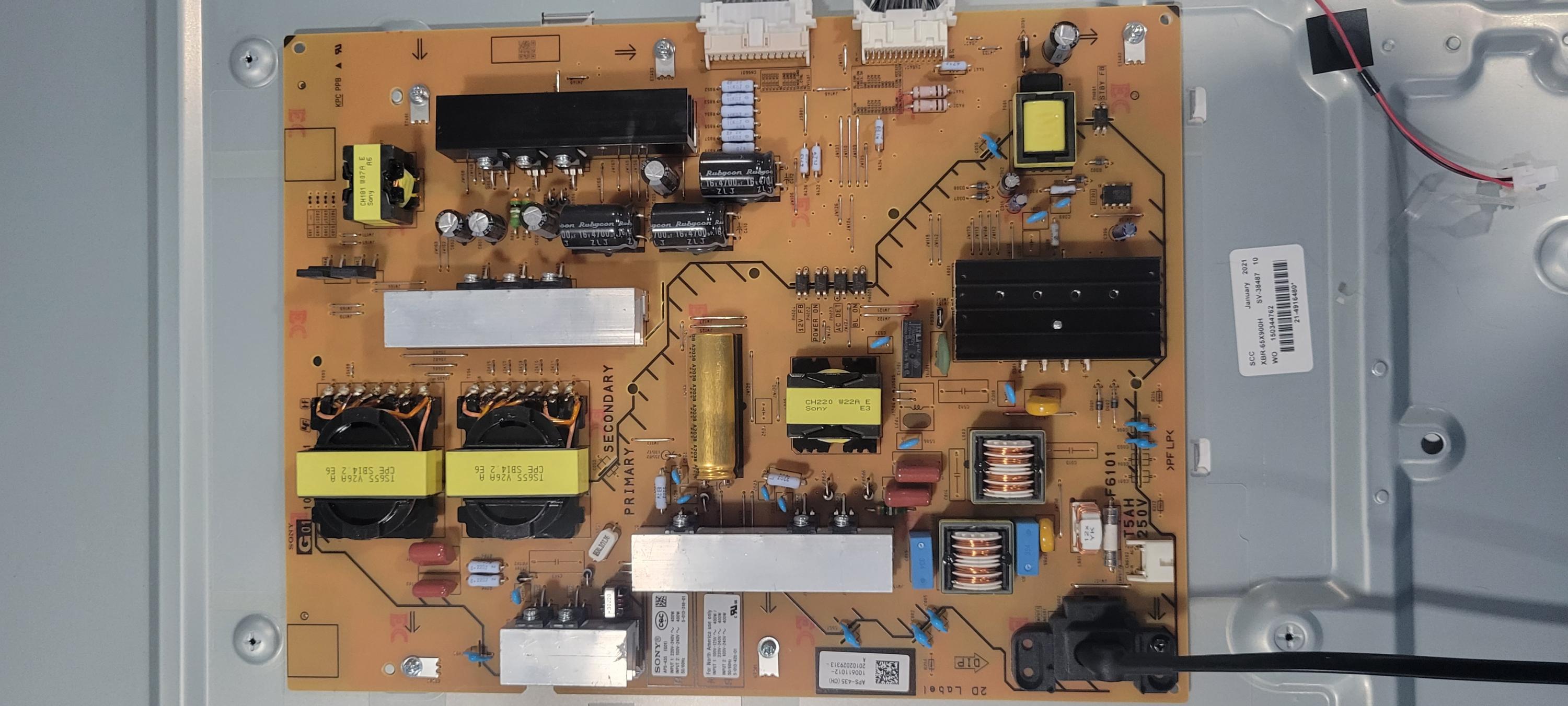

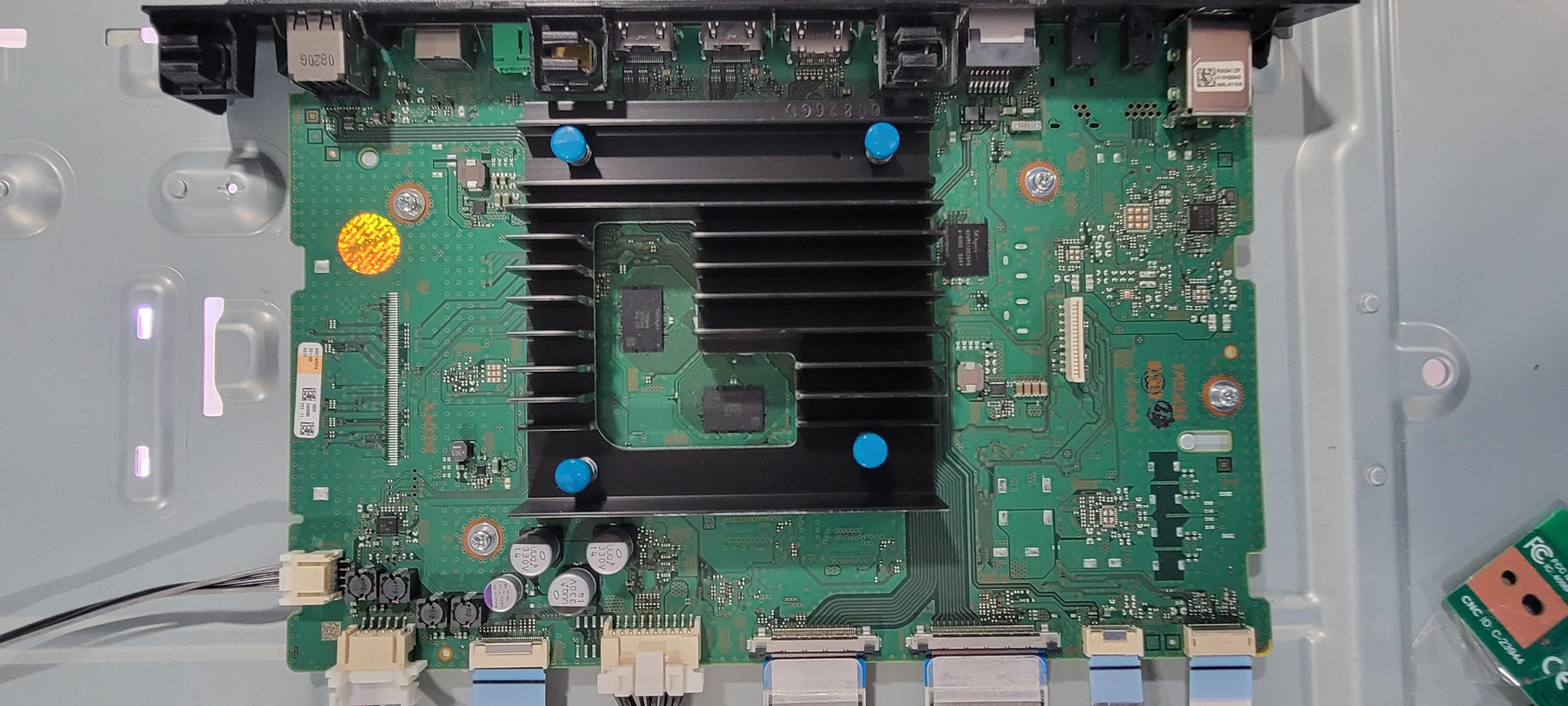

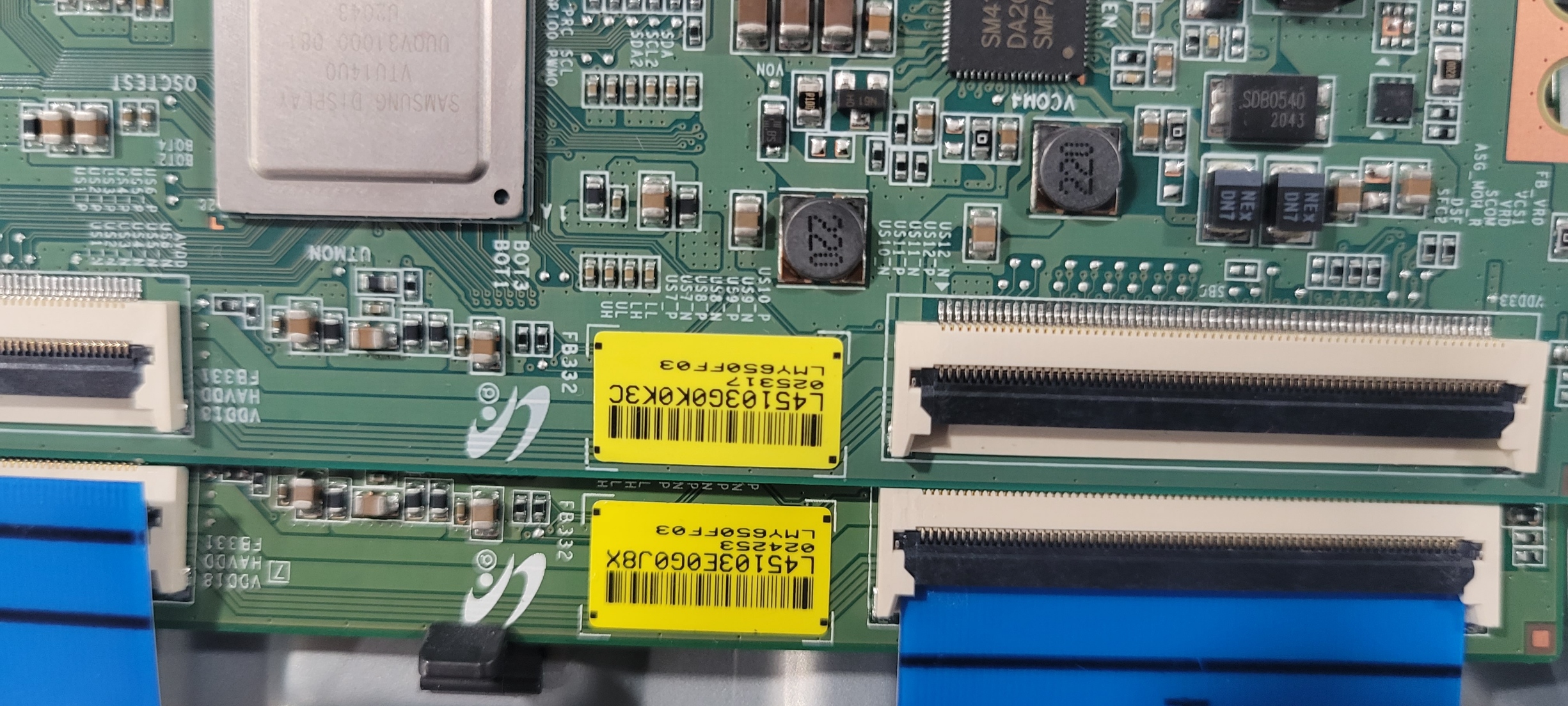

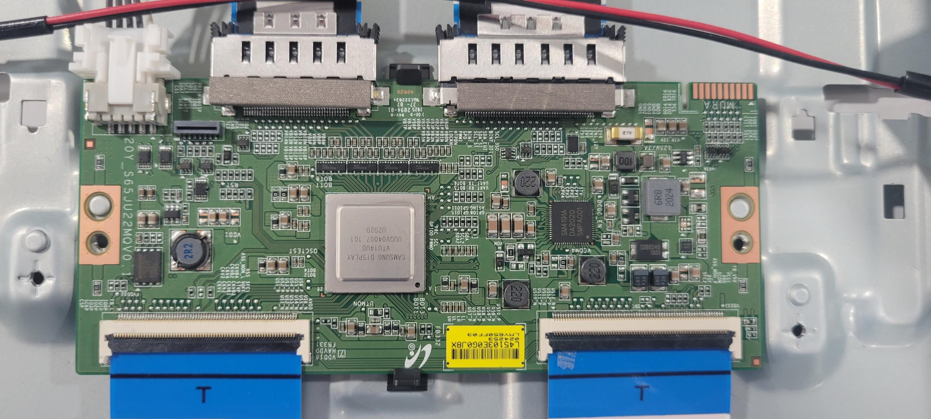

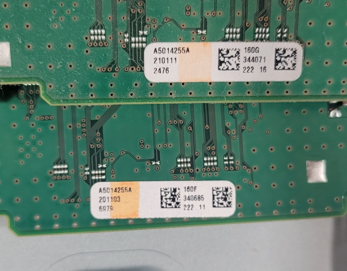

          Re: Sony XBR-65X900H vertical lines
          Boards appear to match based on what is available on ShopJimmy. I've attached pictures. The top boards are the original and the bottom ones are the replacements which are currently installed.
          Am I correct in assuming the EMMC is good on the replacement considering I have an optical light and setup/menu noises after a factory reset?
          I can try another TCON but was just debating how likely that is actually the culprit.
            No expert but I don't think you would get that image if bad eMMC, maybe test the tcon, they sold a lot of these xbr's, many good tcon testing videos on youtube.

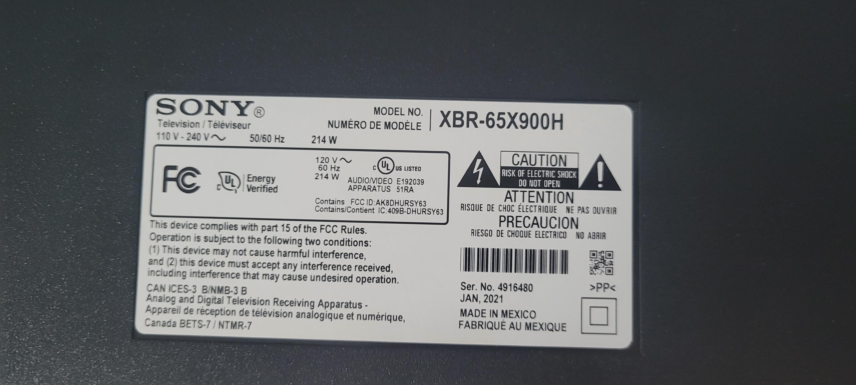

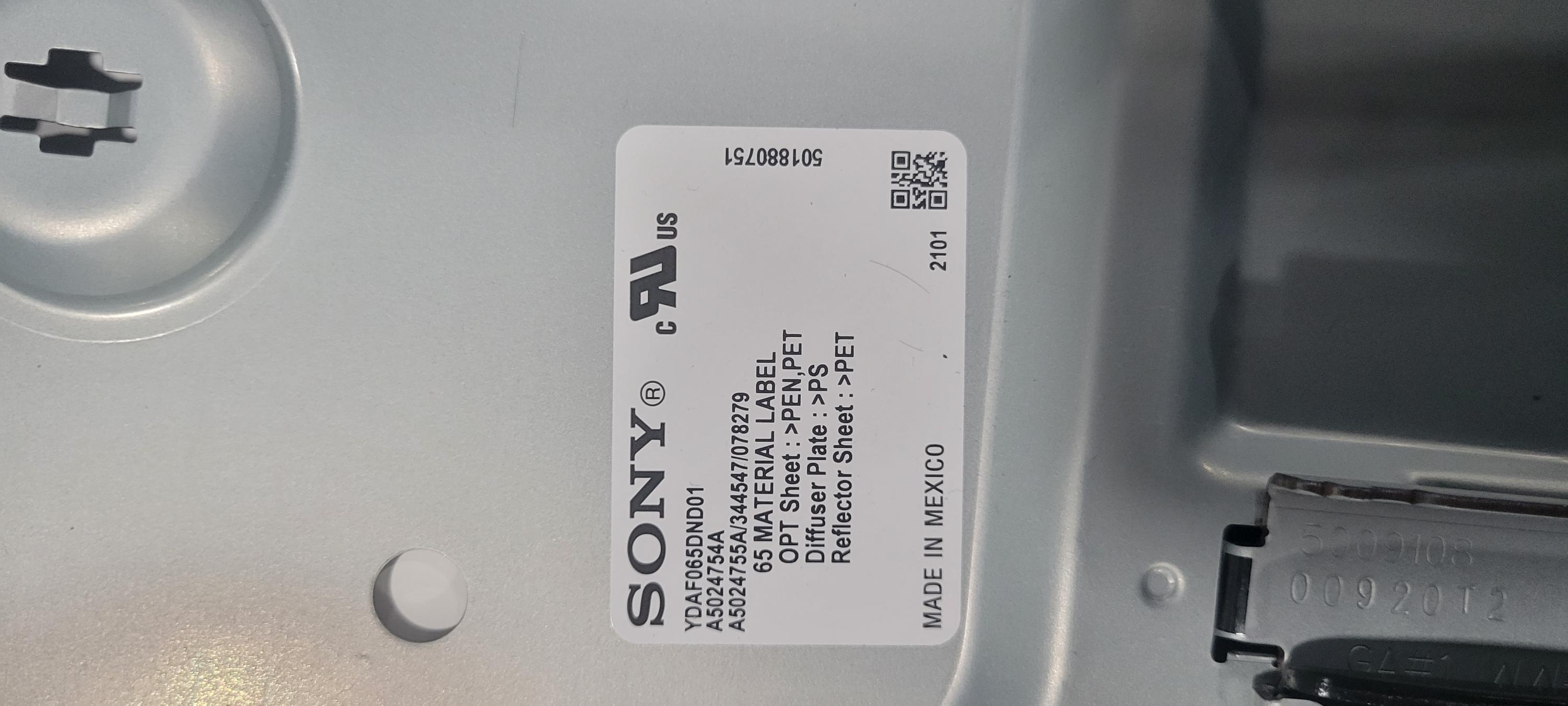

                show us please the sticker on the tv chassis belong to the panel
                • dustman1747
                  • Feb 2015
                  • 33
                  Is this the sticker you're looking for?

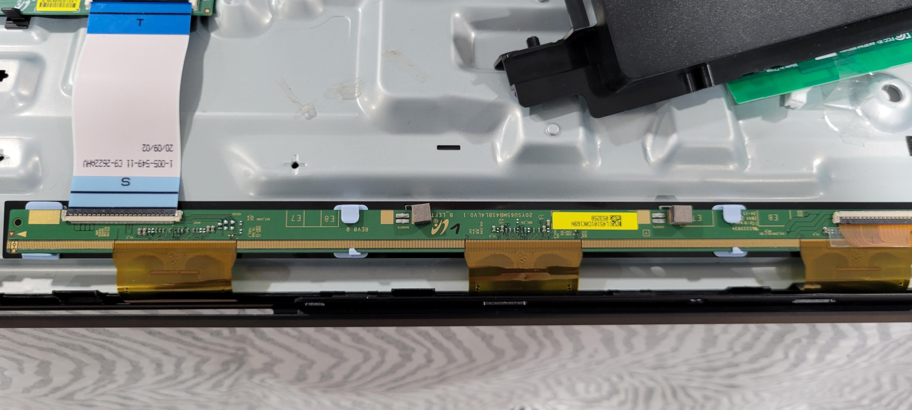

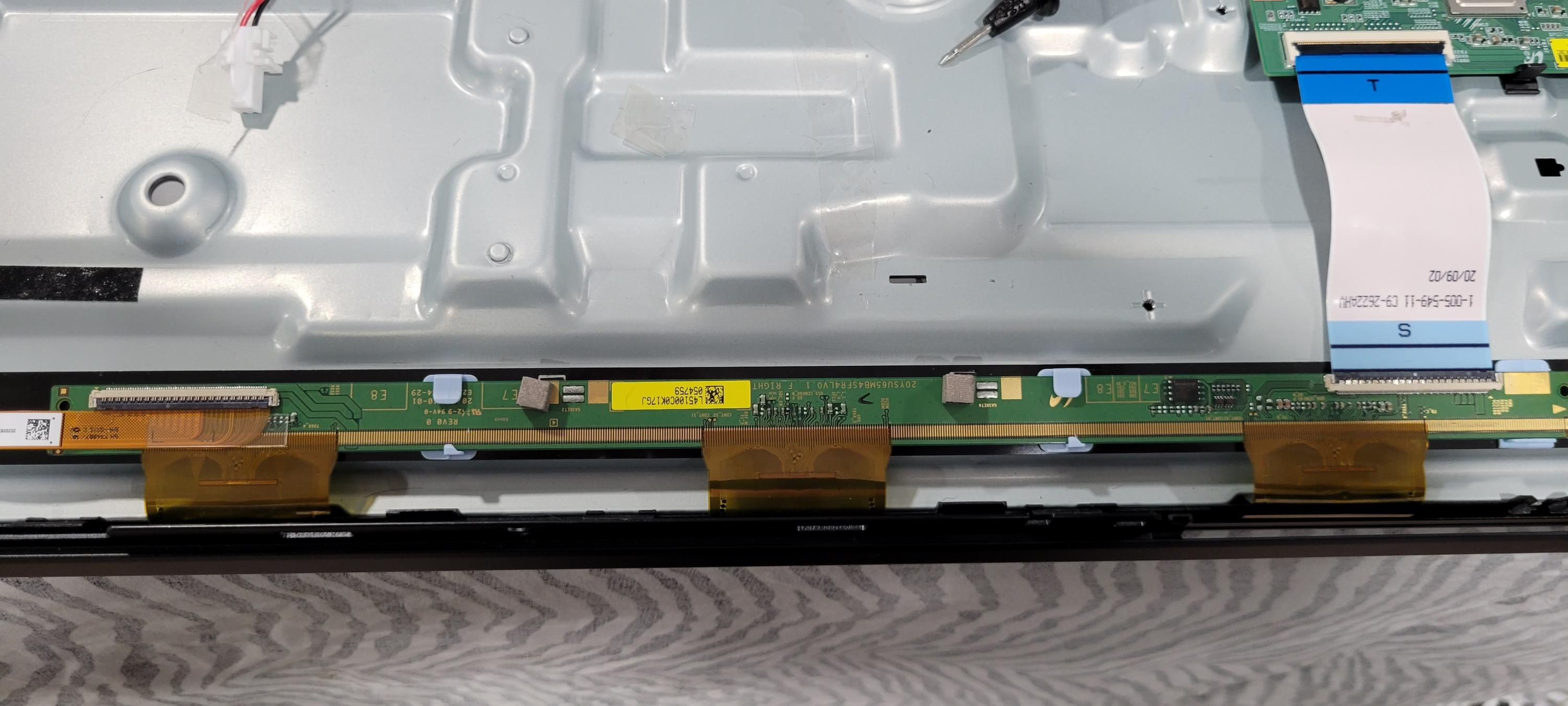

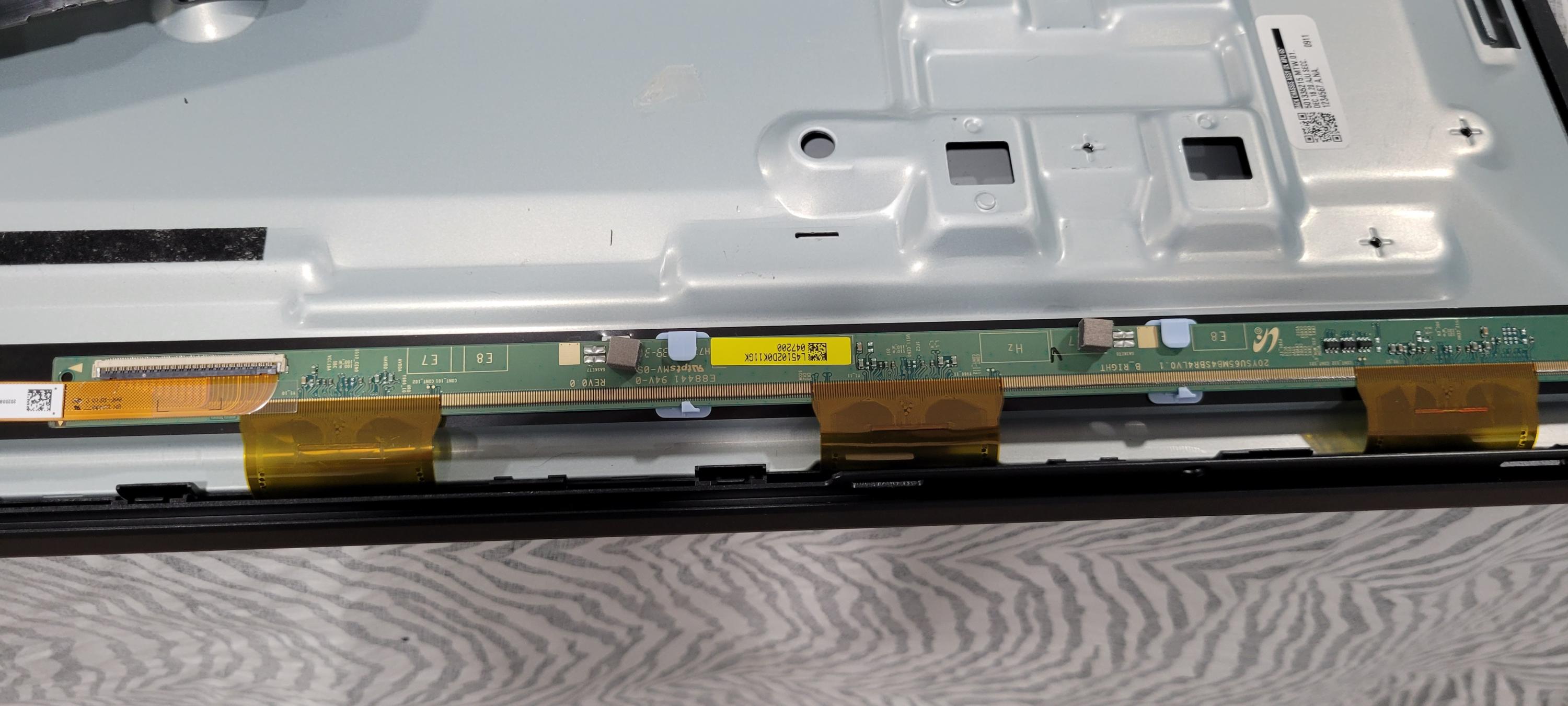

                    VA panel... you have issue on panel buffer boards... it may being cleaning liquid effect on it
                    take out the speaker and the metal cover of both side , show us please yours Panel buffer boards
                    its sound this TV some one work on it before it landed under yours hand

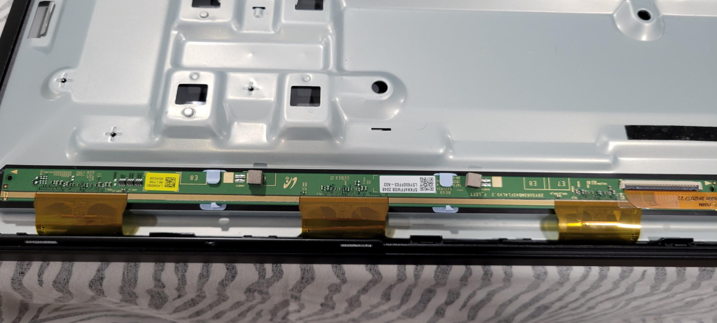

                      Here's some pictures not sure what type of detail you were looking for. I can get better close ups if needed.
                      What makes you think it was worked on before and how does a VA panel make you think it's a buffer problem?

                        Hi dustman.. my guess is that you have good Panel/tcon and only fault was main board, Sony tv needs a pairing procedure after mb or tcon replacement, now i'm on work, i hope at home i manage to find something in my notes on how to.. if you are in a hurry check my last discussions on a Sony this year.. I've talked about it with Lotas.. bye..

                          you have U ribbon cable on each side at the panel buffer boards.... disconnect one a time and turn on... show us the result photo
                          BTW this test should all yours perviouse masking / type remove it... let the set as original only the U ribbon disconnected

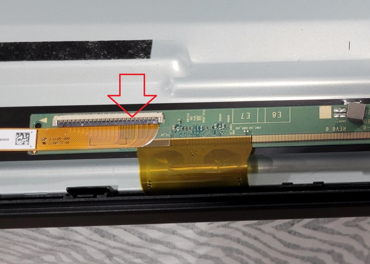

                            The only change I could get was with entire left side unplugged and the right side U cable also unplugged. A picture is attached, boards are disconnected at the arrows. It results in a black pattern.
                              wrong,,, the ribbon cable between t-con and panel should be always in place... only you test the U ribbon at buffer boards disconnected each time one side of left side and right side... you have 2 U riboon alone
                              also your masking type you did before should take out... and feed it to signal.. not just blank screen

                                All of the tape is removed. I have a chromecast connected. The TV seems to be in the initial setup menus based on the audio, so I cannot be sure of the image but there should at least me a menu.
                                I did as you advised:
                                Right U ribbon disconnected, all others connected - Black screen with no changes
                                Left U ribbon disconnected, all others connected - Black screen with no changes
