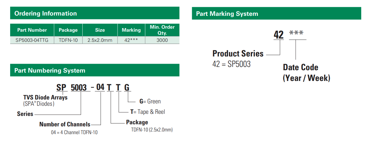

      Problem is I have no info what diode packs this is and where to get them...

        Anyone able to indentify the diodepacks on the above pictures?
        Markings are 4262H and 4267H

                Thanks Diah, the thing is I have already removed the diodepacks since I was suspecting them at fault, before going into the clock lines troubleshooting.
                So now I need to find the partnumber of those diodepacks so I can mount them back.
                The old ones are gone.

                              Hello. I mounted new ESD diode packs, but then the same symptom came back.
                              I used the IP4283CZ10.
                              When remove again set is working.
                              From what I can see, the pinout is the same on original and the new ones.
                              I wonder, what required voltage is required to drive the clock lines, perhaps the new ESD diode clamp to early?
                              Datasheet to new ESD diodes:
                              https://cdn.badcaps-static.com/pdfs/...8f794f7f84.pdf
                              • PowerAmpFreak
                                • 982
                                • Sweden
                                #95
                                Re: Samsung 4K led model UE50NU7445U no picture
                                Today I measured the clocksignals that the ESD diodes protect. The amplitude is about 27V peak so the suggested ESD diodes clamp way too early.
                                That's the reason for not showing a picture and reboot.
                                There must be ESD clamp diodes with higher voltage rating.

                                  Marking 4262H and 4267H is most likely 42*** - SP5003-04TTG.
