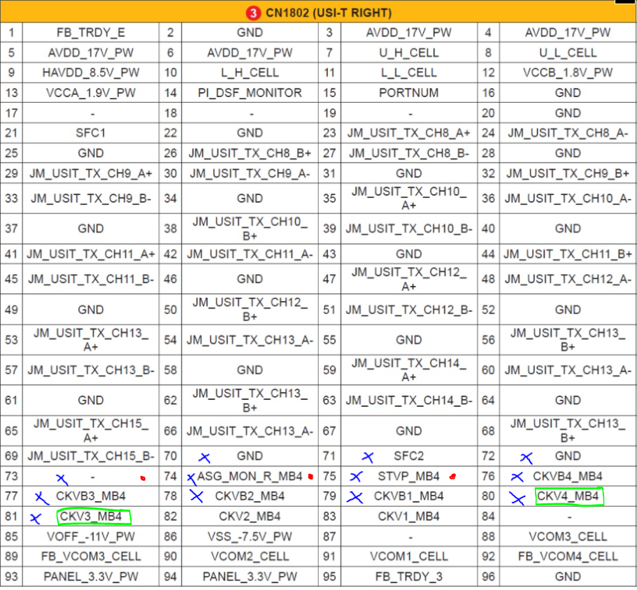

    Originally posted by PowerAmpFreak
    Going for Diah's advice blocking only 3 pins made the bootloop come back.
    Explanation:
    Blocking all blue markings - set is OK
    Blocking only the red markings - Set goes into bootloop
    Now extend blocking to cover a few of the CKV lines aswell. Stay tuned.
    ASG_MON_R_MB4 with its respose STV_MP4 they are only 2 not 3

      #62
      Re: Samsung 4K led model UE50NU7445U no picture
      There is only one signal which causes bootloop and that is pin 81 CKV3_MB4, but isolating only that one gives lines in the screen.
      I did not investigate how many signals that was necessary to get rid of the lines, so I simply isolated the original 12 which I by luck happened to do at my first try.

        #63
        Yes I know but I had to use a quite thick isolatingtape so it was three in total, but the third was not used according to pinout.

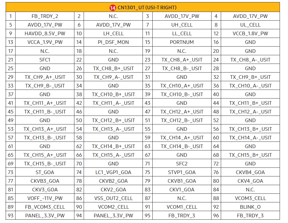

          Here is the same connector but from the NU Series Service Manual

                  #68
                  where are the line appearing on the screen?

                    #69
                    The lines were all over the left side of the screen "right buffer", black lines.
                    • Diah

                          #72
                          I have tried to read up quite a lot over the last days. Apparently in modern panels the actual gate driver Transistors are integrated into the panel itself on the left and the right side. The external control turns on the gates line by line.
                          In case of a short on one side (e.g. left) that gate signal does not work correctly. However if you block the clocks on one side, the gate still opens on the other side (e.g. right). This might lead to timing violations visible in small bad lines, but at least the panel works again.
                          • kevinallein
                            • Dec 2010
                            • 32
                            #73
                            Just to double check: You did block two pins, CKV3_MB4 and CKVB3_MB4 and still had lines ?

                                  #76
                                  CKV3_MB4 and CKVB3_MB4 isolated only does not give a picture. Only bootloop.
