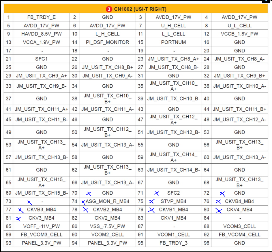

                    Can you please explain, which pins exactly you blocked with tape ?
                    • PowerAmpFreak
                      • 982
                      • Sweden
                      #50
                      Re: Samsung 4K led model UE50NU7445U no picture
                      https://www.bildtagg.se/bild/0m64i6ybovlhznm0xg54mh01
                      This is the ribbon to the right buffer board if looking at the tv from backside.
                      I have no clue what signals this is, or what effect it will have.

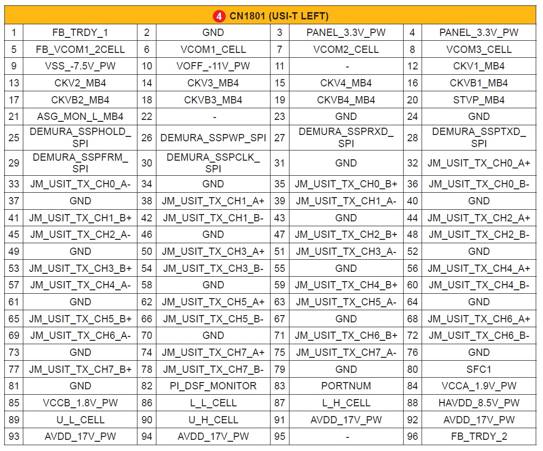

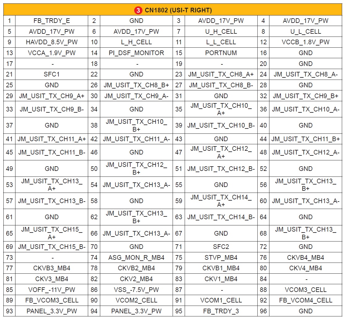

                        I am trying to count, but it looks like you are blocking 13 lines starting from PIN 16 ? Is that correct ?
                        That totally confuses me. I thought you would only block the CKVx and CKVBx lines, which should be 8 in total ?
                        Where did you get the info, what to block ? Could you please explain ?
                        I found a Samsung KS Service Manual, slightly different from the one I have, but here is the pinning info I found in there.

                          #52
                          I am just a surprised as you how this could actually work.
                          The tape is blocking 12 lines from start pin 16.
                          I was looking at the youtube vid and decided to give it a go.
                          Did not look very carefully how much pins to block and from where actually.
                          The first try I made resulted in a properly working tv, with no picture side effects.
                          I will try, by your pinout information, to see what signals I actually blocked.
                          Could you upload the complete service manual ?
                          And what does the CKV lines do ?

                            #53
                            you probably blocked clk signals due to the fact that your gate driver circuits connected to the clocks are s/c..

                              #54
                              The CKV signals control the on / off frequency of each line. (CKV line switching signal in line drivers)

                                I did actually find a NU Service Manual, that is probably more appropriate for you. Am I allowed to upload here ?

                                  From looking at the pinout for connector CN1802 (right side) and assume this also applies to my set I can tell those below signals are blocked:
                                  I will now try to narrow the blocking down to the smallest amount of signals needed for picture

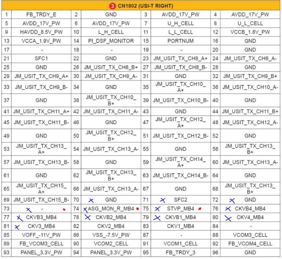

                                      #58
                                      the supject become more interset.. i think if you block only ASG_MON_R_MB4 with its respose STV_MP4 would enough... but let see these pins where are going.. as there no diagram i think they are return signal to MB.

                                          #60
                                          Going for Diah's advice blocking only 3 pins made the bootloop come back.
                                          Explanation:
                                          Blocking all blue markings - set is OK
                                          Blocking only the red markings - Set goes into bootloop
                                          Now extend blocking to cover a few of the CKV lines aswell. Stay tuned.
