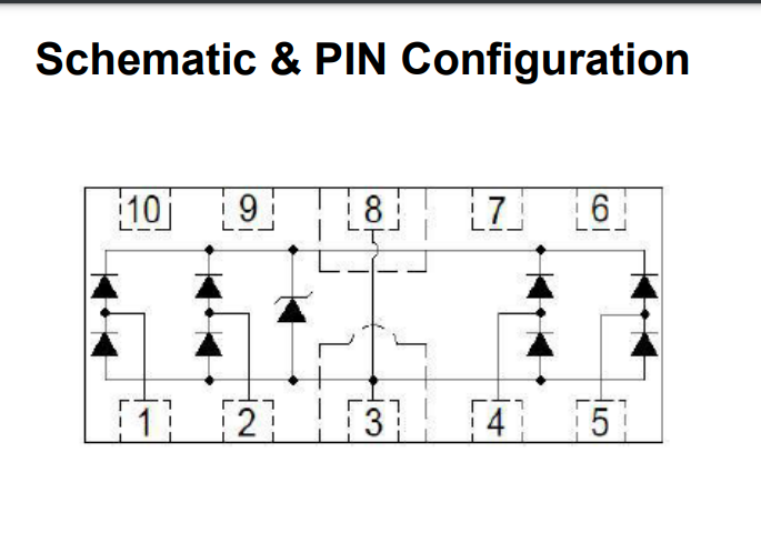

Samsung 4K led model UE50NU7445U no picture
  • lotas
    • Jan 2016
    • 4890
    • Russia
    Re: Samsung 4K led model UE50NU7445U no picture
    ESD Protection Diode
    • Davi.p
      Hobbist Tech
      • Sep 2009
      • 4542
      • Italy - Milan
      diodes are only protections, you can remove them, but to close the repair it is fundamental to replace them, so the next surge peak will not destroy panel, by your photos i see also 200 ohm and 51 ohm resistors..
      • PowerAmpFreak
        • 982
        • Sweden
        Tested without any of the diode packs. The same issue remains.
        Still 35ohm across a bunch of 0402 decoupling caps - NOTE! 35ohm across a bunch of caps on BOTH buffer boards even ribbons not connected! So buffer boards should not share supplylines at this point.
