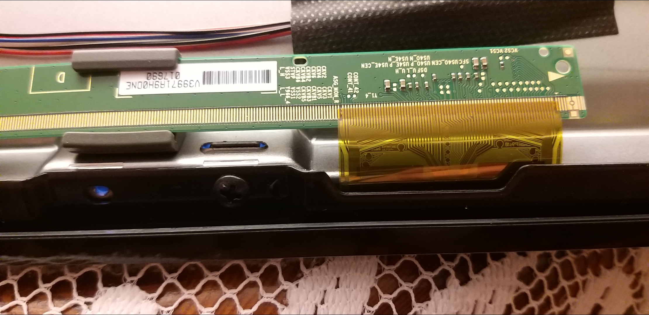

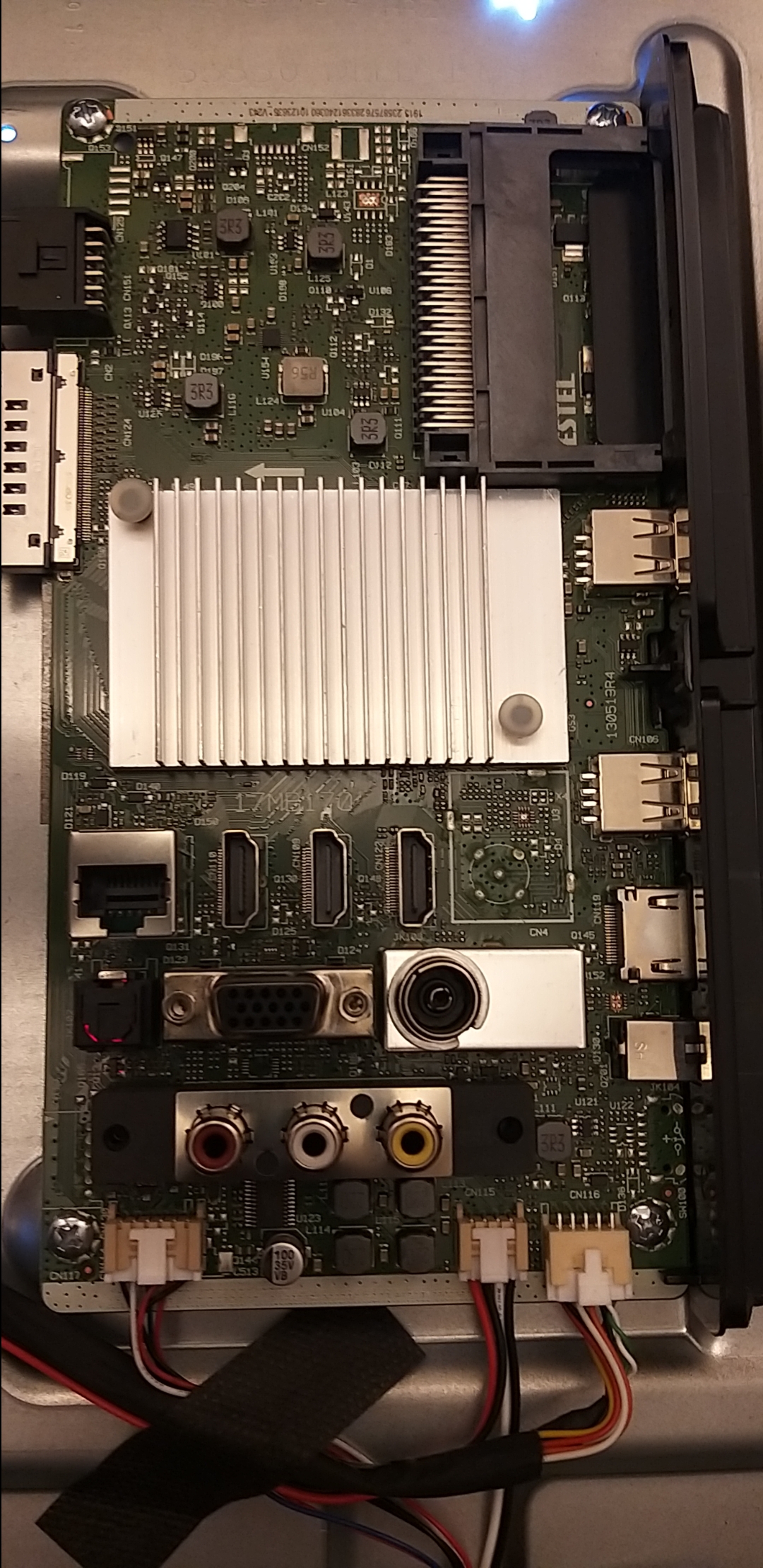

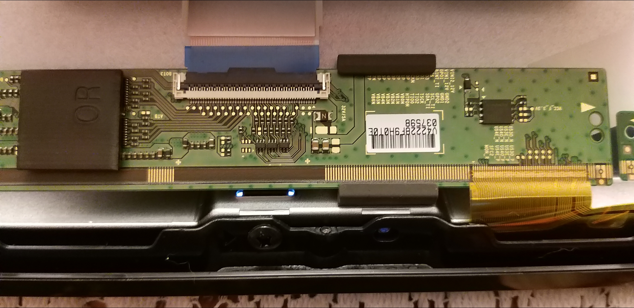

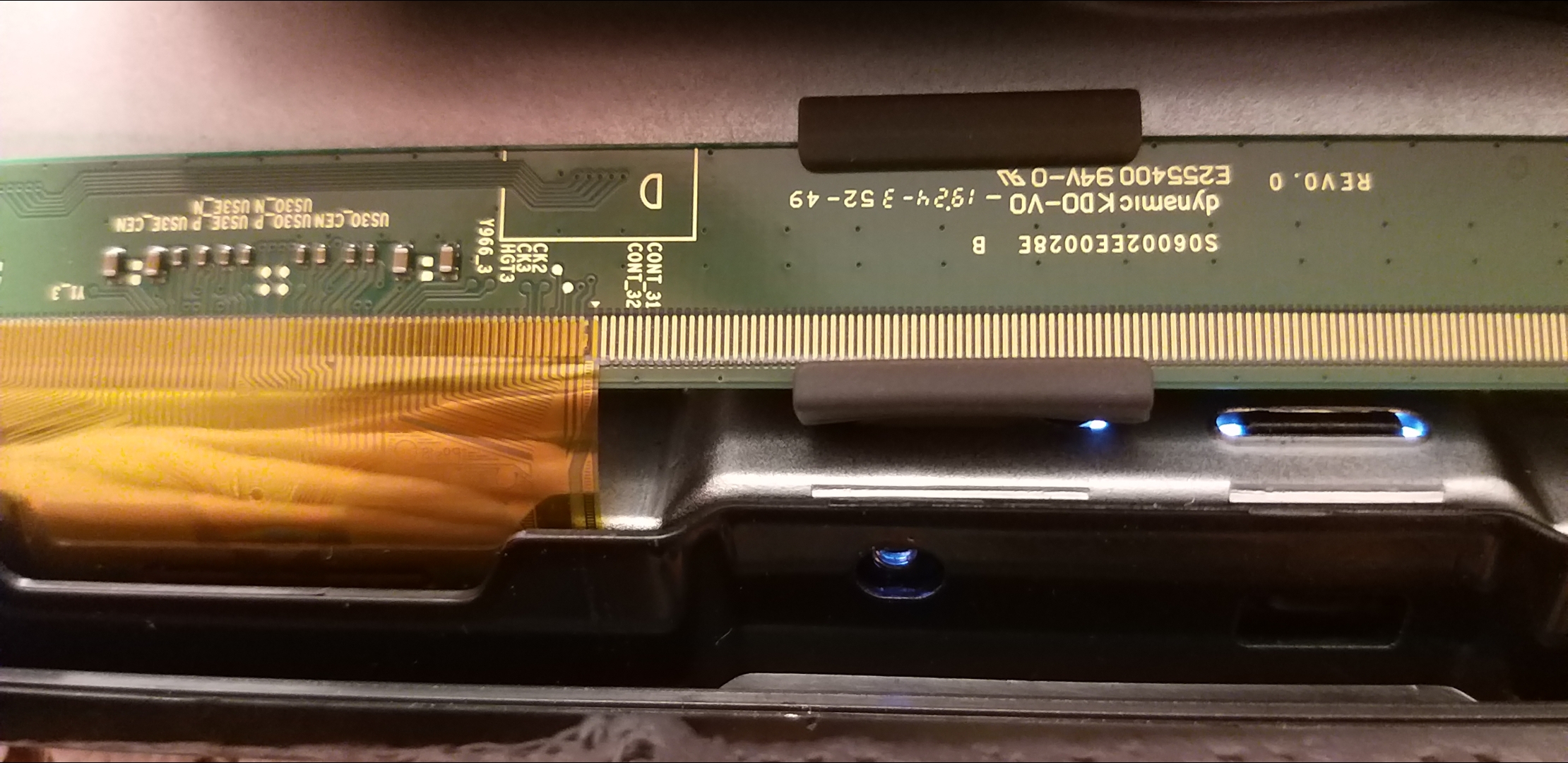

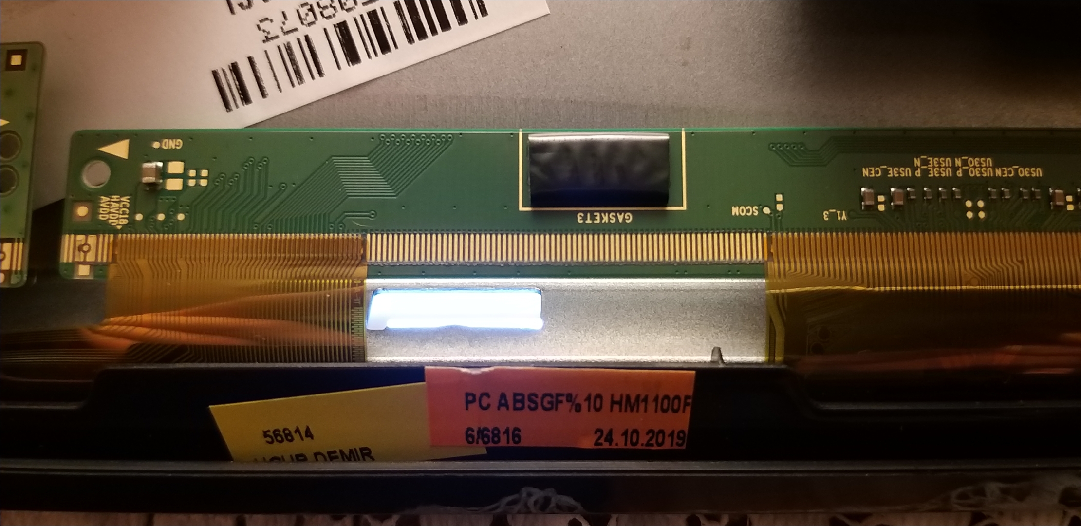

    Re: JVC LT-55CF890 backlight on but no image
    photos
      Voltage on the fuse both sides ?

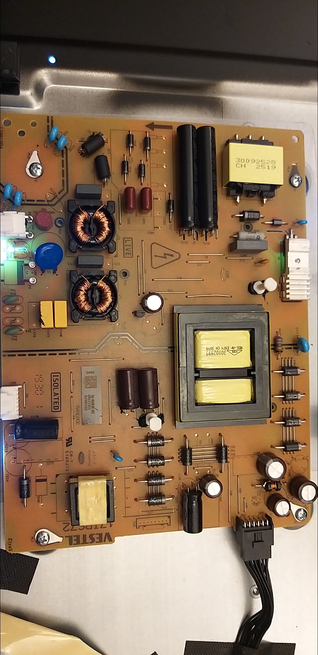

              • notallbad
                • Oct 2012
                • 1183
                power board voltages
                12v stby (stby- 12.55v, on - 12.55v)
                power pin 9 5v_stby (stby - 0v, on - 0v)
                dimming (stby - 2.75v, on - 3.4v)
                BL_on_off (stby - 0v, on - 5v)
                stby_on/off_not (stby - 0v, on - 0v)
                power pin 1 24v_vcc (stby - 24v, on - 24v)

                • notallbad
                  • Oct 2012
                  • 1183
                  The power pin 9 5v stby is not connected to anything on the pcb side of the board so can be ignored.
                  So looking at the power board voltages I would say they look ok.
                  Anyone care to confirm please?

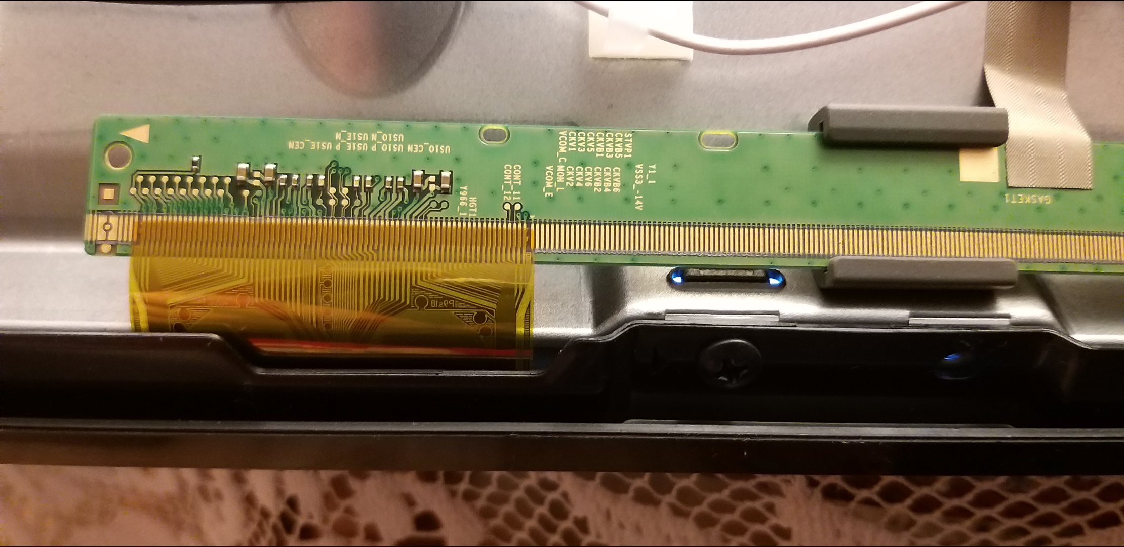

                  • diif
                    • Feb 2014
                    • 6978
                    • England
                    I was suggesting you check the voltages on the slim boards that connect to the panel, the rest are working if you have everything but picture.

                      • comptek
                        • Aug 2013
                        • 606
                        • uk
                        Check screen slim boards for anything getting hot caps or dc-dc converter etc

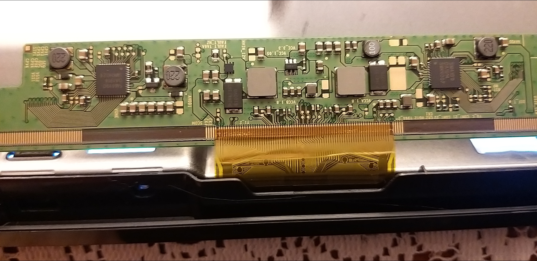

                          • notallbad
                            • Oct 2012
                            • 1183

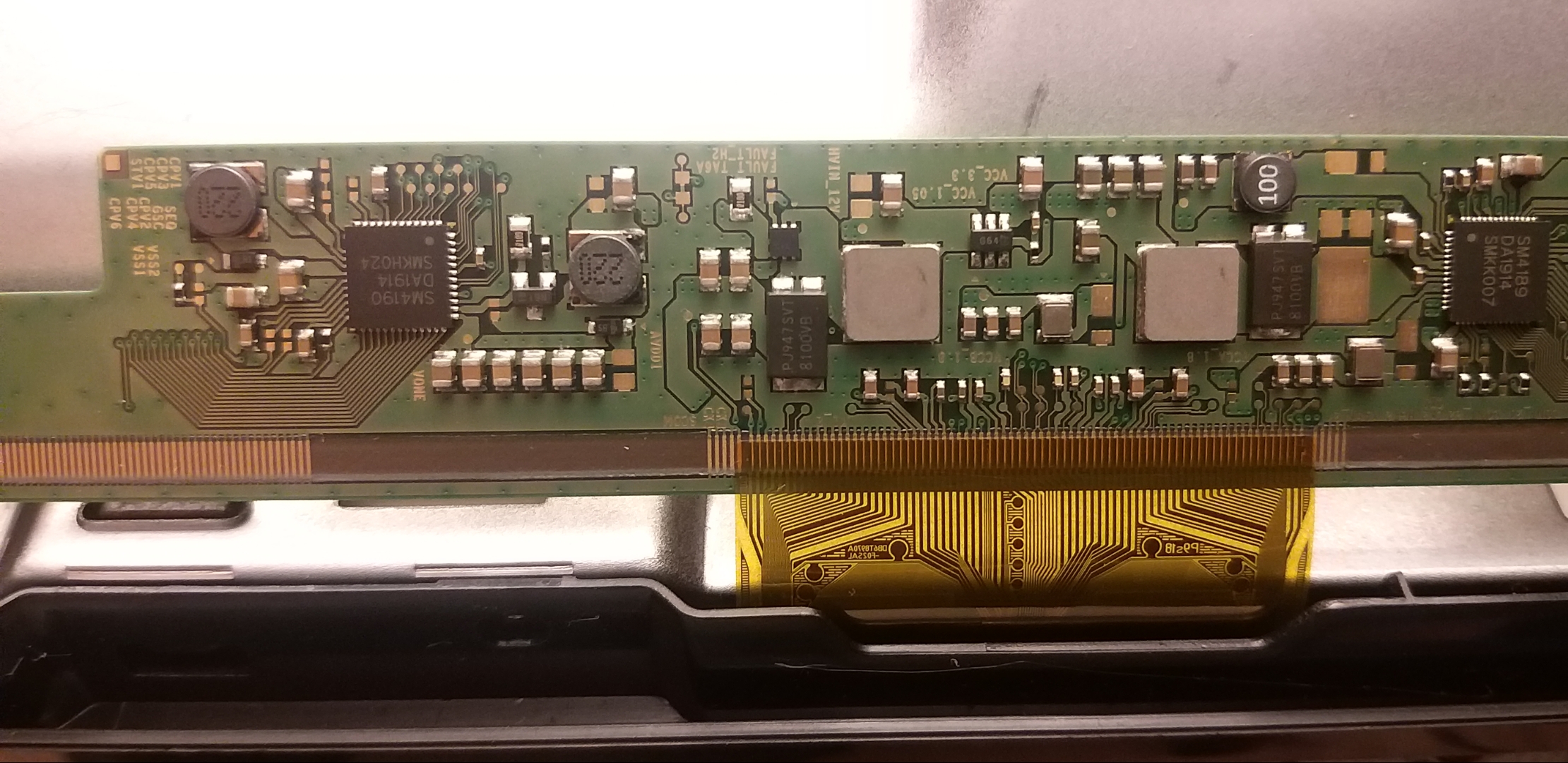

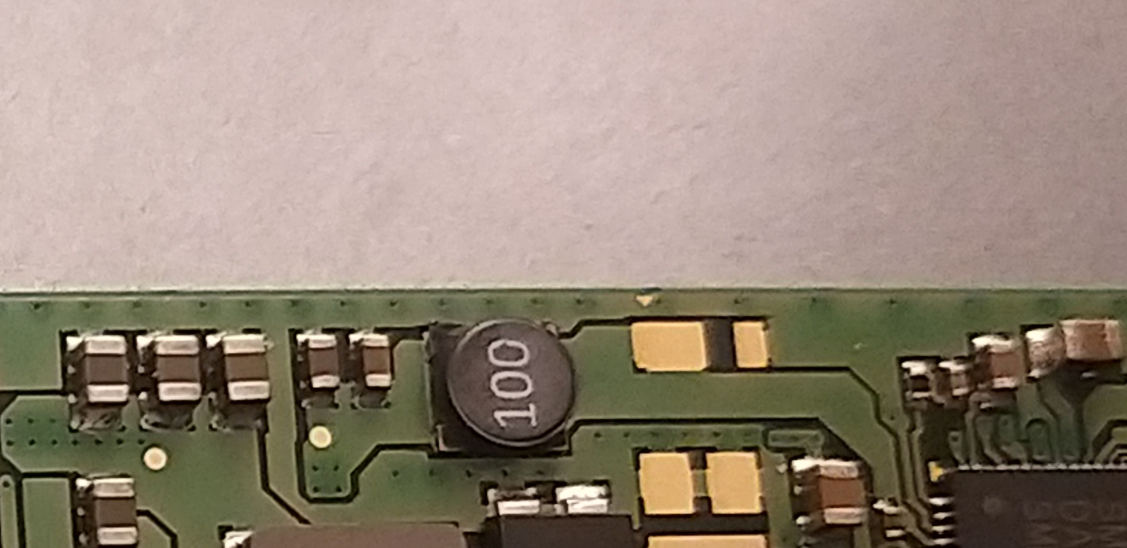

                            It would seem the slim panel board is hotter in the upper portion as per zoomed in photo below, around 41 degrees whereas its around 24 to 30 degrees elsewhere.
                            • notallbad
                              • Oct 2012
                              • 1183
                              Theres an smd G64 6 pin ic, mosfet.
                              12.5v on pin 4 Source
                              12.4v on pin 3 Gate
                              0v on pins 1, 2, 5 & 6.
                              Drain is connected to the hvin_12v test point that reads 0v.
                              How can I bypass or otherwise check its the mosfet at fault?
                              thanks
                              • diif
                                • Feb 2014
                                • 6978
                                • England
                                Is it hot ? You can check mosfets in diode mode but it's not in the photo of the hotter area, have you checked the components there ?
                                • notallbad
                                  • Oct 2012
                                  • 1183
                                  Theres an ic SM4190 which I'm assuming is a DC-DC converter, but cant find any datasheet for it.
                                  But seems its not generating any of the required voltages. i.e -14v, -7.4v, -3.3v, -4.15v, 9v or 32v.

                                  • dskall
                                    • Oct 2016
                                    • 2905
                                    • usa
                                    SM4190 appears to be a processing chip. What voltages are you getting at your ldvs input on the paired lines going into main processor? You should read about 1.2v if data is coming from mainboard.
