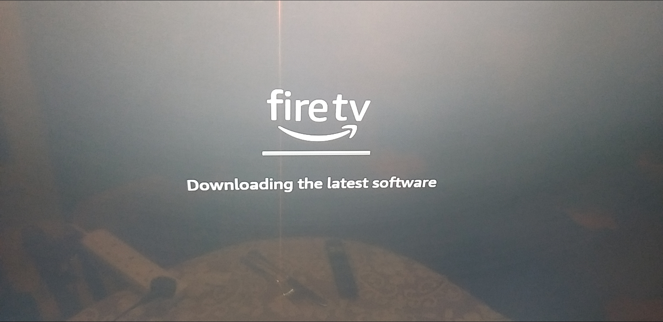

            Re: JVC LT-55CF890 backlight on but no image

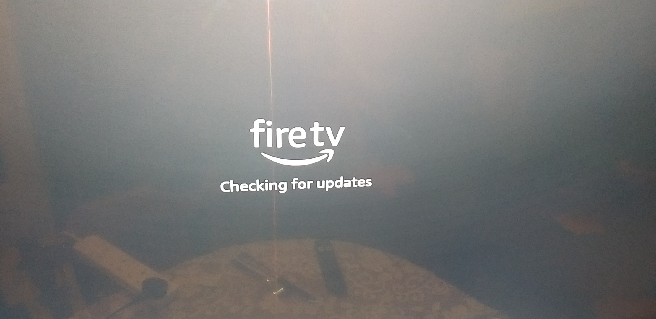

            Amazingly its just come on, connected to internet and now doing a software update! For better or for worse.
              TaDa.
                On for a while and done a couple of power cycles and still ok. Shall continue to use for a while before moving it about or removing power completely.
                So not entirely sure what the problem was/is but working at the moment.

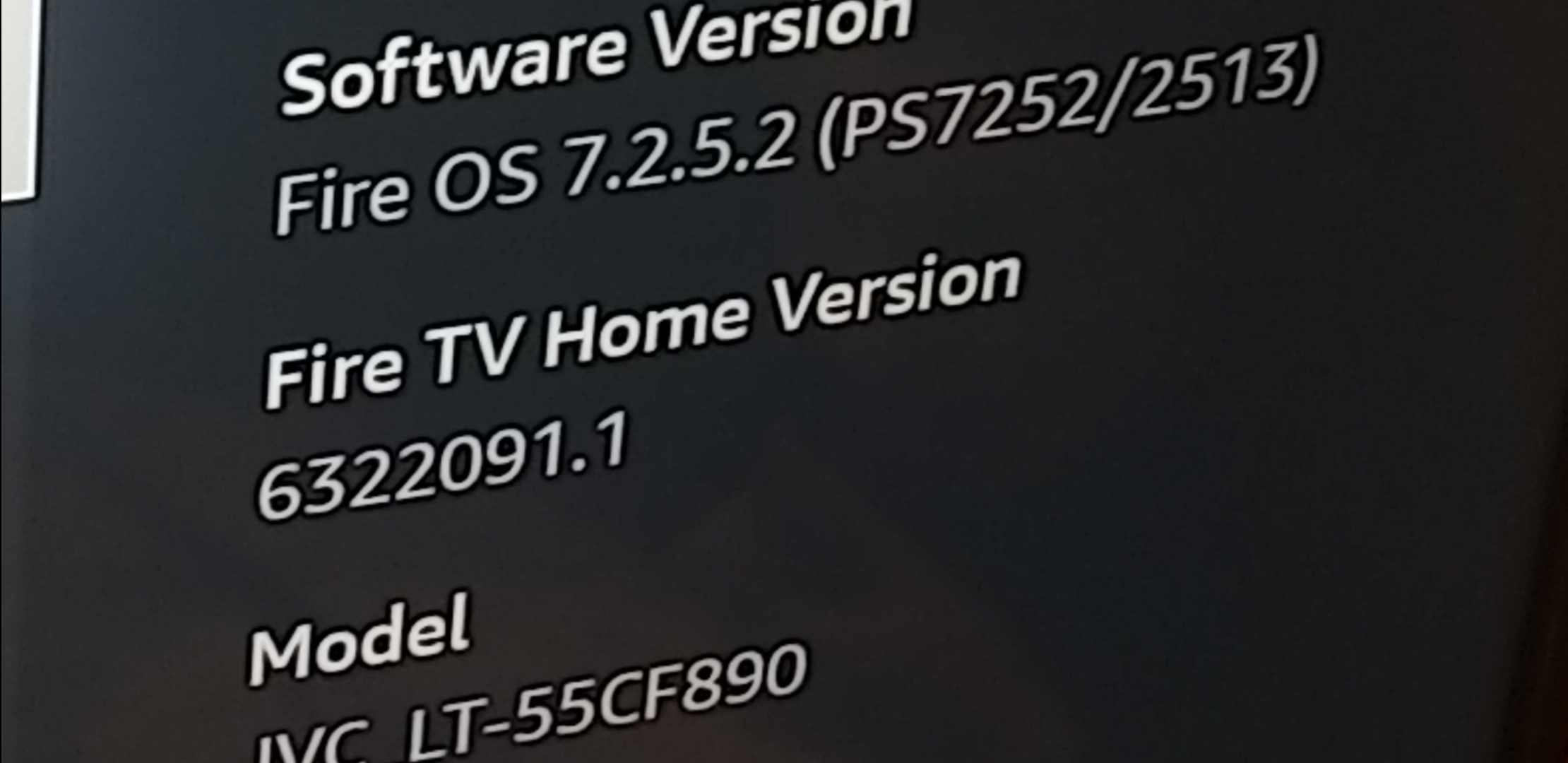

                          Further details
                            hi,I don't know if it can help you

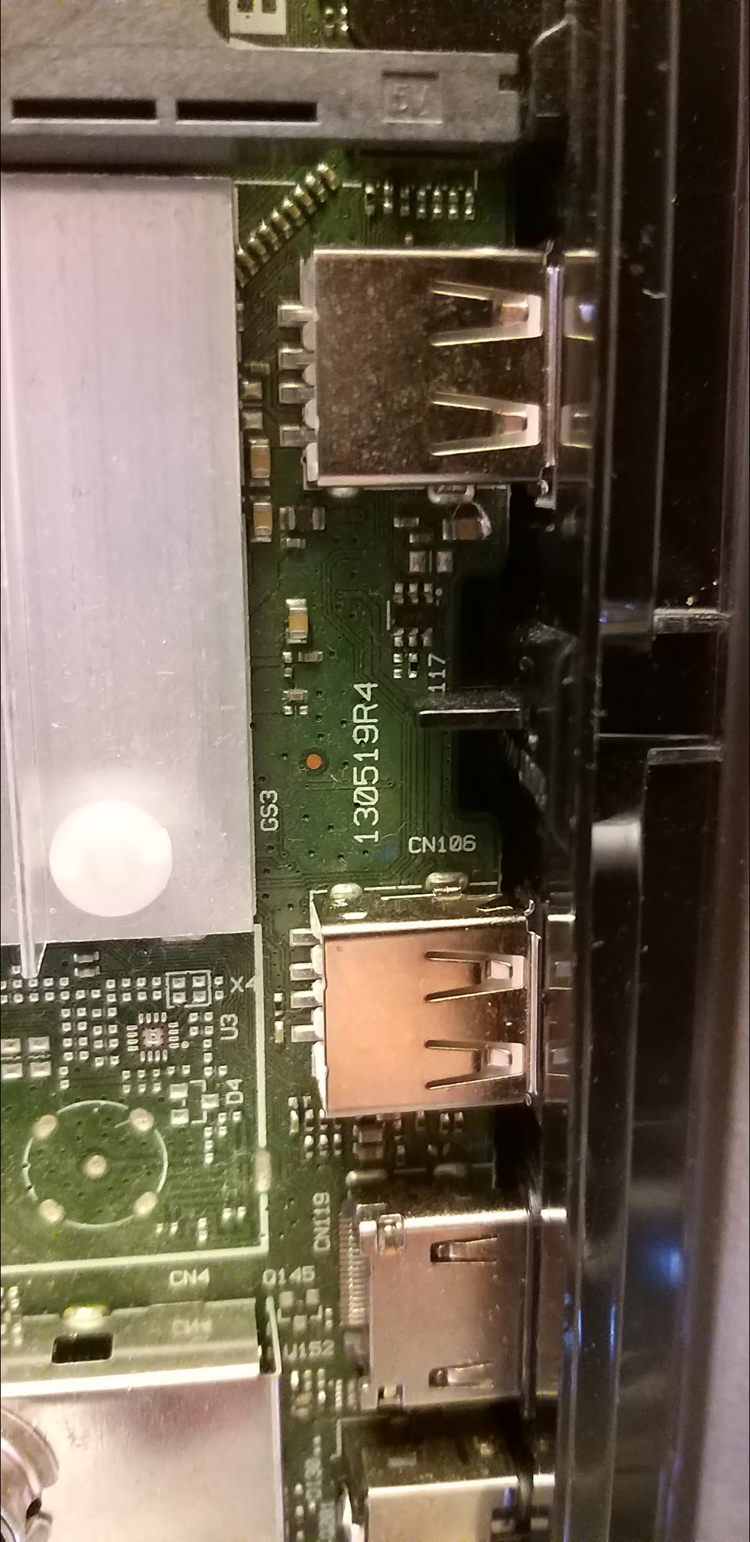

                              #34
                              I'm 100% sure its the main processor on the main board, applied pressure to the large heat sink and image now back! Needs reballing I guess but dont have equipment to do that.

                                  #36
                                  no, on the original board.
                                  the replacement board I bought has the same symptoms (no image) but unable to get it to show an image by applying pressure, perhaps too far gone.
                                  I do have another board on its way, fingers crossed though suspect this is going to be a common fault on these boards.

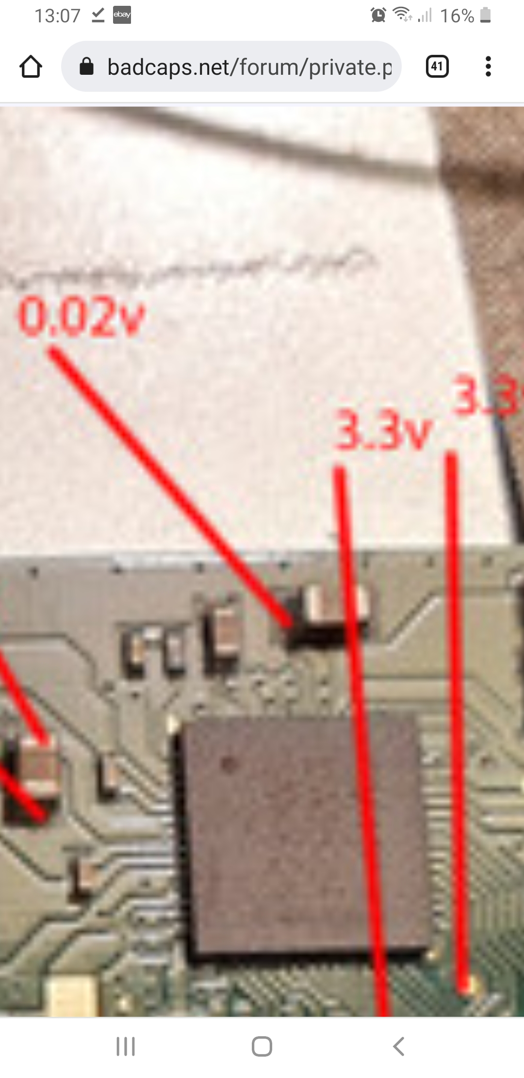

                                    #37
                                    For info/ref
                                    14v & 0.02v on this cap

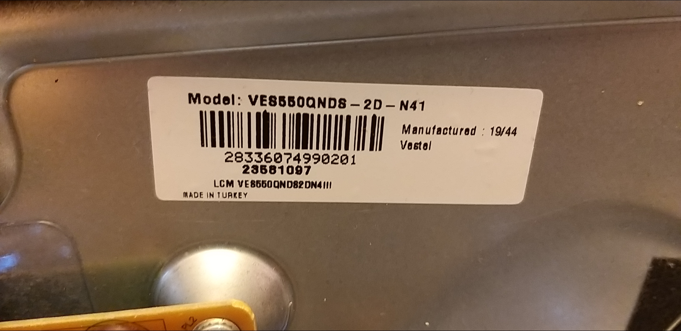

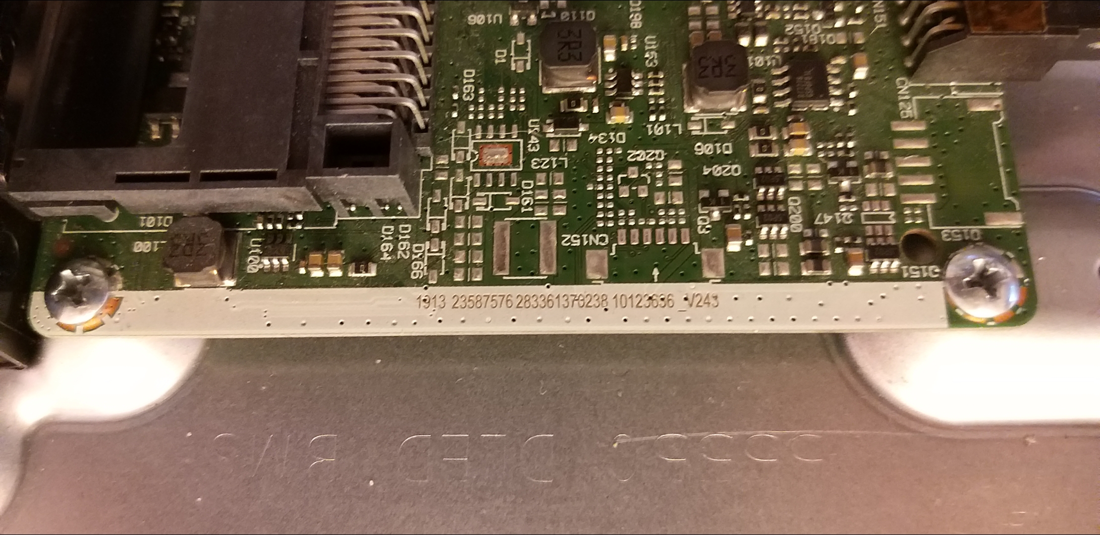

                                      #38
                                      Just make sure your main board is 23587576 otherwise you will inevitably have issues with it (assuming that this is the original main board from your TV that is pictured).

                                        #39
                                        the 1st replacement board was the same and did get something change on the screen when applying pressure but not an image.

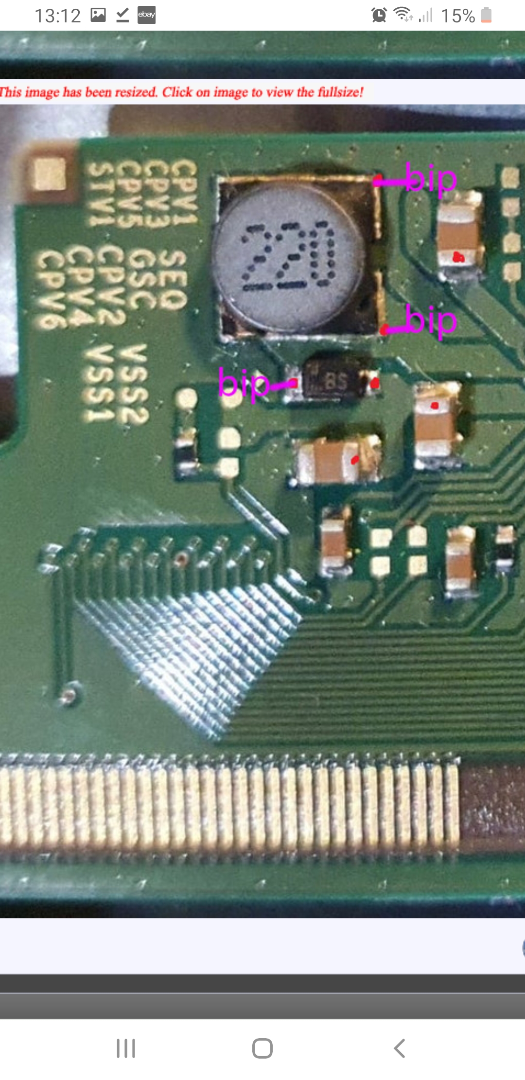

                                          #40
                                          For info/ref.
                                          VSS1 -7.3v
                                          VSS2 -14v
                                          diode fluctuating 8.5v and steady -14v
                                          12.3v on that top cap next to the 4 test points
