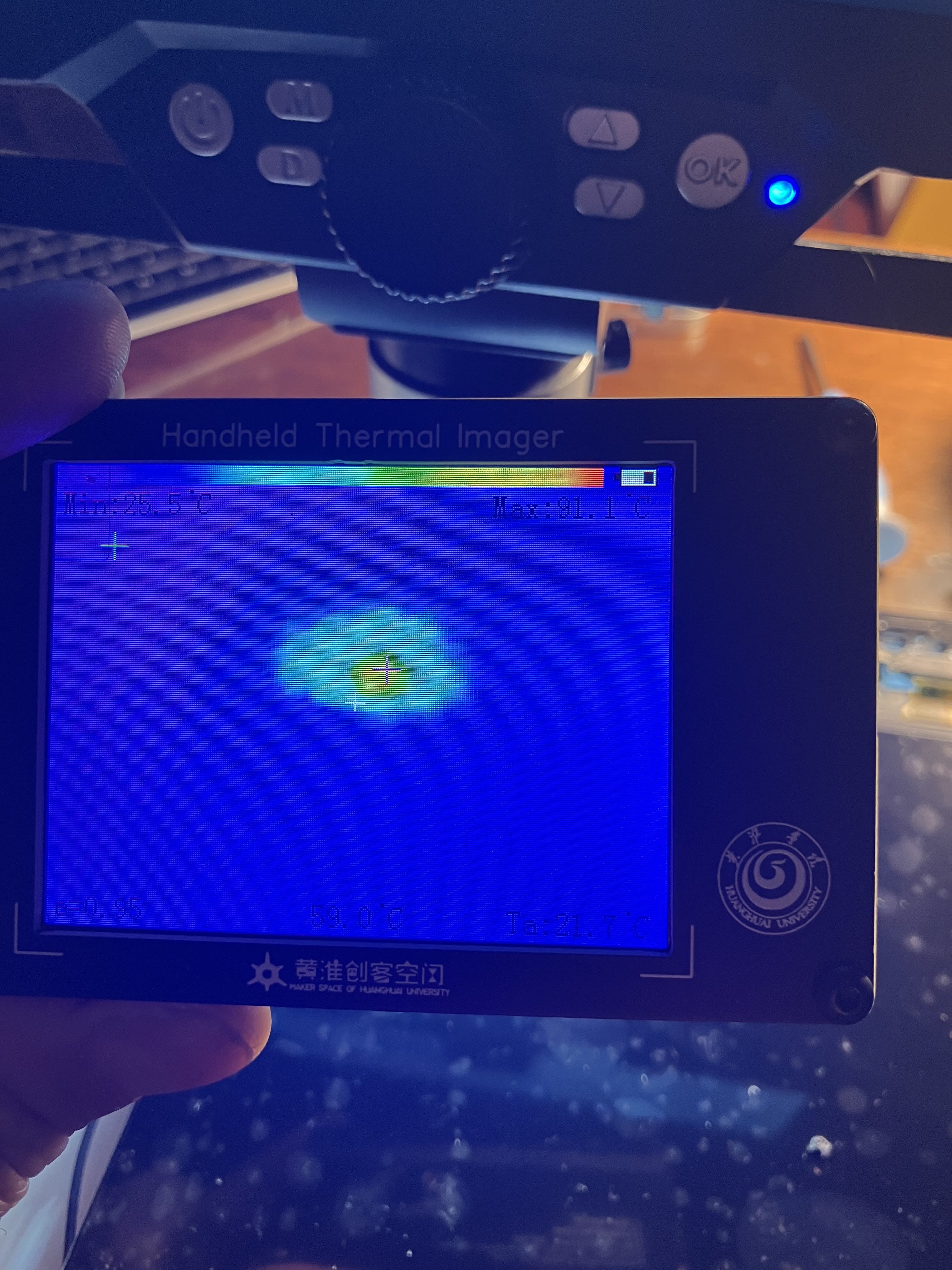

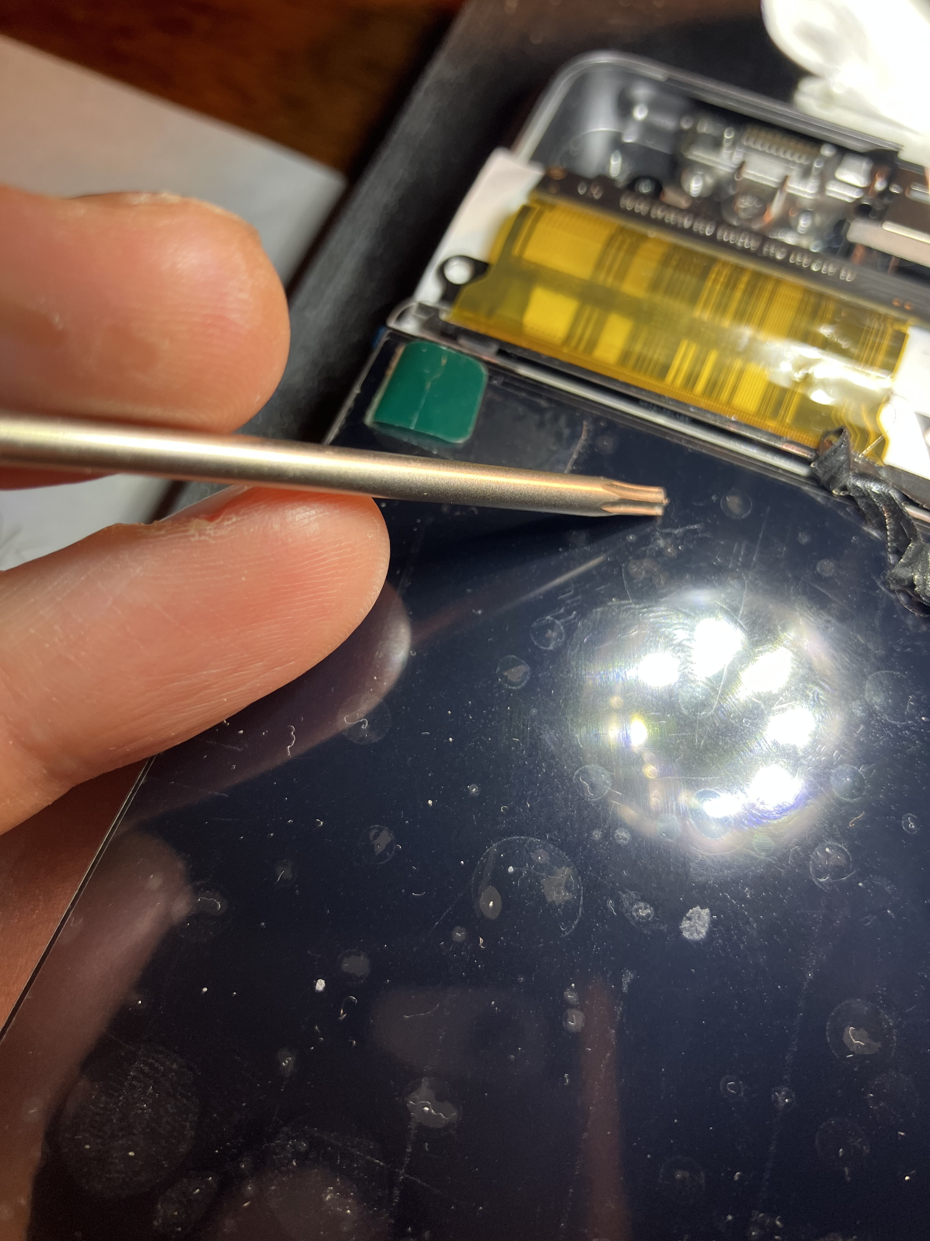

                              yes, I got flex and it show image, but the problem is lcd heating up to 100 celsius at 1 point, I dont risk to finish repair because it will damage MB soon, so I opened dispute too, dont know how about Ali accept my issue or not
                              how do you think it is lcd fault or my fault? I dont think it is my fault
                              *** may be lcd does not start because apple detects at TCON board something wrong, and seller short-circuited (as they say) some pins of flex, and this short-circuit disables apple's checking, IMHO

                                  no visual difference on flex cable. need to work with tester to compare all pins of apple's flex with seller's flex. will do when have a time
                                  it is getting hot directly glass. see picture where scredriver points

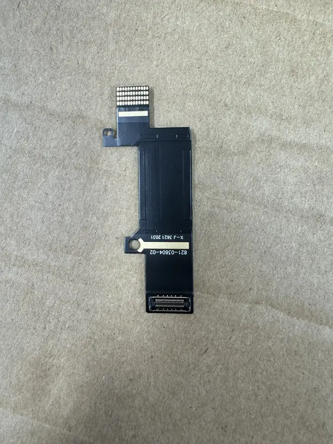

                                      no, they are differemt, as apple's flex not show image, and sellers flex - shows, tried both on same seller's lcd
                                      • a316
                                        • Oct 2024
                                        • 24
                                        • Georgia
                                        Originally posted by MartZisto
                                        a316 alright. I have to hope they sent me a flex cable but impossible to reach them. I am afraid they are no different, and then I will be out of luck. Will continue and try measuring voltages on the tcon board.
                                        found seller's flex has spi_tcon_clk_conn shorted to ground, on JP600 side. apple's flex has 4,5Om same pin to ground, flex disconnected
                                        it is like not flex, it likes has some parts inside
                                        let me know if this helps
                                        ps. spi_tcon_clk_conn connected to M1, be careful
