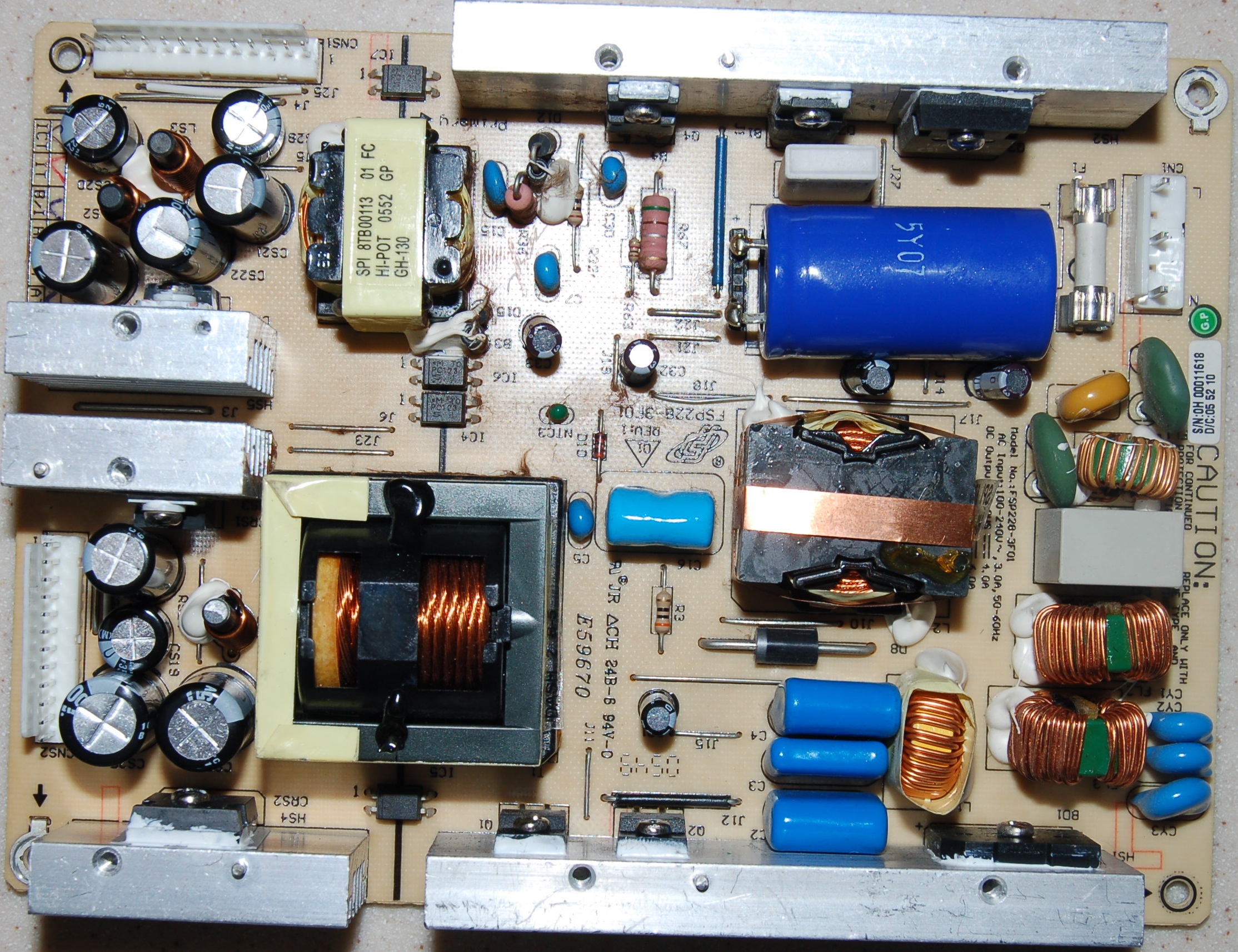

      @timbot, are those voltage readings in red are the readings you are getting? Pictures of the your board top and bottom?
        Re: Fixed a ViewSonic N3260w

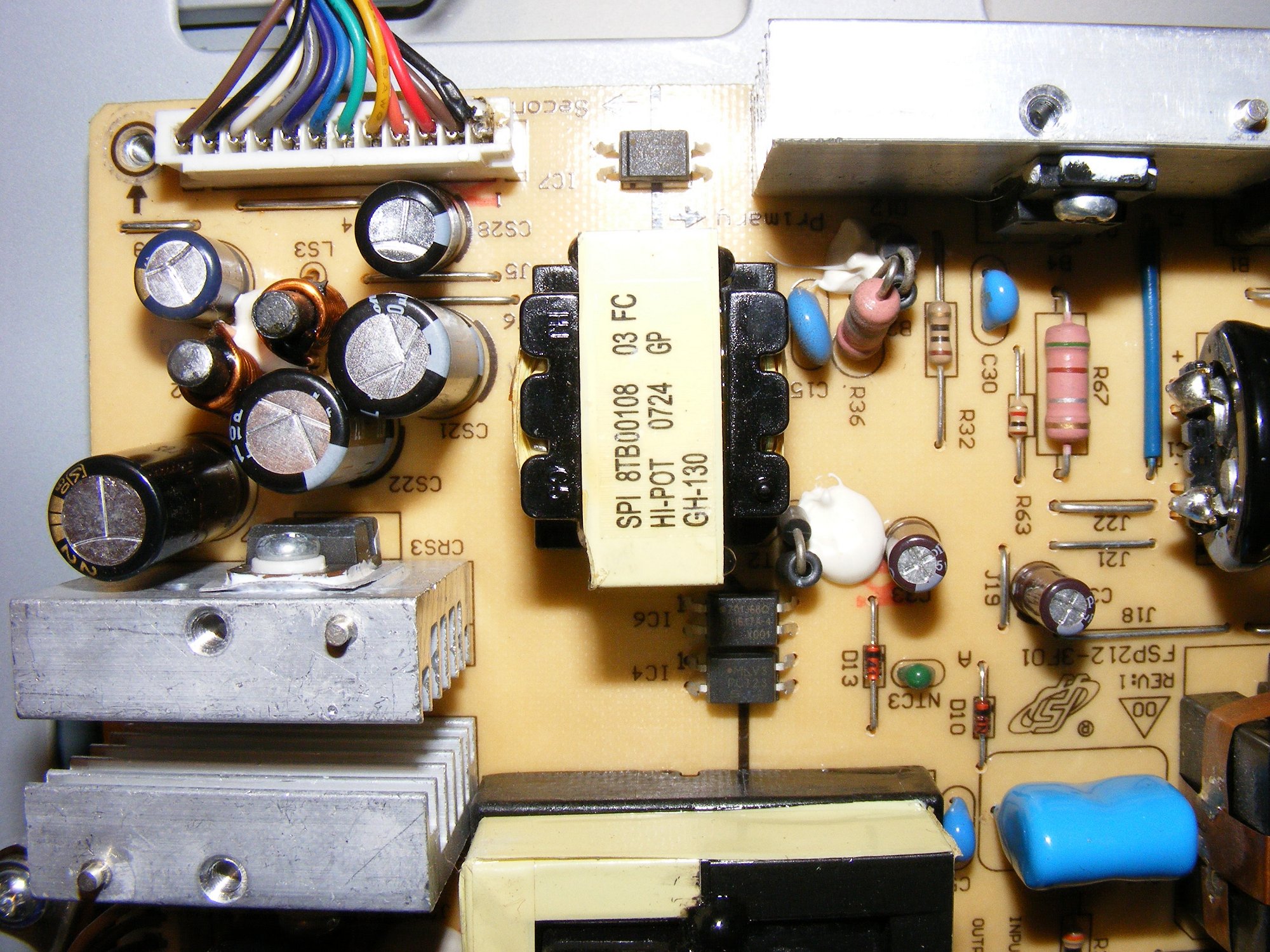

        Budm, yes, those are the voltage readings in red, here are the pics of the board with the new caps. Thanks much!
          OK, we need to fix the 5VSTBY first. Check or replace start-up/running cap C22, C33 (33UF/35V), make sure R65 (5.1 Ohms is OK). Zener Diode ZD4 (15V) is really 15V (I just fixed one last week, the Diode mode test OK but it becomes 10V Zener instead of 15V). You will need variable power supply and a 1K resistor to test the voltage of ZD4.

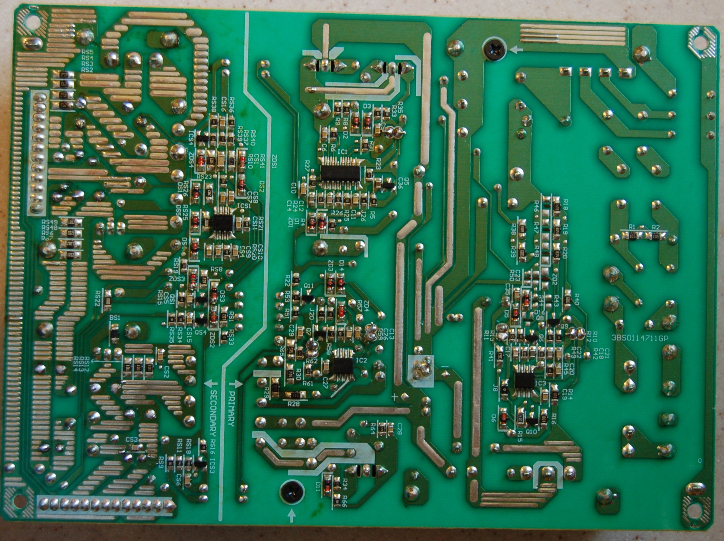

              3) On the back side, inspect all SMDs for burn marks or bubbles. A bright light and a jeweler's loupe are recommended. Clean up any flux residue on the SMDs so you can see the markings clearly. Surfaces should be shiny all the way across devices. If you see a clouded line transecting the device, that's a problem.

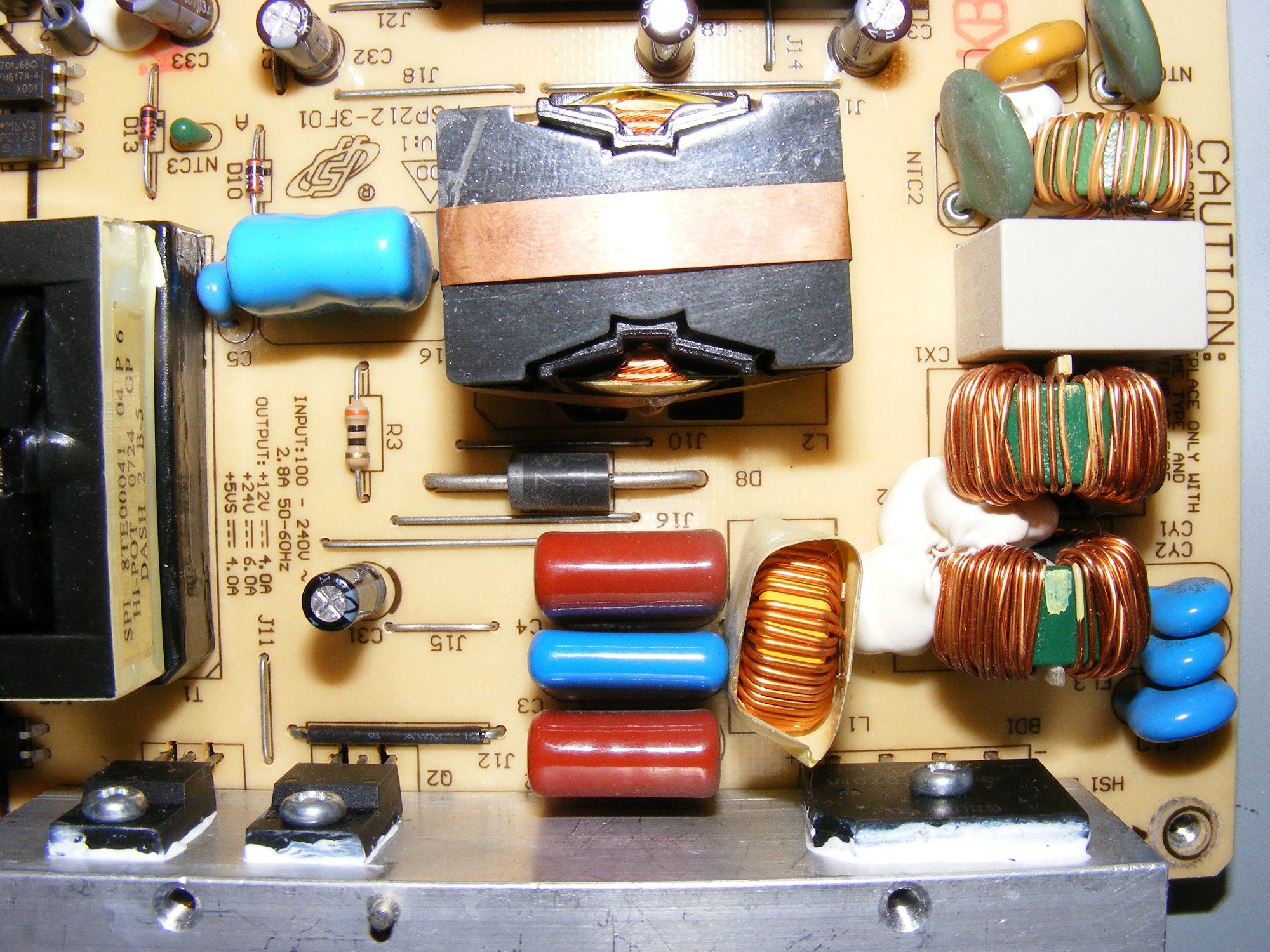

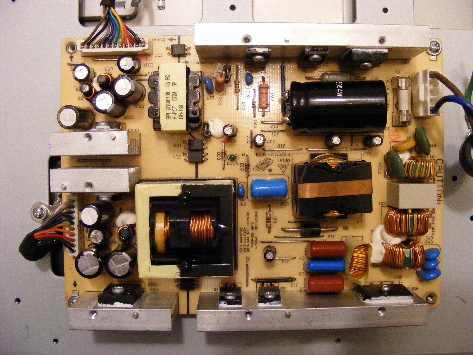

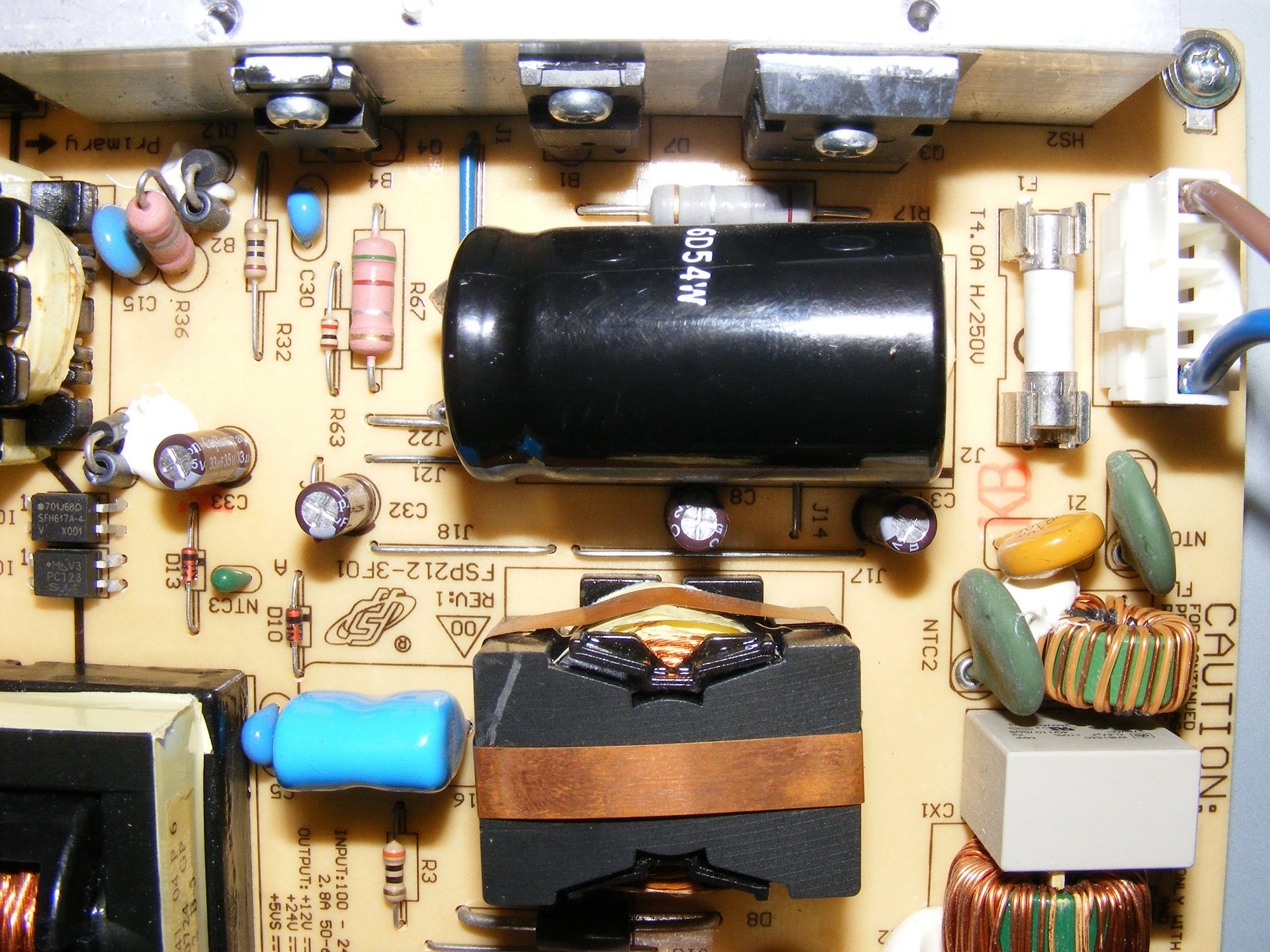

                        Here's some pics of the board:

                            I am concerned about C16 as there appears to be a circular fracture on the one end. Understand that those caps are dipped when manufactured. There are no mold or parting lines and that crack indicates an issue.
                            Great top pics, a few of the bottom in that quality would be super!

                                  C16 is OK, it must be a reflection you are seeing.
                                  I'll take some bottom pics after I get it running and clean up the flux.
